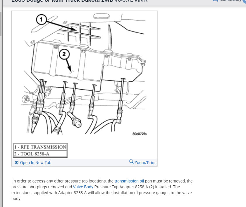

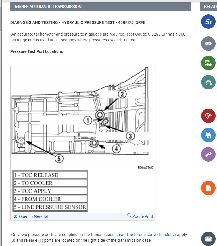

Okay. Just to be sure I understand, if when you put it in any gear it acts like it is in neutral and just revs then this is due to a lack of fluid or pressure.
so, we need to check the fluid and then check the pressure using the info below.
Unfortunately, this is most likely not a sensor. More than likely this is a pump issue.

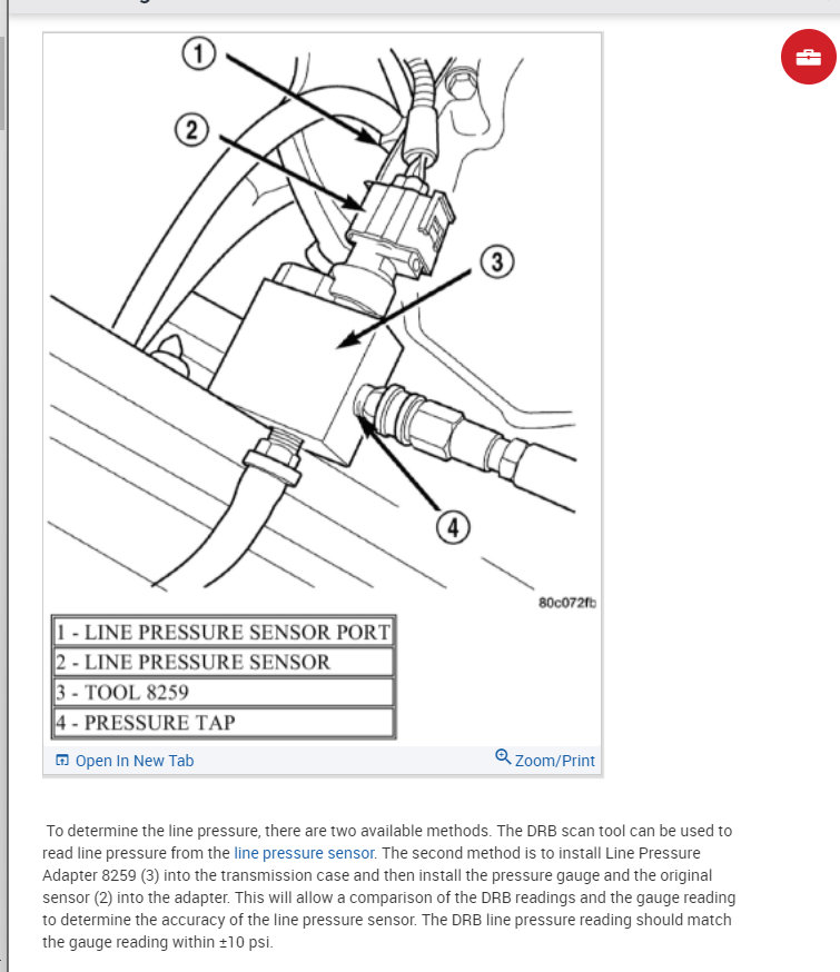

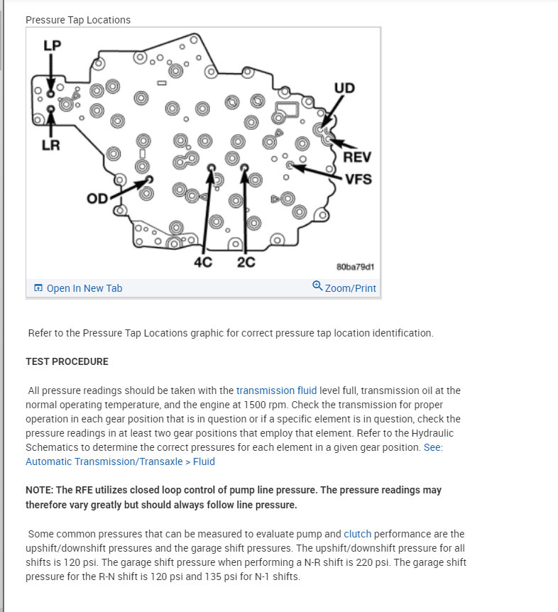

This is most likely due to a fuel pressure issue from a failed pump, or the torque converter has failed.
Basically, we need to use the info I attached before and check the pressure in the unit and find out if we have the proper pressure and go from there.
Without this info then it is unlikely that we will figure this out just because we need to start running through the basics and that will take us to the next step.
