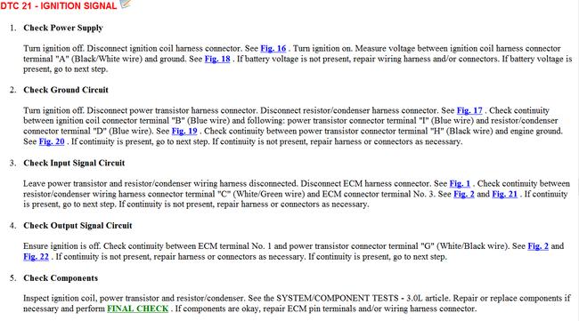

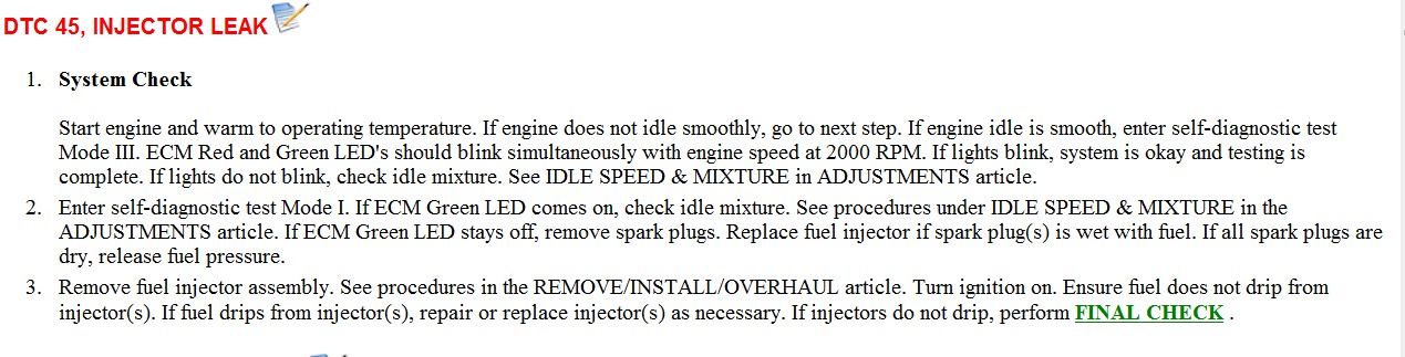

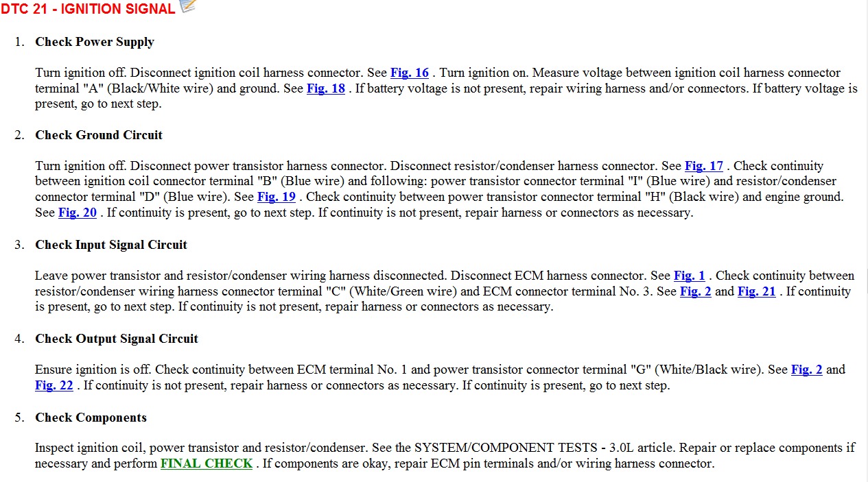

I can't find a code 23 what engine is in this a 3.0L? is this like a pickup or a pathfinder? code 45 diagnostic is shown in pic. i'm sending two different things to check.

ok you should have 33 psi fuel pressure at the rail wih engine idling. If vacuum is disconnected it will be 43 psi. your truck still doesn't show a code 23 so i'm taking it that it's a code 21 but check for a vacuum leak with choke spray, spray around intake for leaks. also take intake vacuum reading at idle if 15" or less suspect a clogged converter.
