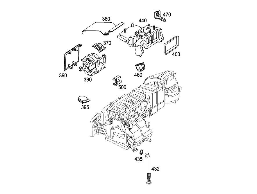

Can you point out the tube to check? http://www.mbpartsworld.com/showAssembly.aspx?ukey_product=7631671&ukey_assembly=1083530
Thursday, August 27th, 2020 AT 6:23 PM
MHPAUTOS
  • 31,937 POSTS
Can't see it on that pic, but there will be a small drain tube to allow condensed water that forms on the evaporator to drain away, there will be a small tube through the floor or the lower part of the fire wall at or near the evaporator housing.
KEVINM01
  • 63 POSTS
Ok, I really hadn't the slightest clue what you were telling me to look for. Are you talking about #432 in the picture?
If so, how do I access that?
KEN L
  • MASTER CERTIFIED MECHANIC
  • 48,363 POSTS
It is part 432, install the leak detector in there
KEVINM01
  • 63 POSTS
I couldn't find it
MHPAUTOS
  • 31,937 POSTS
You will have to locate the outlet under the car, the pic will give you an indication to it's location you will probably only see a rubber grommet with a small rubber hose protruding only about 2-3 mm
KEVINM01
  • 63 POSTS
I mean you've seen a C230 and you see the diagram. Where specifically do you think it comes out? I've looked under the vehicle, I don't see anything.

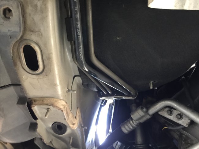

Do you know what this oval opening is? I saw that. But that was the only thing I saw.
There's a hose that drains outside of the windshield to the bottom of the car. I also saw that one.
But no visible evaporator drain hose.
