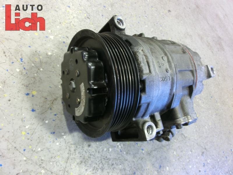

This is what my compressor looks like. It's got a metal piece on the front, which seems to be a clutch (which is not engaging). The product info is DENSO ASSY 447220-8843. It seems to be for European c-class models.
What do you think, does this compressor have a clutch or not?
Aug 27, 2020 at 11:23 AM
  • 55,781 POSTS
Nope, no clutch on that one buddy, Internal valve model. I think its time to check out the video because you will need to replace the compressor.

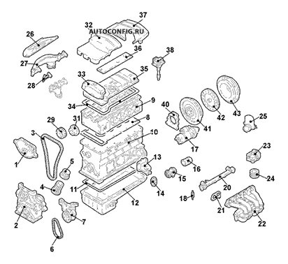

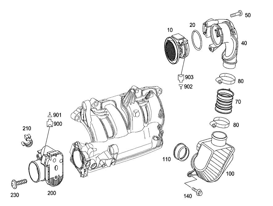

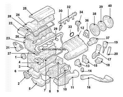

I did a preliminary check to try and locate the starter and see how I will access it once I get that part....it doesn't look so straightforward. I got under the vehicle to see it, and I couldn't see really even how to get it out.
Just take a look at these diagrams. How do you get to it? It looks like #37 and #17.
Let me know if you instructions or ideas on how to approach this. I think accessing the starter was easier on the Ford.
  • 55,781 POSTS
Upload the images please use the link right below the text box
KEVINM01
  • 63 POSTS
Oh...so these were the images I was referring to. I realize that's probably not the M271 engine, but the layout is similar. I pulled that from a website that was written in Russian, so I don't really know what it says since I don't speak/read Russian.
Problem is, you don't really see what it looks like next to the bell housing from these pictures. I'll post some pictures from my car later on this week when I get a chance.

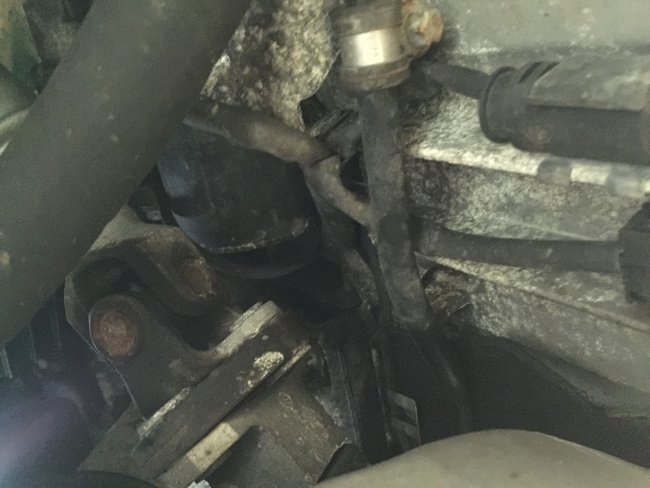

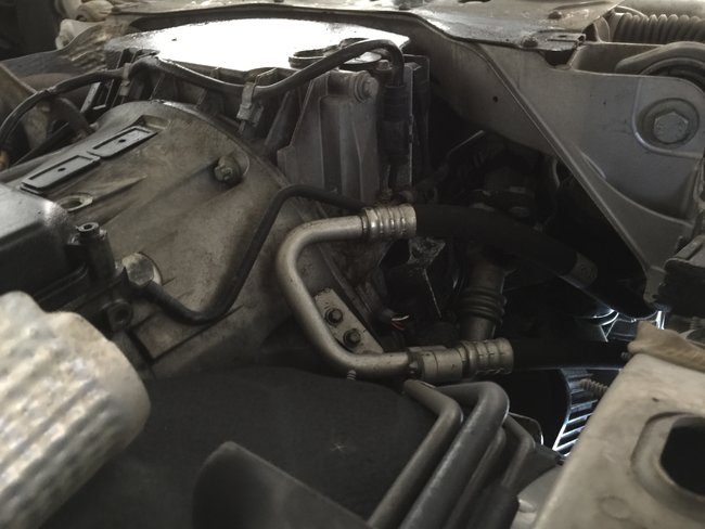

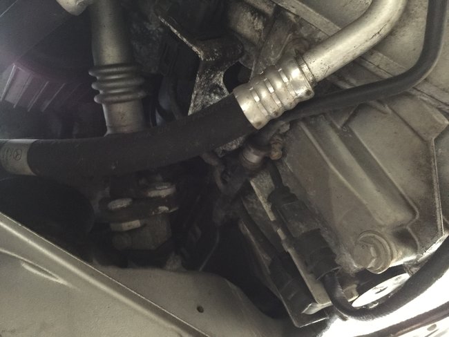

Haha, I'll keep that in mind. Well I'm definitely trying to learn to become talented. Things are definitely challening on this car--intimidating but rewarding when you get it right.

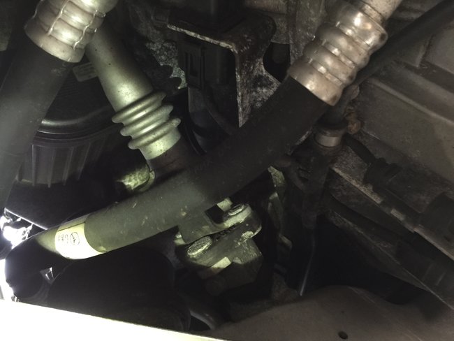

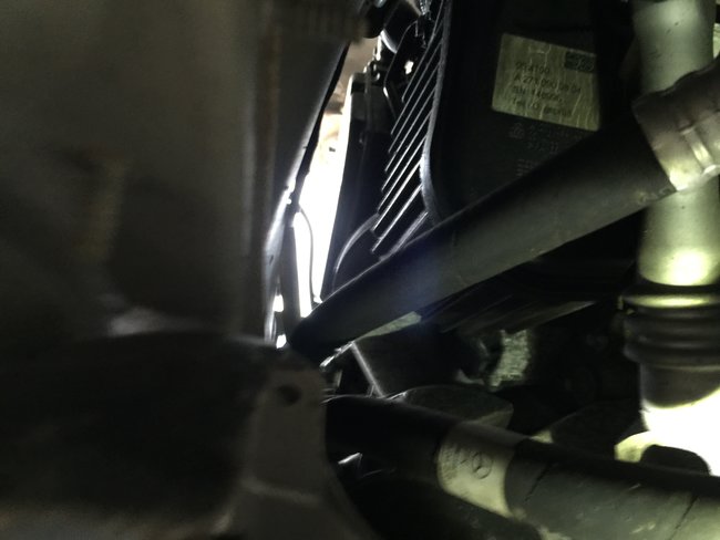

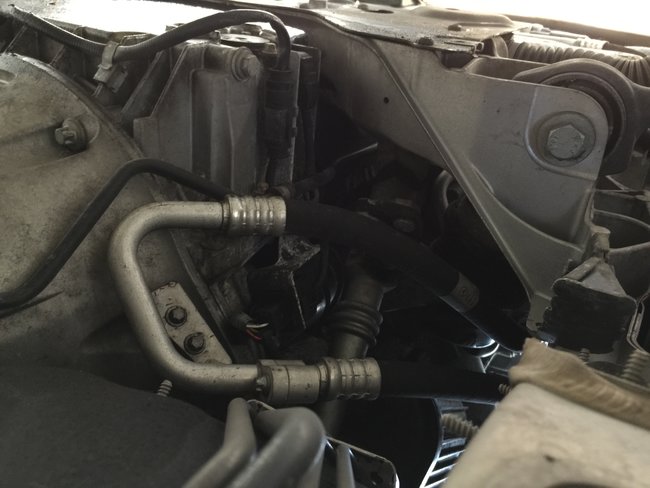

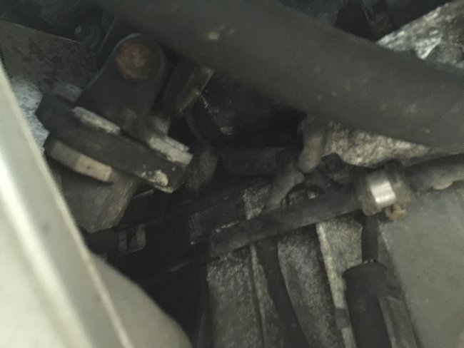

So I've a snapped a couple photos to give you an idea what we're dealing with. The first two, are just to get you oriented. And then I took some close-ups so you can see how tight the space is.
If you look above where the hose are bolted to the bell housing, and above and adjacent to the steering coupler, you can see the starter. Then above and adjacent to that is the supercharger muffler and supercharger.
So the question is, how do you get it out?
What I know is, the intake muffler DEFINITELY has to come out, since it would not be possible to get the starter out even if you managed to miraculously unbolt it.
So how do you get the muffler out....does the whole supercharger come out too?
Or is there a another way to squeeze out the starter?

Sorry the first two photos I posted, posted upside down for some reason, which is extra confusing. We're on the left-side/driver's side. So the top of the photo, is the bottom of the vehicle in those first two.
  • 55,781 POSTS
You don't need to remove the super charger but you do need to remove the steering column coupler I believe. To get the air filter muffler out you must remove the air cleaner housing along with the computer etc. The hardest part is to get the hose clamp undone to the muffler btw. You will need one of these tools.
http://www.amazon.com/OTC-4525-Cable-Type-Flexible-Pliers/dp/B000F5JM0O/ref=sr_1_1?ie=UTF8&qid=1464057468&sr=8-1&keywords=hose+clamp+tool
Let me know how it goes
KEVINM01
  • 63 POSTS
I got the tool, but where is the clamp are you talking about? The starter is behind and below #100 in the picture.
