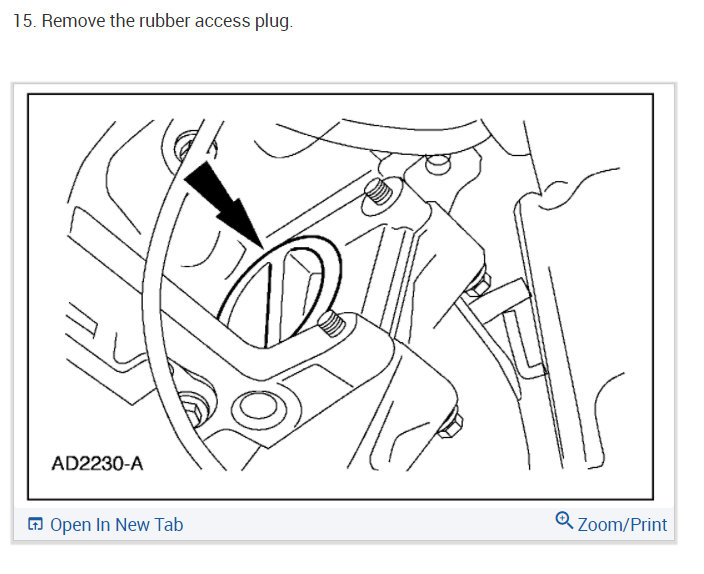

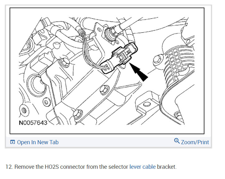

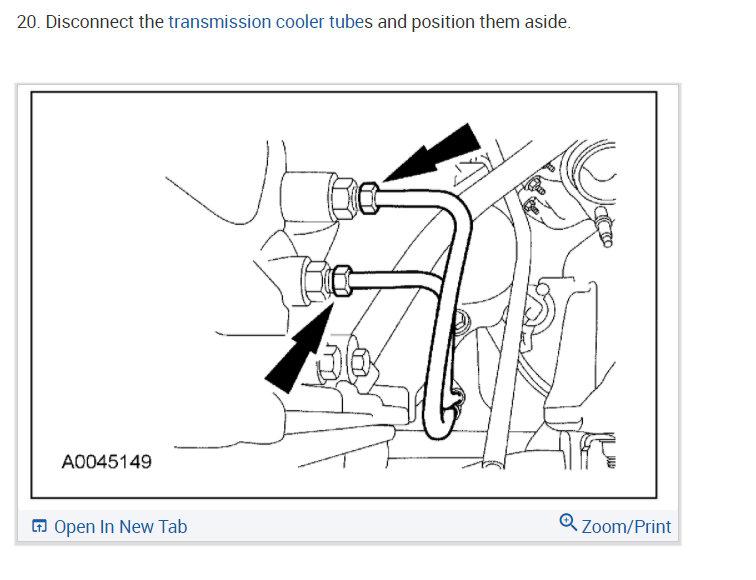

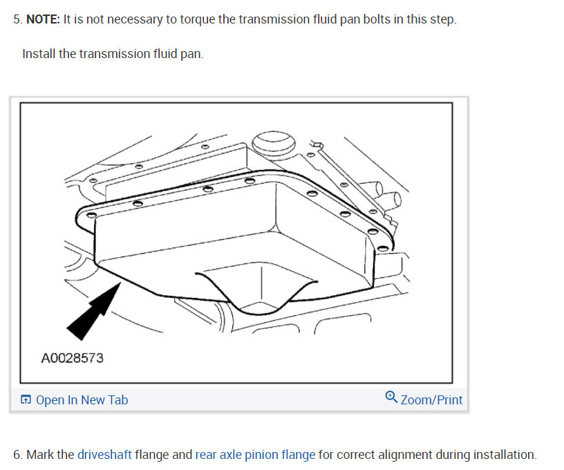

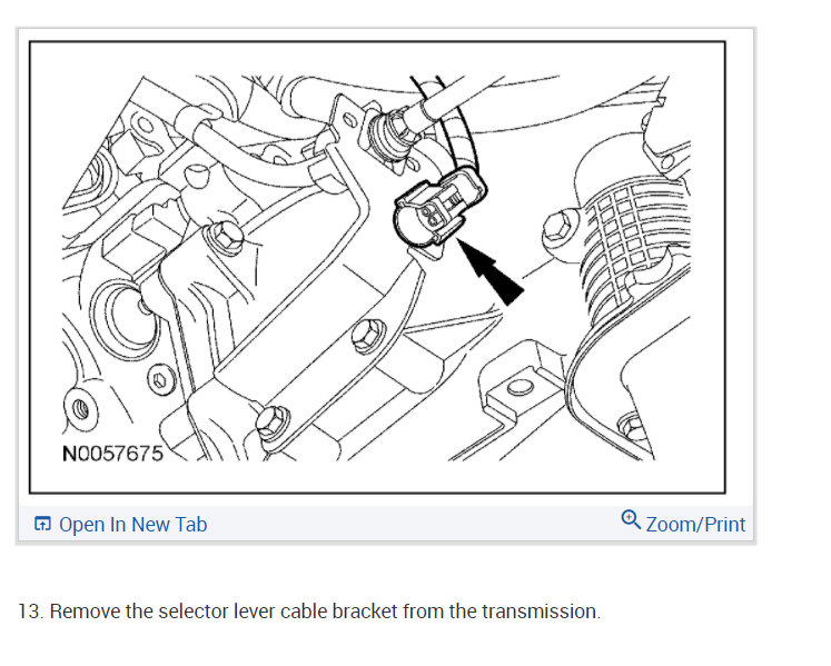

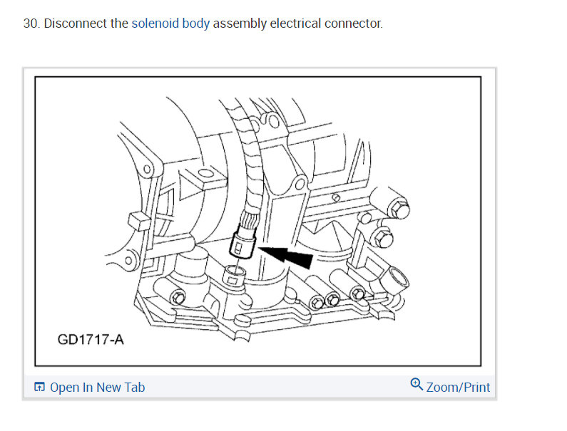

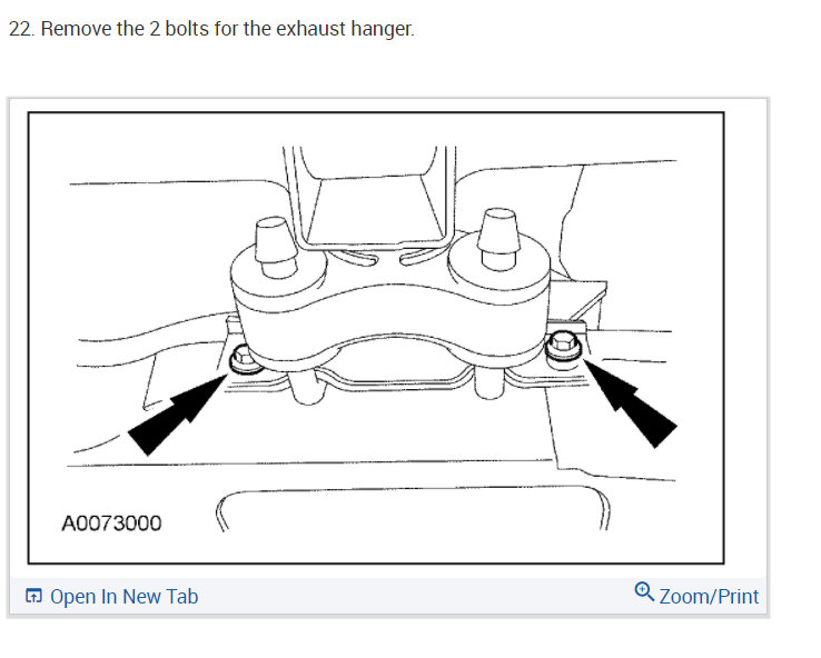

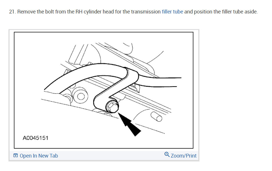

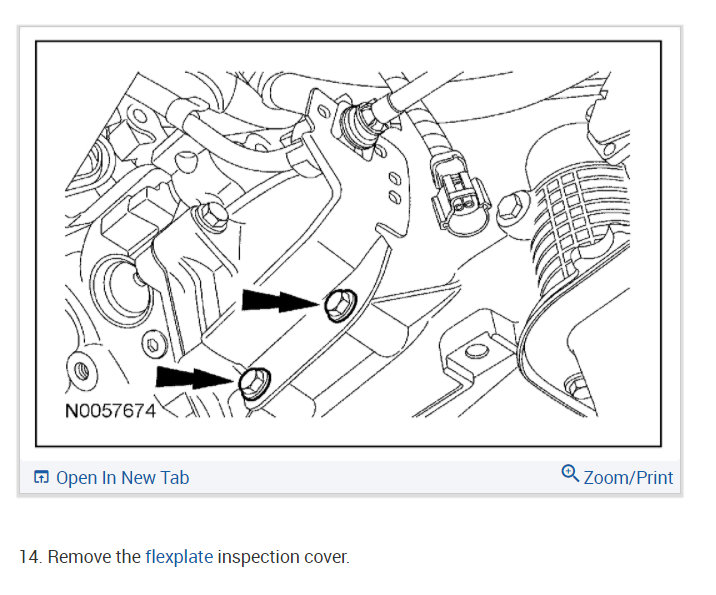

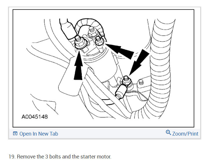

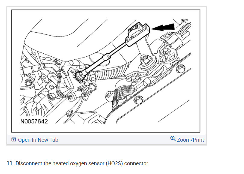

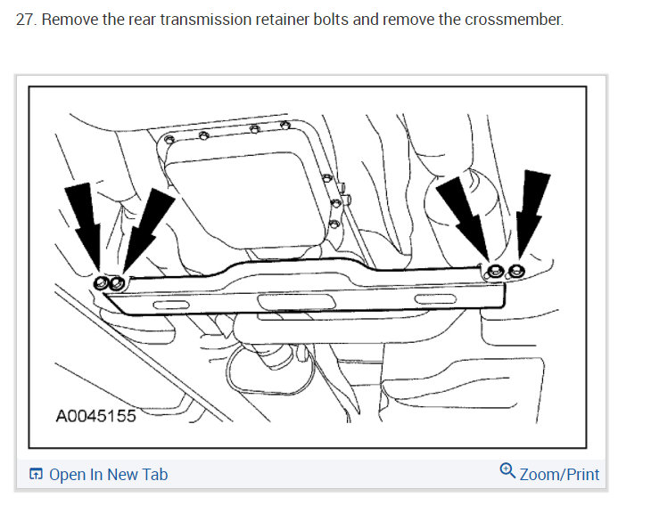

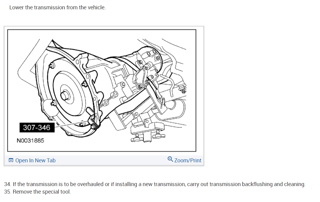

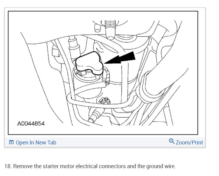

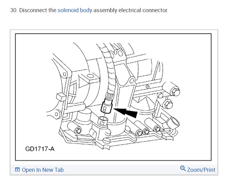

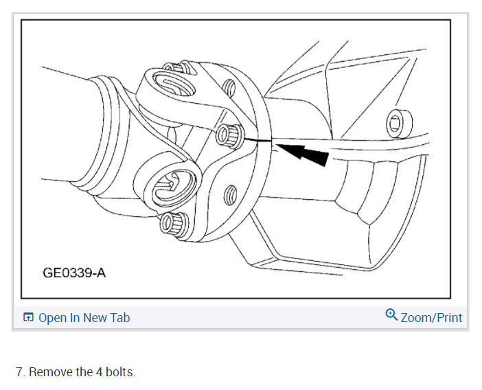

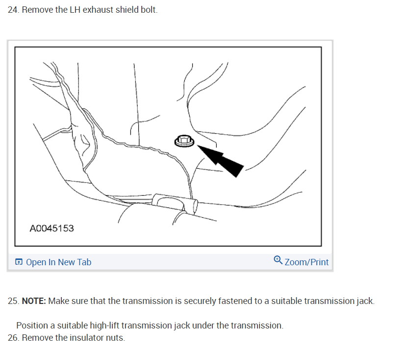

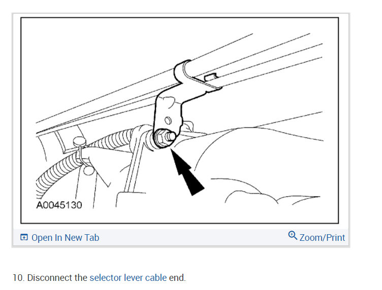

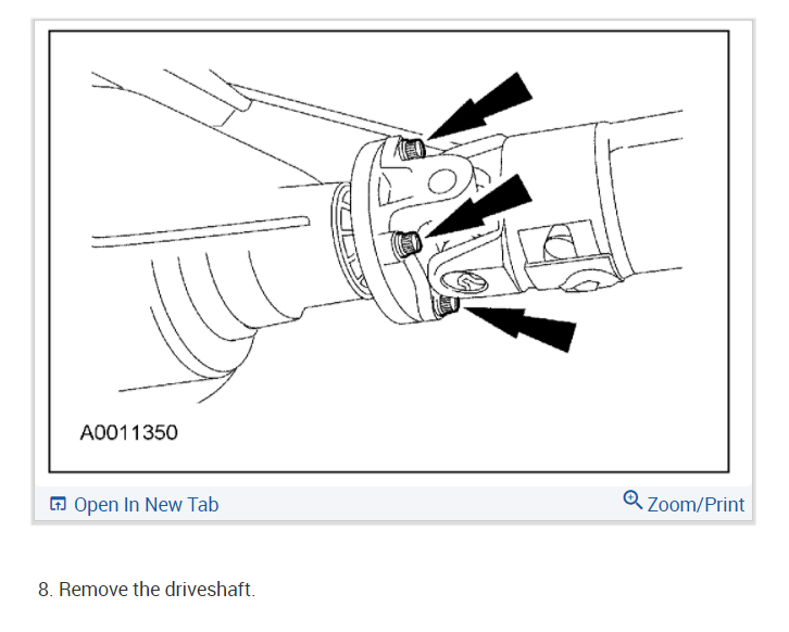

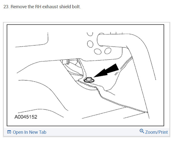

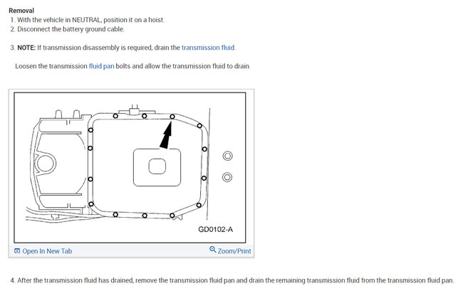

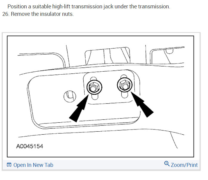

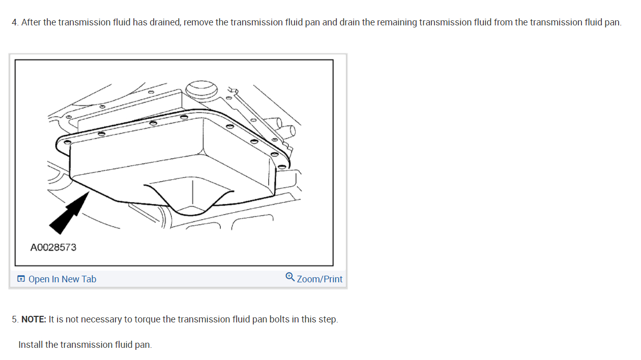

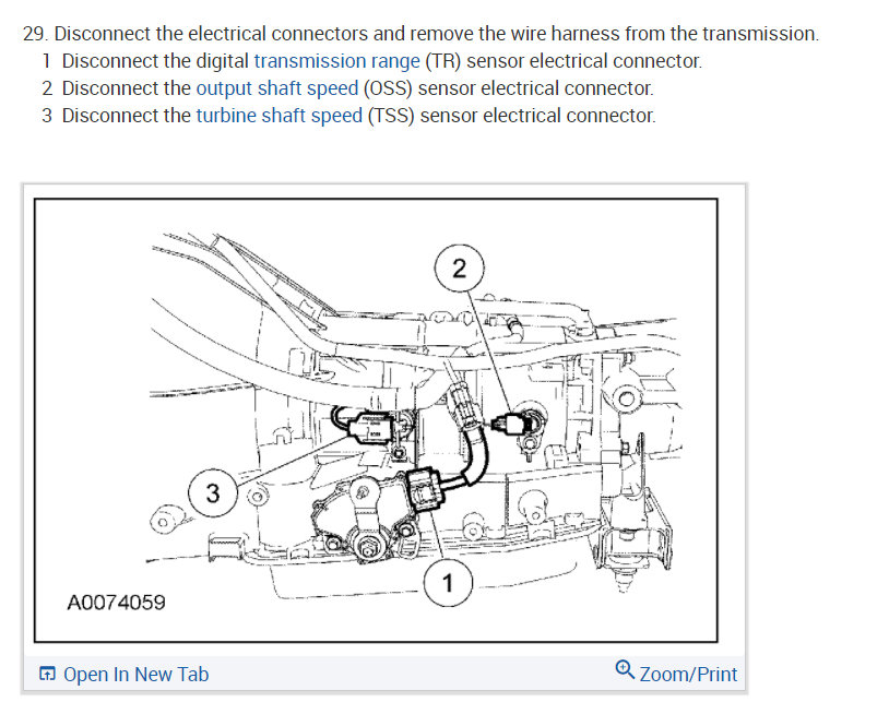

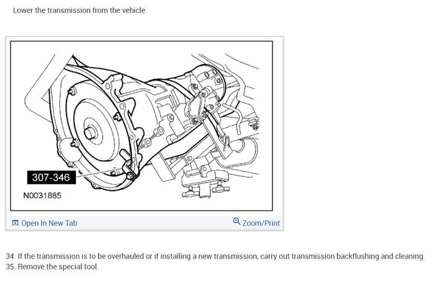

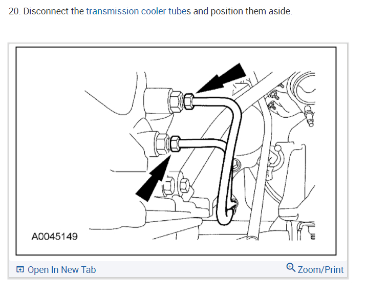

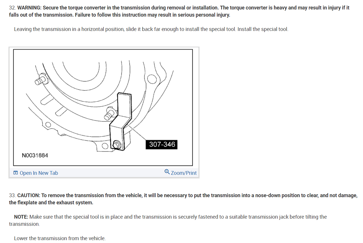

Hi, I need to ask if you can give me the instructions and guidance on how to remove the transmission? Will a transmission out from a crown vic work? Thanks, Andrew
Wednesday, December 30th, 2020 AT 10:48 PM
5 Replies
  • 52,797 POSTS

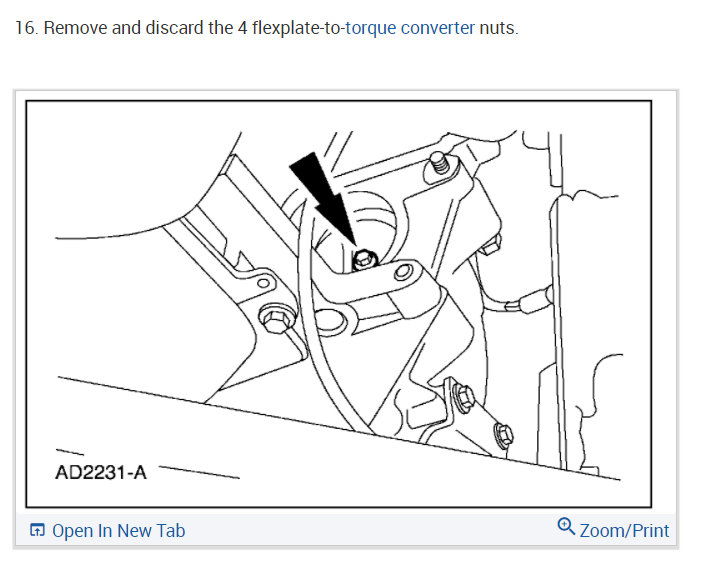

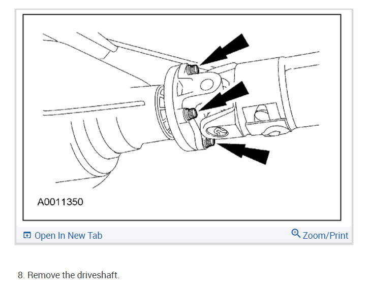

Good morning,

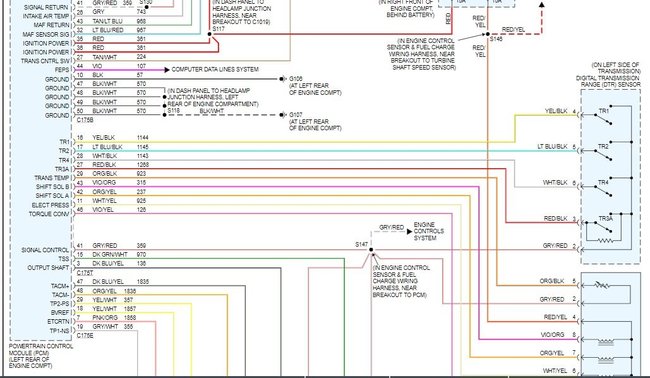

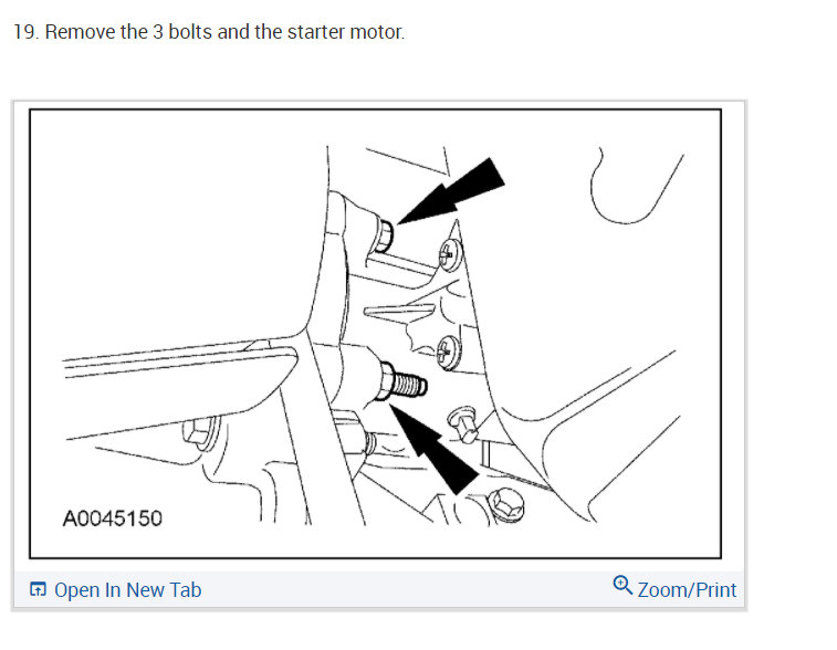

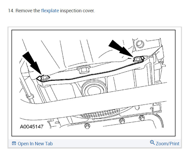

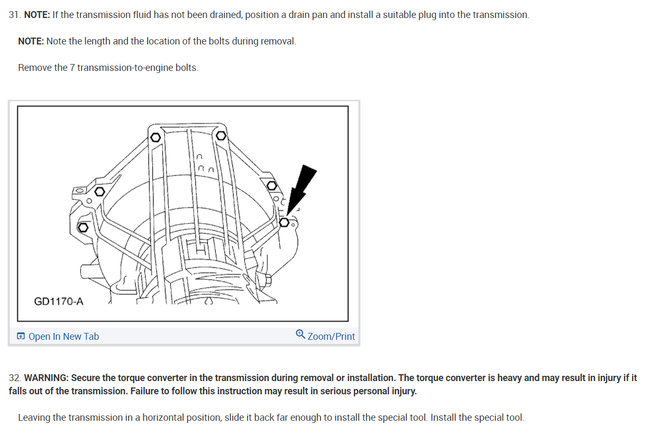

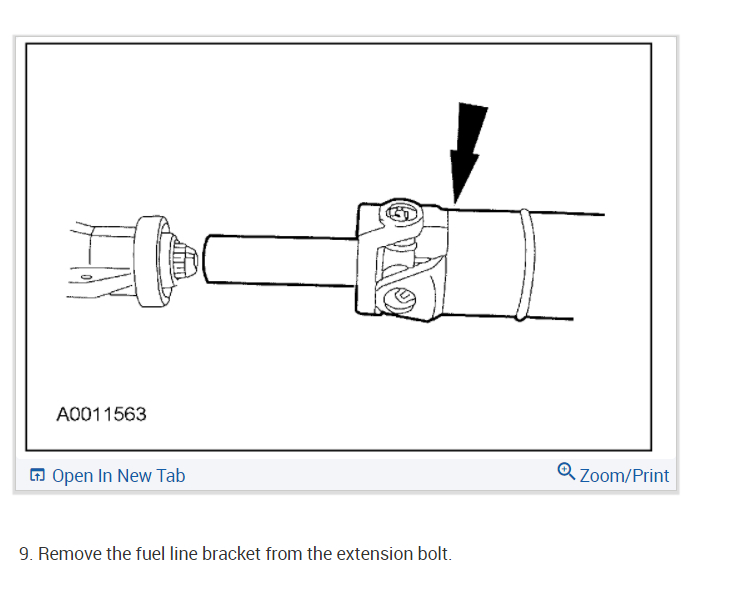

This video shows the job being done on a similar car but the process is the same with instructions below to help you with your truck.
https://youtu.be/3vJAojsrfuU

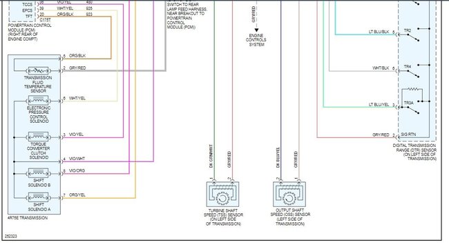

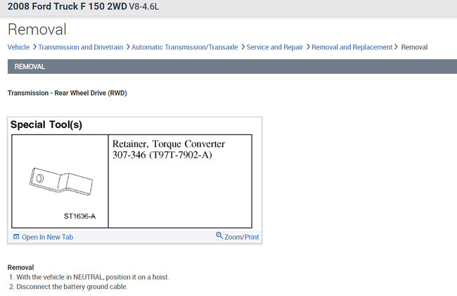

There are 3 option transmissions for the F 150. I need the numbers ff the tag on your current transmission to be sure. This video shows the job being done on a similar car but the process is the same.

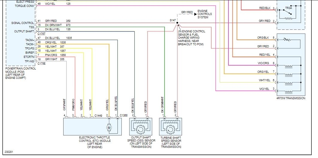

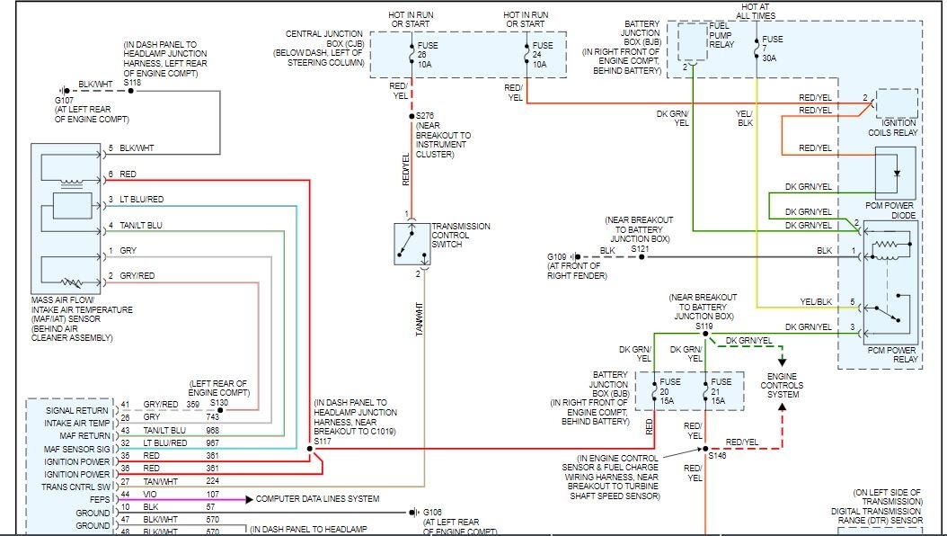

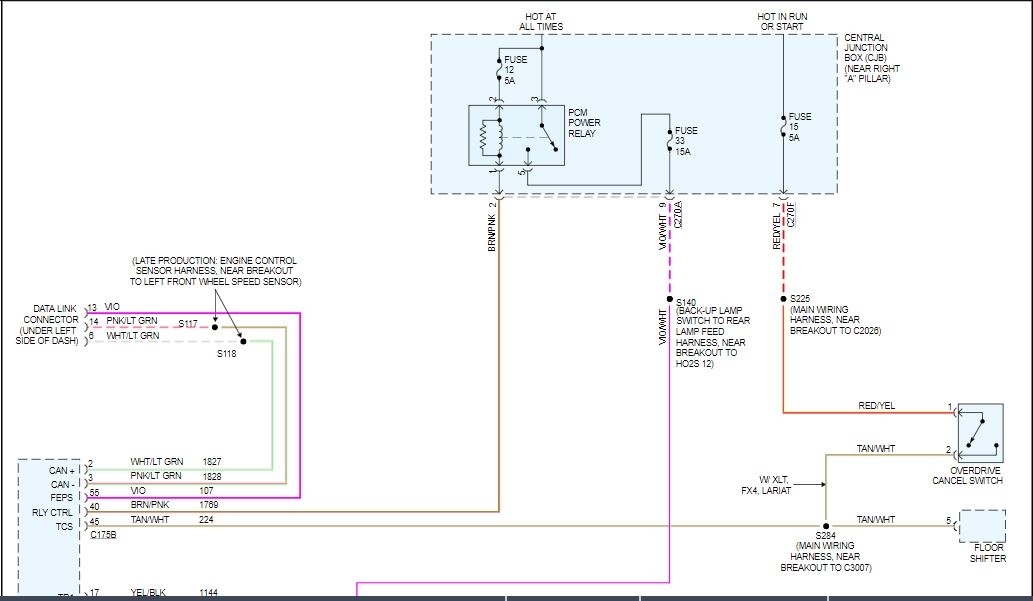

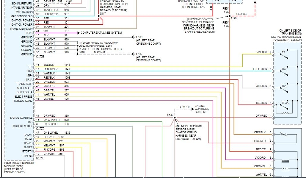

You do realize the donor is a 2 wheel drive and you have a 4 wheel drive in the truck? That alone may require a lot of work to adapt.

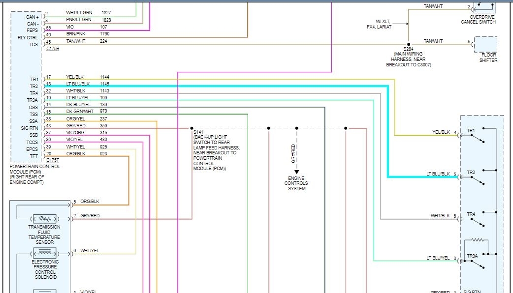

I attached wiring diagrams of both transmissions. If you are looking for a simple answer, I say no. I would get the number off the tag and find the correct transmission.

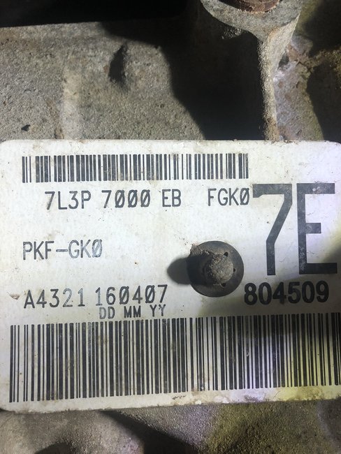

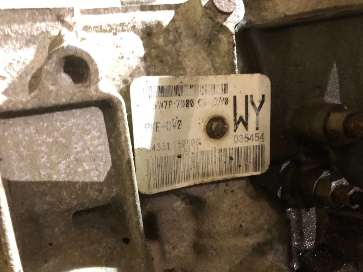

ANDRZEJ KAMELA

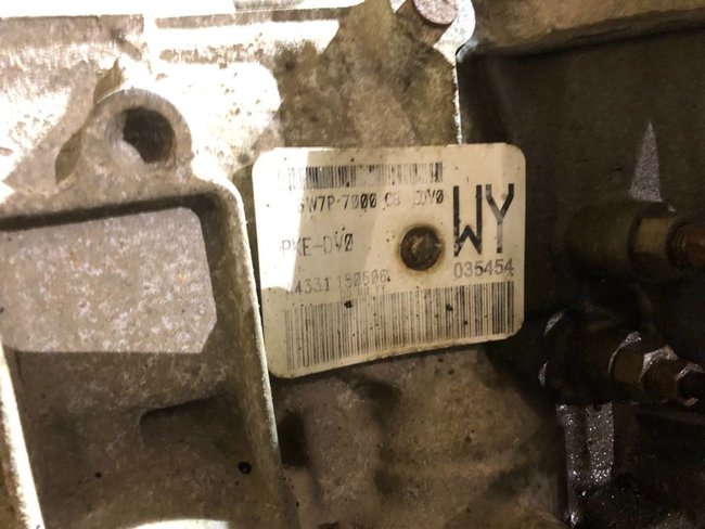

Hi Roy, this is a picture of the sticker from my truck transmission.
-1
Thursday, December 31st, 2020 AT 8:39 AM
  • 52,797 POSTS
Okay, the numbers you need to match is PKF-GKO.
Let me check on a transmission for you. Can you give me your zip code?

ANDRZEJ KAMELA
Canada British Columbia v4n 4y5.
This is a sticker from Crown Victoria transmission.

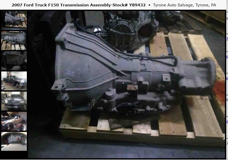

I attached a picture of the unit you need from the web site www. Car-part. Com.
You have a 4R75 transmission.
