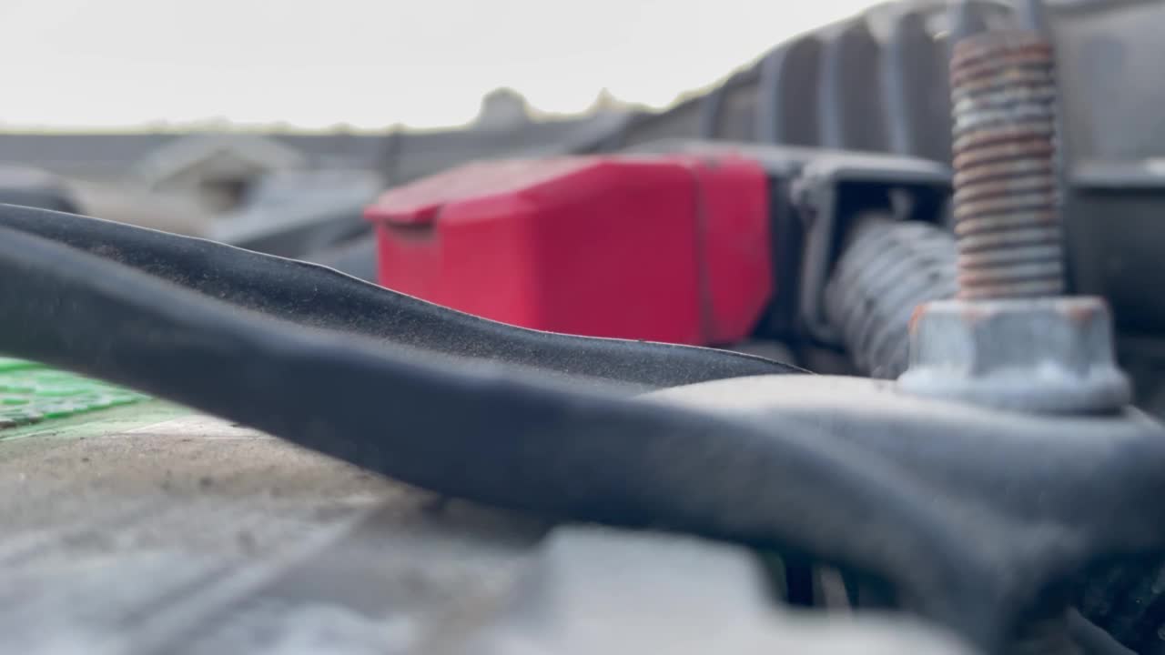

Car wouldn't start but cranks. Transmission/starter.

The sound it makes.

I do hear a rattling noise when you release the starter. Is that what you are referring to? Did the no-start happen all at once? Is the noise something new since the no-start happened?
As far as the no-start, we need to narrow down possible causes.
In most cases, a crank no start is either an ignition-related issue or fuel related issue. Also, a failed timing belt can also cause this.
Here is what I need you to try. First, see if the engine starts if you use starting fluid. If it does and then stalls, we know it is a fuel-related issue. If there is no change, then suspect an ignition-related issue.
At that point, I will need you to check for spark to the plugs.

Yes, so my car started making like a tractor noise at low speeds and goes away when i speed up. They told me my timing belt went bad. And a week later the car didn't start. Since u just confirmed its the timing belt, could you help send me what i need to buy for the parts? Either names or links to eBay. I'm not sure if i need just the belt, the kit, or also a belt tensioner. Let me know thank you so much.

This engine has a timing chain and not a belt. At 130K, it shouldn't be a problem. If it was a belt, yes, that could be the issue, but in this case, I don't think it is the issue. Also, all Honda engines except a couple of v6 engines are interference engines. If the chain breaks, it can cause internal damage to the engine. But I don't think that is the case. Listening to it crank in your video, it doesn't sound like a compression or timing issue.
The replacement of the timing chains is a big job on this vehicle, so I suggest we confirm that is the likely cause. Were you able to perform the tests I mentioned above? Also, can you tell where approx on the engine that noise comes from? Also, I need to know if this has a PZEV engine. The procedures are different.
I will be happy to help you replace the chains and components, but I don't want you to take things apart to find that isn't the cause. Try the tests I mentioned above and let me know the results. Also, if you have a scan tool, check for codes.

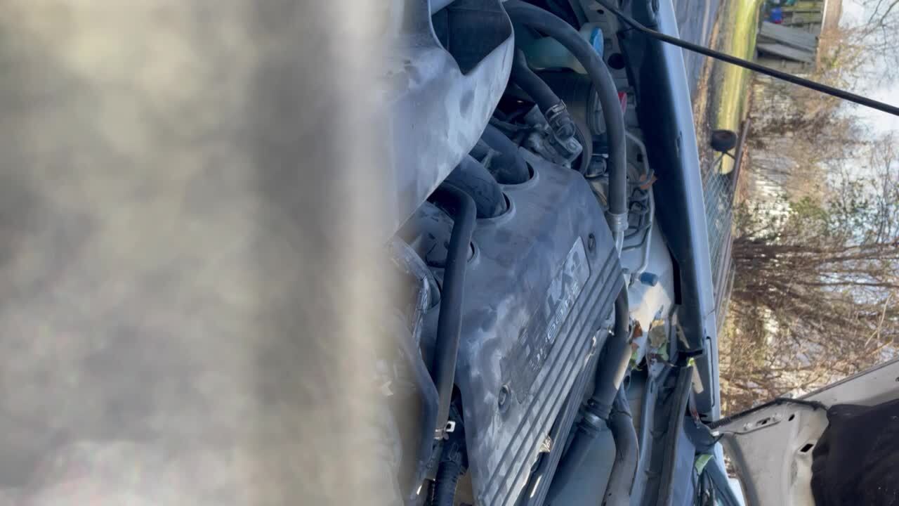

AHMADMUSAITIF
  • 12 POSTS
Another video.

However, I can help you this was also. I listened to your video. I think you are hearing the top of a piston hitting a valve. I can't be certain, but that is what it sounds like.
In this case, we have two ways it can be checked. First, you could use a borescope camera. If you remove the spark plugs, you can place the camera into the cylinders and see if there is evidence they are hitting. Or you can perform a compression test. If I am correct, I feel you will find no compression on one or more of the cylinders.
Here is a link that explains how to perform a compression test. You will need a compression gauge, but most parts stores will lend one to you free of charge.
At this point, this is what I feel needs done to confirm what I'm saying is the cause. If it is, we need to remove the cylinder head and see if it can be salvaged.
