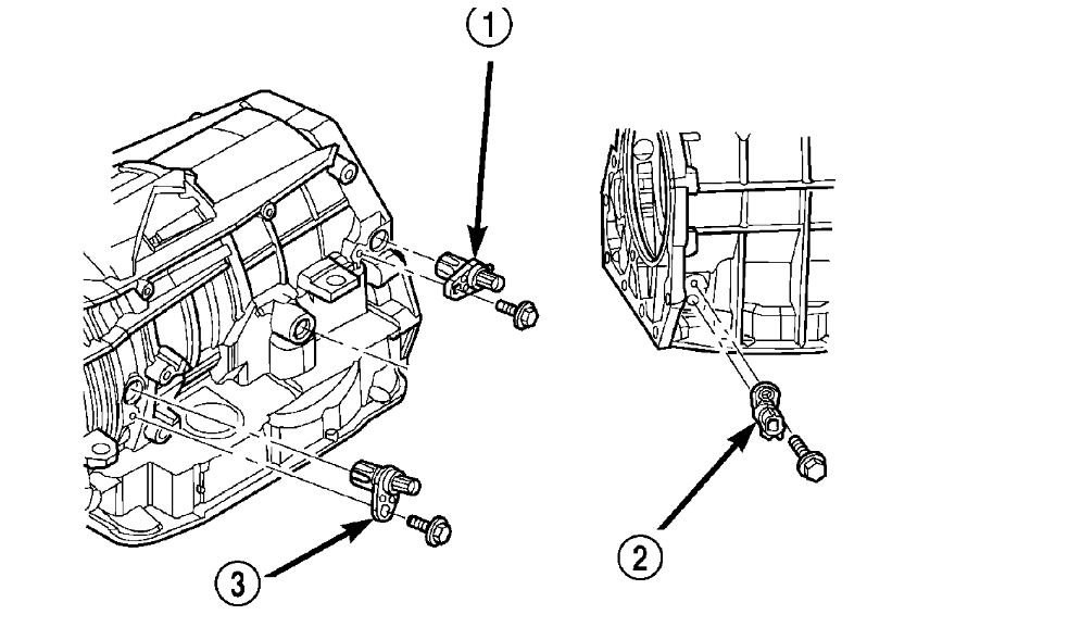

I had the transmission replace 2 years ago. now sometimes it shifts well and other times it doesn't.
Does it have an input and output speed sensor on the transmission?
Where is it located?

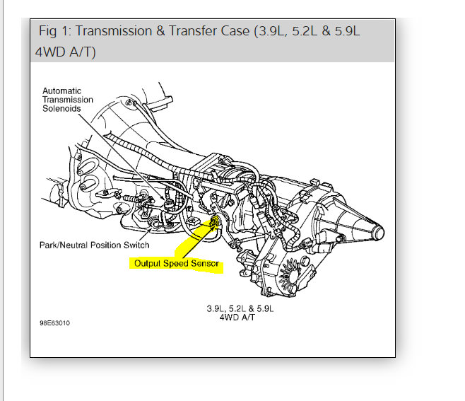

Good morning,
I attached a diagram for you to view for the sensors on the outside of the case.

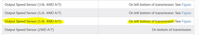

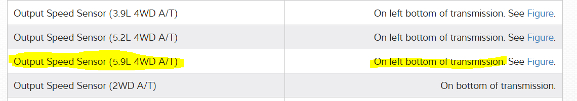

Okay I'm not sure if you are needing to know where the Output Speed Sensor or the Wheel Speed Sensor so I have included printed descriptions of where each sensor is located as well as diagrams for both of them in the diagrams down below. Please go through these guides and get back to us with how everything turns out.
Thanks,
Alex
2CarPros
Dec 30, 2020 at 11:05 AM (Merged)

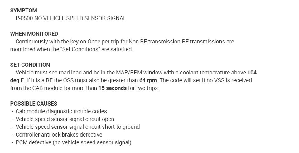

Thanks for your assistance. But I have a manual transmission. I noticed these images are for automatic transmission. Would that make any difference.
I was looking for the output speed sensor since my speedometer want working and had the P500 code.
But I cannot find anything that resembles an output speed sensor on the transmission.

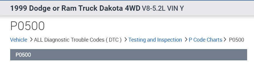

Hello again,
Okay, I don't know why I didn't do this earlier but I have just included the diagnostic troubleshooting guide from the vehicle manufacturer for DTC P0500. Please go through this guide, find the problem, fix it, and report back with what you find out.
Thanks,
Alex
2CarPros

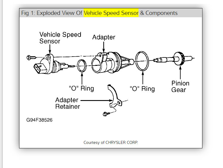

COLE3773

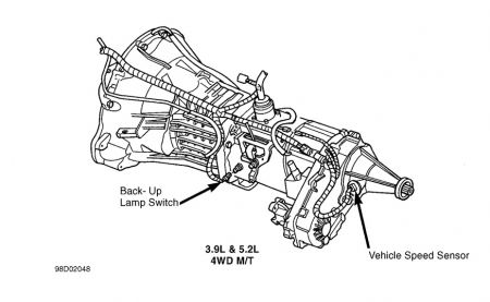

my 98 manual dakota needs a new vehicle speed sensor. i have the part but where does it go? i dont know where the vehicle speed sensor is

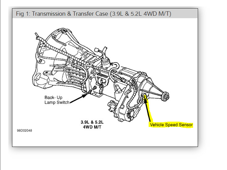

JDL
  • 16,098 POSTS
My info shows this location. Check out the diagrams (Below). Please let us know if you need anything else to get the problem fixed.
https://images.2carpros.com/forum/automotive_pictures/170934_dakota_speed_sensor_1.jpg
COLE3773
i cant find the vehicle speed sensor. i was shown this but its deffinitely not therehttp://www.2carpros.com/forum/automotive_pictures/170934_dakota_speed_sensor_1.jpg
JDL
  • 16,098 POSTS
For a 3.9--4wd--man, that diagram is what MOD showed. I'll keep looking. I couldn't get your link to work? If you stay on the original post, it is less confusing. Might you be talking about a wheel speed sensor?

COLE3773
im sure its the vss. its a manuel 1998 dakota v6. no speeddometer and tacometer. i bought the sensor and everything and checked online to make sure i have the right part and its right. i just cant find the dam thing. i looked at where the diagram said adn there was just nothing there no wire no plug. im stumped
JDL
  • 16,098 POSTS
Sometimes these databases aren't correct. I looked at some more info, it says no vss. Check rear wheel speed sensor. That sensor sends signal to abs, abs sends signal to pcm, pcm sends signal for speed. I'll try to double check. The databases are all I have to go by.
COLE3773
i pulled the code its the vss for sure and napa autoparts showed me the same diagram showing the sensor on the transfer case but im 100% positive its not there on my truck. i am very confused now. any sugestions?

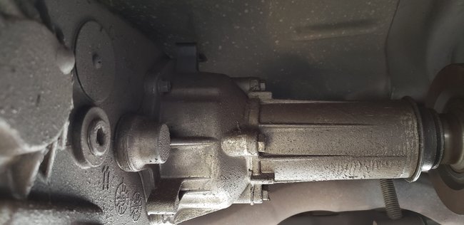

ANTH
  • 8 POSTS
[quote:7068d0ce19="drkaminski"]200 dakota, abs and brake lights are on and my speedometer only works when i get up to about 30 to 35 mph, could it be the speed sensor and if it is where is it??[/quote:7068d0ce19]
i have a 4.7 v8 dakota and my speed sensor is located on top of my dif im not sure if yours would be similar but check it out any way its the only thing on top of the diff it sticks out almost like a 02 sensor
Dec 30, 2020 at 11:06 AM (Merged)
