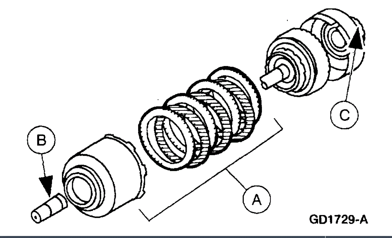

See Pic 1
The (A) reverse clutch couples the (B) input shaft to the (C) reverse sun gear. It is applied in reverse range only.

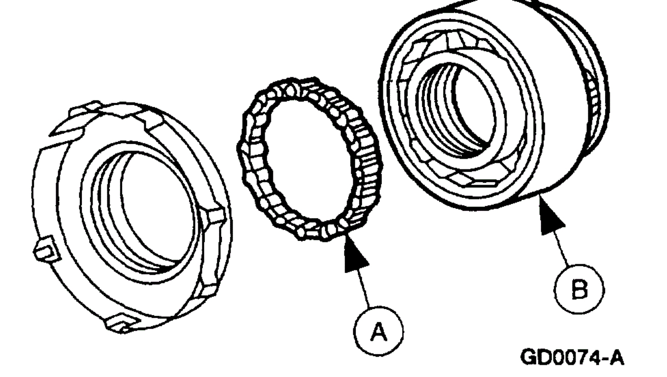

See Pic 2
The (A) planetary (low) one-way clutch is a roller clutch that holds the (B) planetary gearset in first gear, (OD), and D ranges. During automatic coasting downshifts into first gear (OD) and D ranges), it freewheels so that there is no engine braking.
