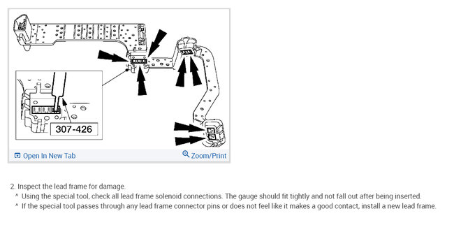

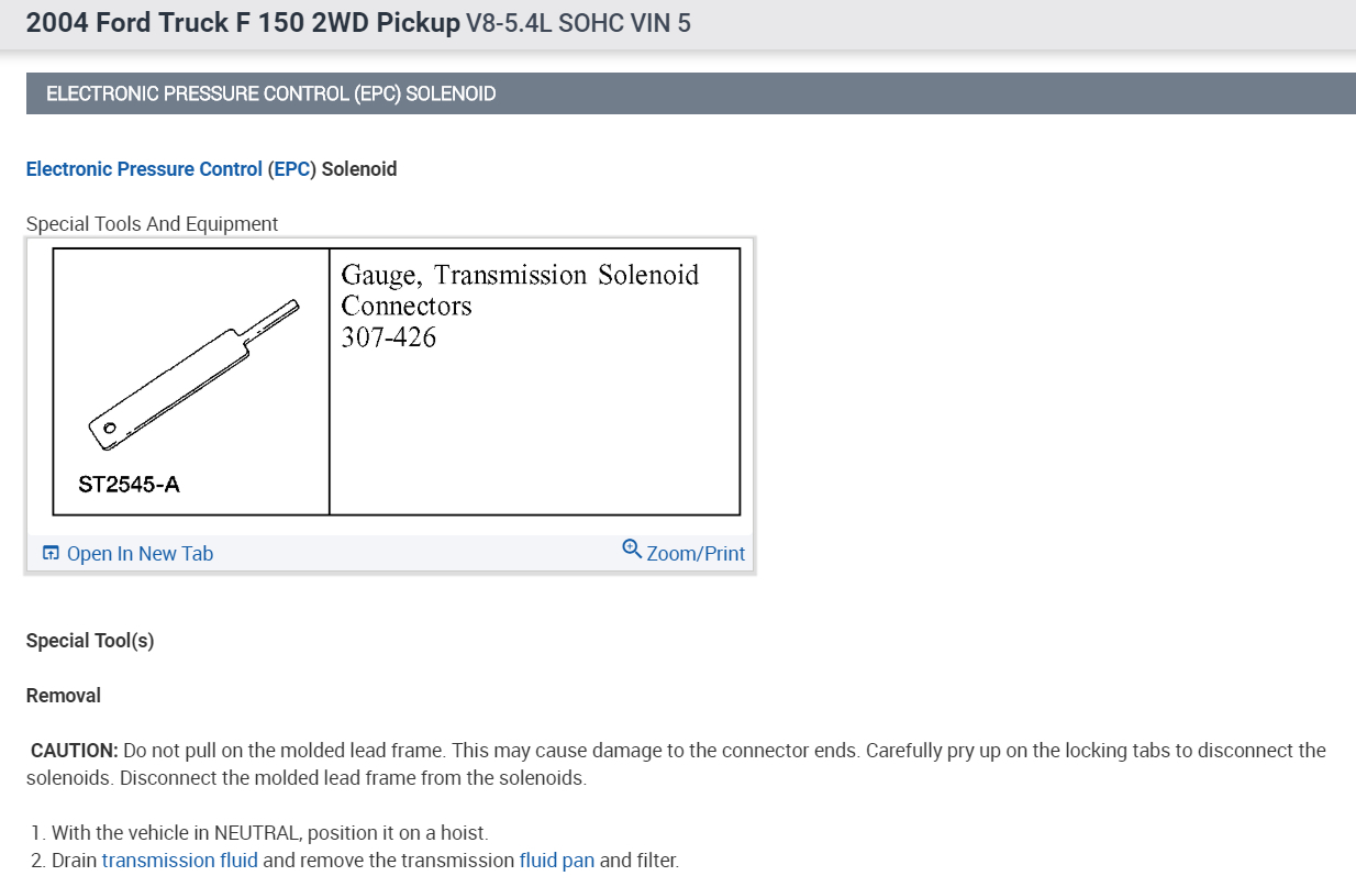

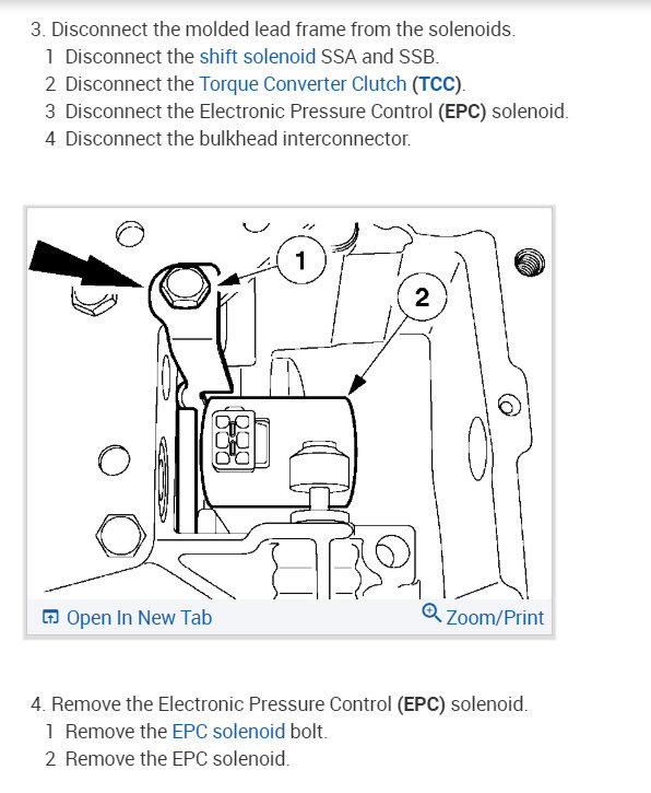

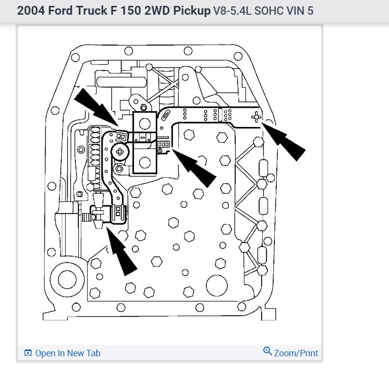

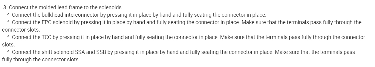

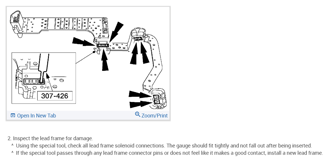

When my transmission goes into overdrive, transmission slips like it is in neutral. 1st, 2nd, and 3rd are o.k. If I shut off overdrive truck runs fine. Is this a transmission problem or is it something with a switch or computer issue ??
Oct 18, 2009 at 2:21 AM
  • 55,554 POSTS
Hey FORDQUESTION0785,

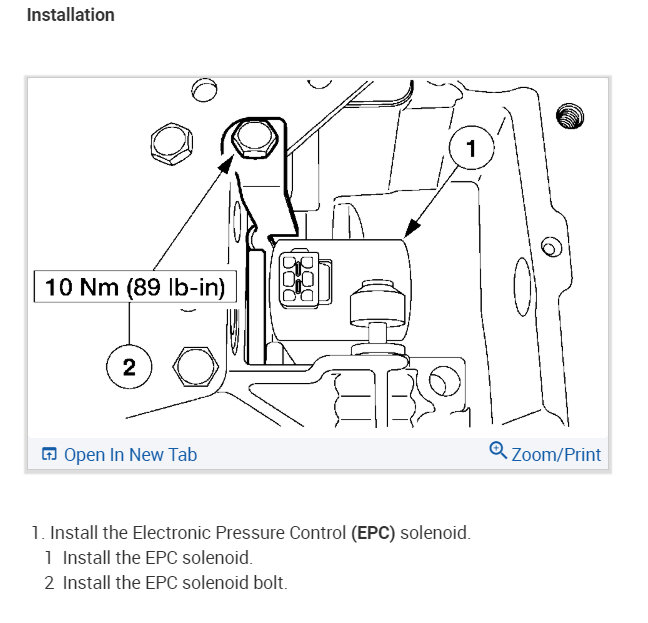

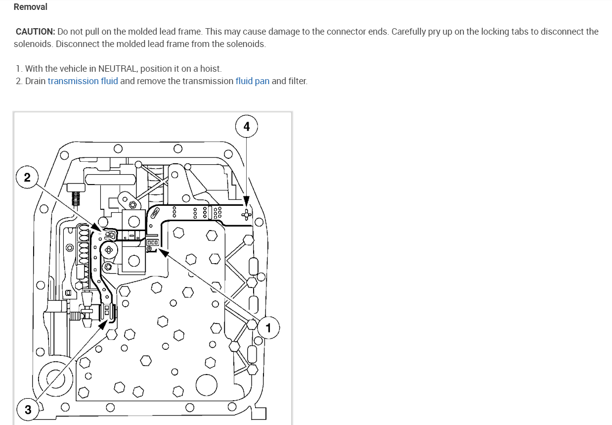

It sounds like you could have a pressure control solenoid that may be out. Here are instructions and diagrams below to show you how to replace it, if this does not work then there is a chance the transmission is going out and needs a rebuild or replacement. I would recommend a service but it is too late for that, the overdrive clutches are burned up.
If so here is a video on how to remove the transmission on a similar vehicle so you can get a rebuilt unit.
https://youtu.be/3vJAojsrfuU
Check out the diagrams (Below). Please let us know what you find. We are interested to see what it is.
