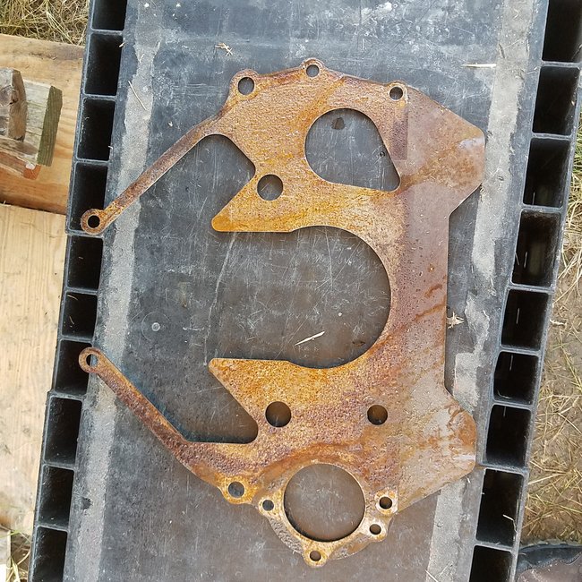

Transmission reinforcement plate
180,000 MILES • 5.4L • V8 • 4WD • AUTOMATIC
BILLY IV
Reinstalled the engine and got it all put back together and forgot to put in the reinforcement plate that goes between the flywheel and the block. And it's between the transmission and the block.. how important is having that in there?does it need to be put in or can we do without? And what is its purpose?
Jul 6, 2021 at 10:47 PM
STEVE W.
  • 15,414 POSTS
It is an important part as it does a few things, it acts as a shim to space the converter away from the front pump in the transmission to prevent damage to the pump, it acts as a starter shim to help position the pinion on the ring gear as well. It's last purpose is to cover the opening in the bell-housing between the engine and transmission to keep dirt and junk out of the bell housing.
Jul 7, 2021 at 12:12 AM
BILLY IV
I thought of all those reasons also but really didn't want to pull apart to put it in. i greatly appreciate your prompt an informative response, and you guys have definitely made a new fan. Thank you very much.
Jul 7, 2021 at 3:20 AM
STEVE W.
  • 15,414 POSTS
You're welcome. The only one I really would worry about is damaging the transmission if the converter is in the front of the pump too deep as even an eighth of an inch can cause issues. As for pulling it all apart, you could cut the tops out of the bolt bosses, loosen the bolts and slip it into place after you pull the starter out. That would also allow it to be removed easier if needed. Just be sure that all of the plate is used, because of the way it's made if you only installed the lower section it could create an angle between the transmission and block that would but stress on the flexplate, input shaft and internals.
