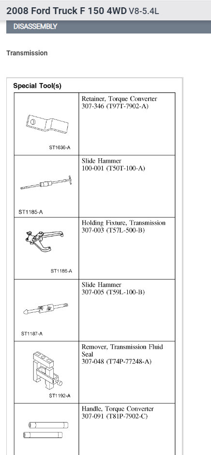

How do I do a complete rebuild of my transmission?
200,000 MILES • 5.4L • V8 • 2WD • AUTOMATIC
ARIANADANIELLE5345
  • 402 POSTS

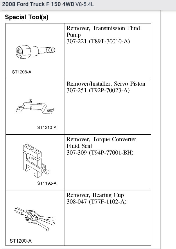

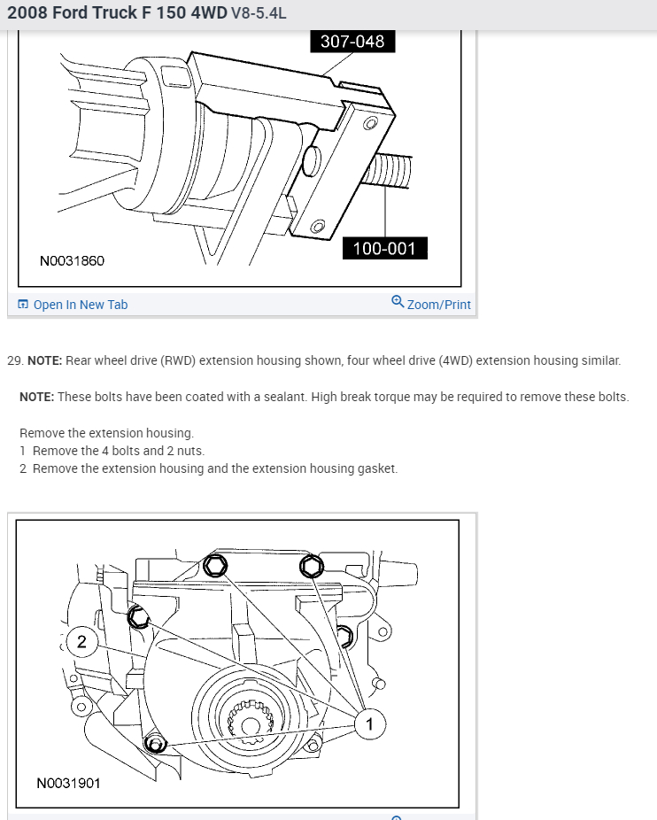

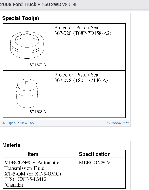

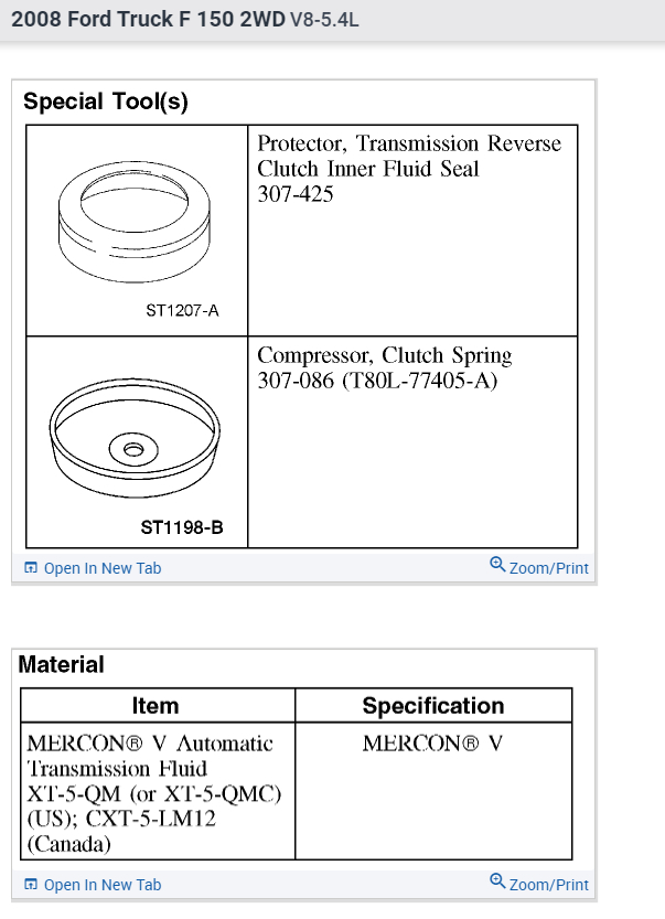

And what parts should the rebuild kit include? Will I need any special tools?
Jun 10, 2022 at 12:57 AM
SQM
  • 6,383 POSTS

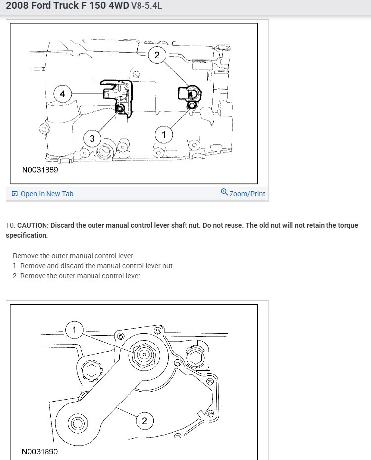

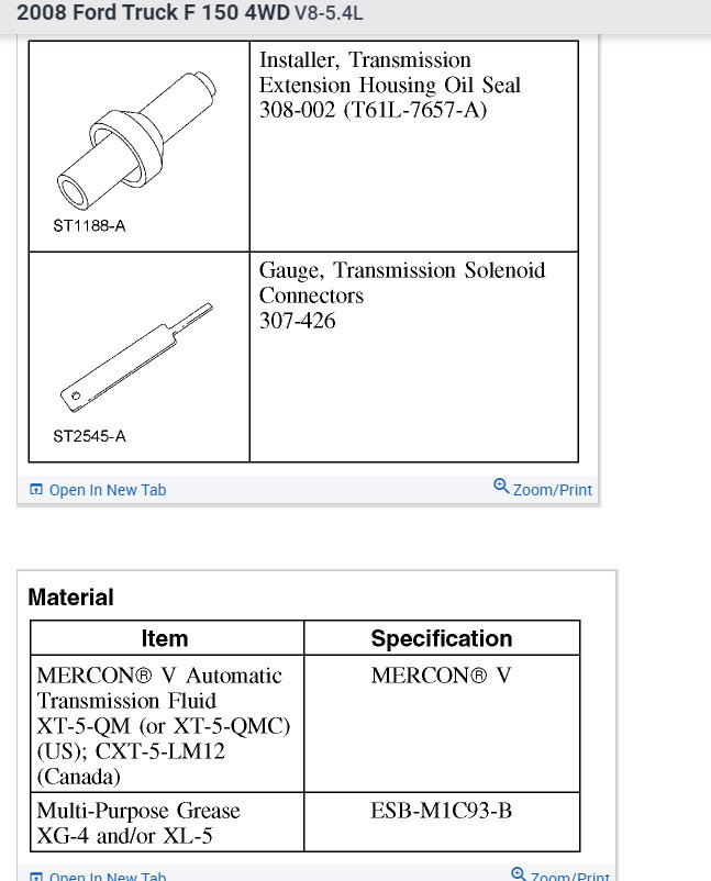

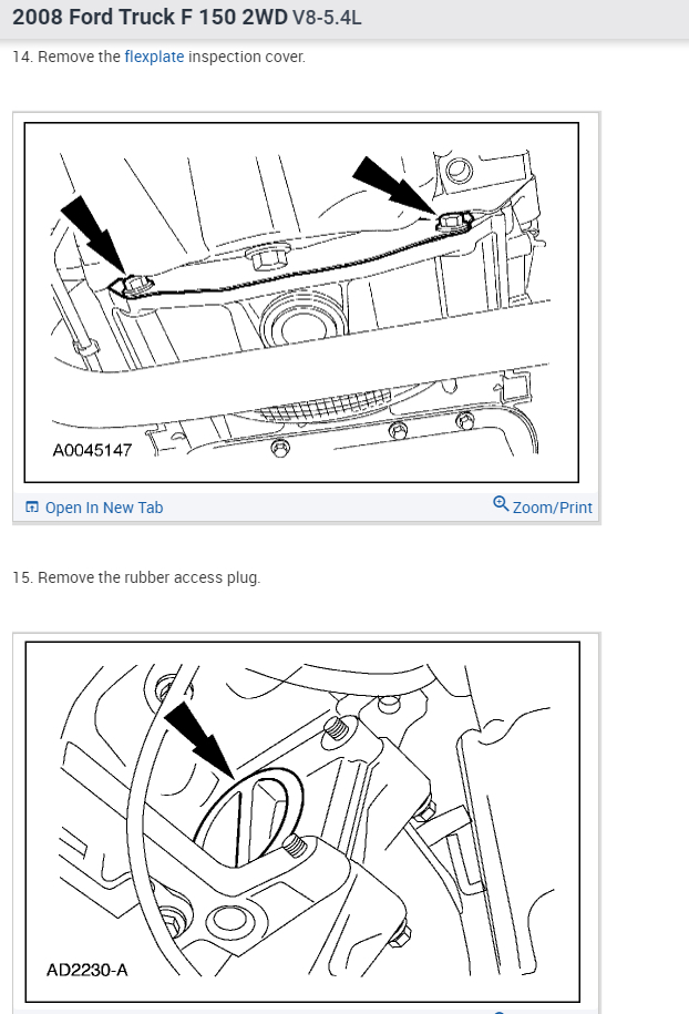

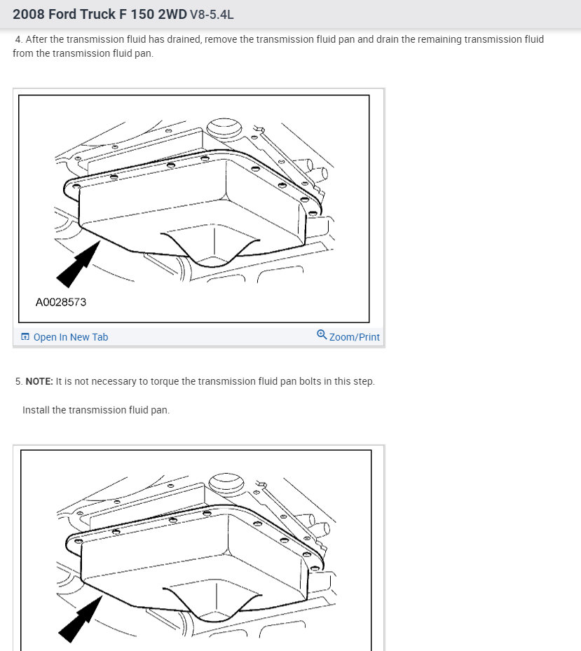

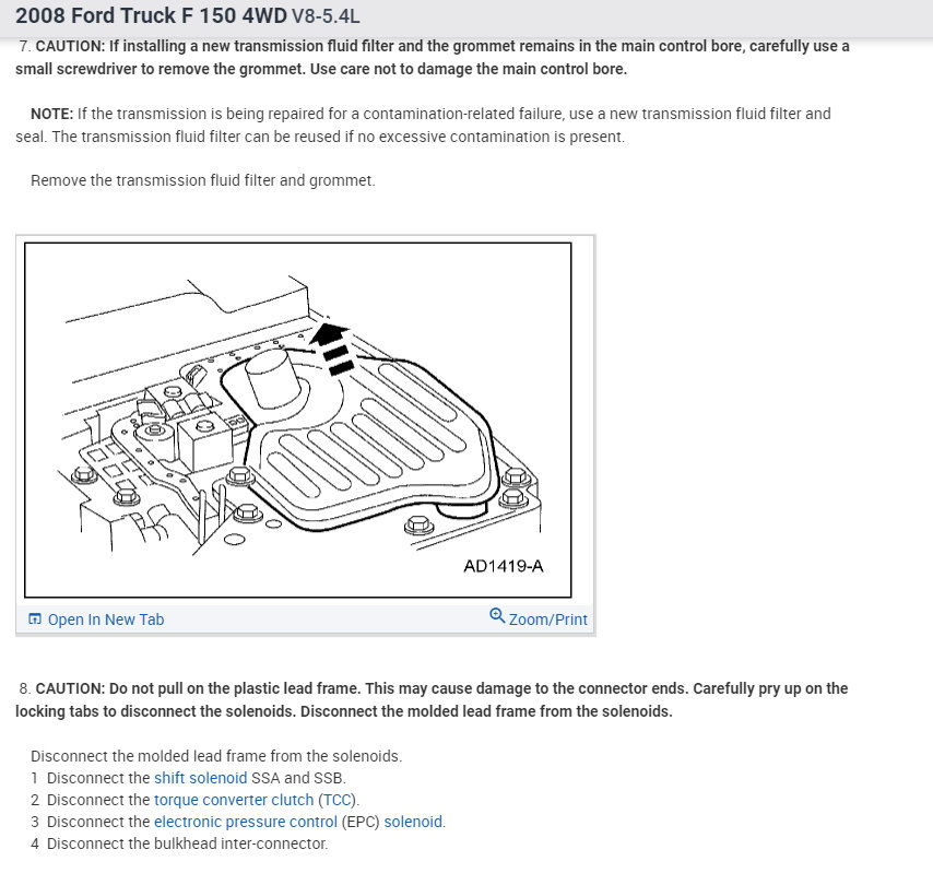

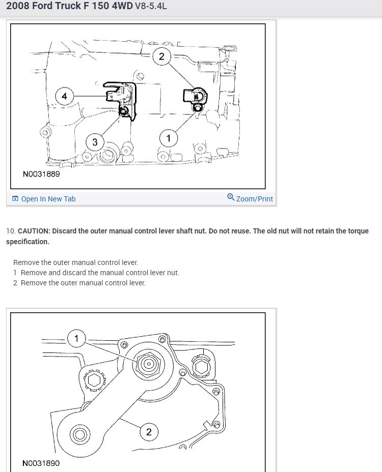

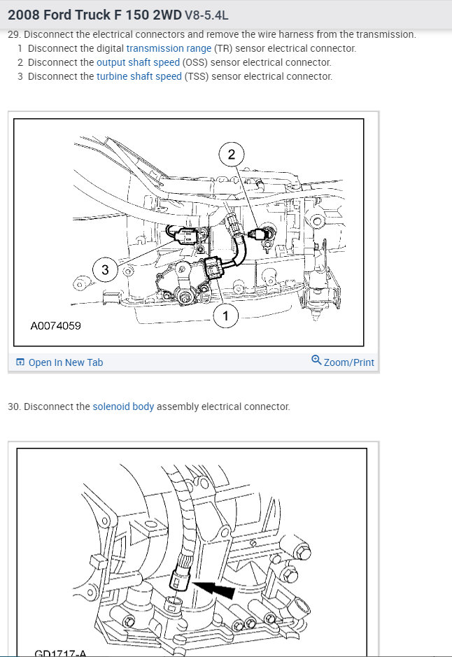

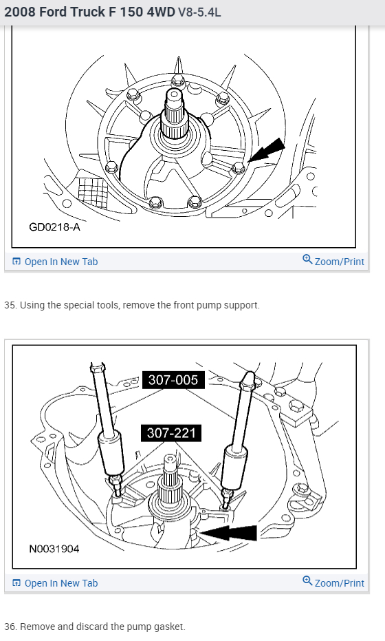

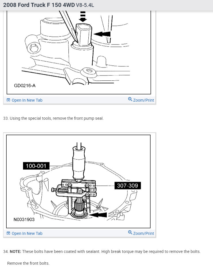

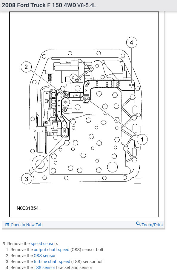

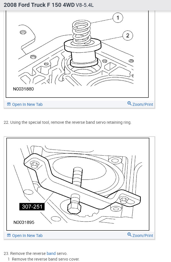

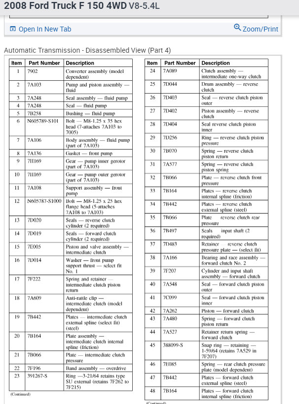

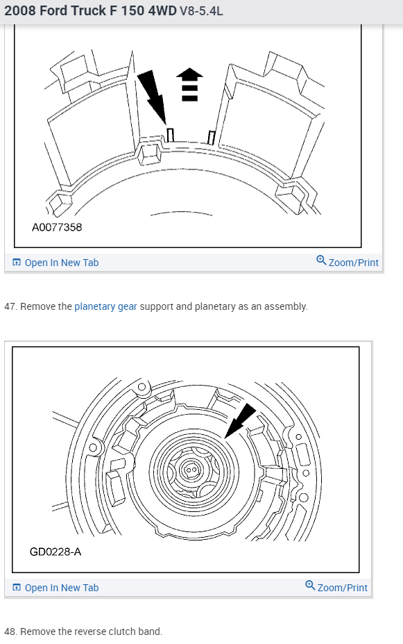

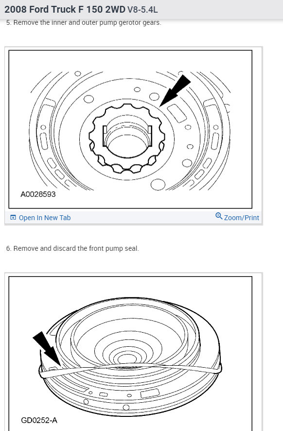

There are many components that can be replaced during a transmission rebuild, depending on the issue at hand.
A typical rebuild includes all the gaskets, seals, gears and solenoids and other typical worn items. Also, the filter and any screens that go inside the transmission.
So, it will all depend on what issue you are trying to fix.

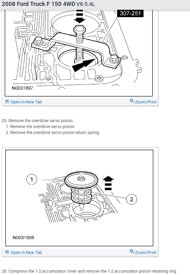

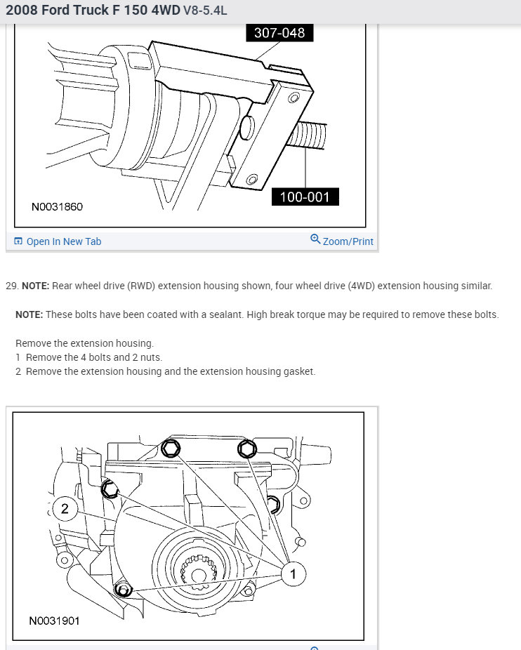

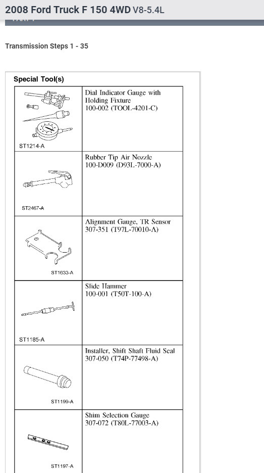

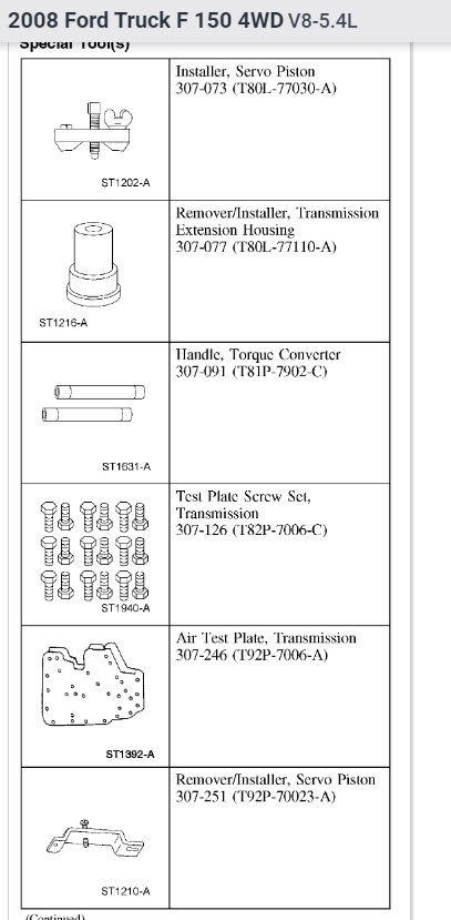

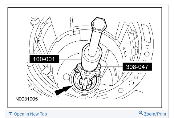

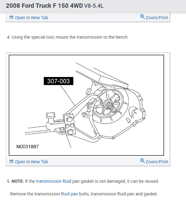

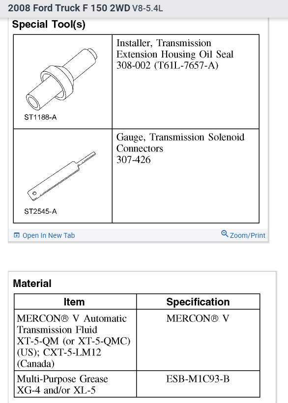

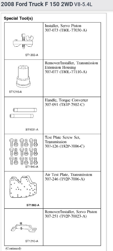

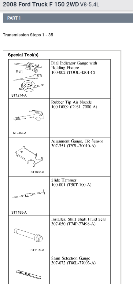

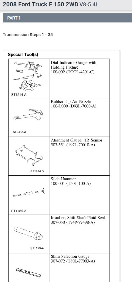

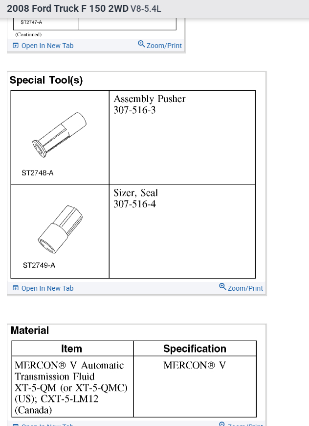

There are a few special tools that you will need to get this done.

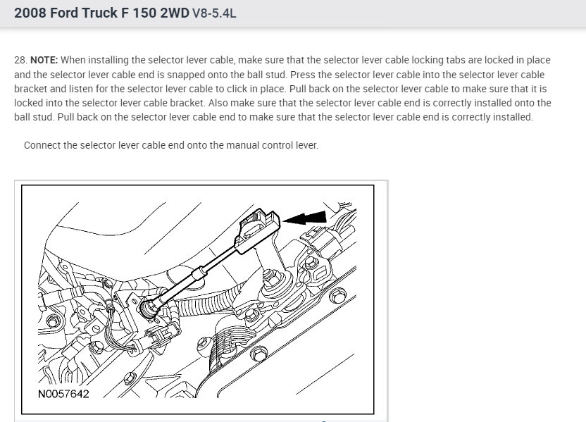

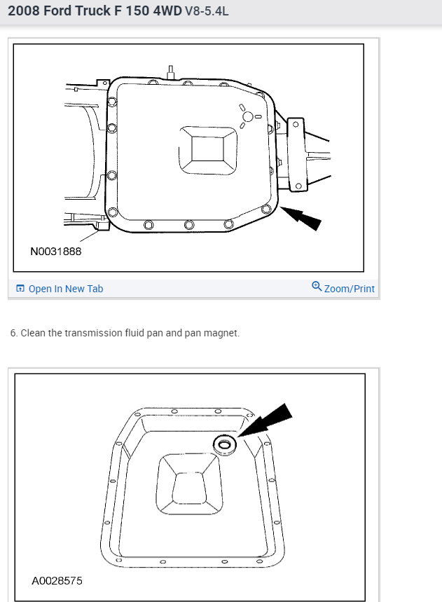

Look below for all the special tool requirements and I have attached transmission disassembly instructions below for your reference.
If you are looking for any specific part disassembly and reassembly just let me know.
https://www.2carpros.com/articles/how-to-remove-an-automatic-transmission-rwd

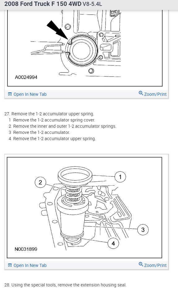

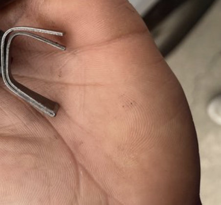

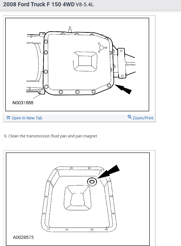

Well, the original issue was it would slip everything you got above 3,000 RPMs, but when I dropped the pan and valve body not only was there thick gray stuff in there, but a piece fell out that the guys from the Ford service dept told me is from something that’s behind the pump and the only way to get to it is by disassembling the transmission and that I may as well rebuild it if I take it apart. They also said I’ll need a TC.
Jun 10, 2022 at 4:22 AM
SQM
  • 6,383 POSTS
Do you have any pictures of the part that fell out?
Jun 10, 2022 at 5:54 AM
ARIANADANIELLE5345
  • 402 POSTS
Yes.
Jun 10, 2022 at 11:18 PM
SQM
  • 6,383 POSTS

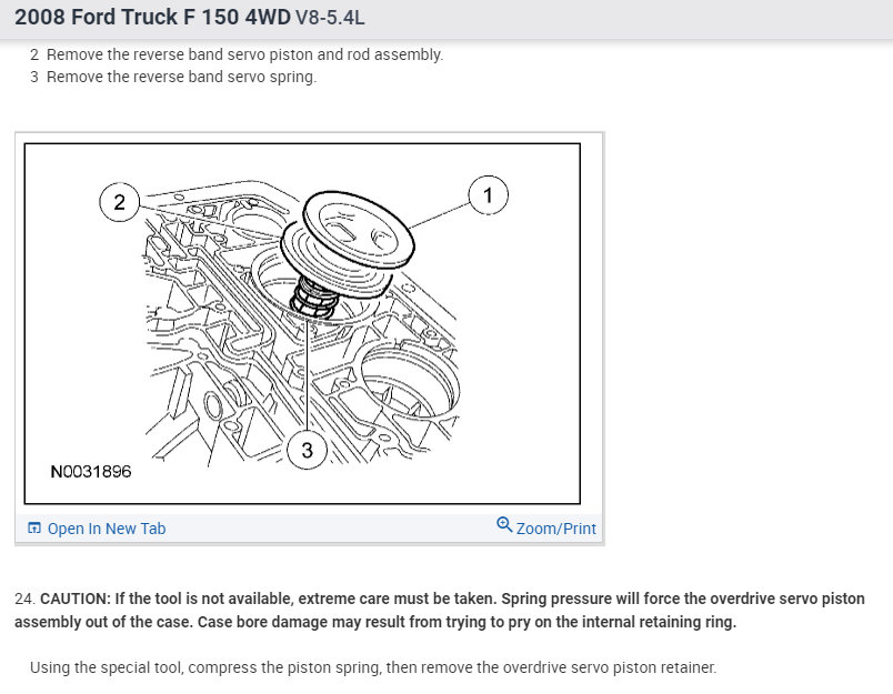

It looks like a retainer but deformed. Can you tell where it possibly came out of? Check the valve body retainers for the valves.
Jun 11, 2022 at 3:40 PM
ARIANADANIELLE5345
  • 402 POSTS
After a lot of searching, I finally found out what it’s called. Anti-clunk spring.
Jun 12, 2022 at 2:20 AM
ARIANADANIELLE5345
  • 402 POSTS
So, do I have to rebuild it, or can I just replace the anti-clunk spring? I was told that the reason those fail are a worn transfer case or something like that so I’ll change the case too.

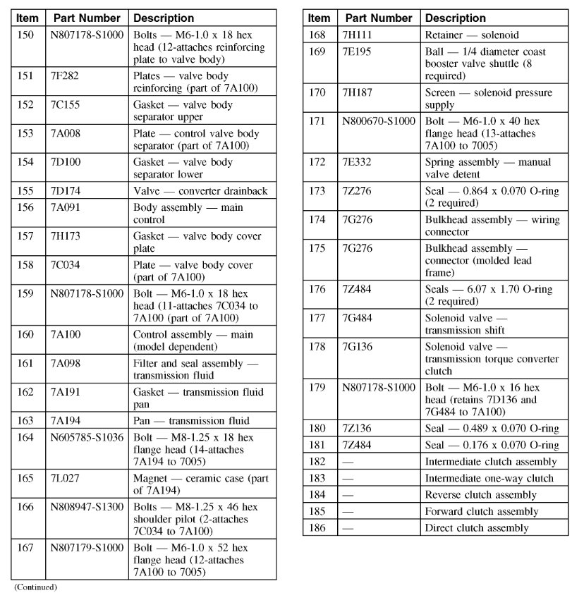

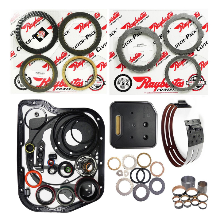

You mentioned that you have issues with slipping, which could be due to worn gear and or torque converter. So, a rebuild of those components is likely.
You want to get a rebuilt kit that has all the regular components, like the picture below.
Jun 12, 2022 at 5:18 AM

One thing you can do is to install a new spring and see the fitment. If it is loose, then the case will need to be replaced. That way you are taking action based on what is required.

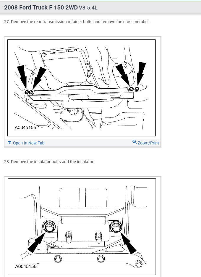

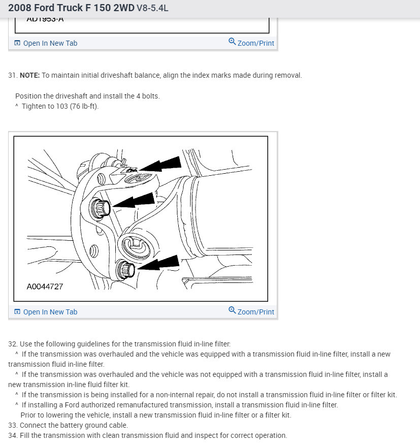

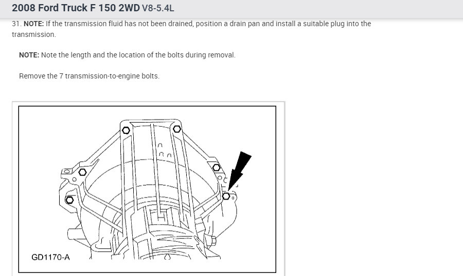

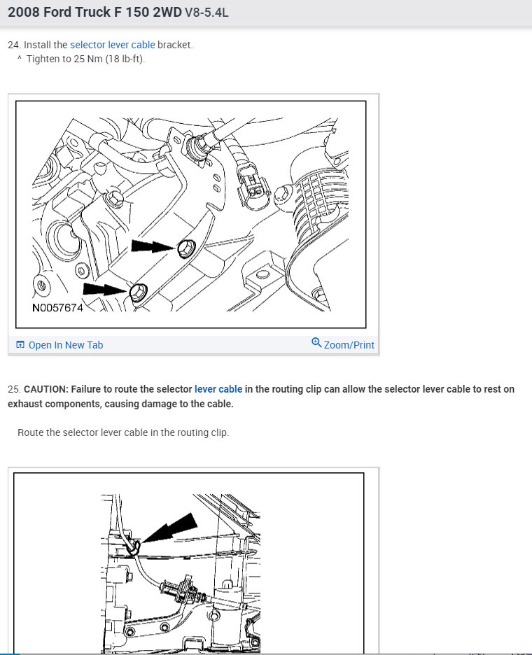

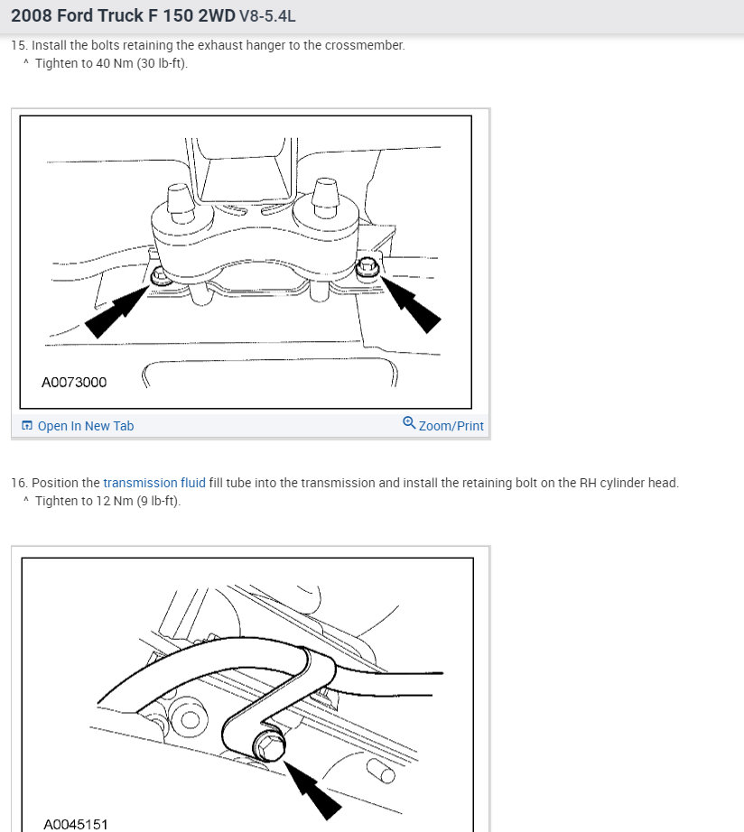

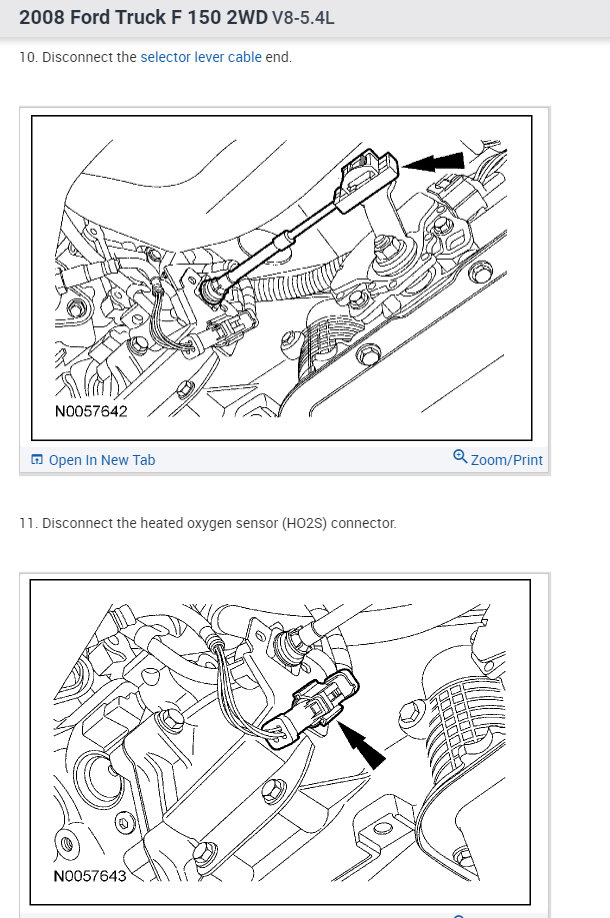

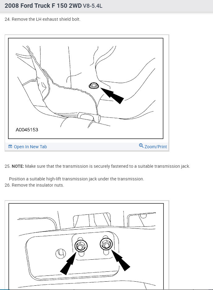

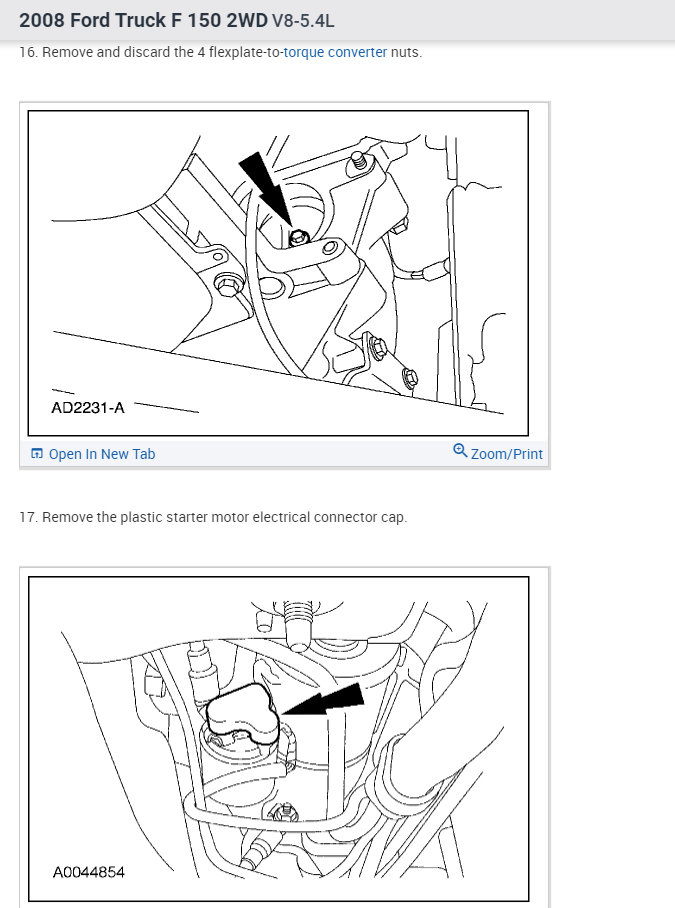

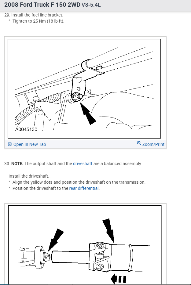

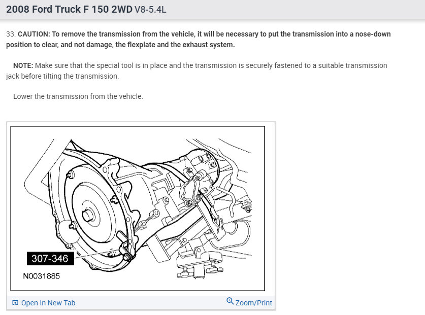

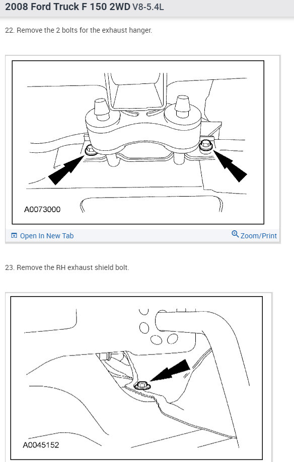

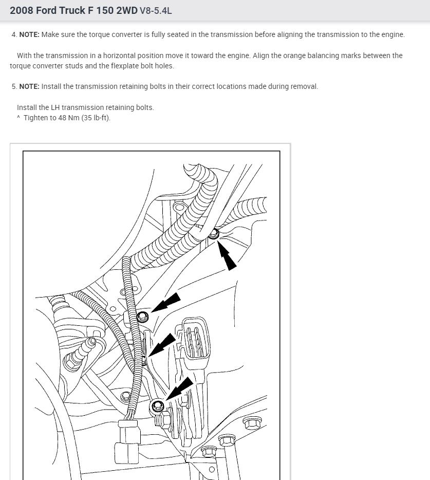

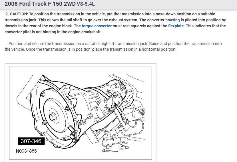

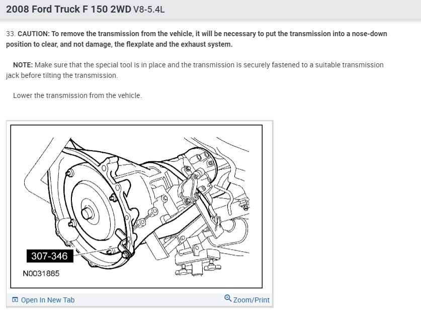

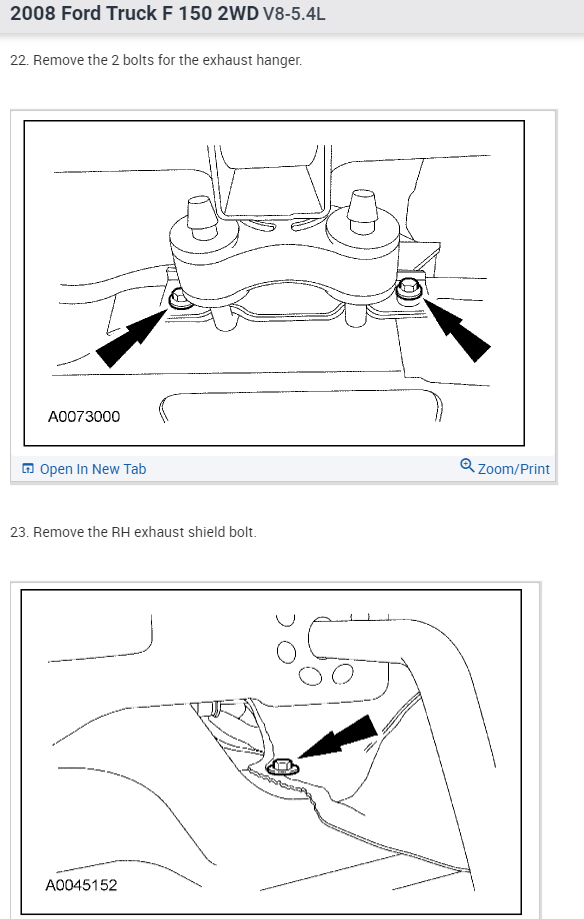

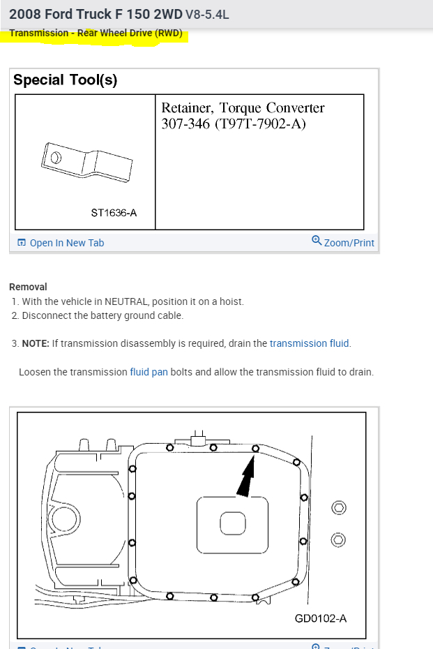

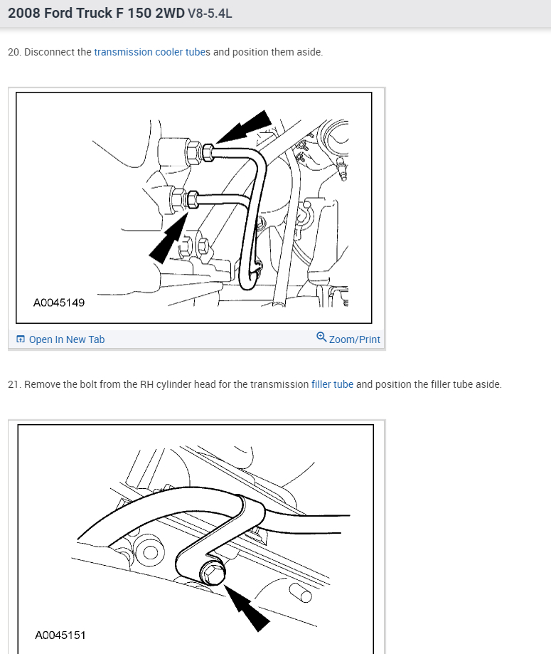

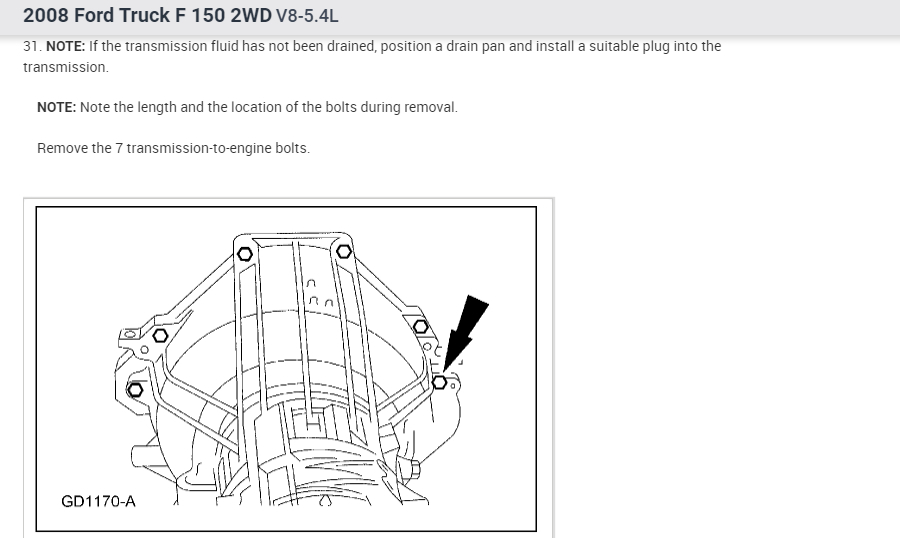

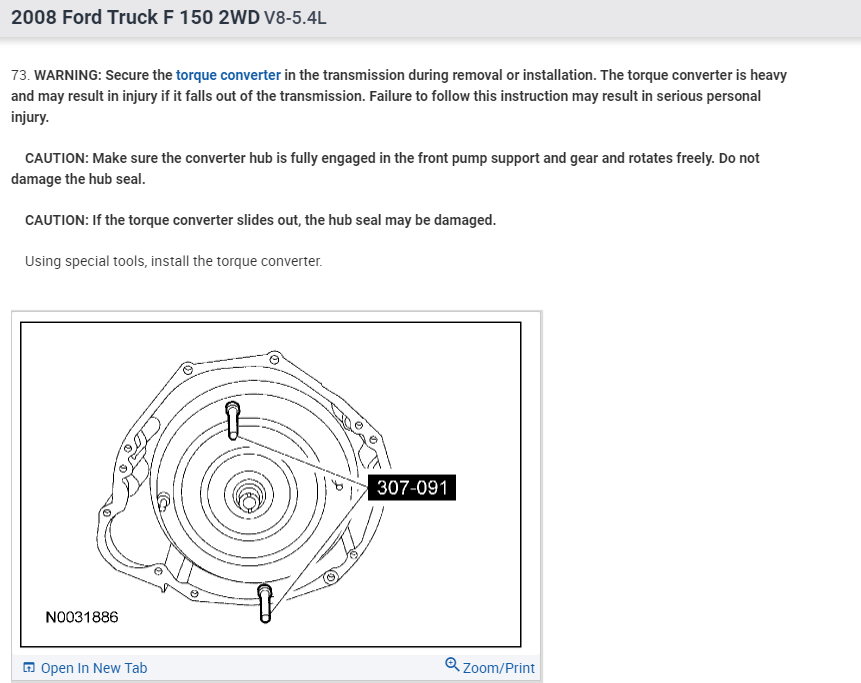

How do I drop the transmission?
Jun 15, 2022 at 3:51 AM
ARIANADANIELLE5345
  • 402 POSTS
What I meant was, is there a way without having to remove the exhaust because I’m having trouble getting a couple of the exhaust bolts off.
Jun 15, 2022 at 3:53 AM
SQM
  • 6,383 POSTS

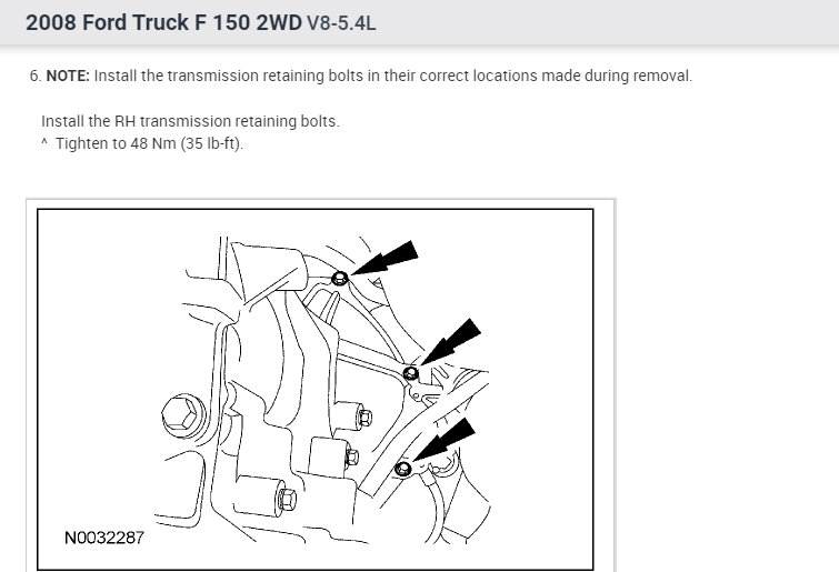

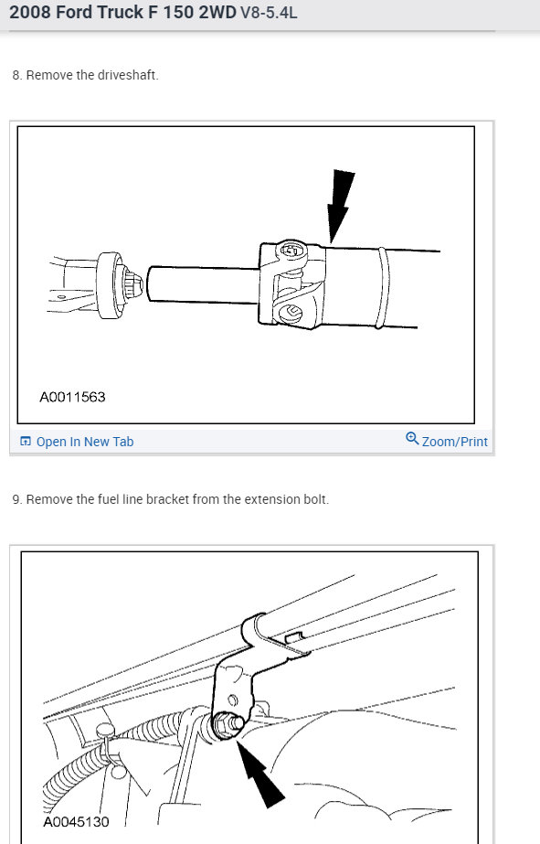

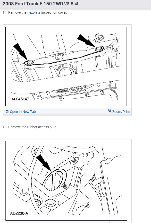

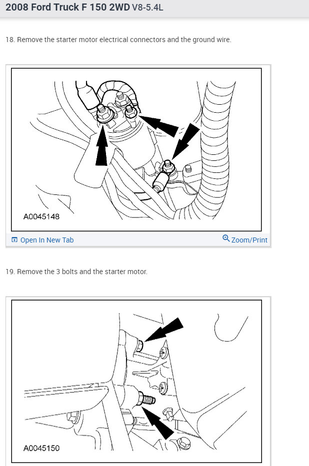

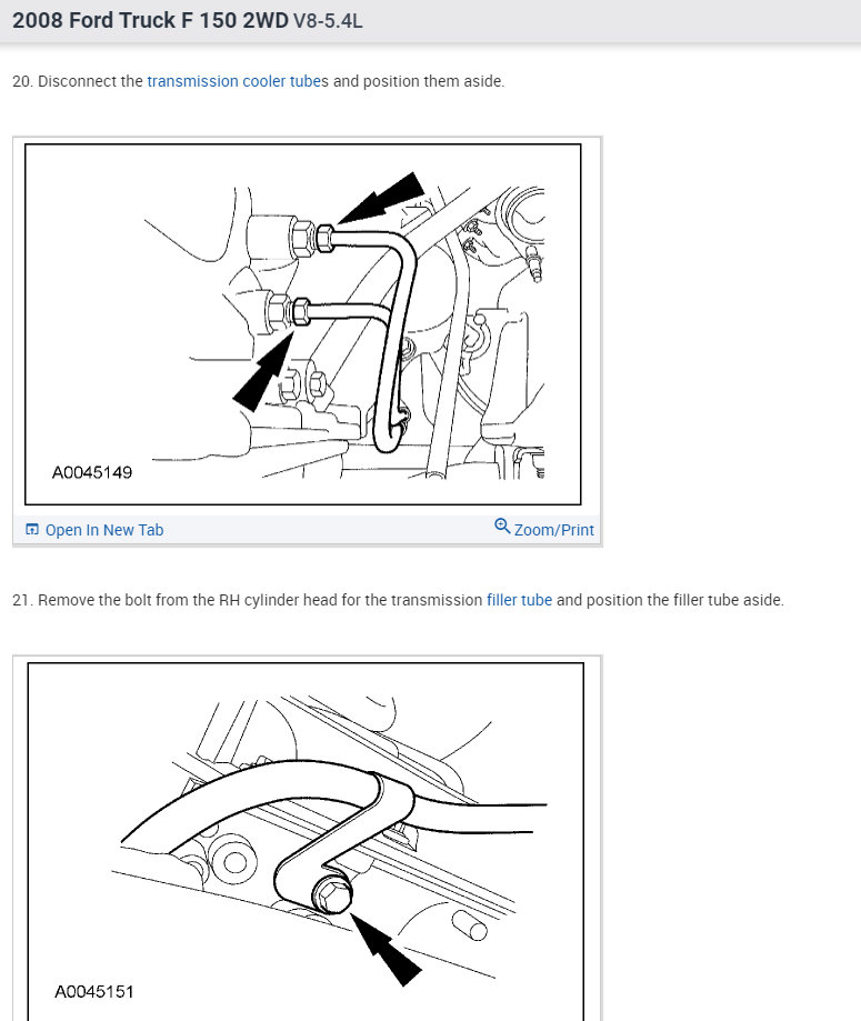

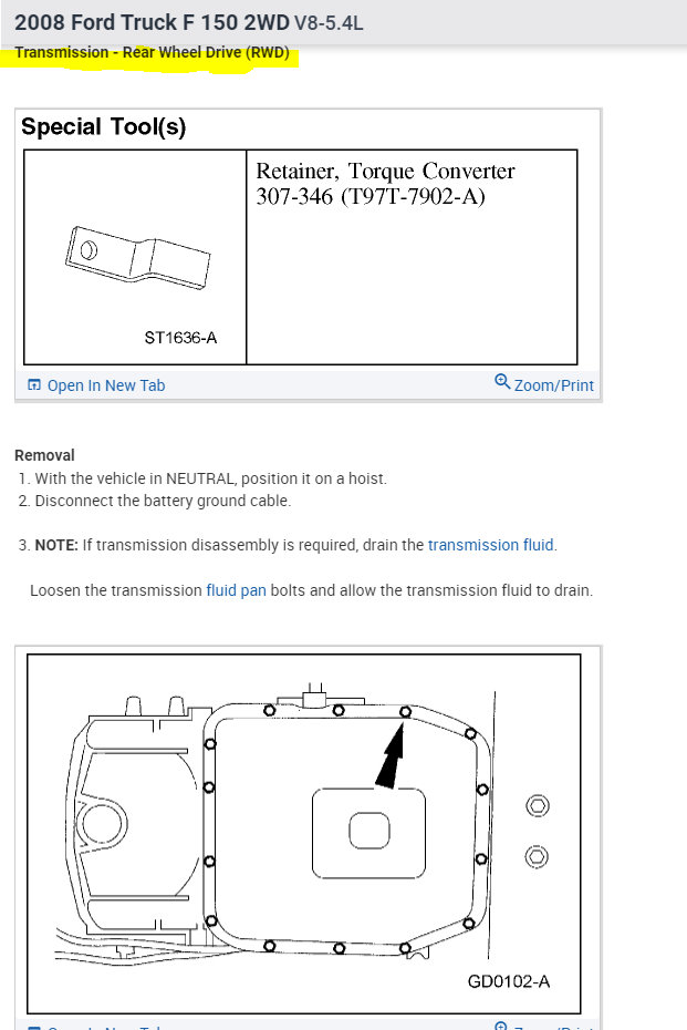

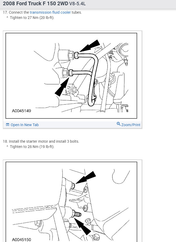

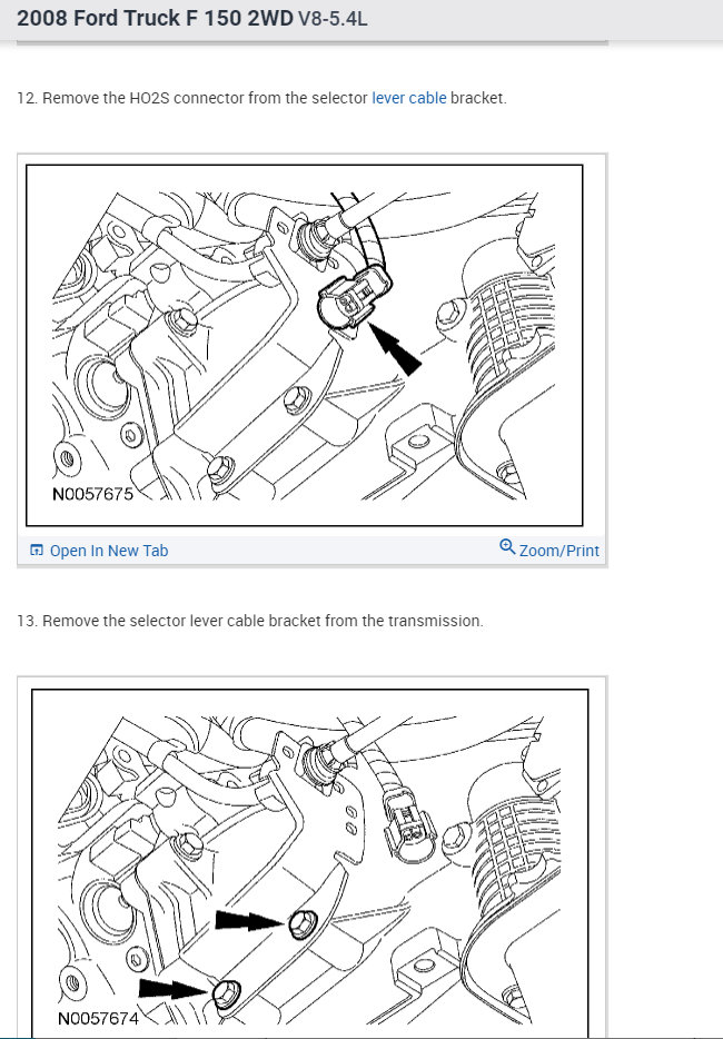

You should be able to remove the exhaust hanger bolts, that will give you enough room.

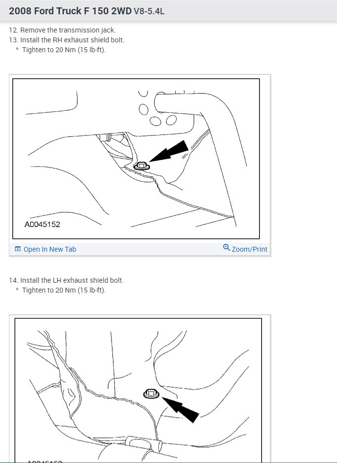

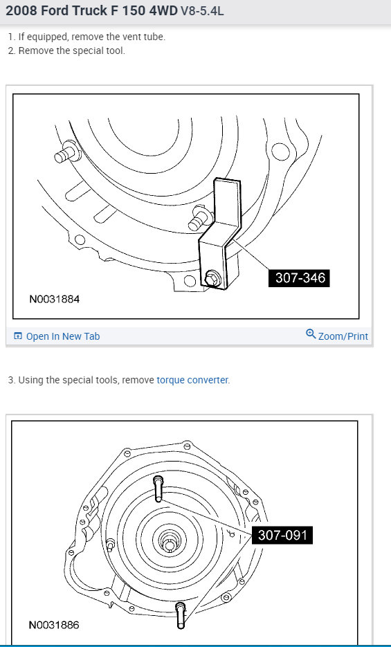

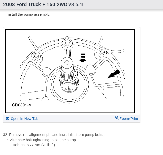

I went ahead and attached the transmission replacement procedure below for your reference.
Jun 15, 2022 at 5:42 AM

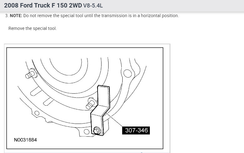

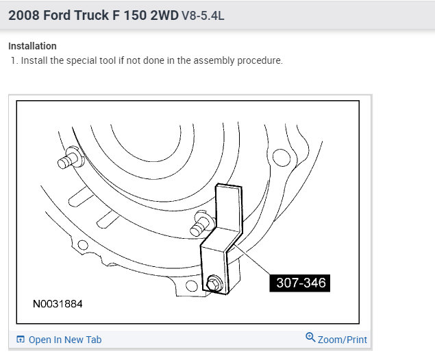

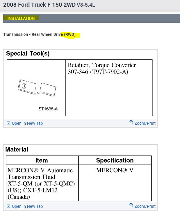

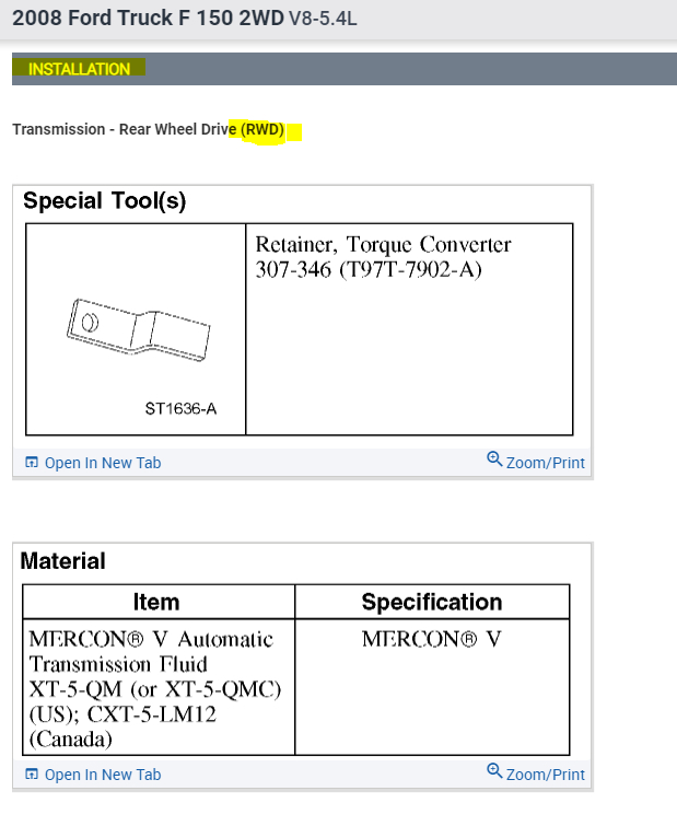

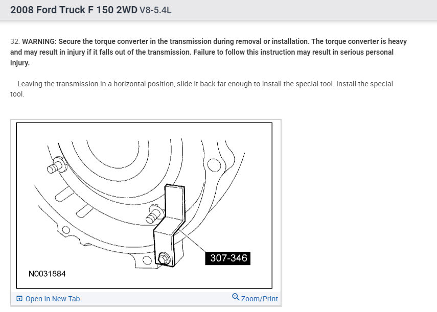

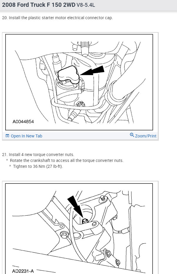

ARIANADANIELLE5345

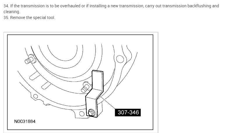

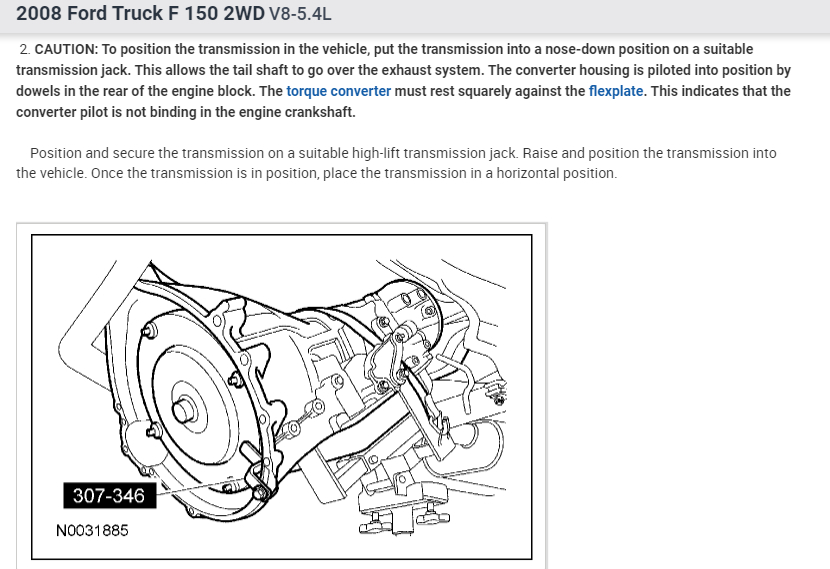

  • 402 POSTS

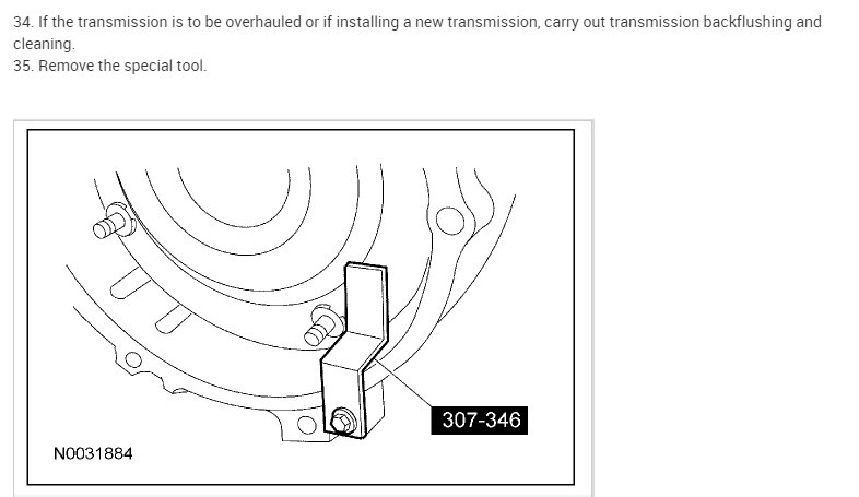

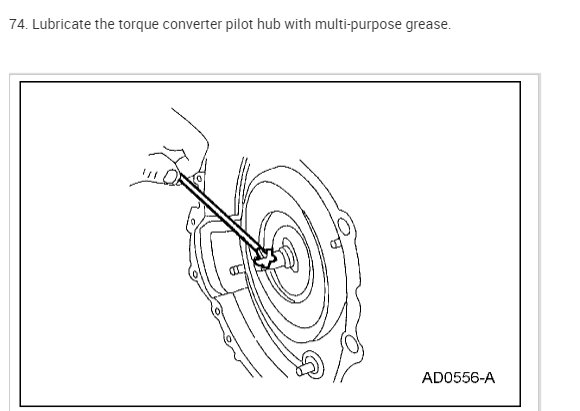

I don’t have that tool. So, can I just bolt a chain across it mounting it where the bell housing bolts go and using nuts on the other side? Or do I really need that tool?
Jun 15, 2022 at 6:27 AM
SQM
  • 6,383 POSTS
The retainer just keeps the converter in place. So as long you can do it any other method it will be fine.
Jun 15, 2022 at 7:08 AM

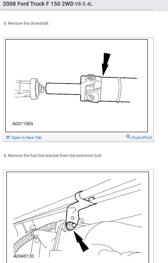

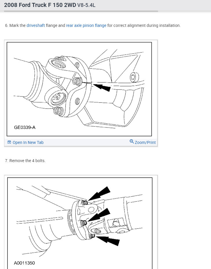

I’m having a really hard time trying to separate the rear driveshaft from the differential. Can I just leave it on and undo the center support bearing and pull the front driveshaft out of the tranny and leave it like that on stands or something?
Jun 16, 2022 at 4:53 AM
SQM
  • 6,383 POSTS
Yes, it might make it little tricky to keep it on a stand. But you should be able to get the job done.

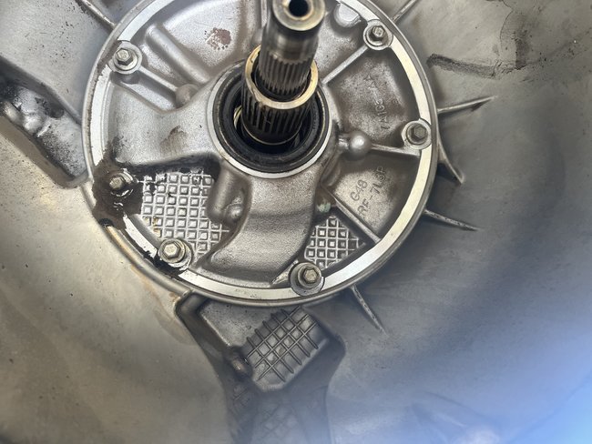

ARIANADANIELLE5345
  • 402 POSTS

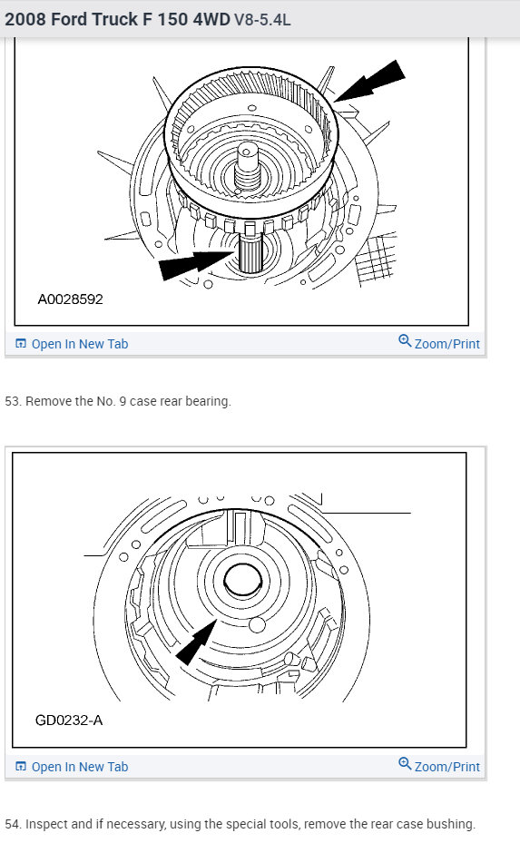

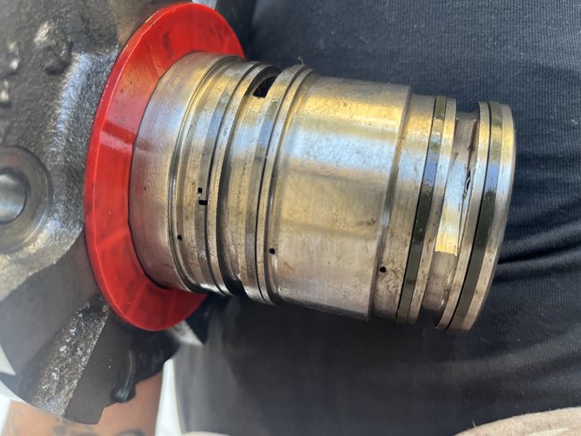

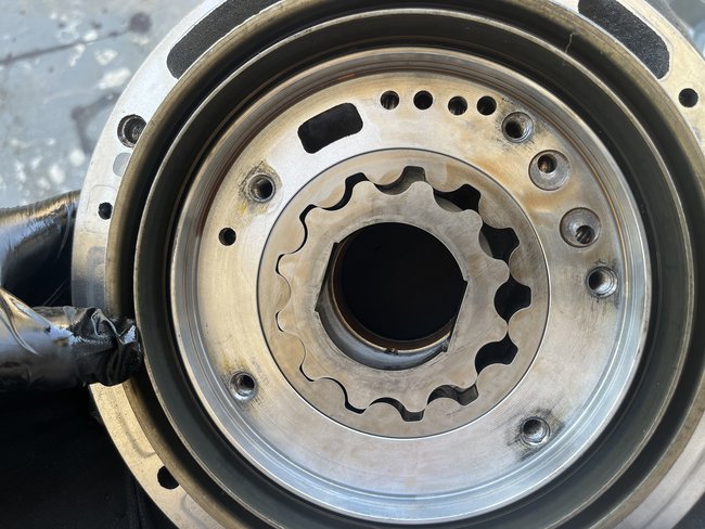

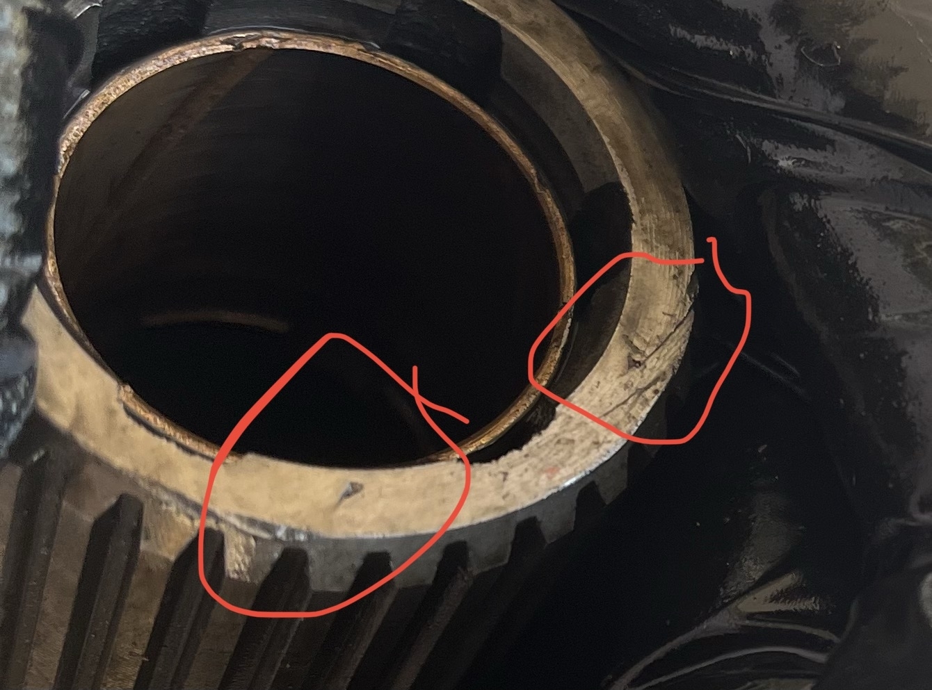

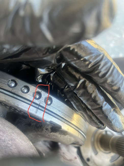

I don’t really know what to look for. I’ll post some pics. Only thing i found were the scratches I circled in the last pic.
Jun 18, 2022 at 4:06 AM
ARIANADANIELLE5345
  • 402 POSTS

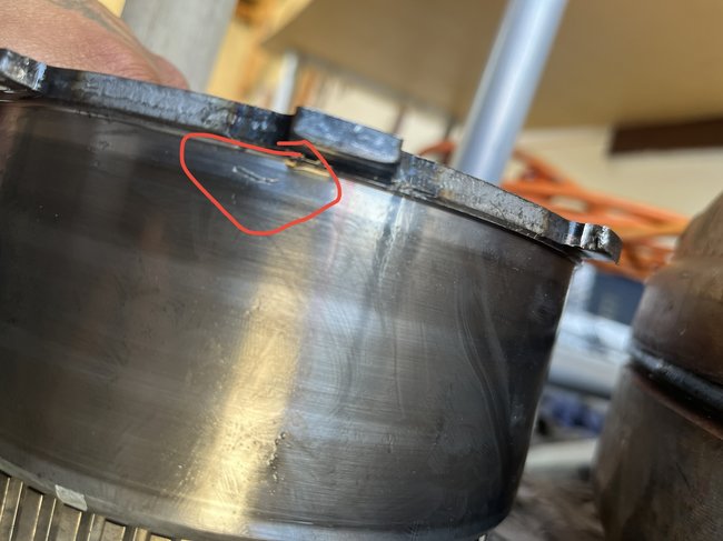

And this. There was a tiny piece of metal stuck where that gouge is.
Jun 18, 2022 at 4:11 AM
ARIANADANIELLE5345
  • 402 POSTS
My fingernail catches in those circle scratches.
Jun 18, 2022 at 4:14 AM
ARIANADANIELLE5345
  • 402 POSTS

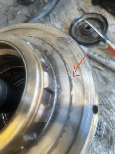

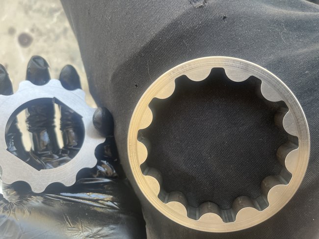

There are a couple of these around this part.
Jun 18, 2022 at 5:38 AM

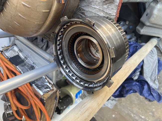

ARIANADANIELLE5345
  • 402 POSTS
Maybe this is the issue.
Jun 18, 2022 at 5:51 AM
SQM
  • 6,383 POSTS
Well, for the most part these components have typical wear due to mileage, not really jumps out of being 'the' issue. The last picture could be the cause of concern.
Jun 18, 2022 at 12:14 PM
ARIANADANIELLE5345
  • 402 POSTS
So just a complete rebuild?
Jun 18, 2022 at 12:44 PM
SQM
  • 6,383 POSTS
That is probably your best option. That way you know you covered all typical worn items.

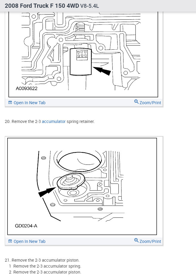

  • 402 POSTS

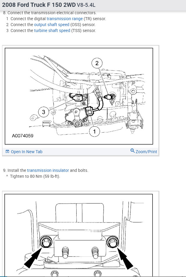

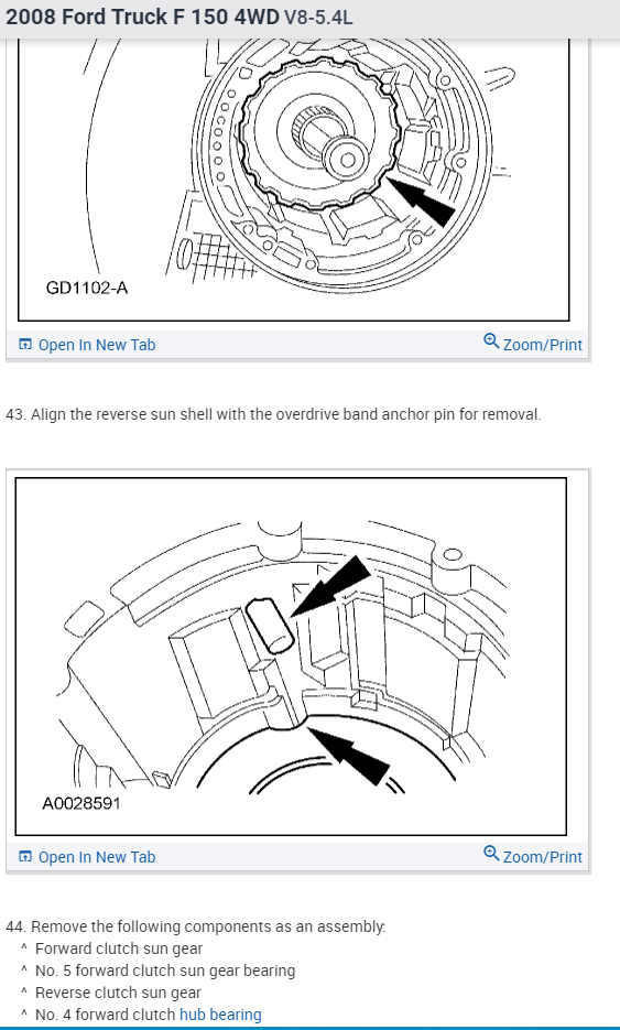

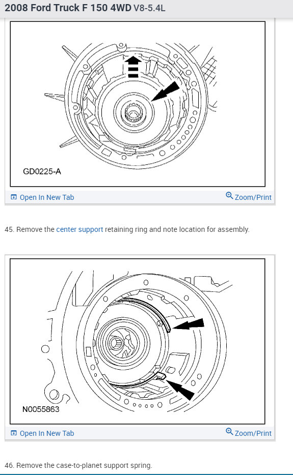

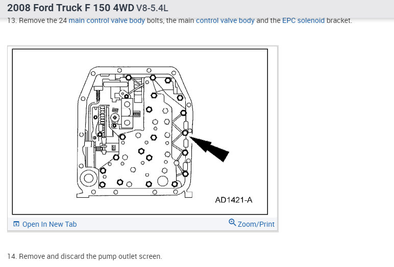

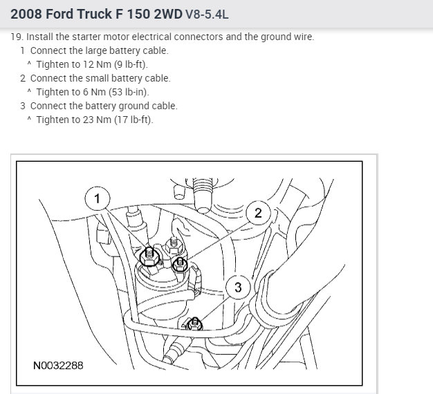

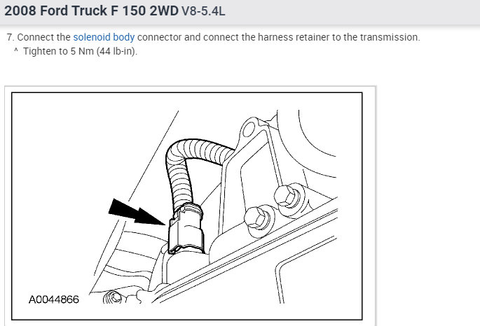

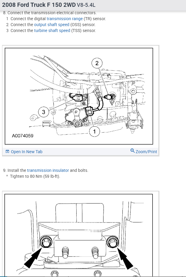

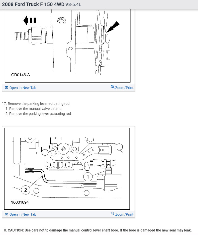

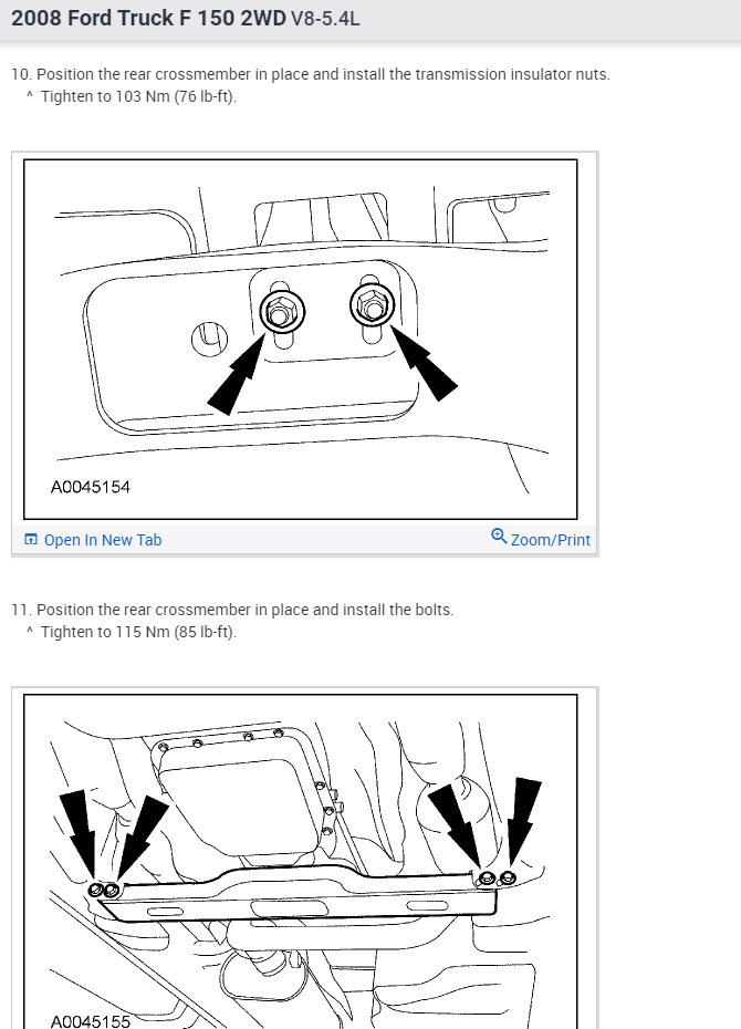

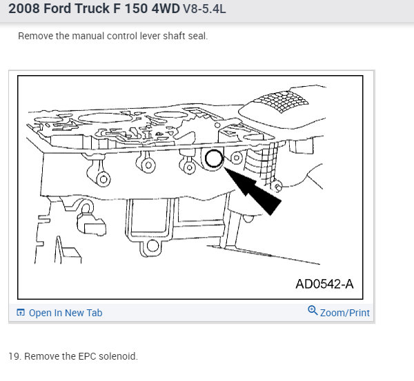

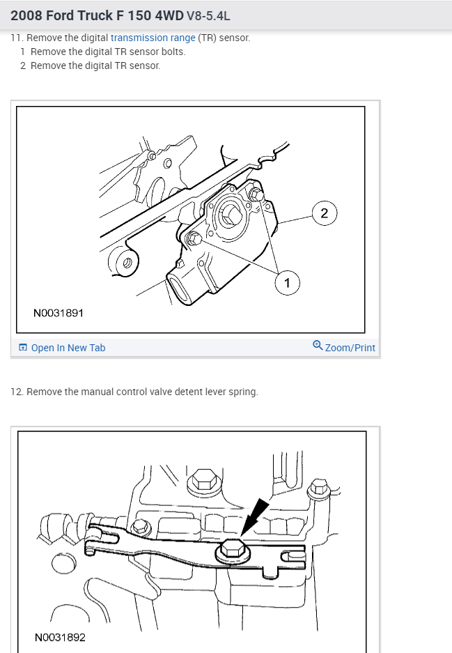

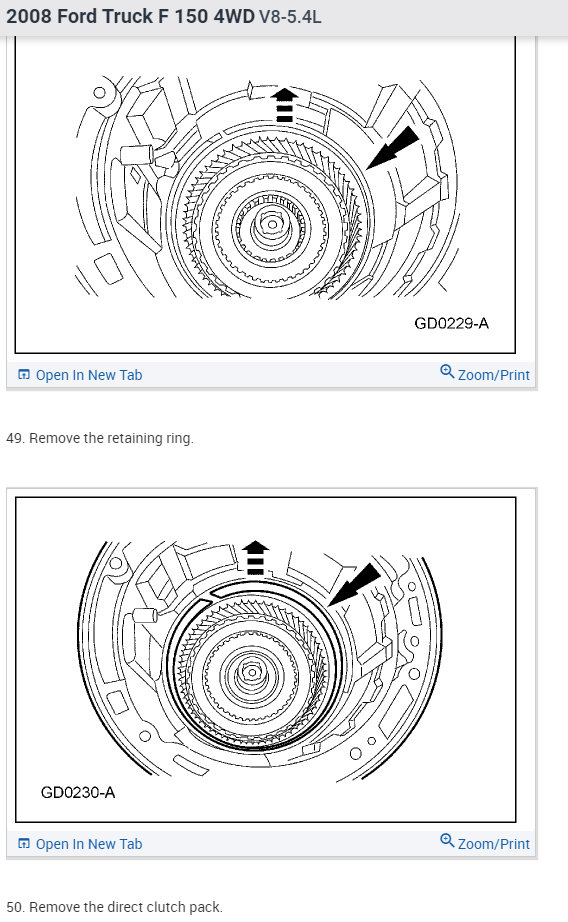

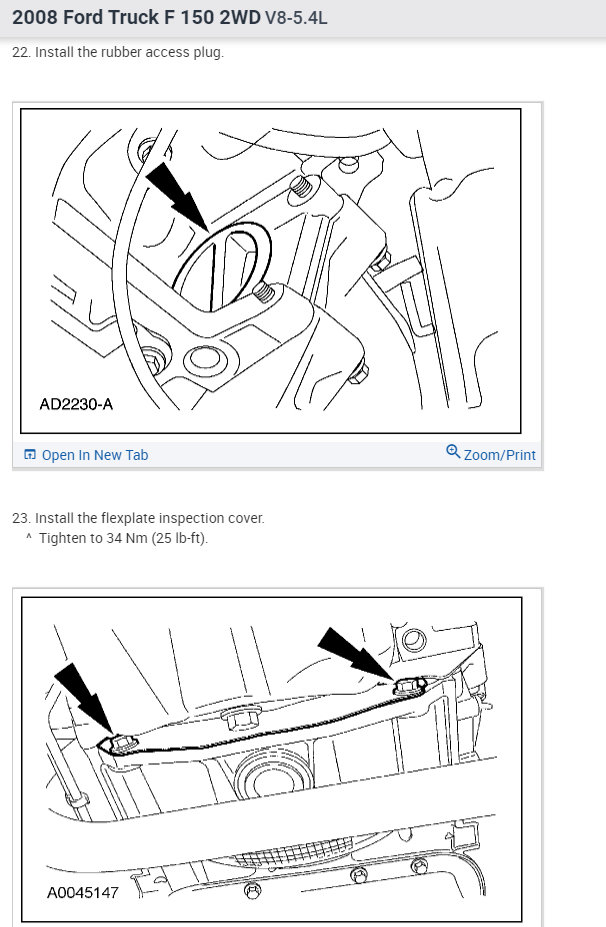

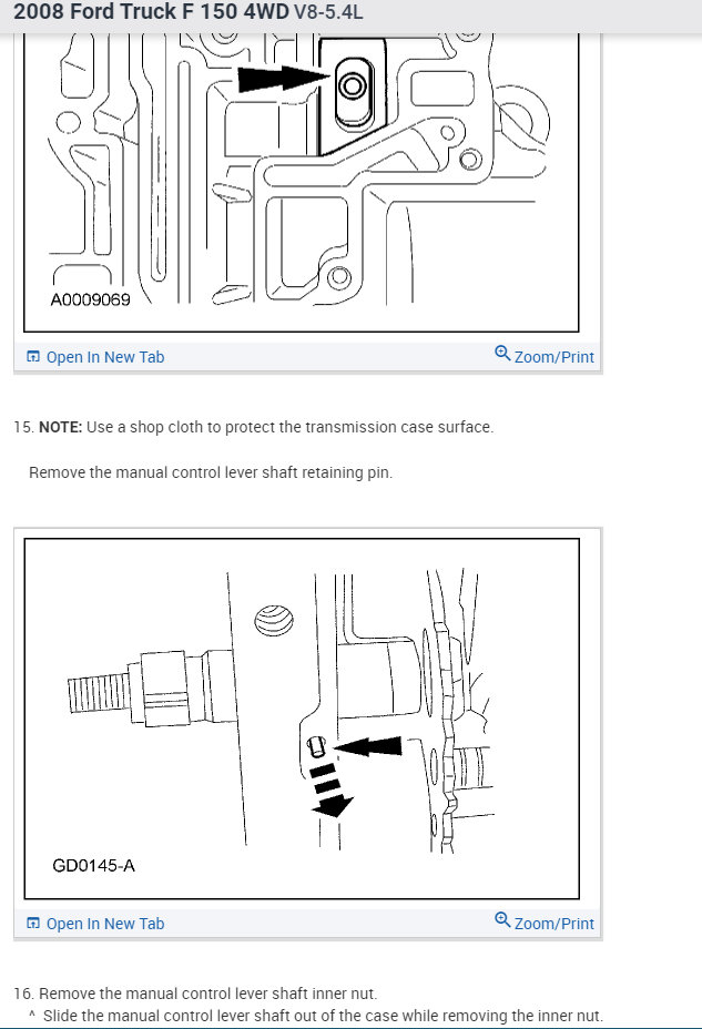

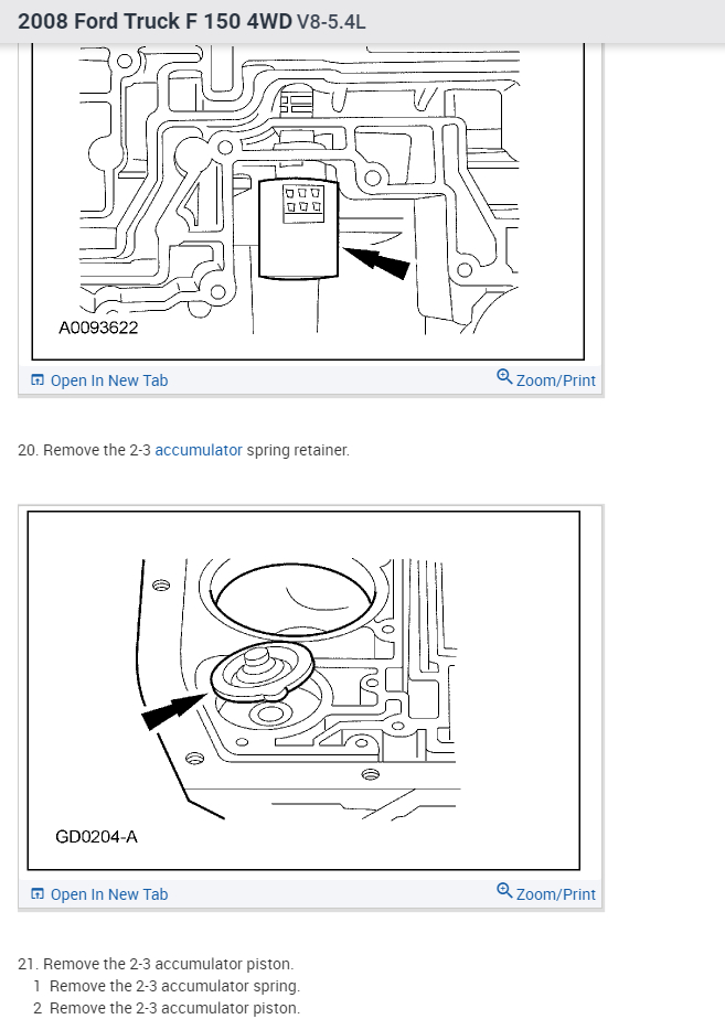

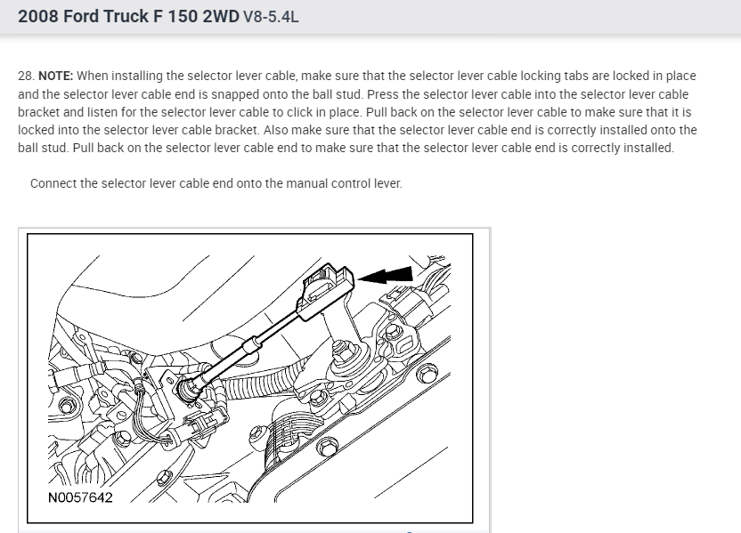

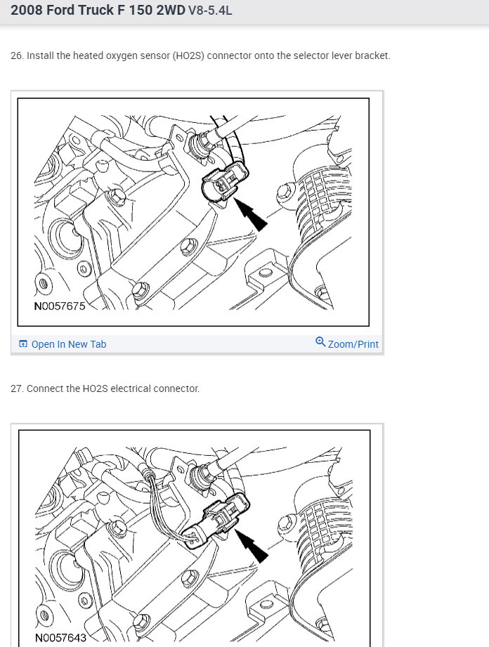

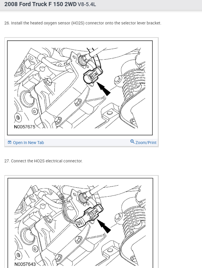

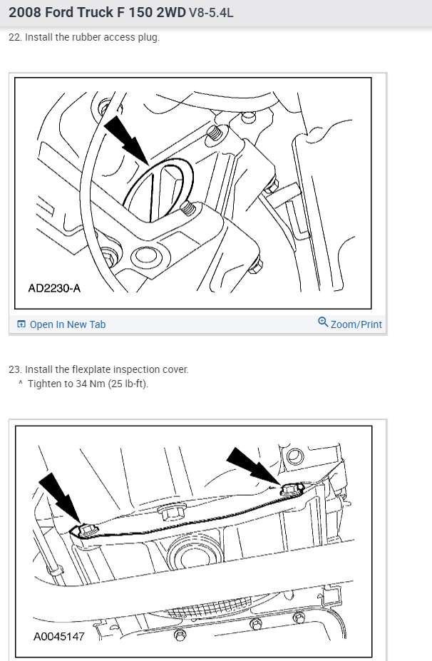

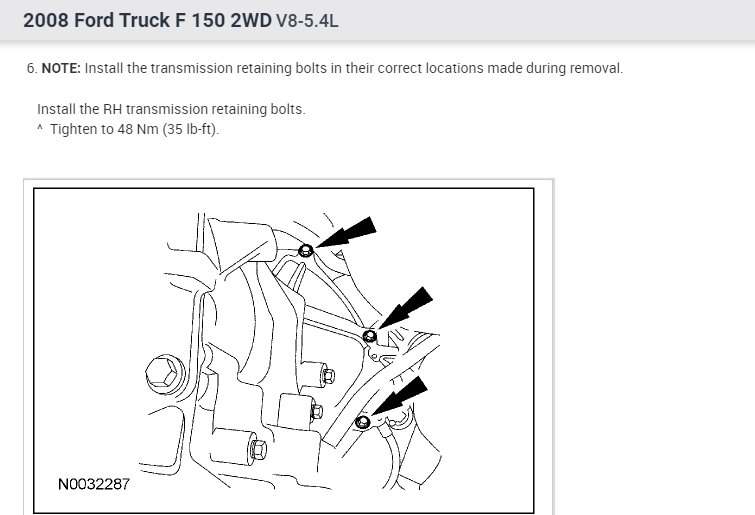

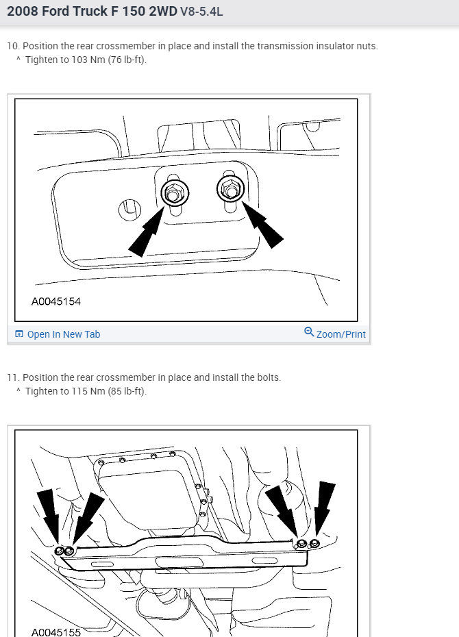

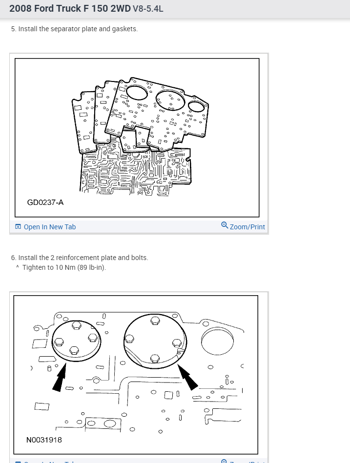

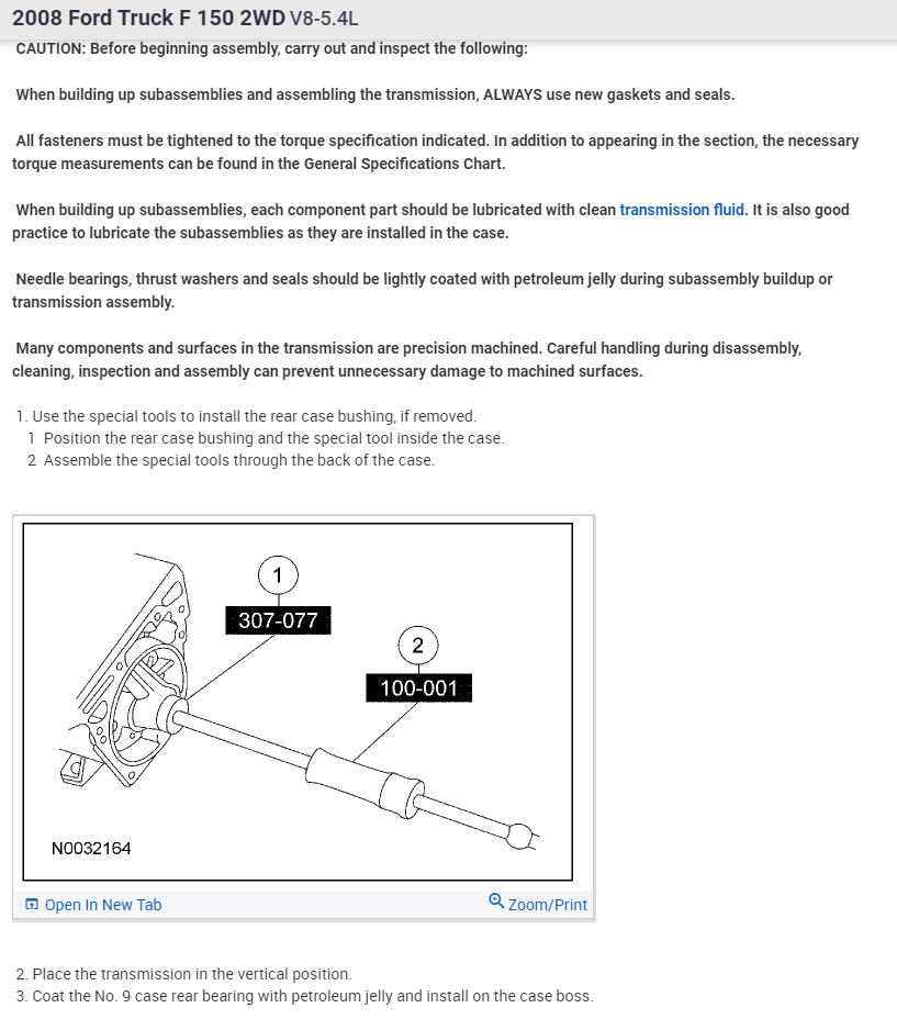

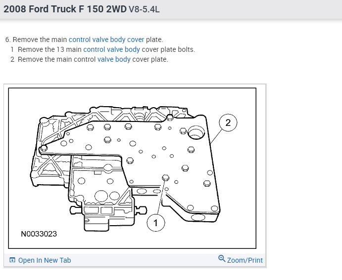

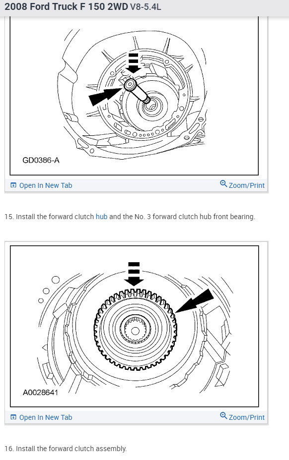

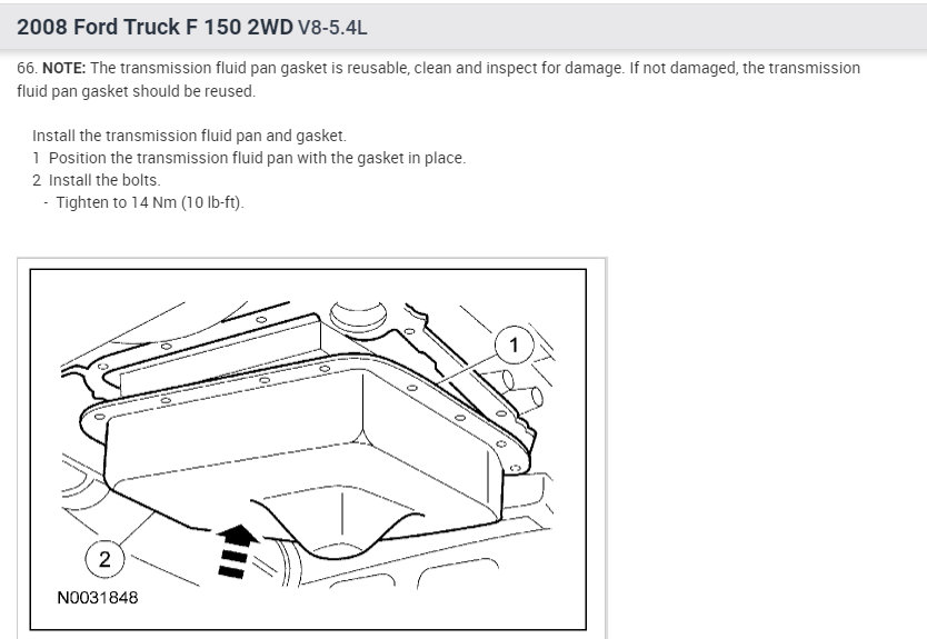

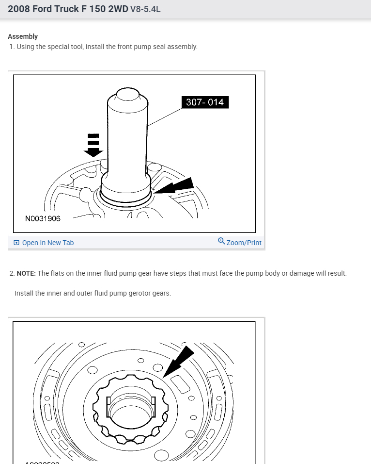

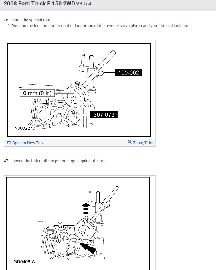

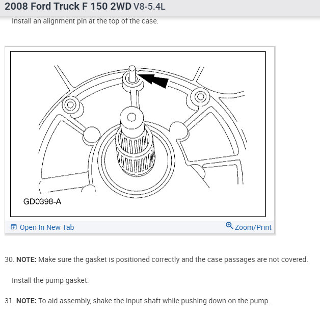

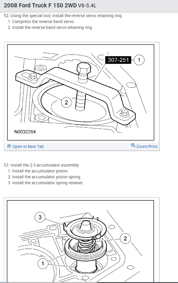

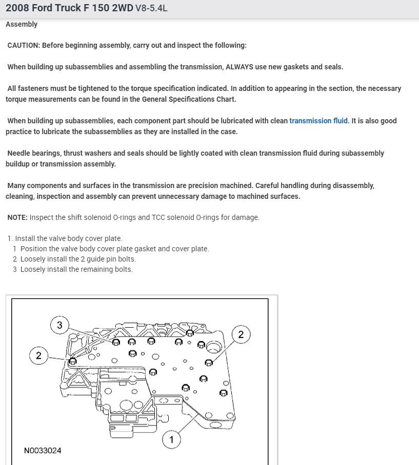

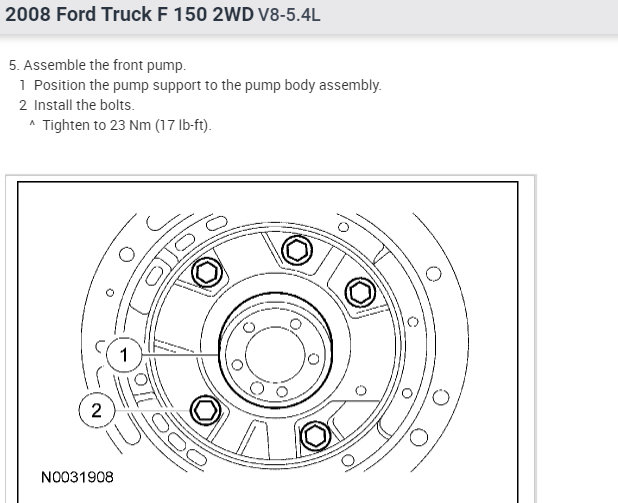

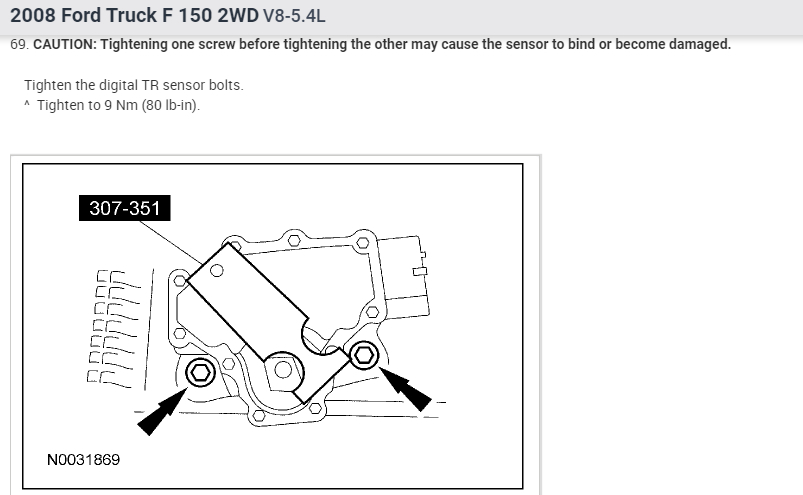

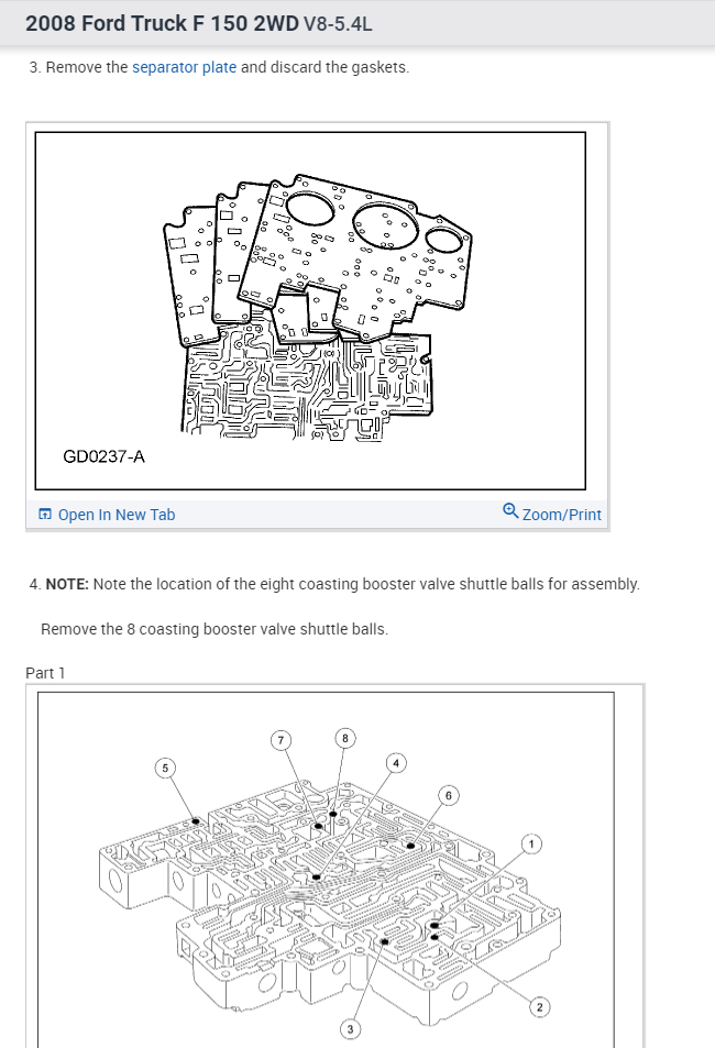

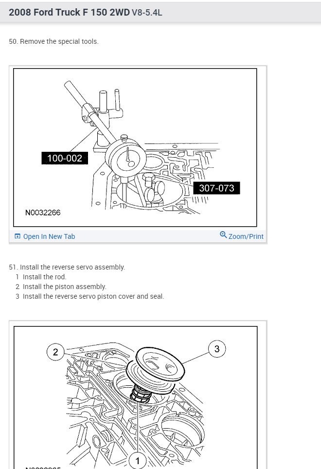

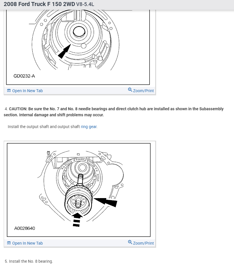

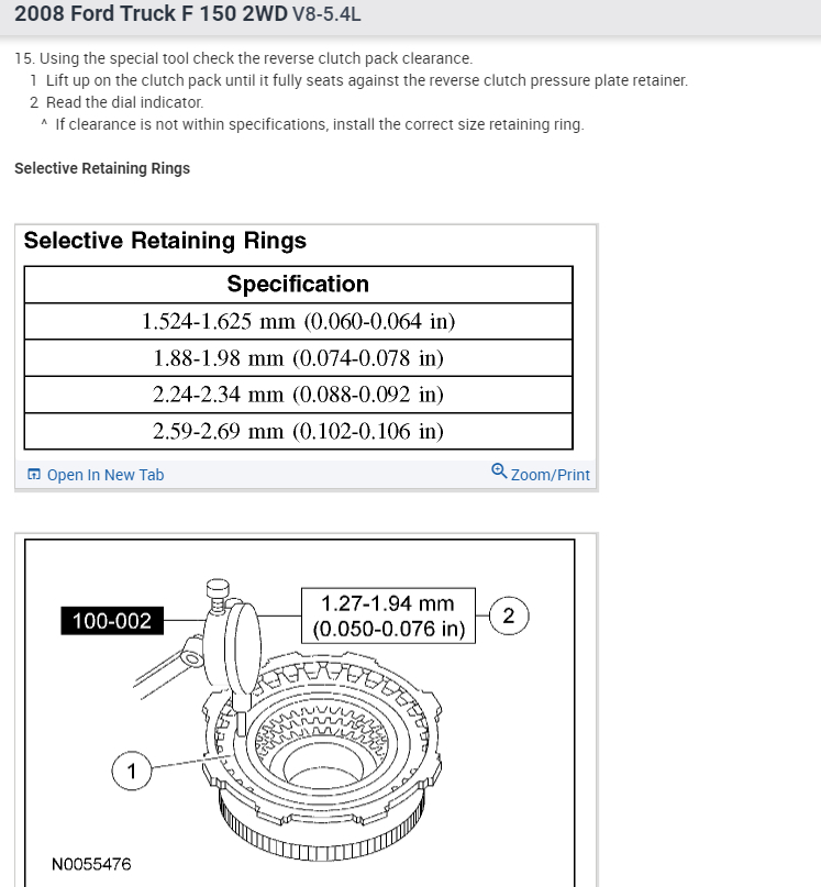

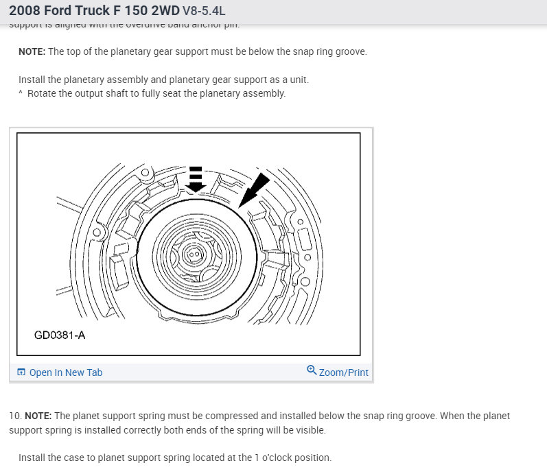

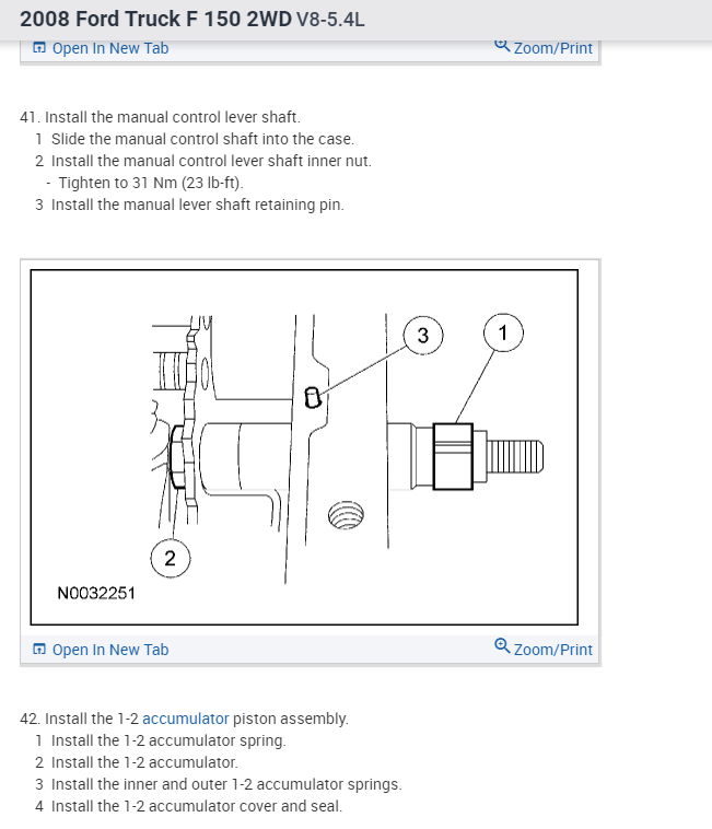

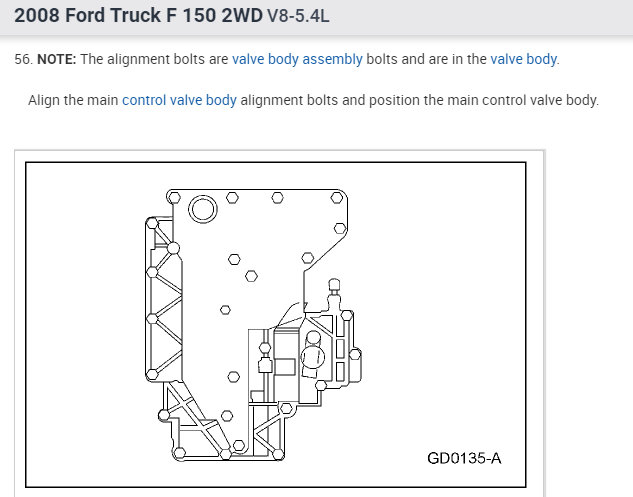

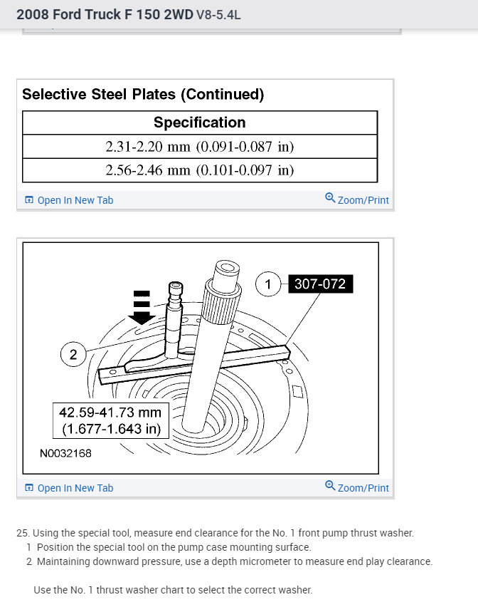

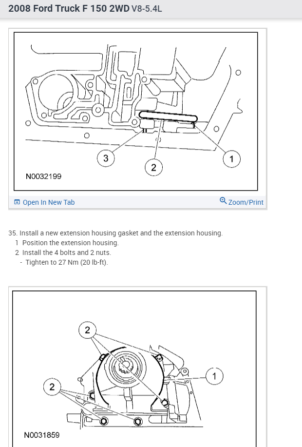

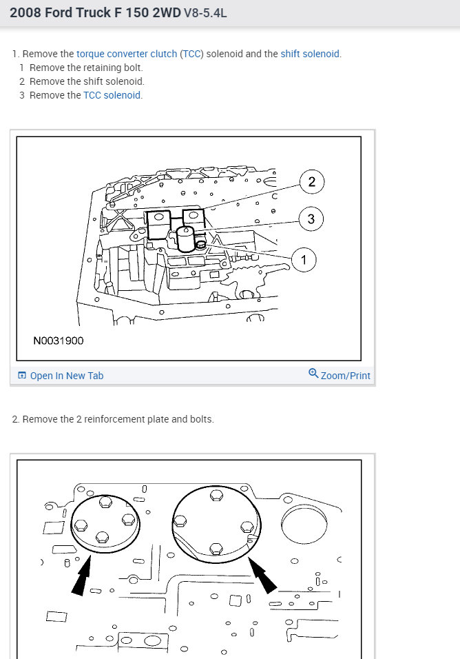

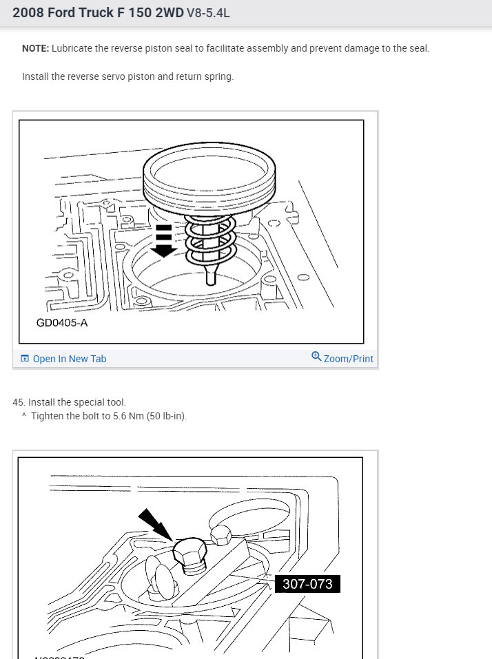

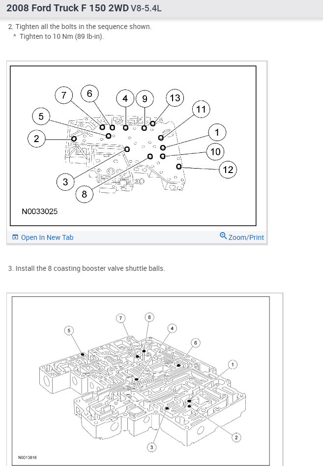

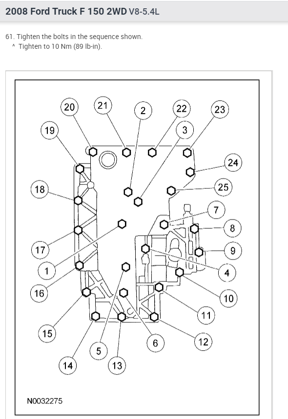

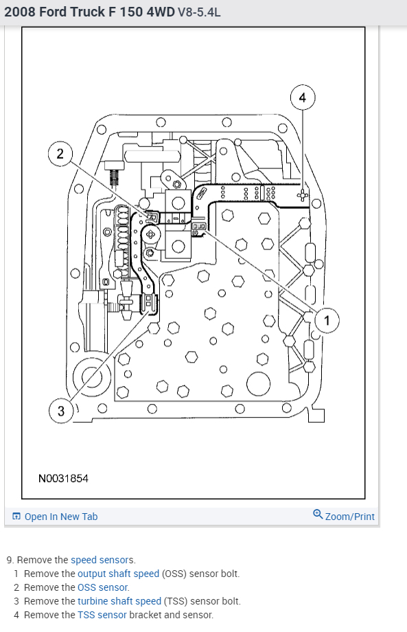

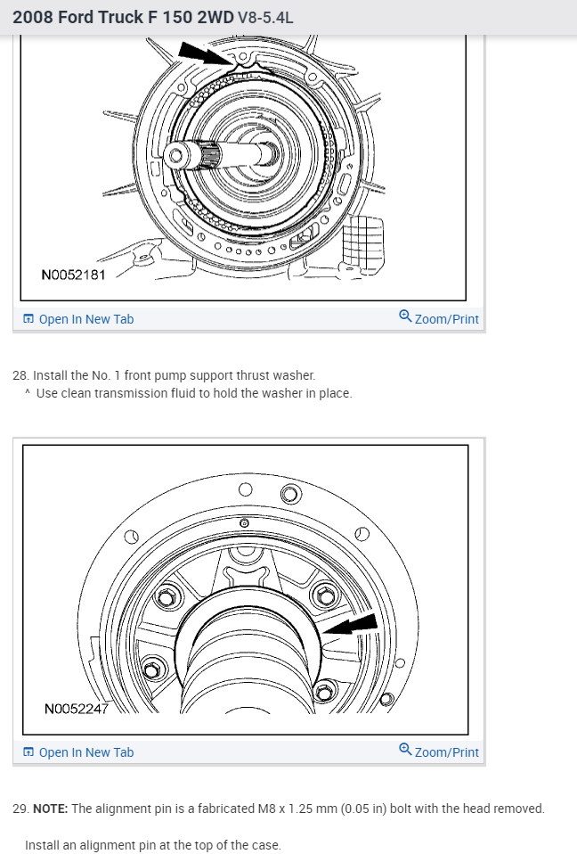

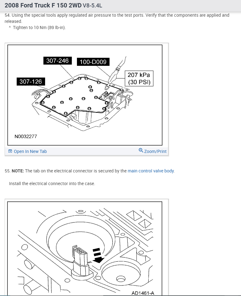

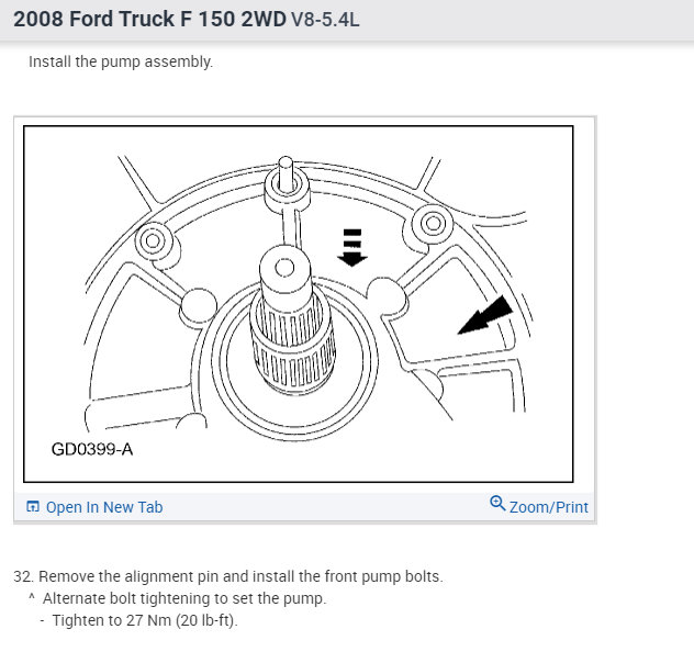

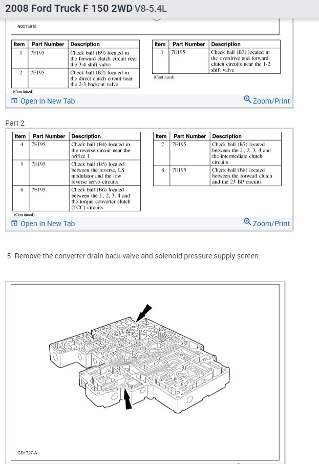

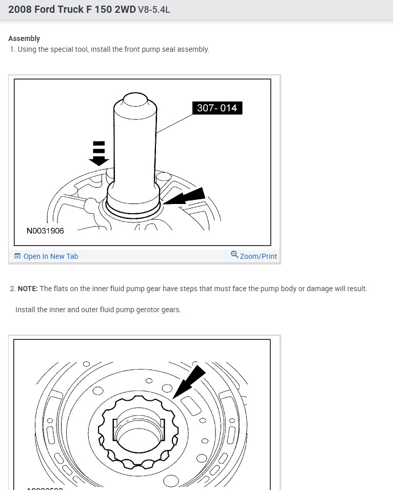

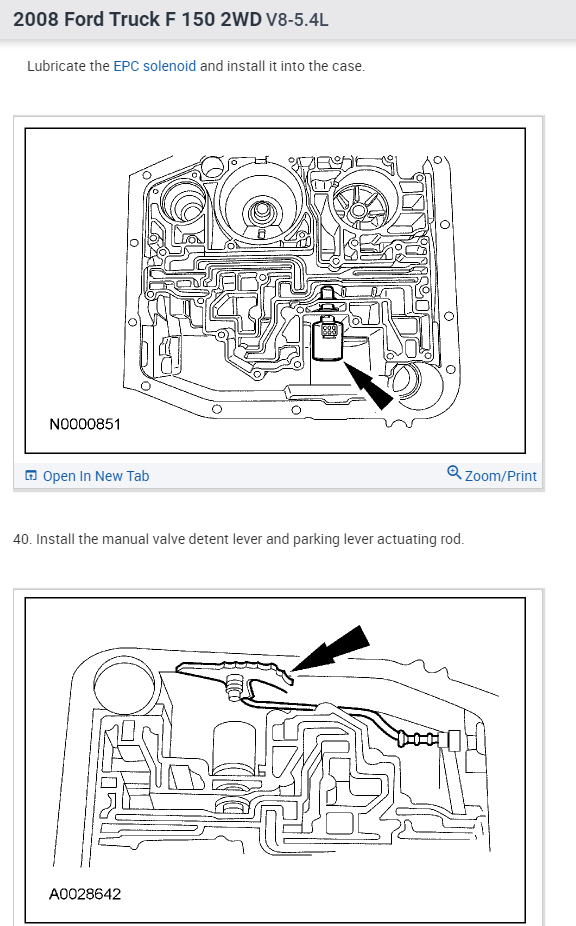

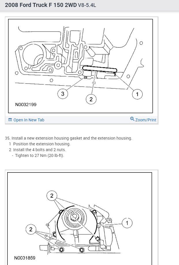

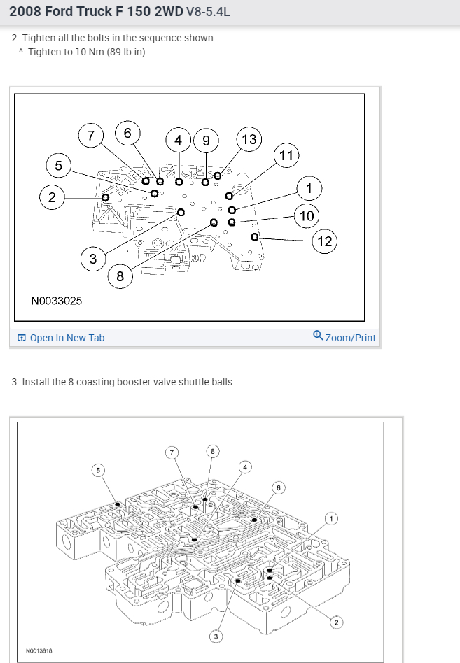

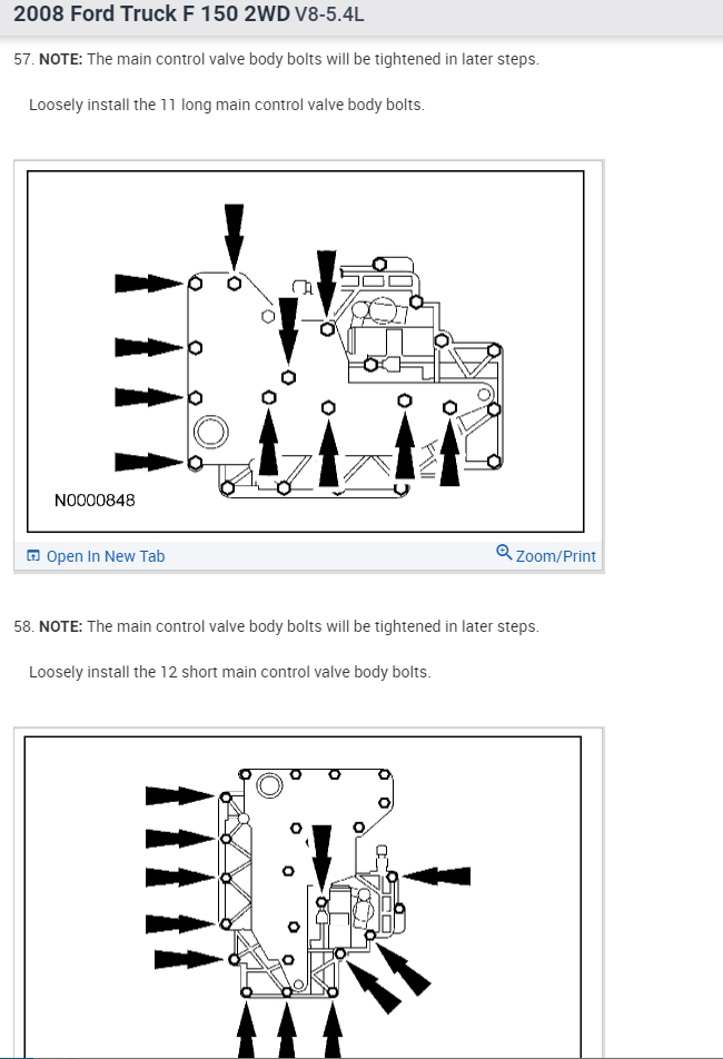

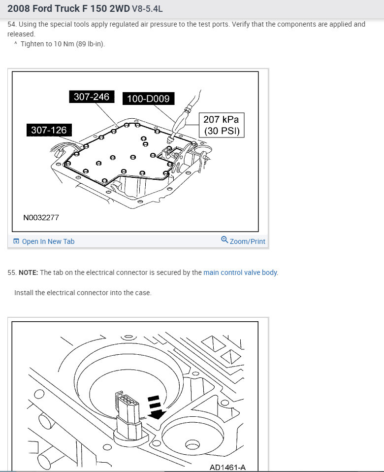

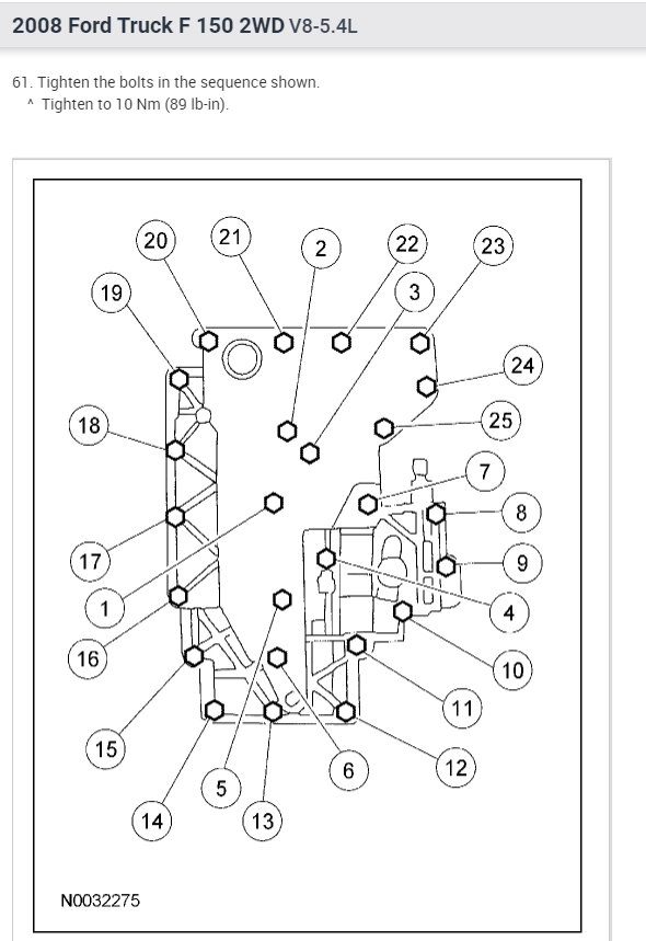

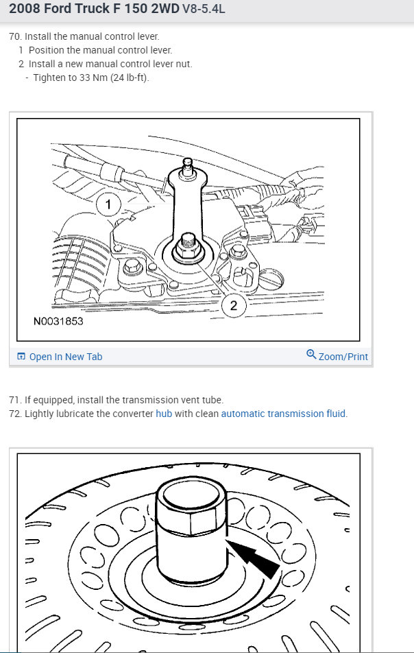

I'm assuming the assembly is the reverse of disassembly instructions from above, but do you have instructions with torque specs for the valve body bolts?
Jun 24, 2022 at 4:49 AM
SQM
  • 6,383 POSTS

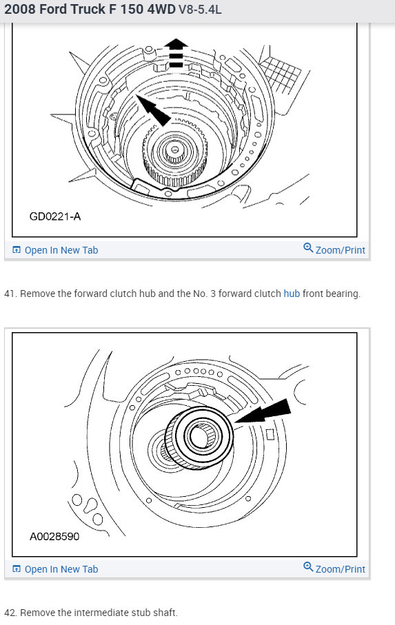

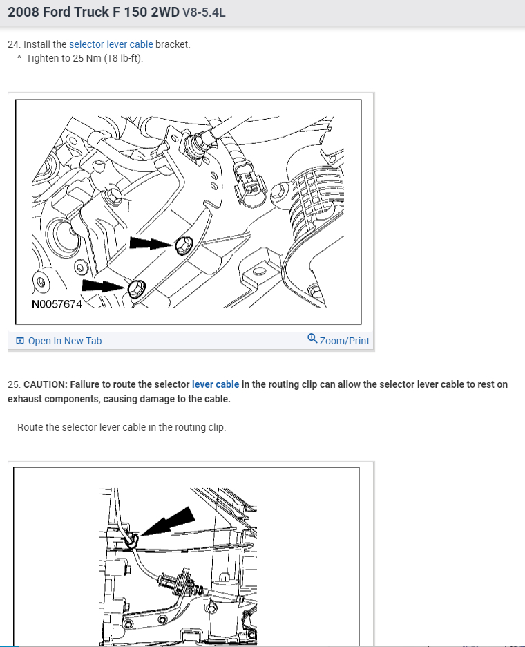

See attached for the transmission reassembly procedure as well as the valve body instructions. You will find all the torque specifications as well as the very important torque sequence.
Jun 24, 2022 at 6:43 AM

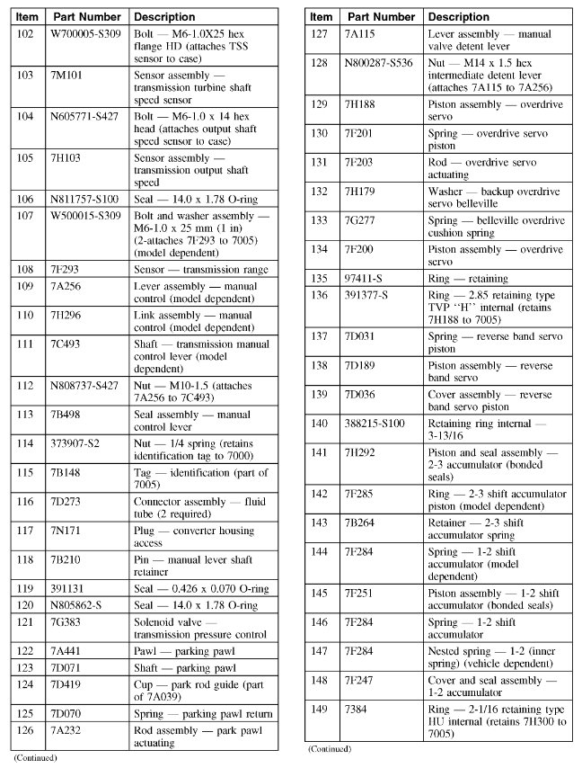

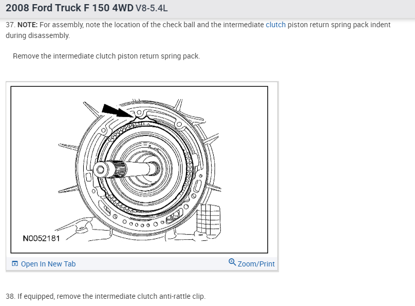

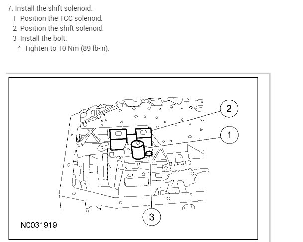

Is it necessary to replace the solenoids during a rebuild?
Jun 28, 2022 at 2:58 PM
SQM
  • 6,383 POSTS
Only if it is a concern (typically shifting issues). Might be a good idea if many other components are getting replaced.

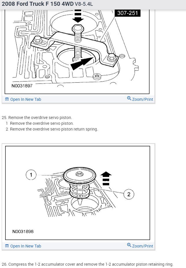

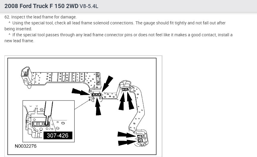

ARIANADANIELLE5345
  • 402 POSTS

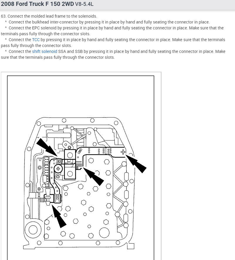

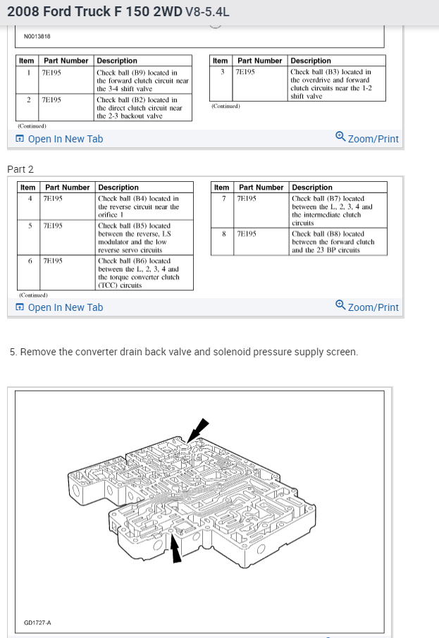

Are there inspection instructions you would be able to post for the transmission parts or at least for the valve body? I am finding that things that would not be okay in an engine are seemingly fine in a transmission. It’s very different and I really don’t want to mess this up. I'd like to be as thorough as possible.
Jun 29, 2022 at 7:45 PM
SQM
  • 6,383 POSTS
Unfortunately, the repair manual does not provide an inspection guide, just rebuilding and replacement.
However, there are some helpful videos on YouTube on this subject.
Take a look at this video.
https://youtu.be/EBuQNkJcKhA
Jun 30, 2022 at 1:36 PM

Okay, I will, thanks. Should I replace the bushings in the transmission since it has around 300,000 (maybe more) miles on it?
Jul 1, 2022 at 4:55 AM
ARIANADANIELLE5345
  • 402 POSTS
Also, I can't really see the different o rings in the pictures posted. How can I identify which one goes where other than putting them where they fit?
Jul 1, 2022 at 6:24 AM

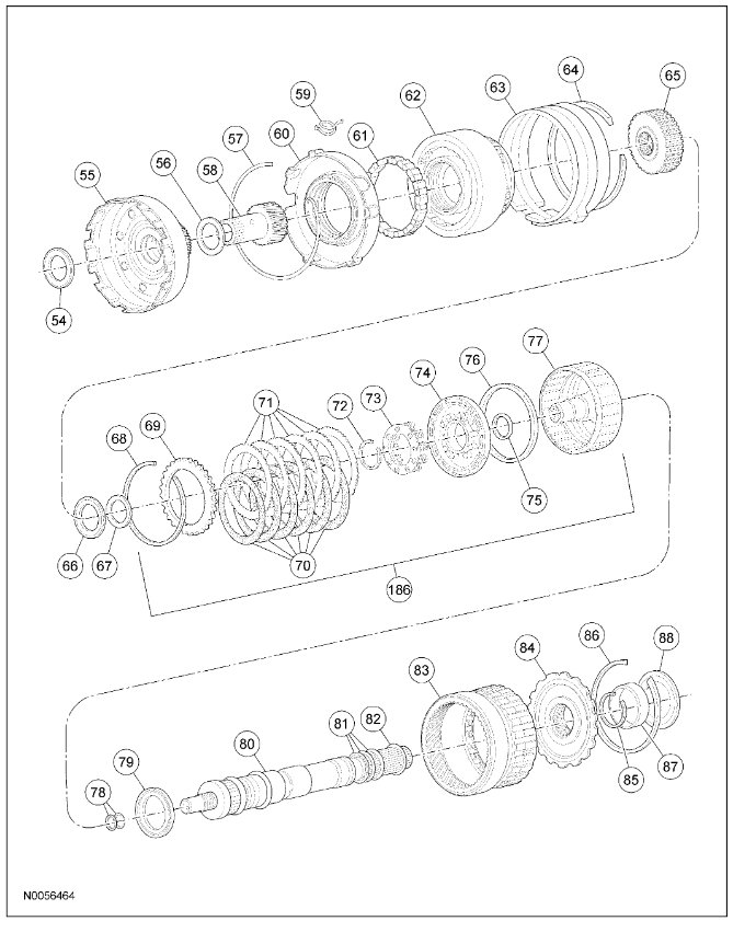

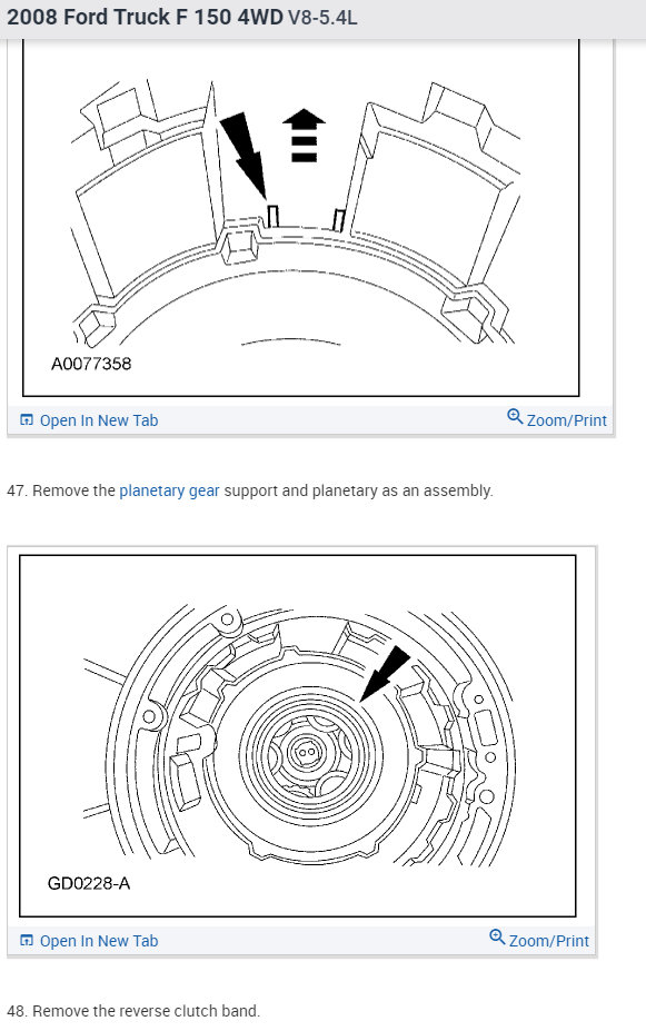

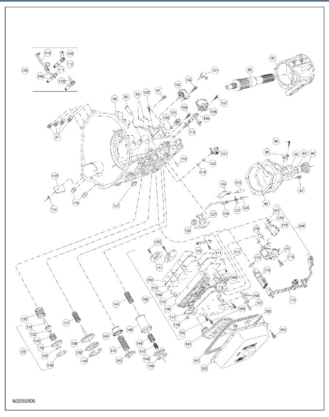

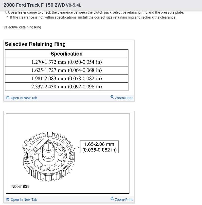

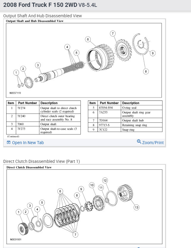

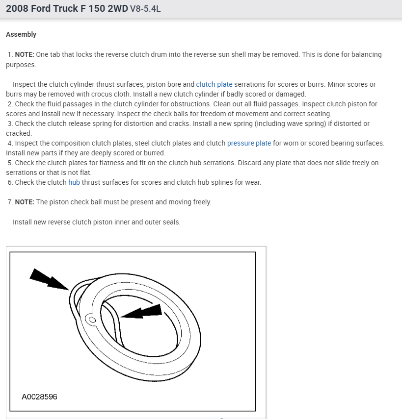

  • 402 POSTS

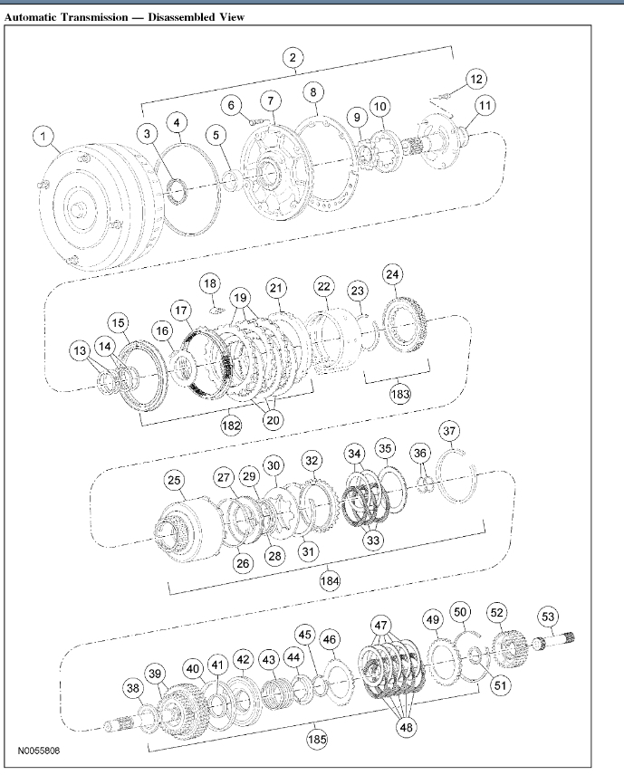

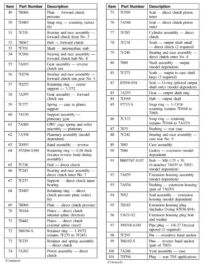

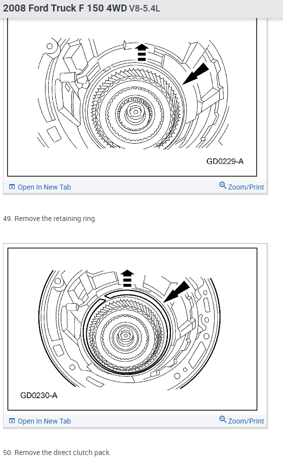

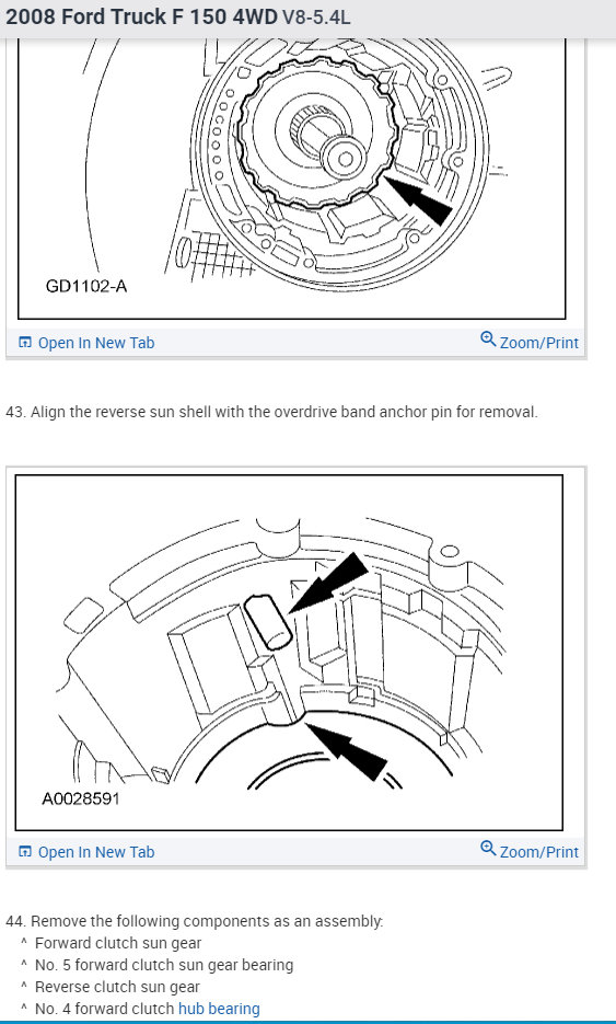

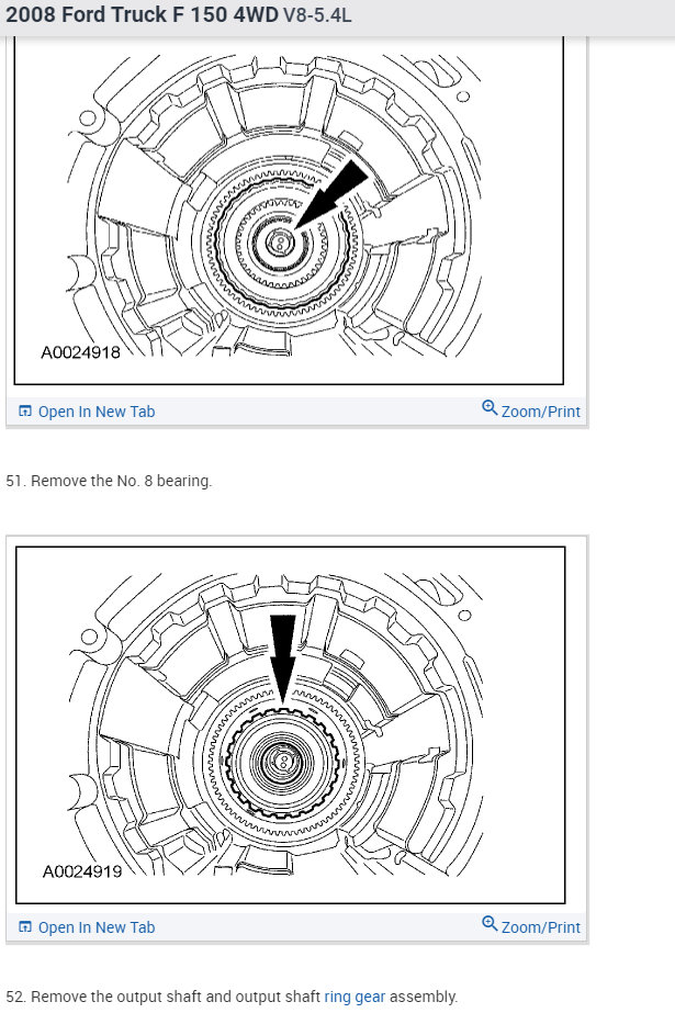

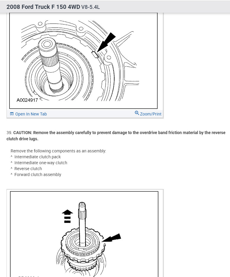

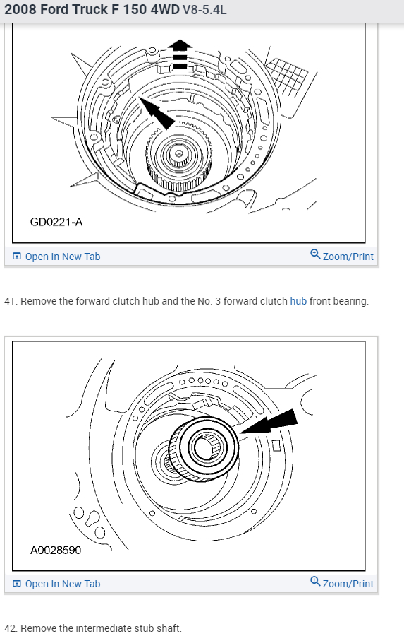

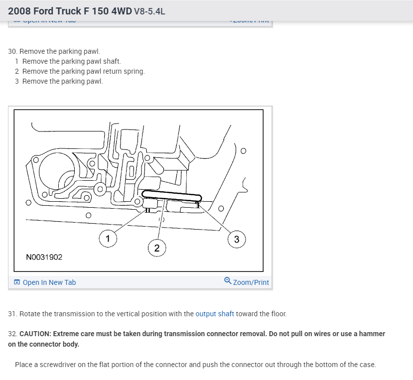

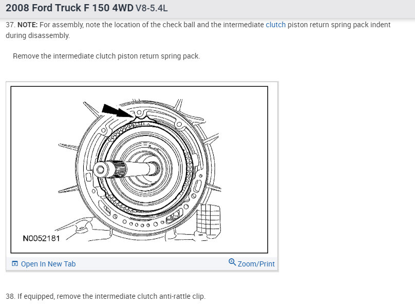

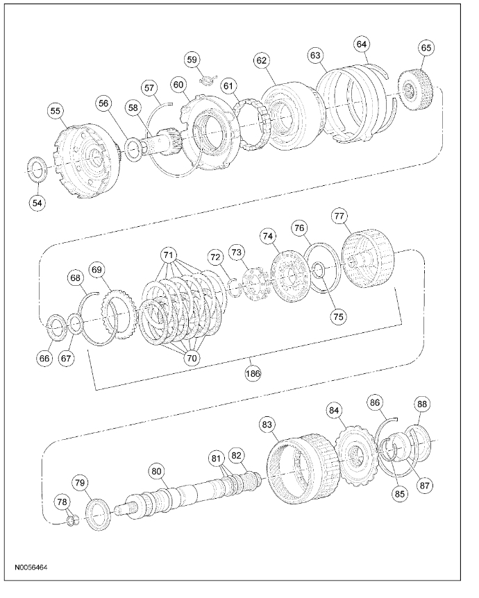

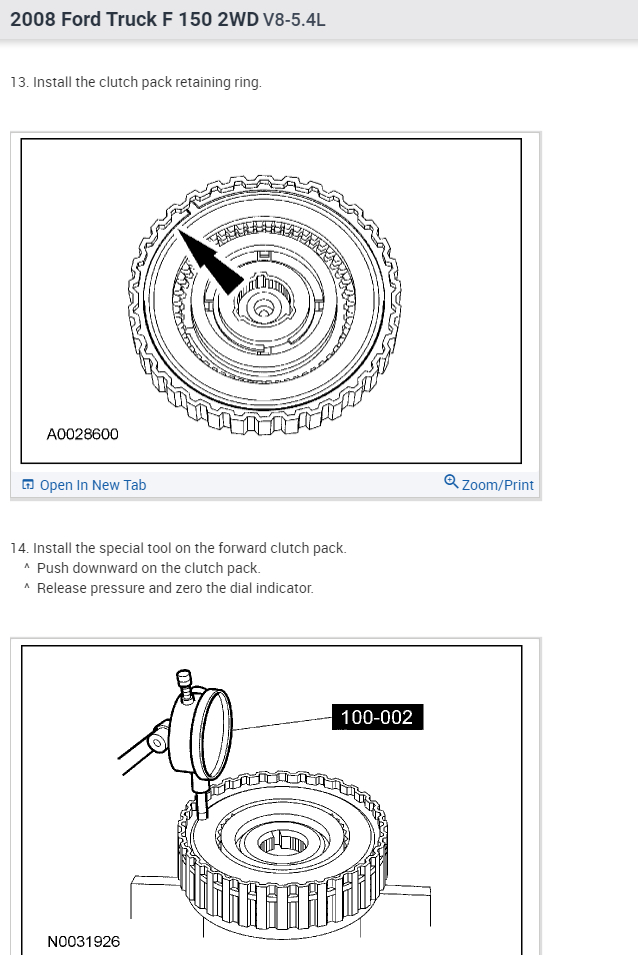

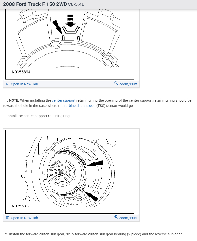

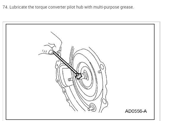

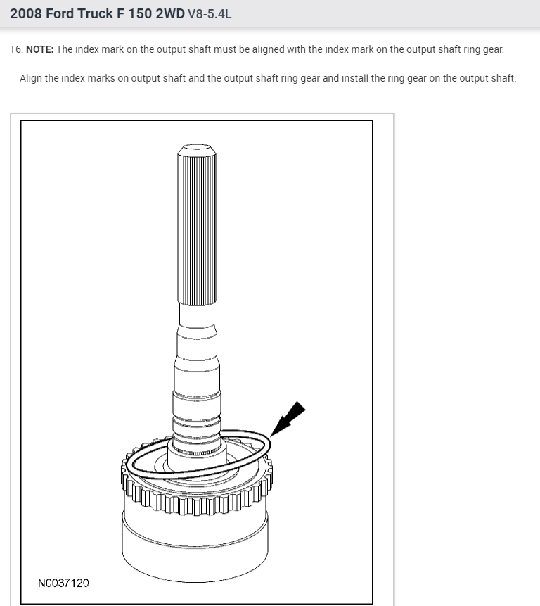

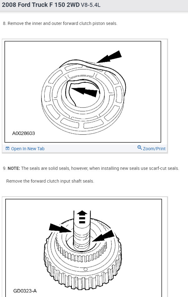

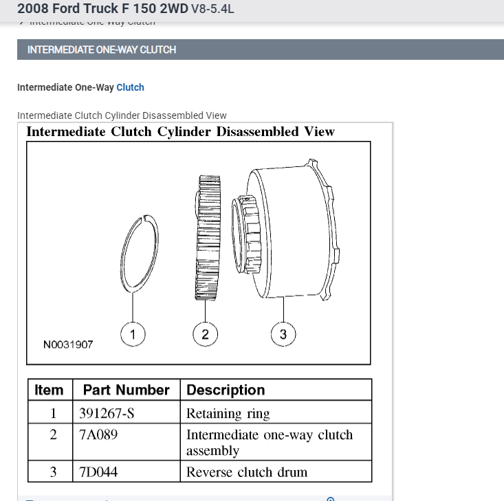

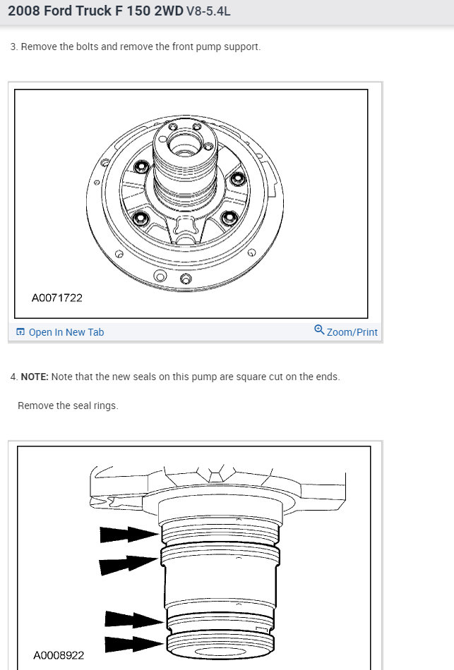

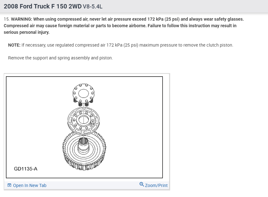

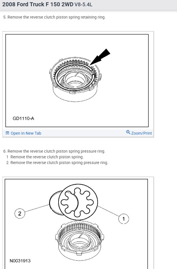

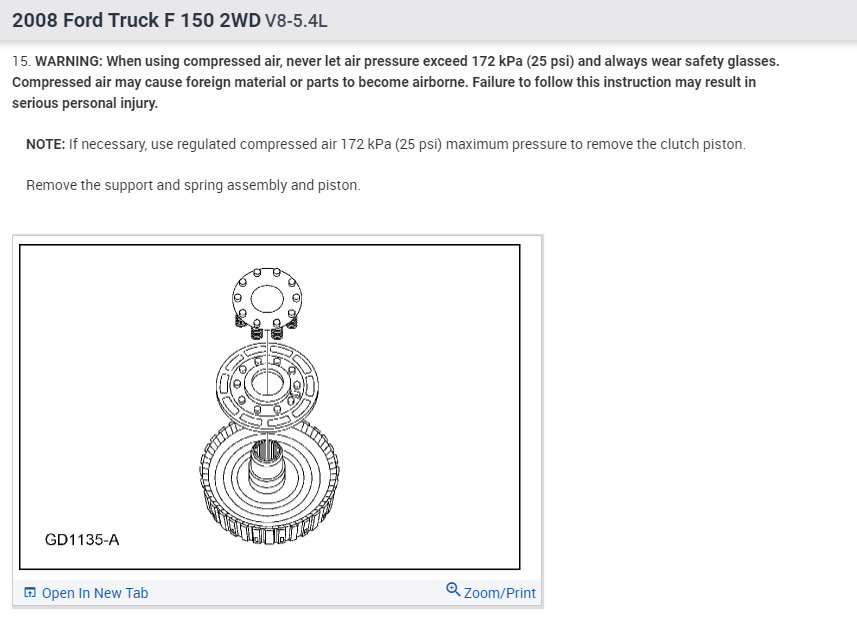

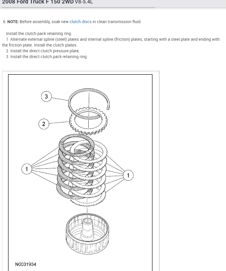

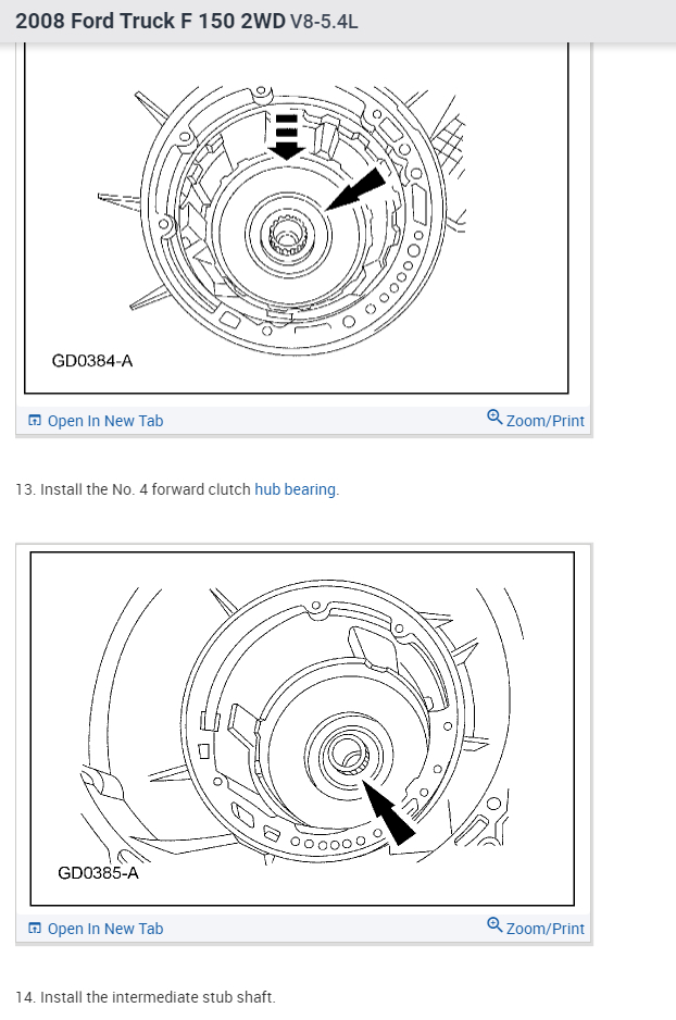

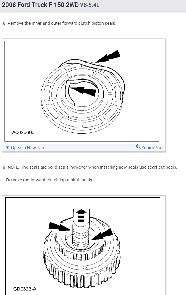

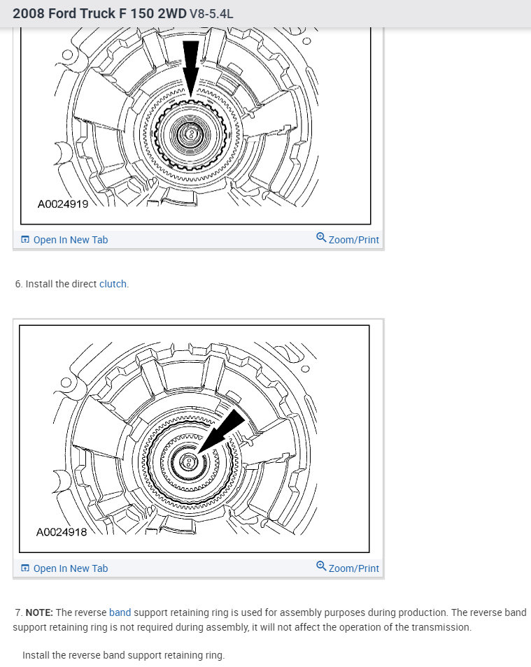

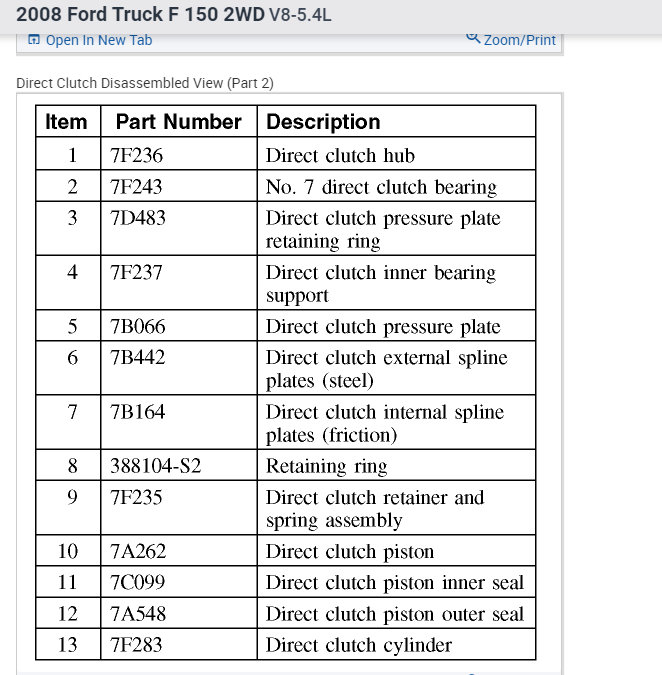

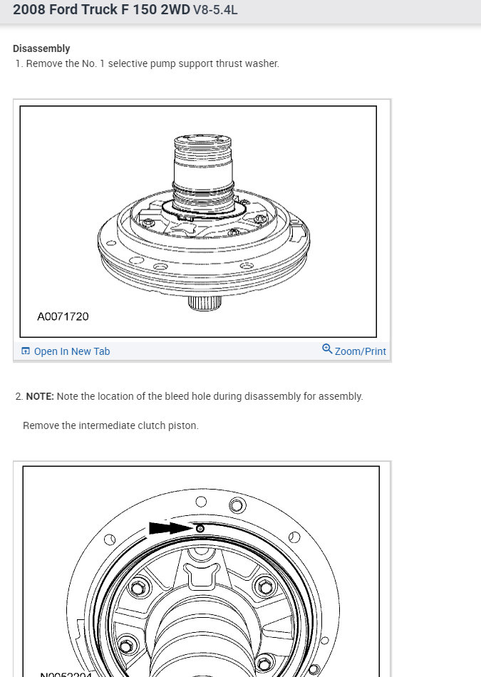

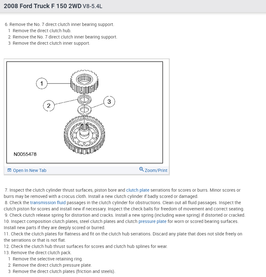

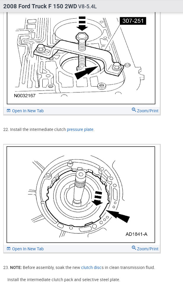

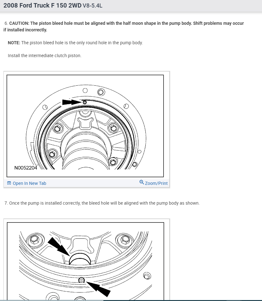

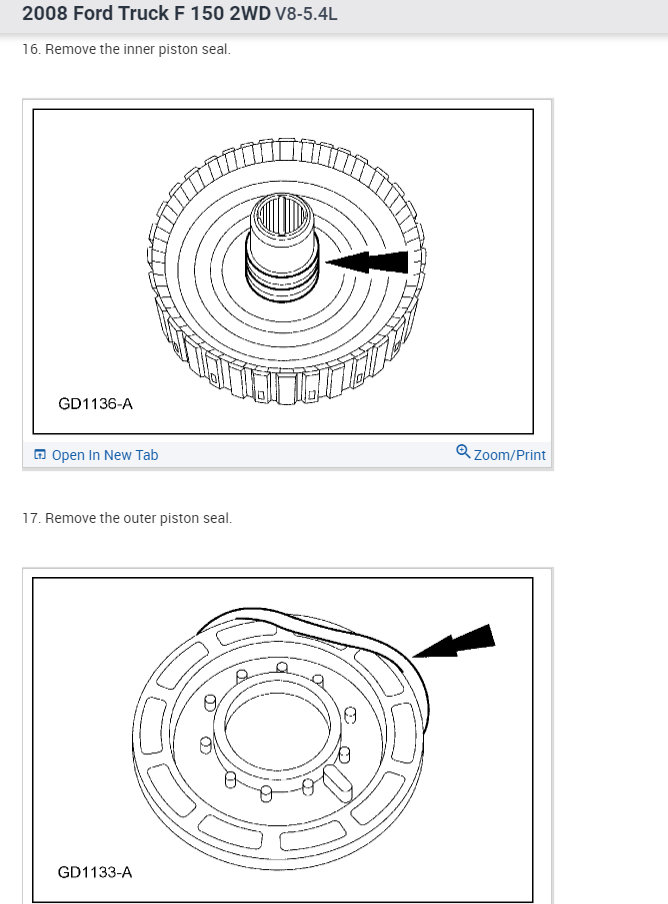

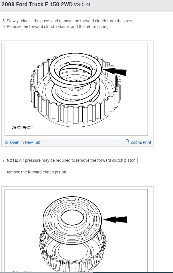

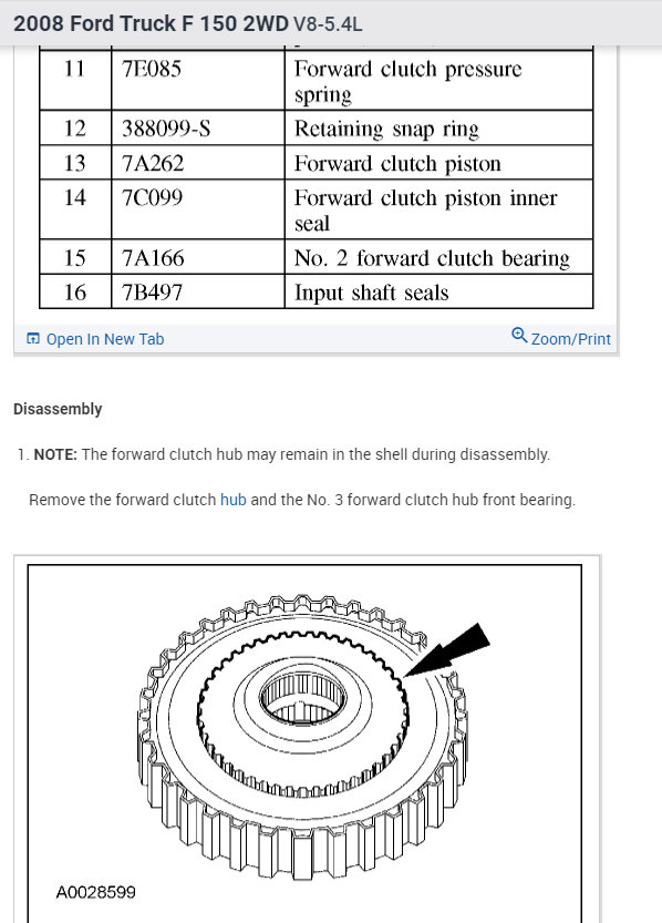

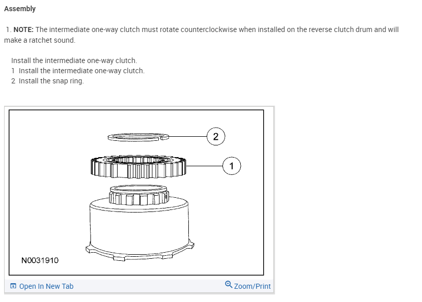

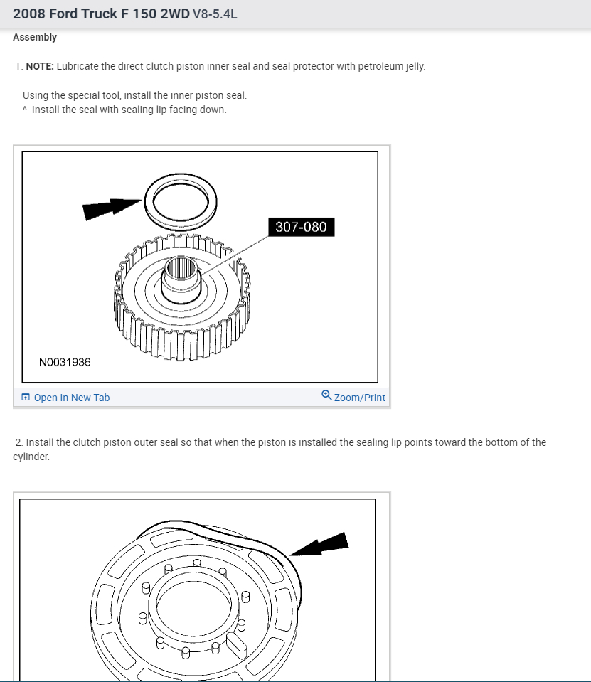

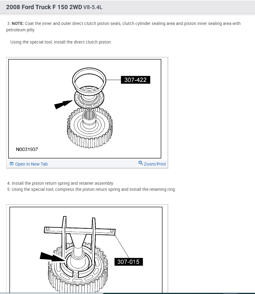

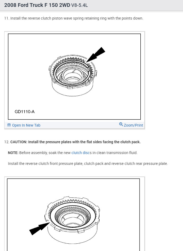

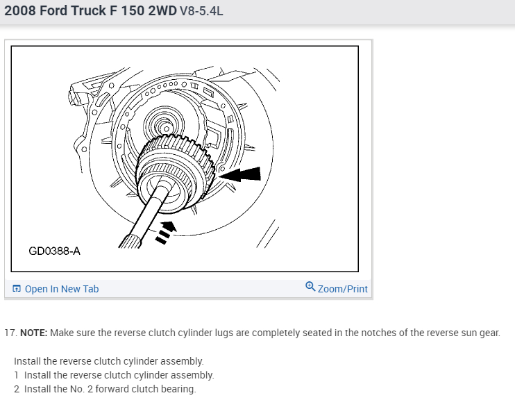

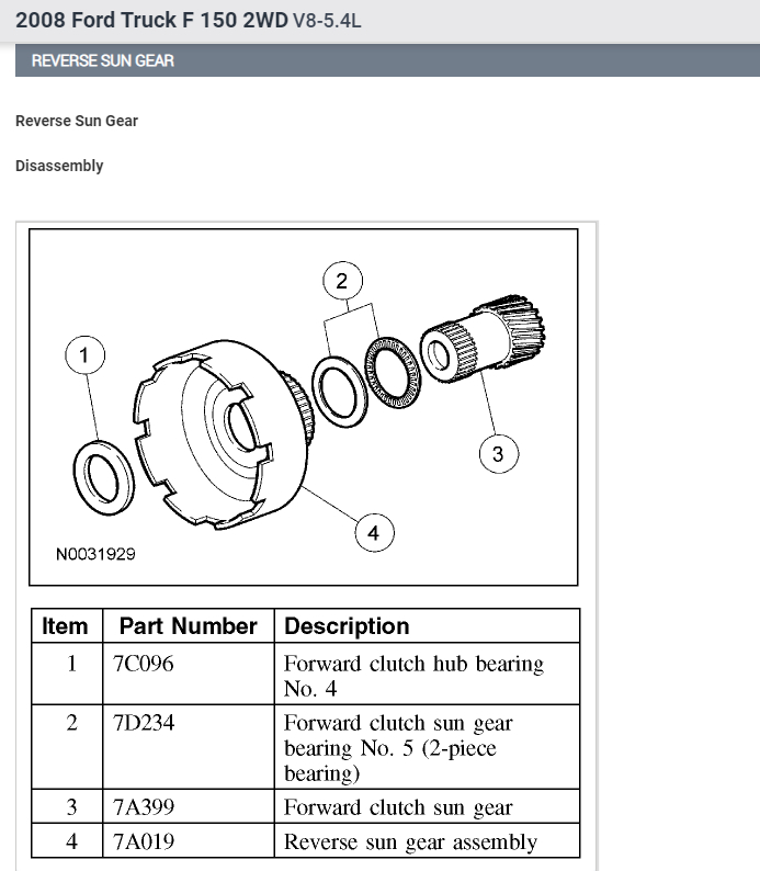

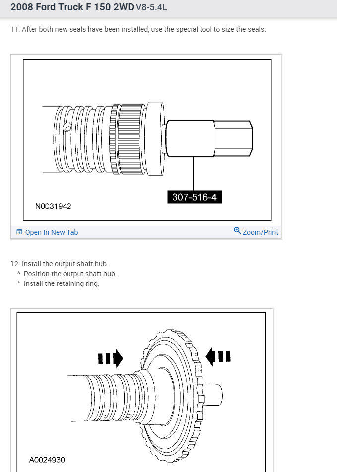

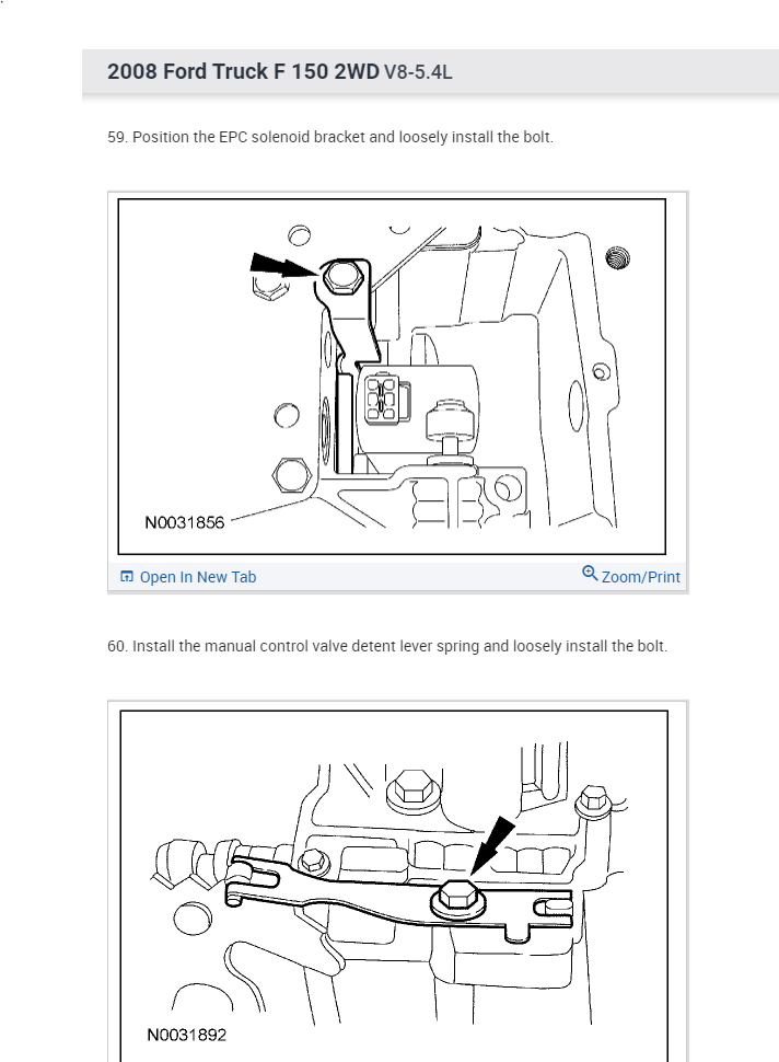

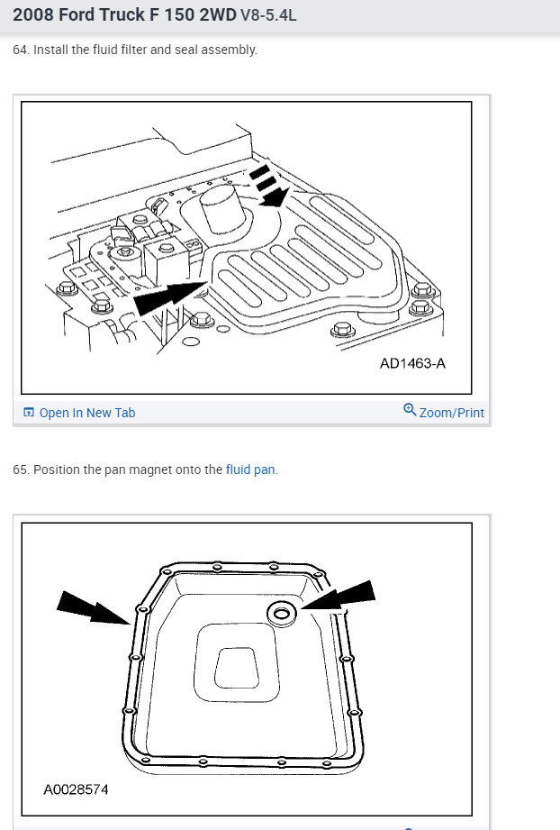

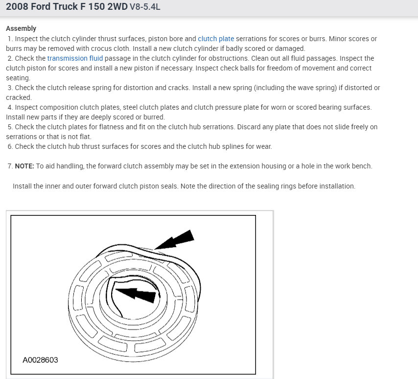

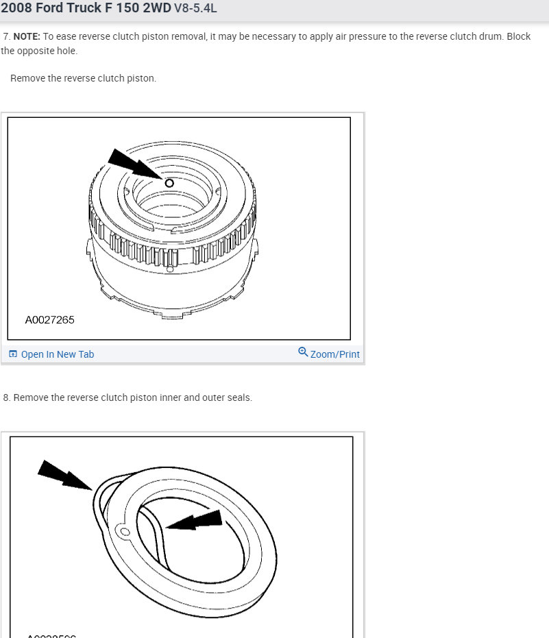

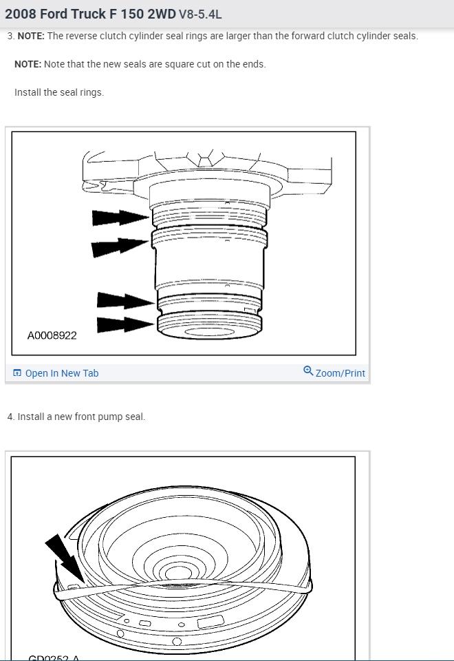

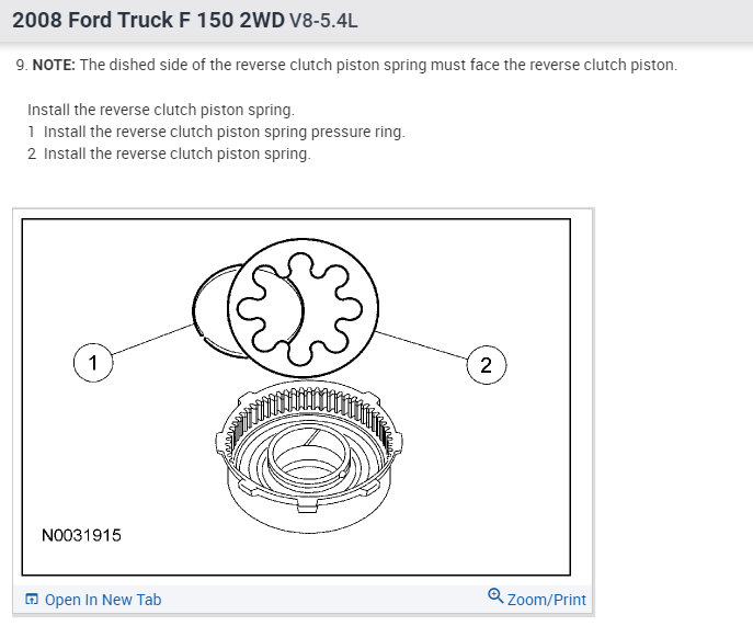

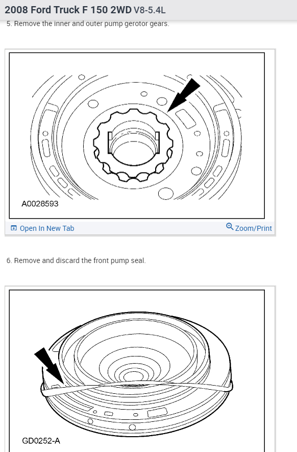

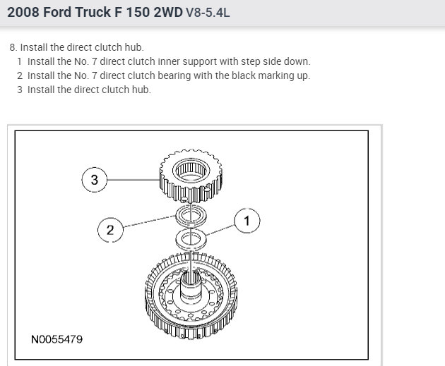

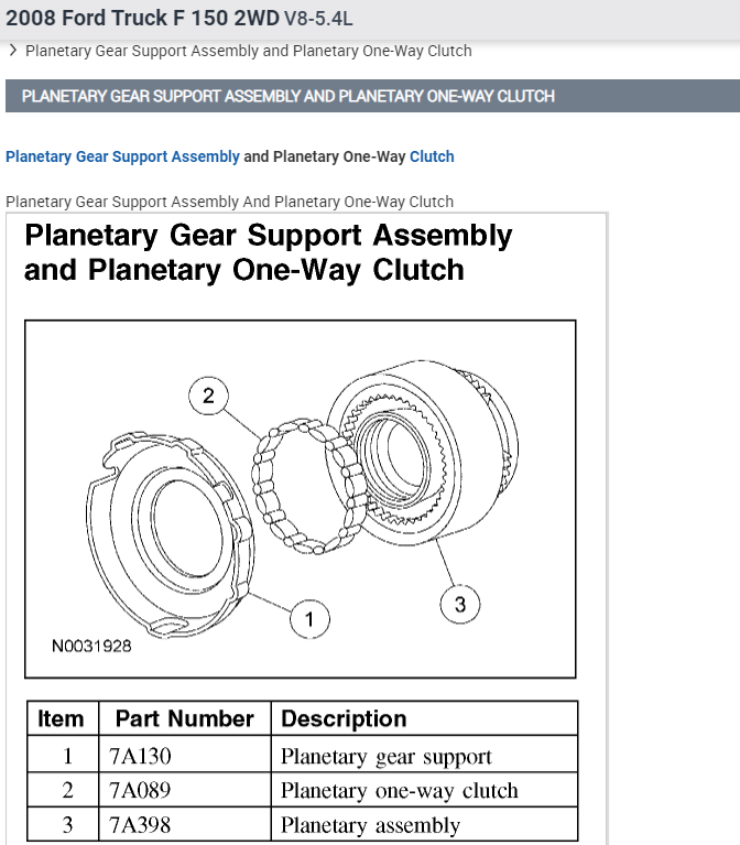

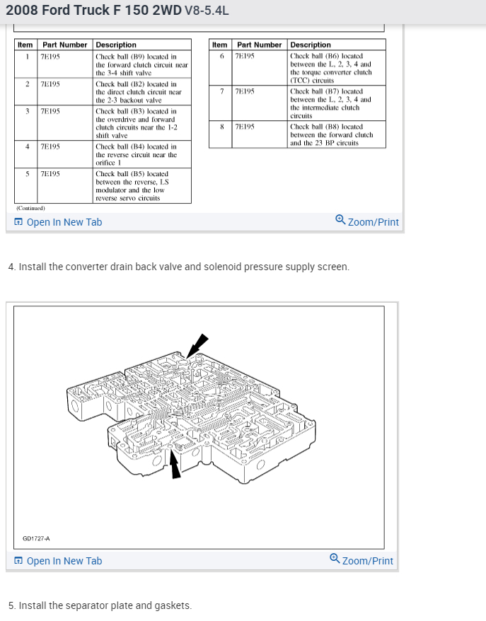

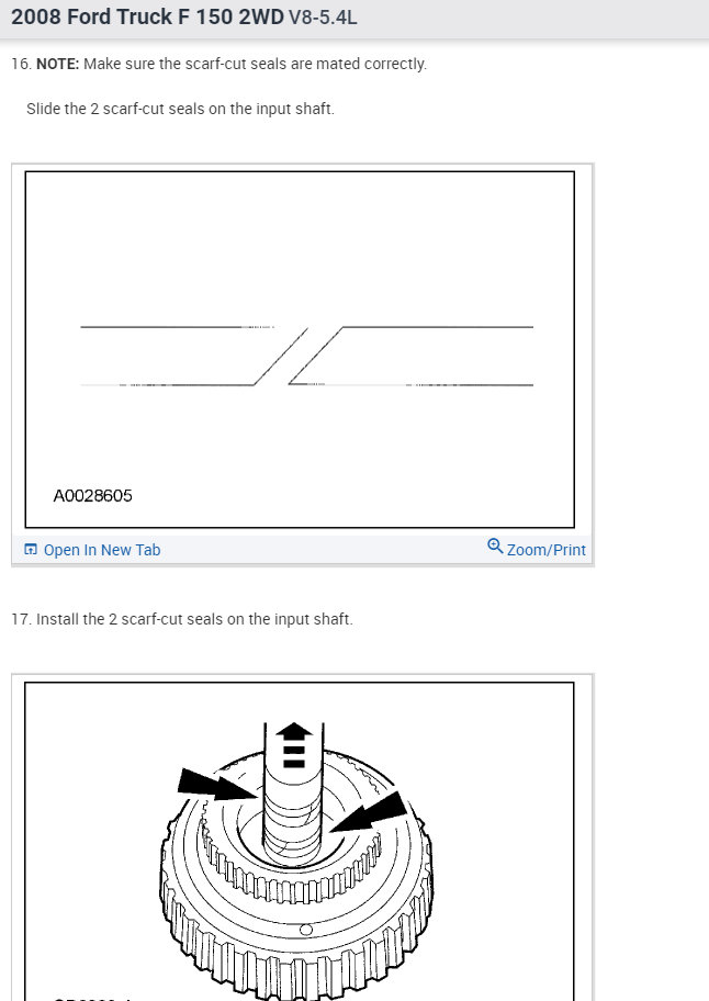

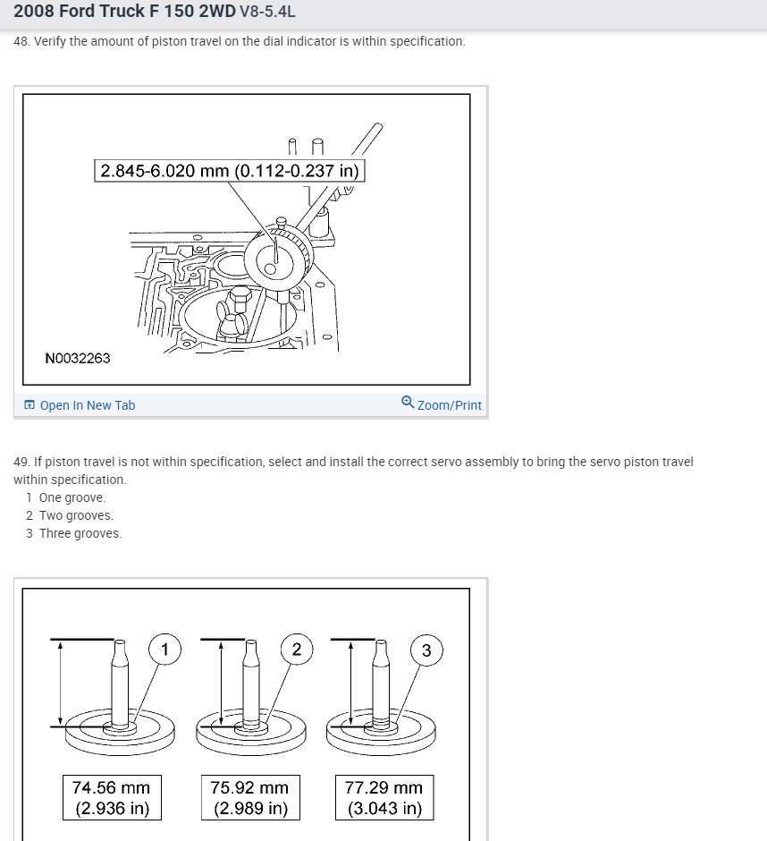

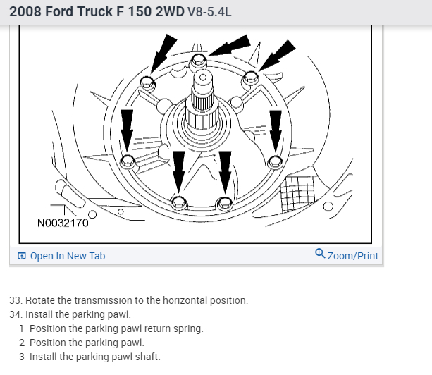

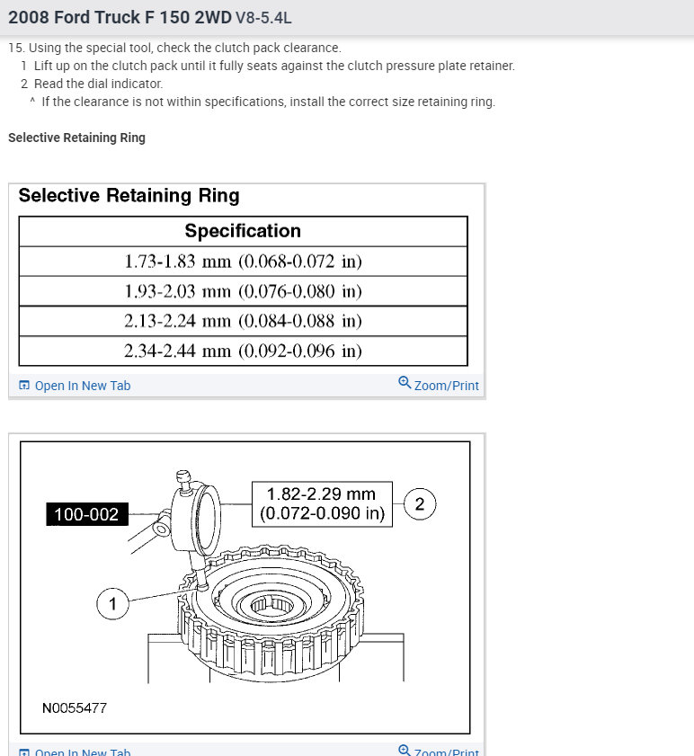

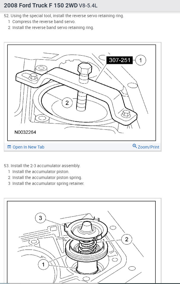

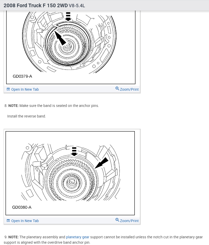

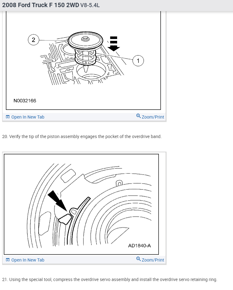

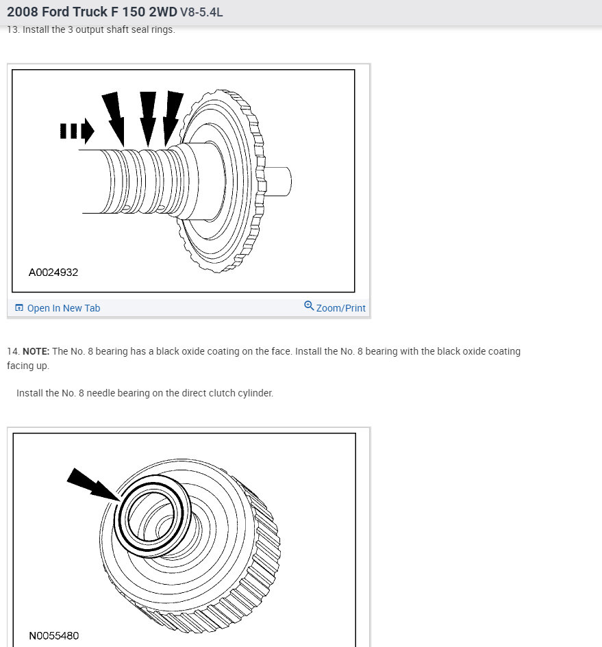

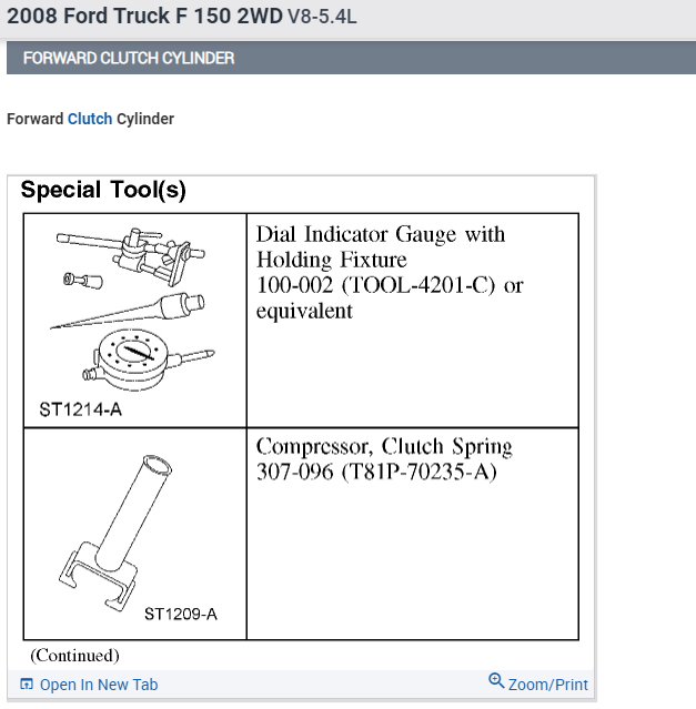

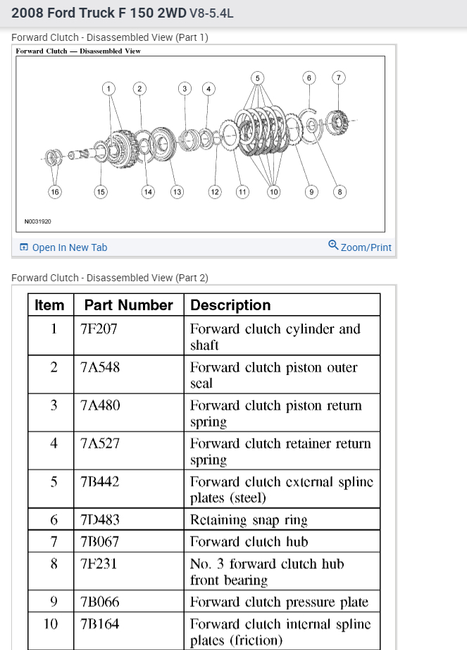

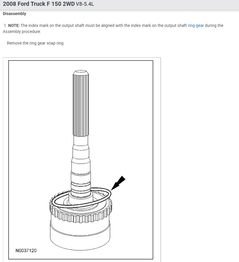

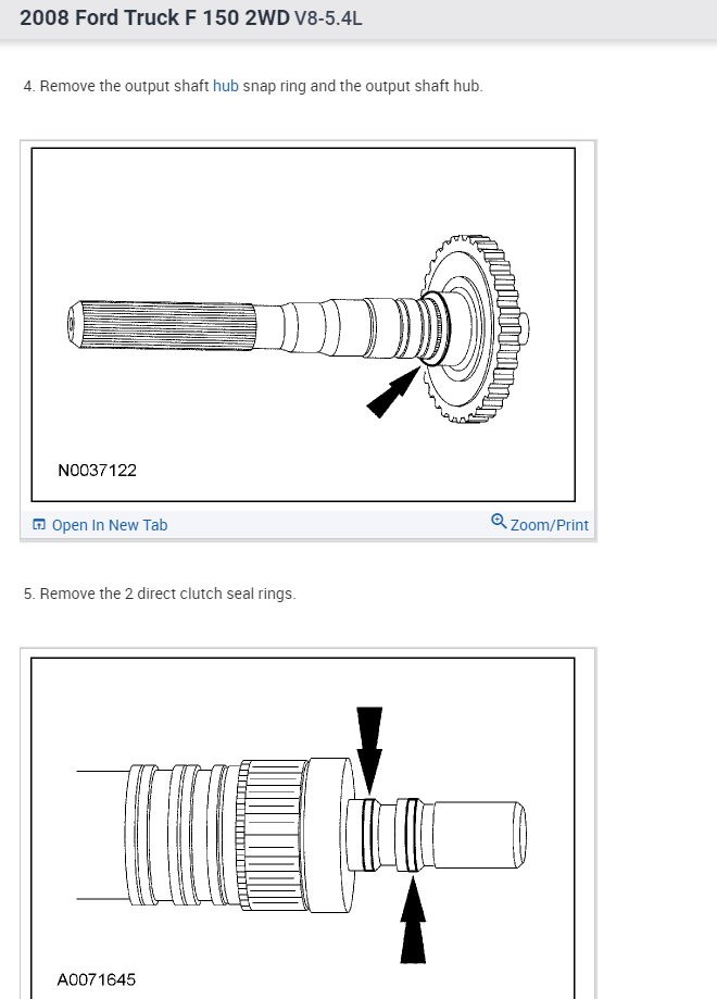

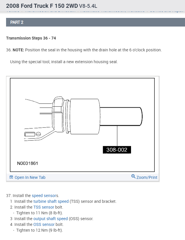

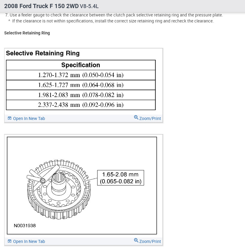

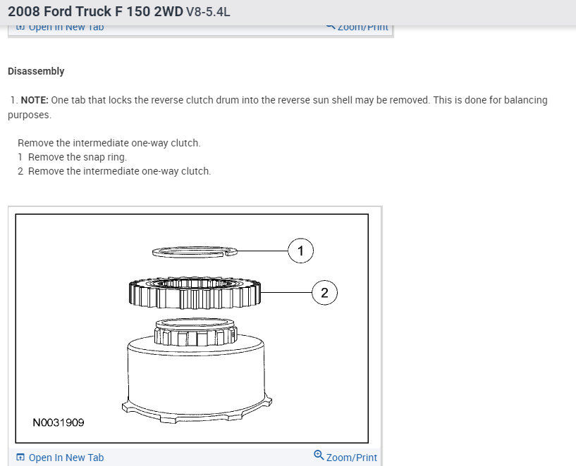

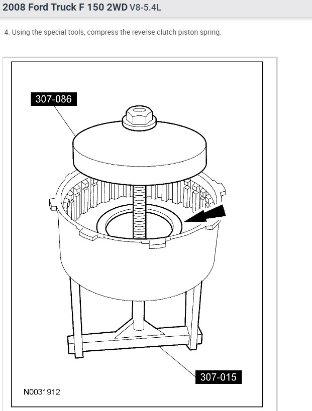

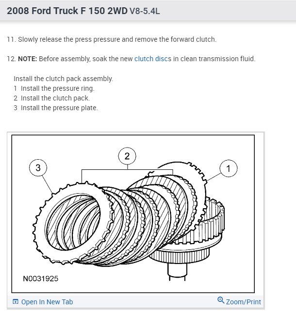

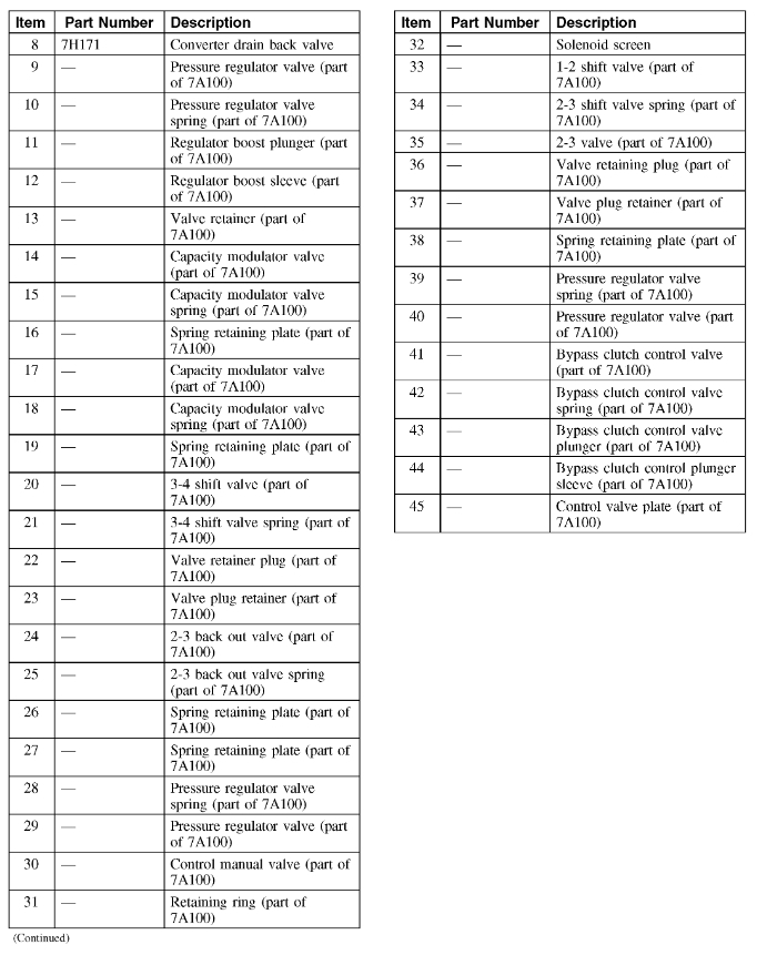

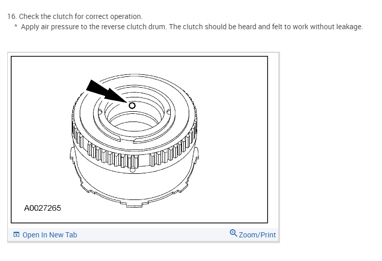

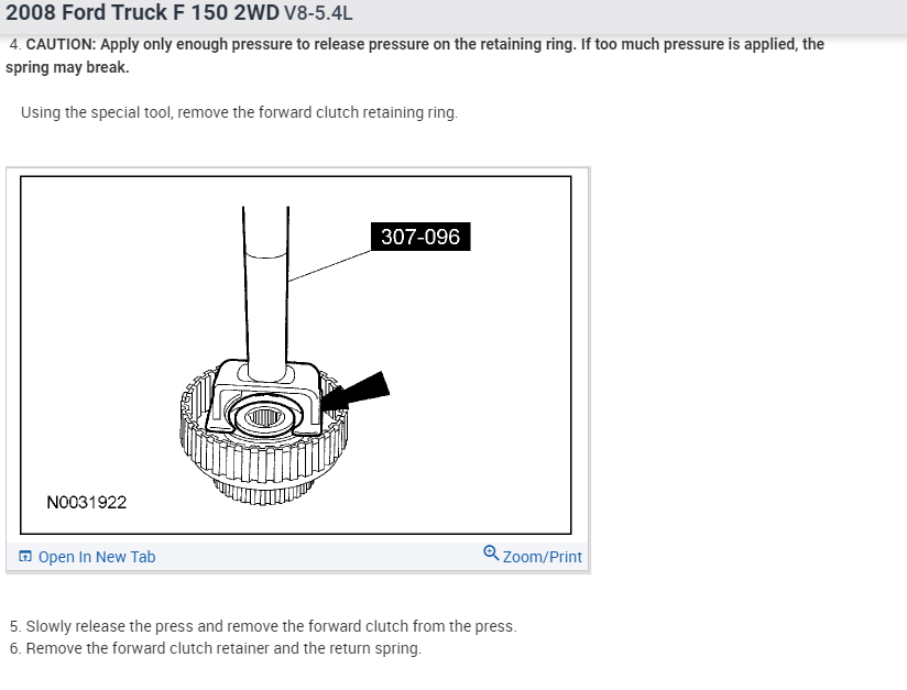

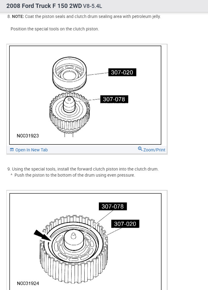

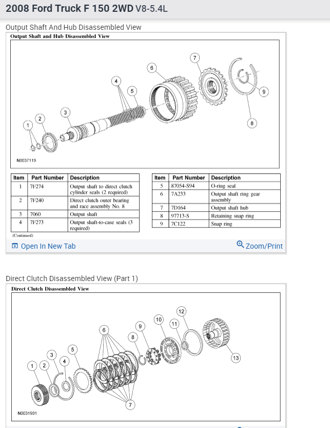

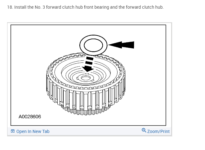

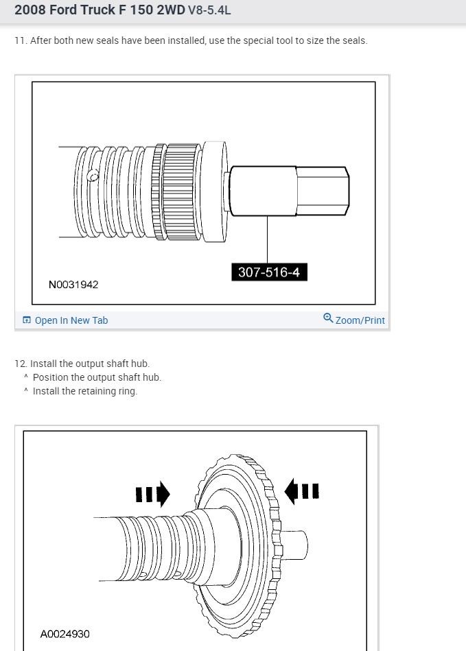

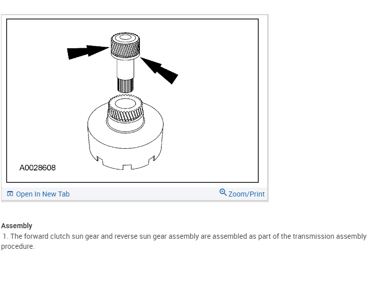

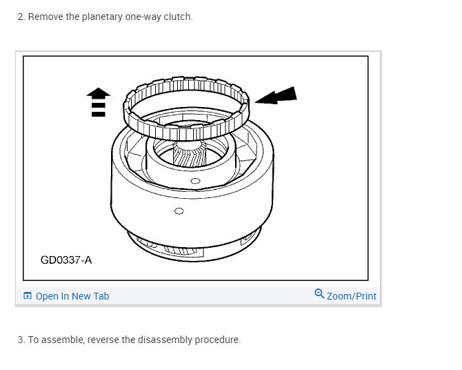

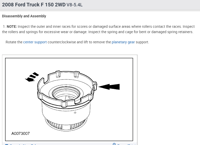

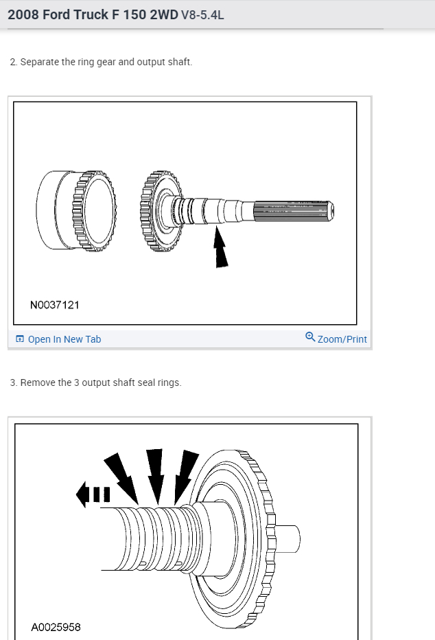

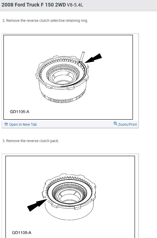

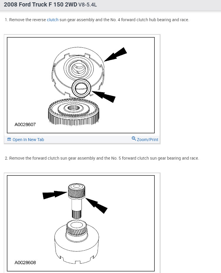

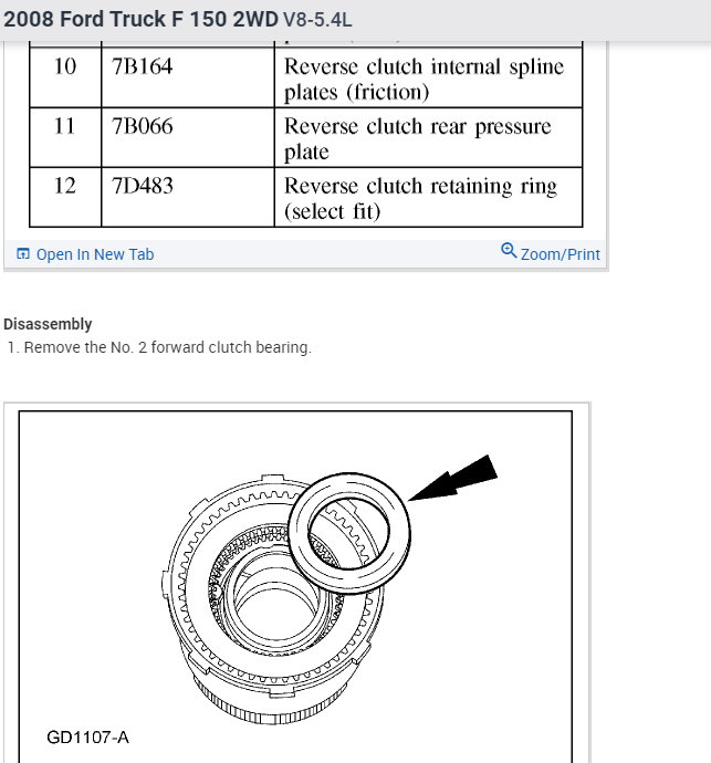

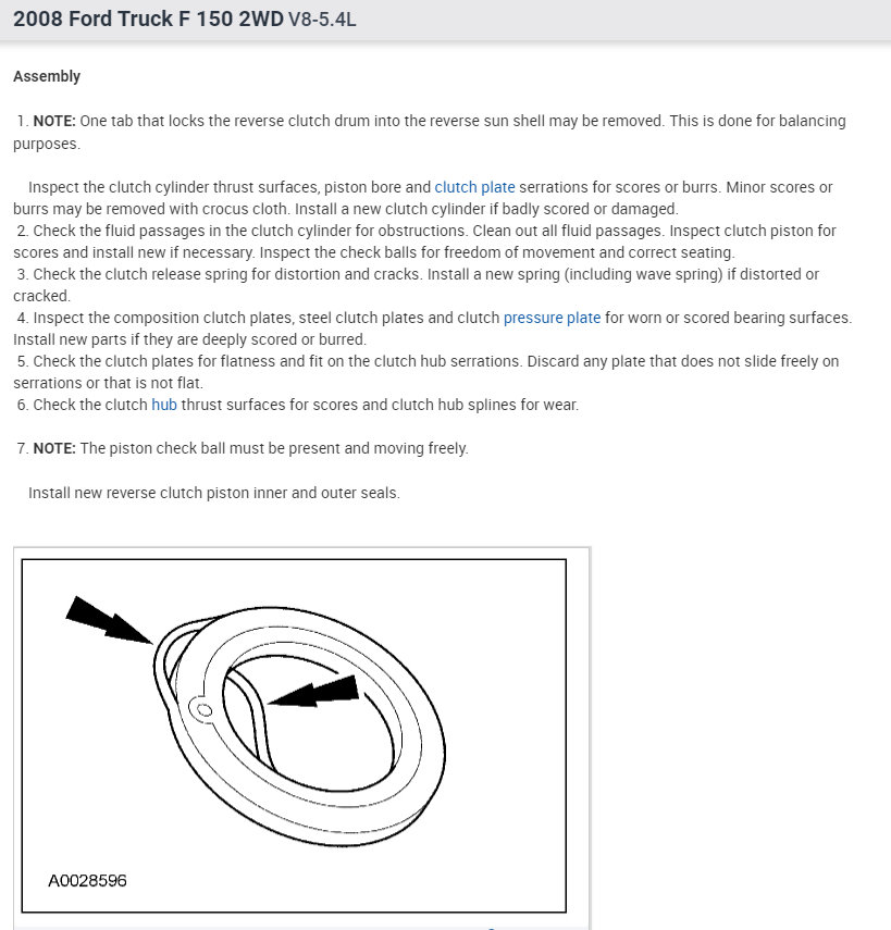

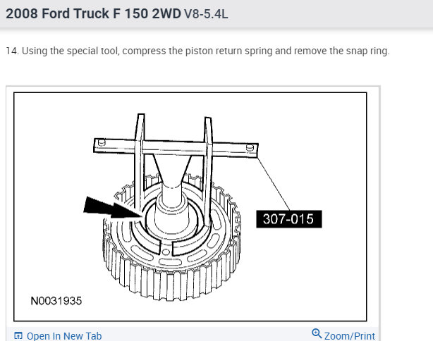

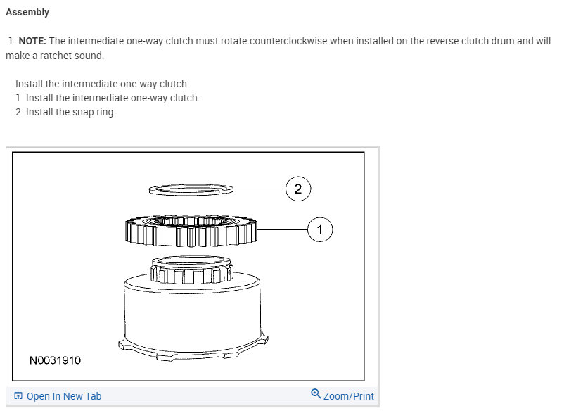

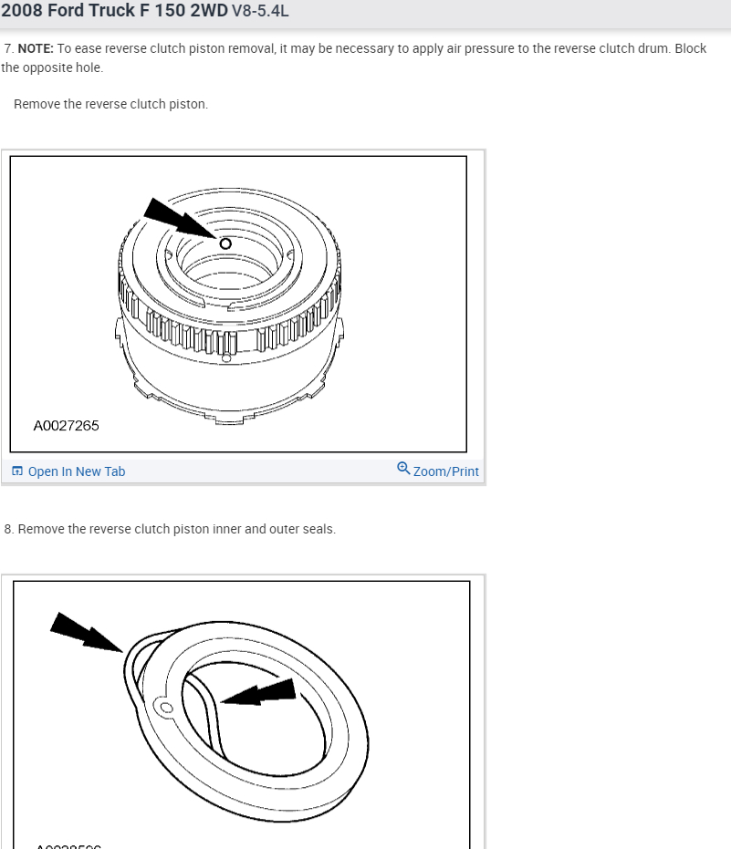

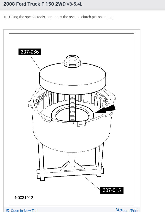

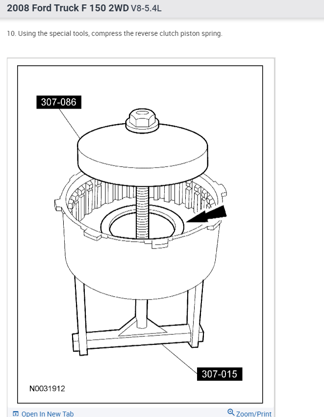

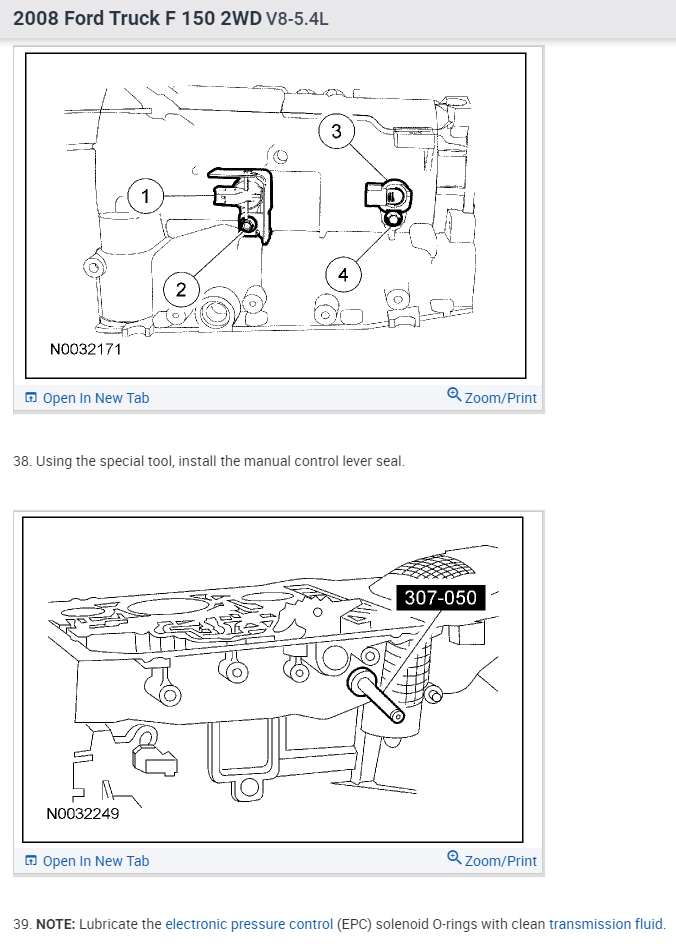

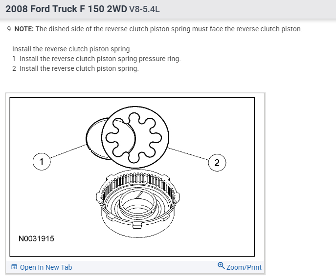

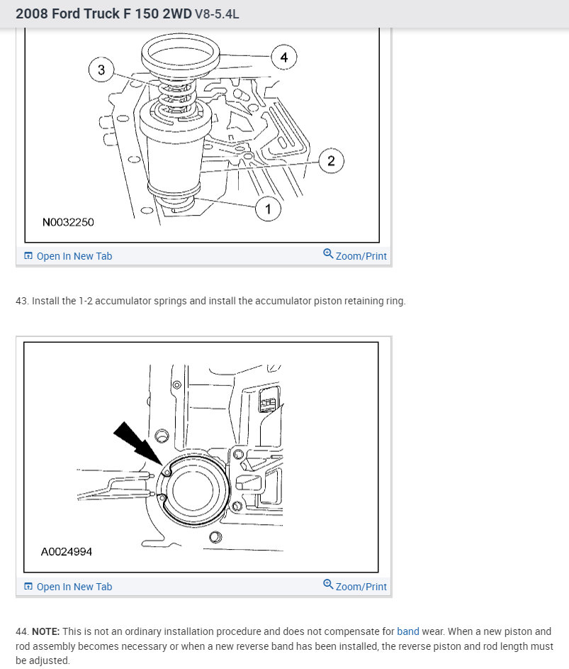

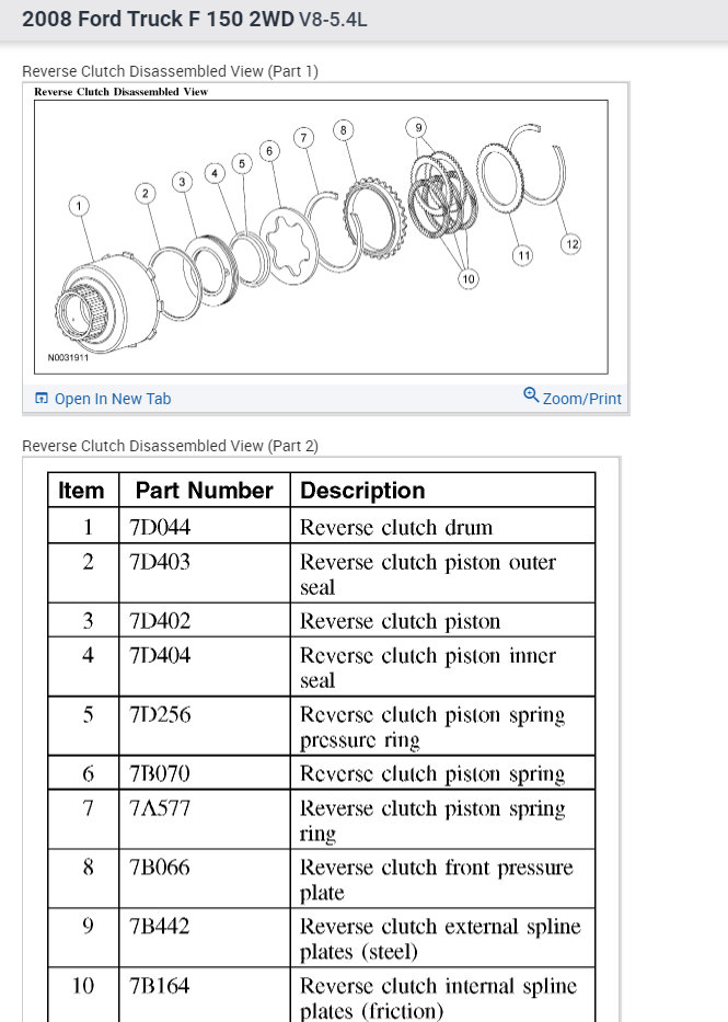

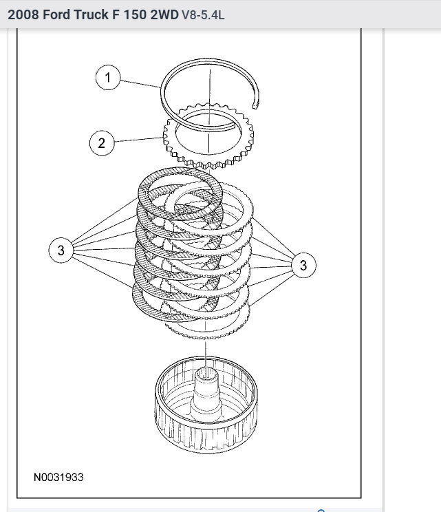

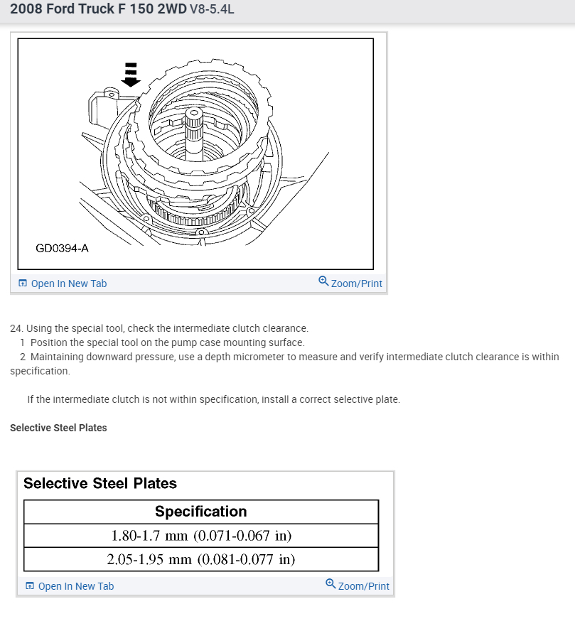

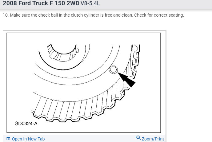

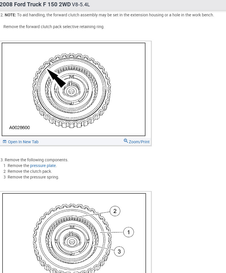

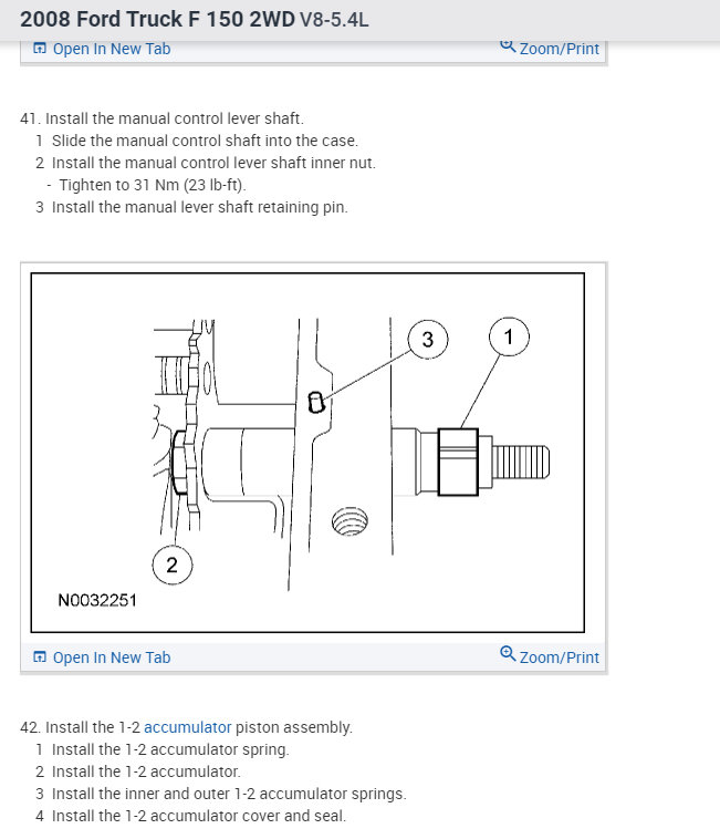

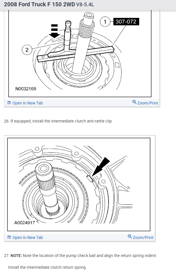

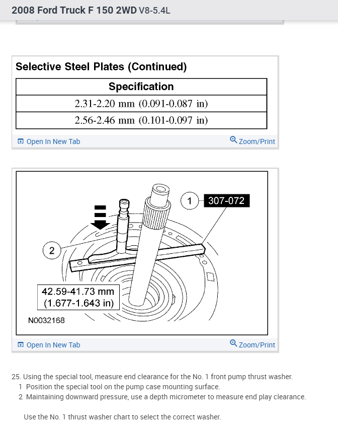

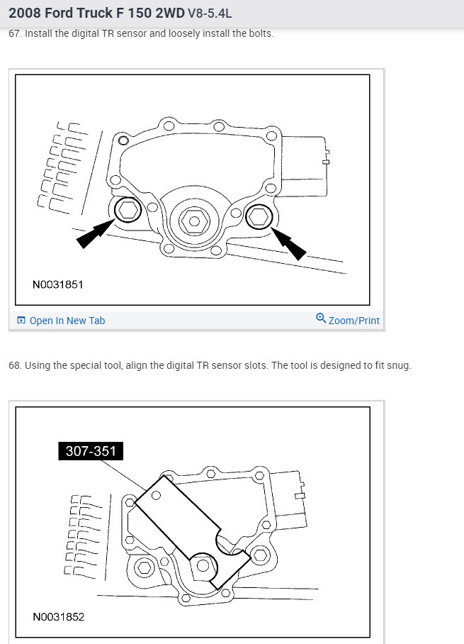

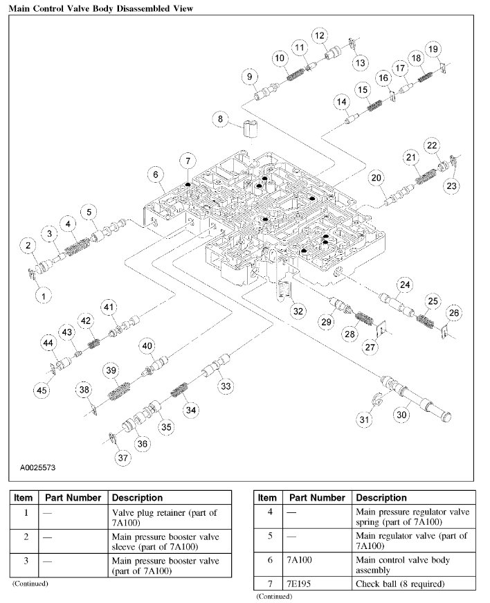

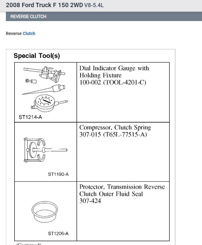

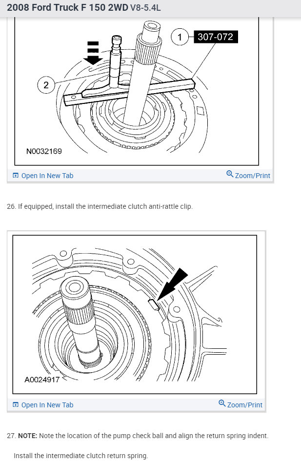

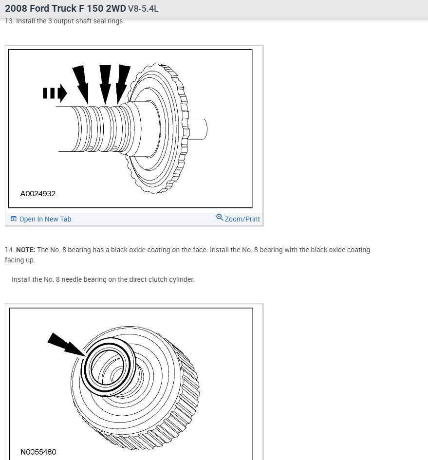

I keep seeing “in the sub assembly section” in the directions but don’t see the actual section. Can you post the instructions to assemble the sub assemblies?
Jul 2, 2022 at 7:09 AM
SQM
  • 6,383 POSTS

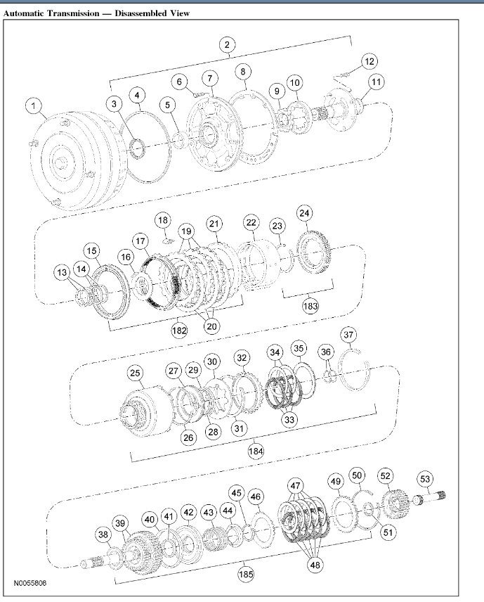

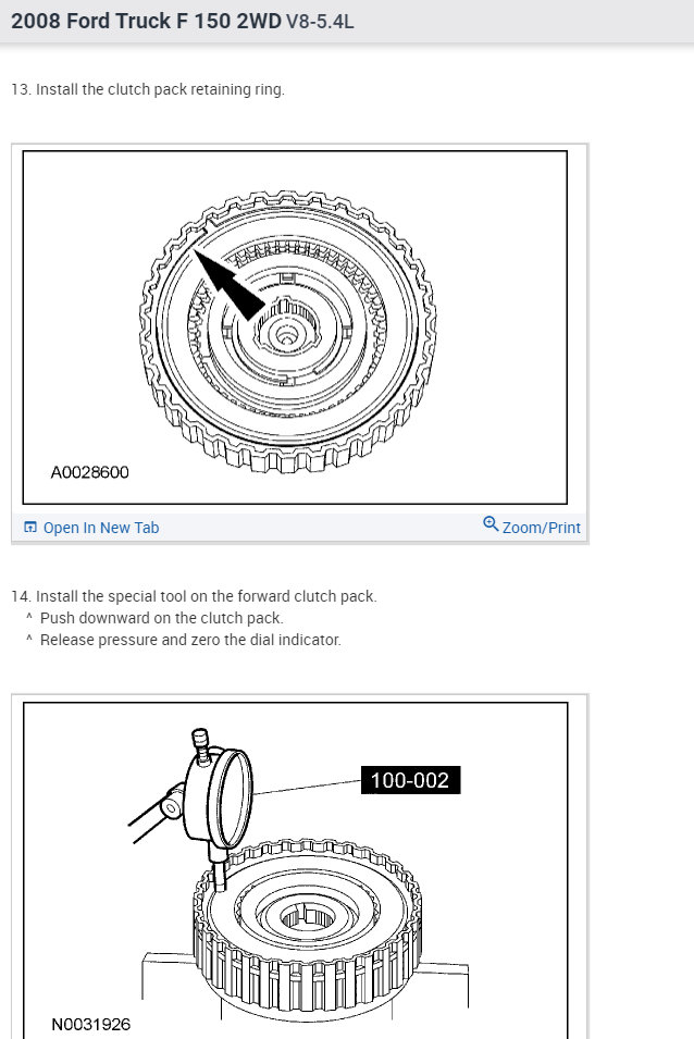

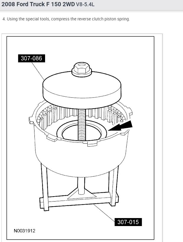

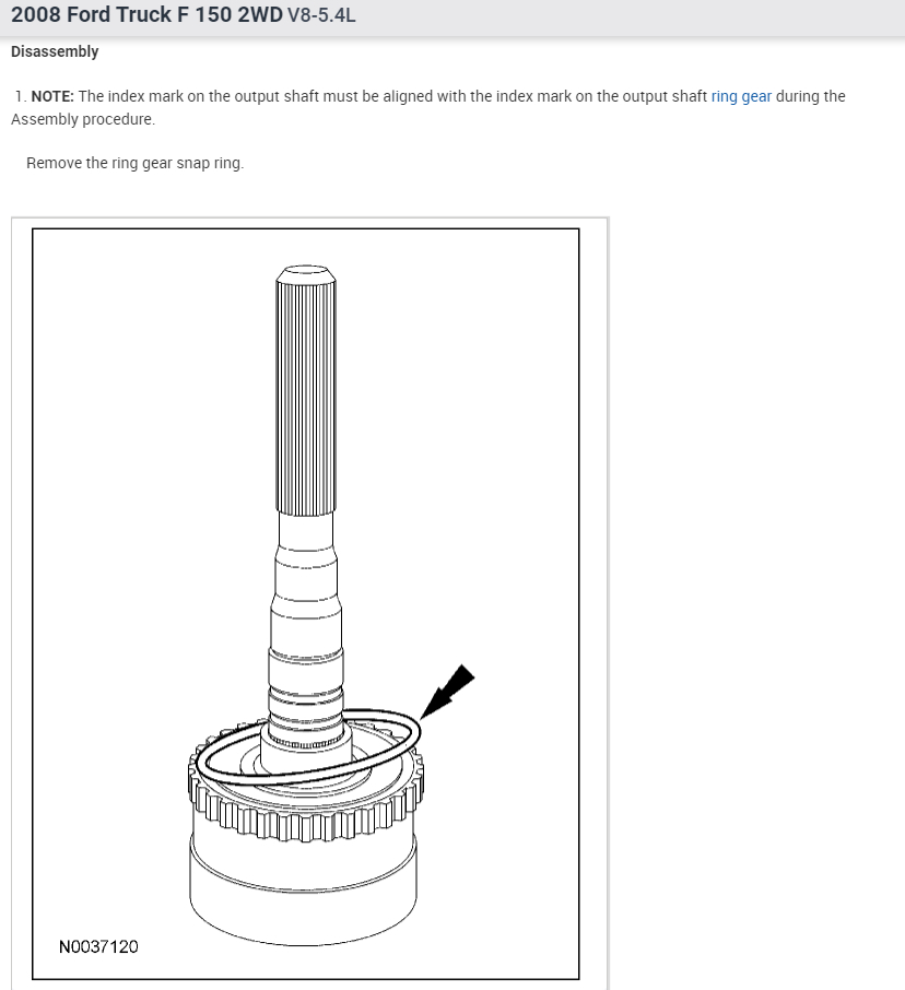

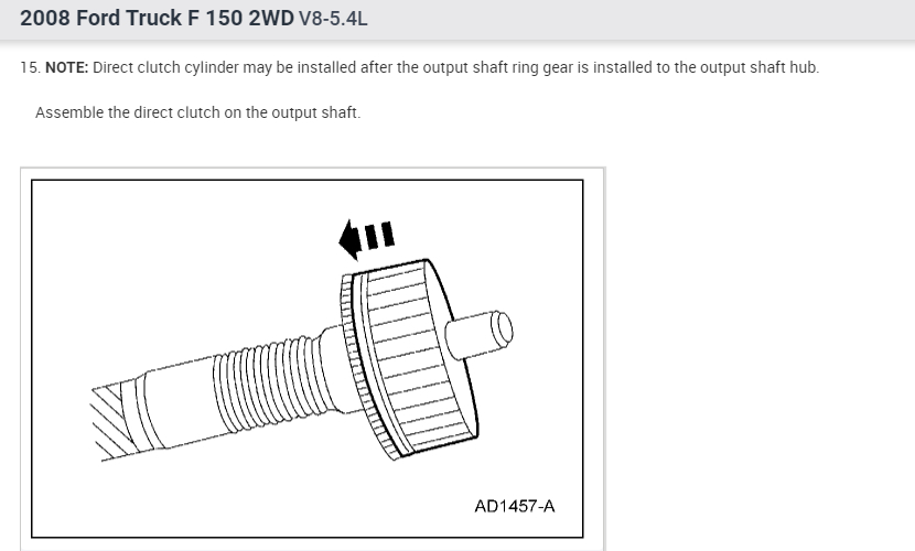

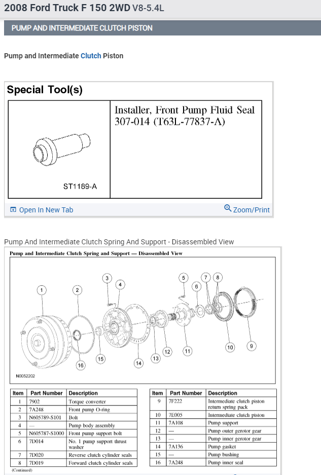

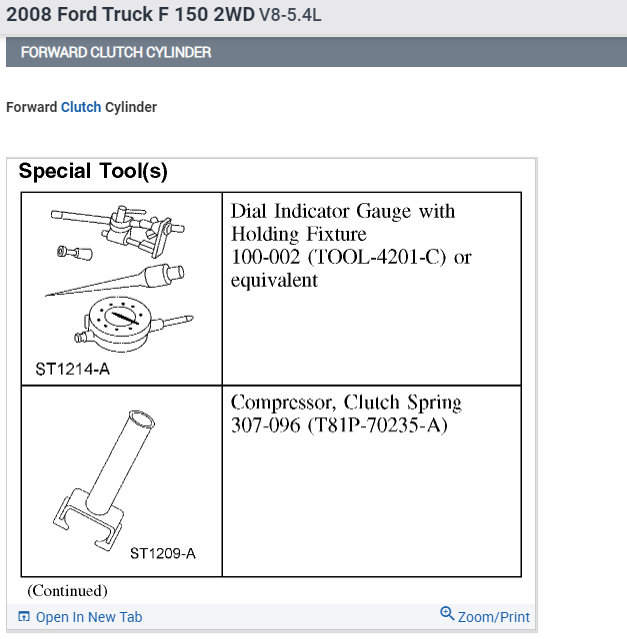

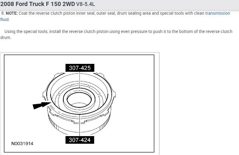

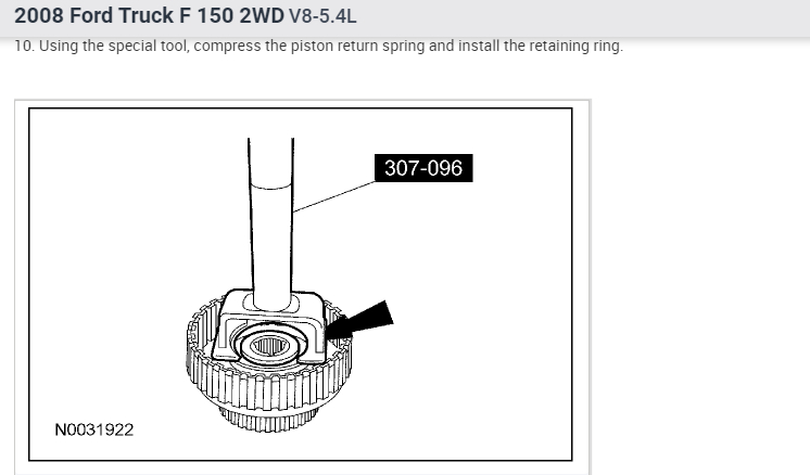

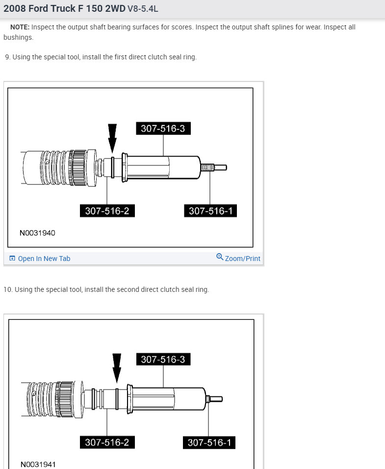

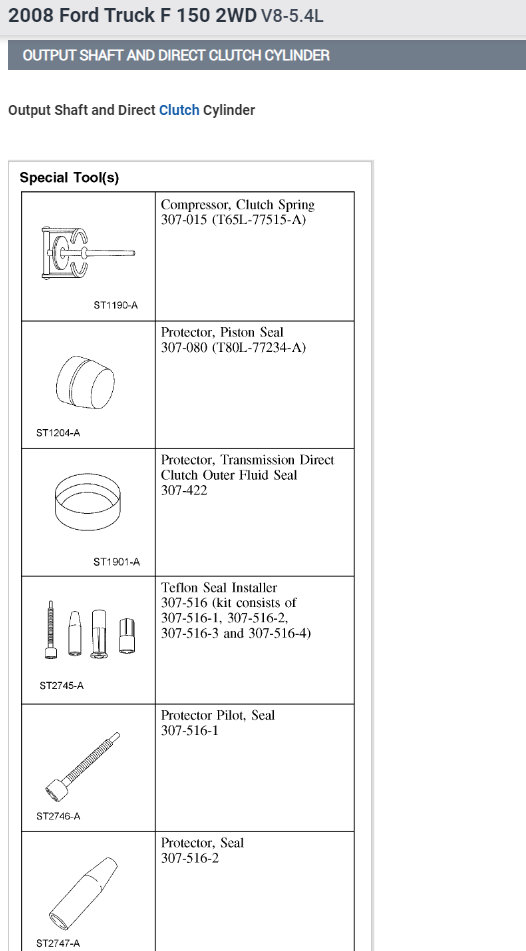

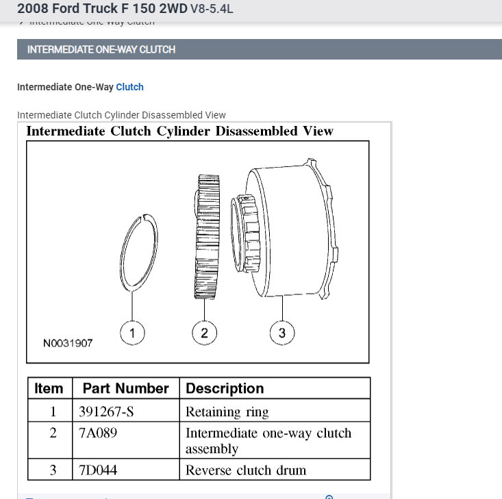

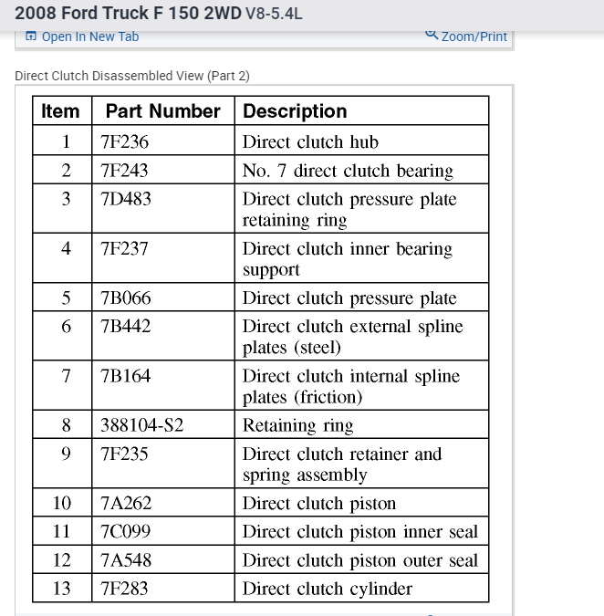

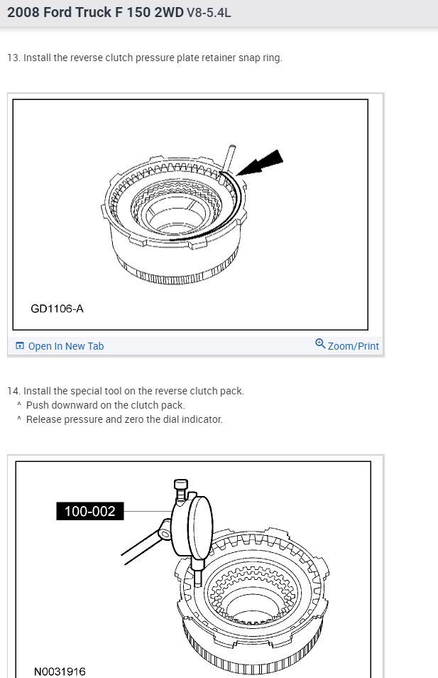

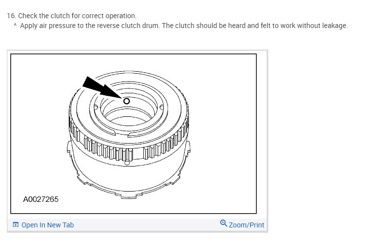

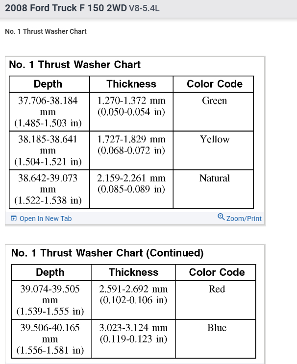

These are the subassemblies that have more details:
Forward Clutch Cylinder
Intermediate One-Way Clutch
Main Control Valve Body
Output Shaft and Direct Clutch Cylinder
Planetary Gear Support Assembly and Planetary One-Way Clutch
Pump and Intermediate Clutch Piston
Reverse Clutch
Reverse Sun Gear
Let me know which one you want to take a look at.
Jul 3, 2022 at 4:04 PM
ARIANADANIELLE5345
  • 402 POSTS
All of them. I literally took everything completely apart.
Jul 6, 2022 at 7:12 AM
SQM
  • 6,383 POSTS

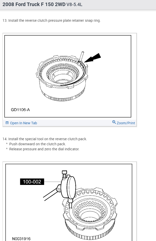

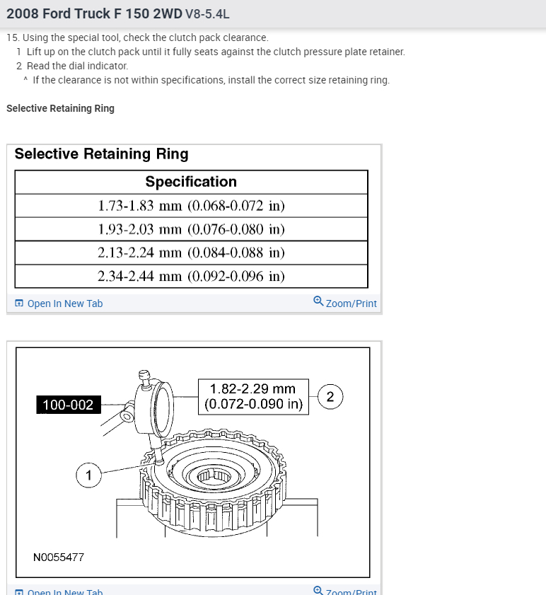

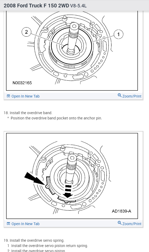

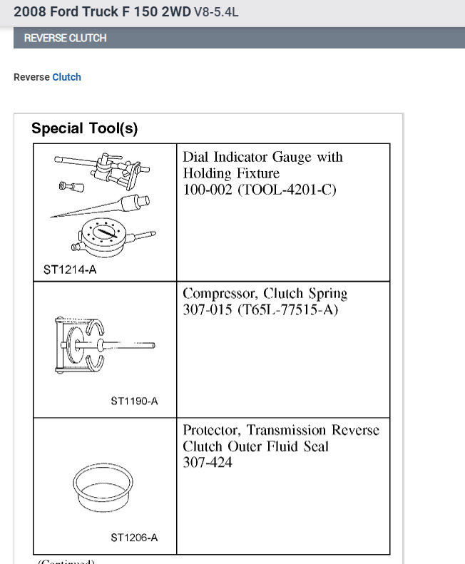

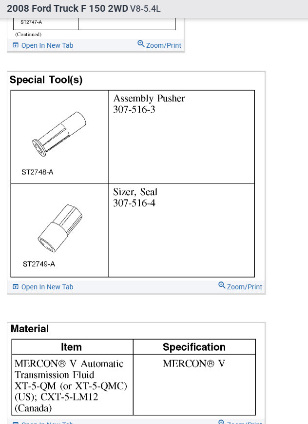

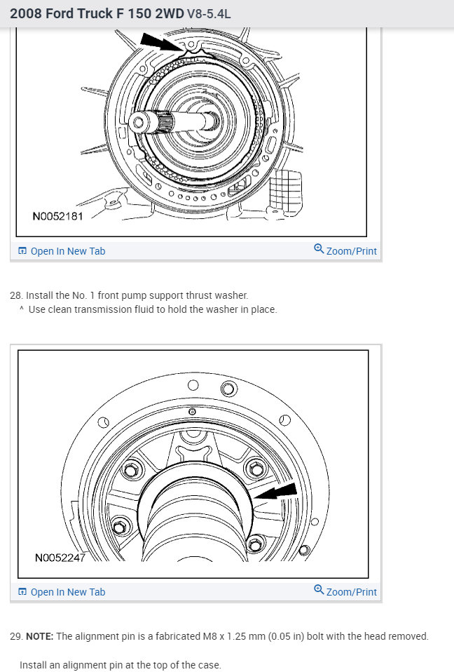

See attached.
Jul 6, 2022 at 4:20 PM
ARIANADANIELLE5345
  • 402 POSTS
Oh wow that’s perfect. Thank you!
