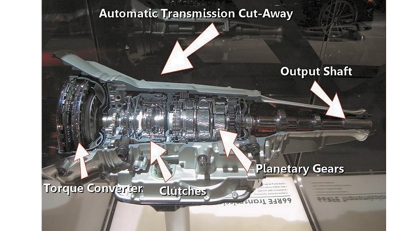

Automatic Transmission
The automatic transmission consists of: a transmission case, planetary gear-sets, valve body, fluid cooler (in radiator) and a torque converter. A torque converter utilizes transmission fluid as a coupling agent allowing the engine to run while the car is stopped without stalling. Then when the engine speed is increased, re-engaging the transmission to make the car move. A series of clutches and bands control the planetary gear sets to provide multiple forward gear ratios. The valve body is the hydraulic control center that receives pressurized fluid via the main transmission pump. This transmission gear system is controlled by the computer PCM (power control module.)
Automatic Transmission cut-away Image
