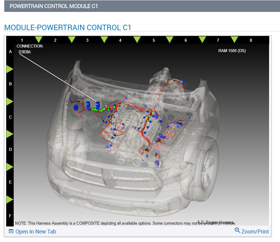

The transmission started acting up shifting into fifth and sixth. It acted like it went into limp mode. So I checked transmission fluid. When I did I noticed that the dip stick tube was broke into where it bolts onto housing. If I put transmission into fourth gear manually it shifted just fine. But overdrive did not work. Then it started acting up when it shifted into fourth. Now it only works if you shift it into third manually. If it shifts into fourth, the RPM's go up like it is slipping and you cannot get it to shift out of fourth. The only way to get it to work again is to stop put truck into park and turn ignition of and restart truck.
Thursday, November 1st, 2018 AT 3:26 PM
KEN L
  • MASTER CERTIFIED MECHANIC
  • 48,363 POSTS
It sounds like the transmission is going out or the PCM, but we should do a pin to pin test using the wiring diagrams from earlier and follow this guide to confirm.
If you want to try the PCM here is the location you can get a programmed unit from eBay.

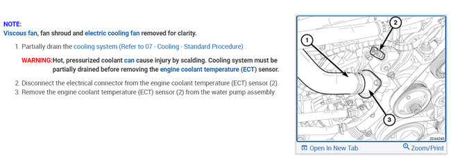

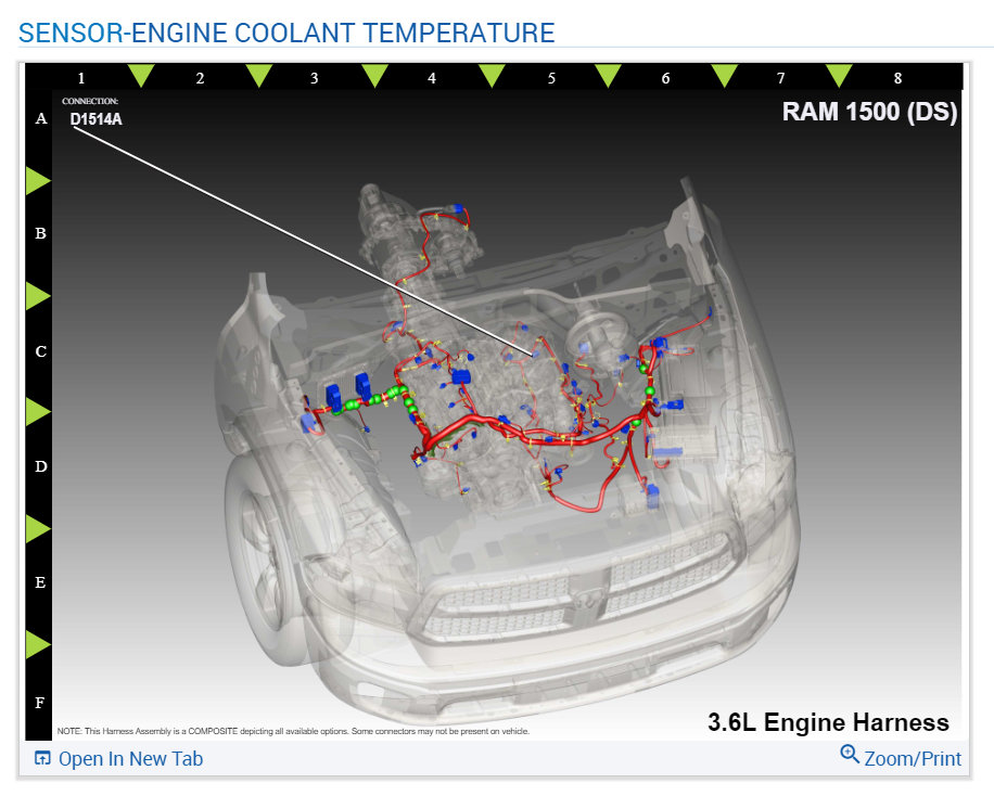

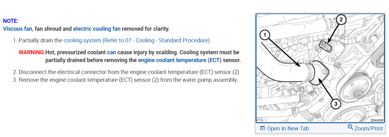

I cleared codes. P0118 pops up when I turn key on and run codes.
Tuesday, November 6th, 2018 AT 11:34 AM
KEN L
  • 48,363 POSTS
That is for the engine coolant sensor which can cause all kinds of issues. Let's check the connection at the sensor if all looks okay replace the sensor. Here is a guide to walk you through the steps and the location of the sensor for your truck below:
https://www.2carpros.com/articles/coolant-temperature-sensor-cts-replacement
Clear the codes when completed. Check out the diagrams (below). Please let us know what happens.
