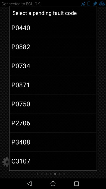

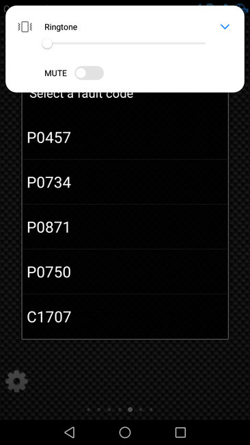

Yes. The two newest codes are gear 4 ratio and low pressure sensor c circuit.

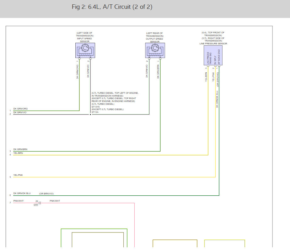

Can I get the code numbers please? It sounds like the input shaft sensor is not working right or you have a shift solenoid that is shorted out. Please let me know.

Where is the input shaft sensor located at?

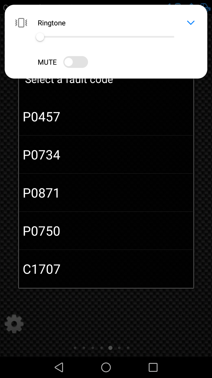

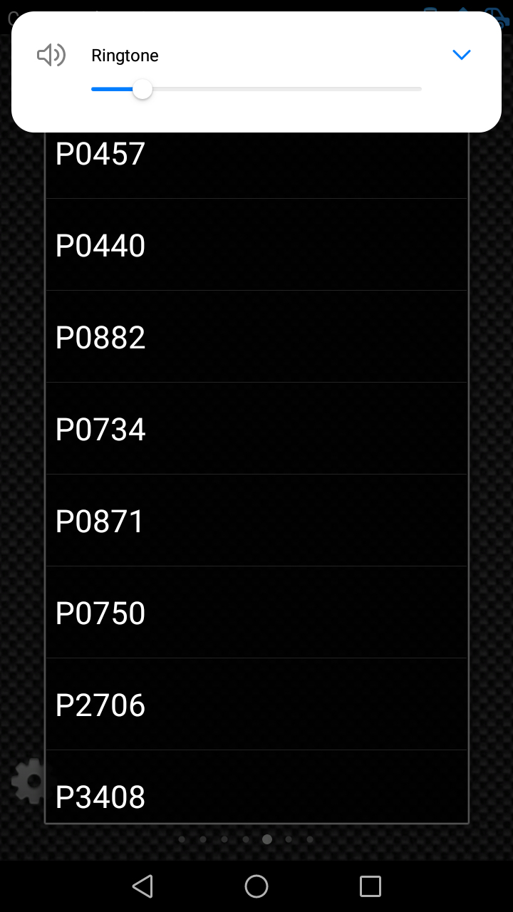

I did that. The 2 codes that popped up after I cleared them and drove was p0871 and either p0882 or p0871. I will do it again.
Oct 24, 2018 at 9:10 AM
  • 55,224 POSTS
Yes, clear the codes then don't start the engine, just turn the key on then run the codes.
Oct 25, 2018 at 9:59 AM
ROCKY RATLIFF
  • 17 POSTS
I did that and no codes popped up.
Oct 25, 2018 at 11:16 PM
  • 55,224 POSTS
Excellent. Now start the engine and shut it off and run the codes do not drive it.
Oct 26, 2018 at 3:32 AM
ROCKY RATLIFF
  • 17 POSTS
Okay. I did that and still no codes.
Oct 27, 2018 at 5:03 AM
  • 55,224 POSTS

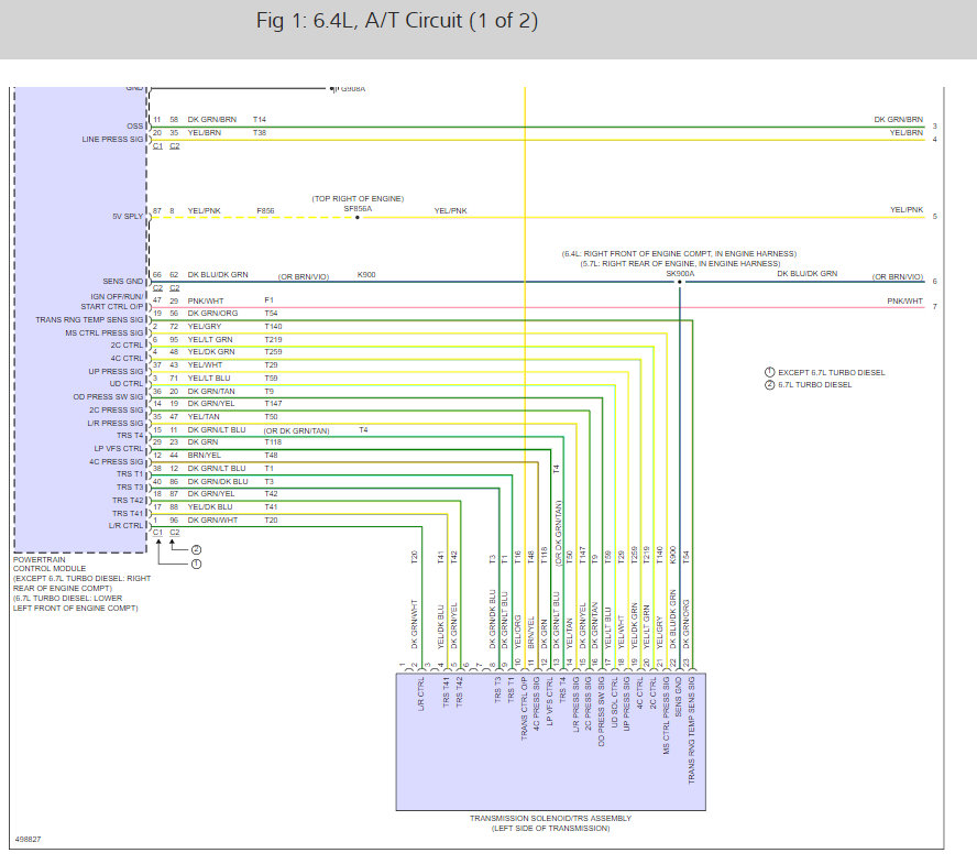

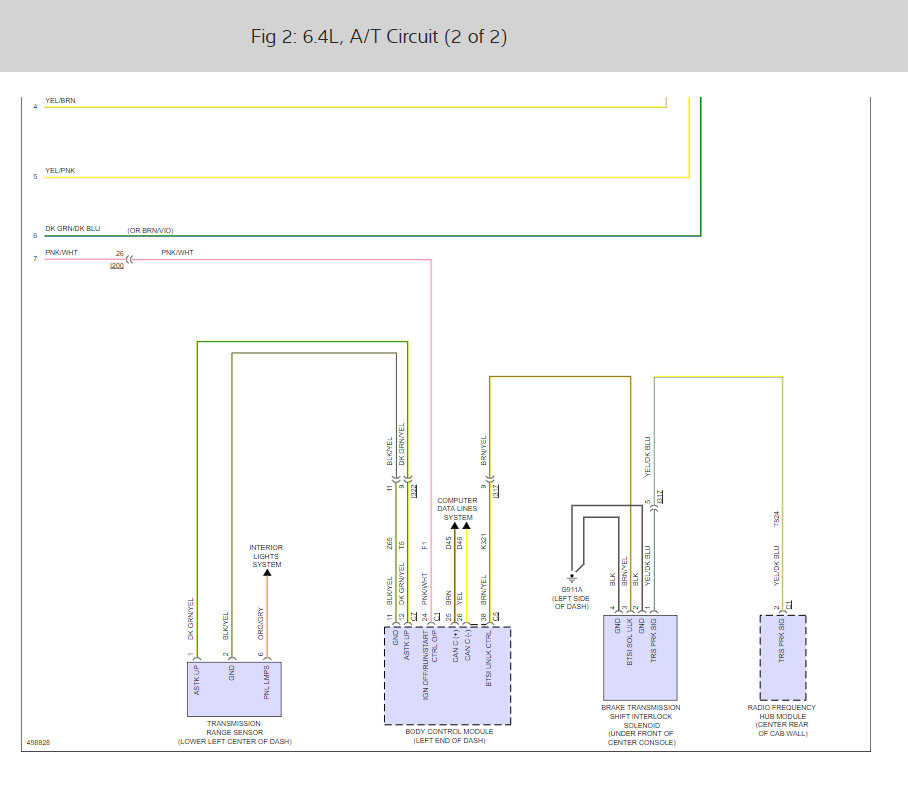

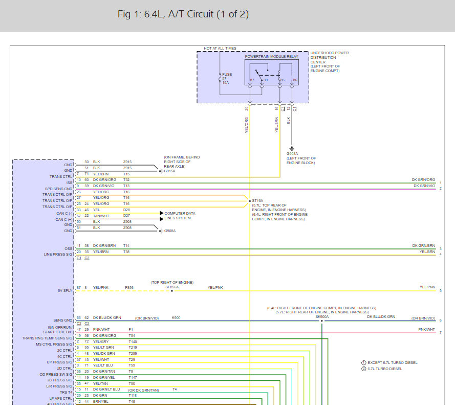

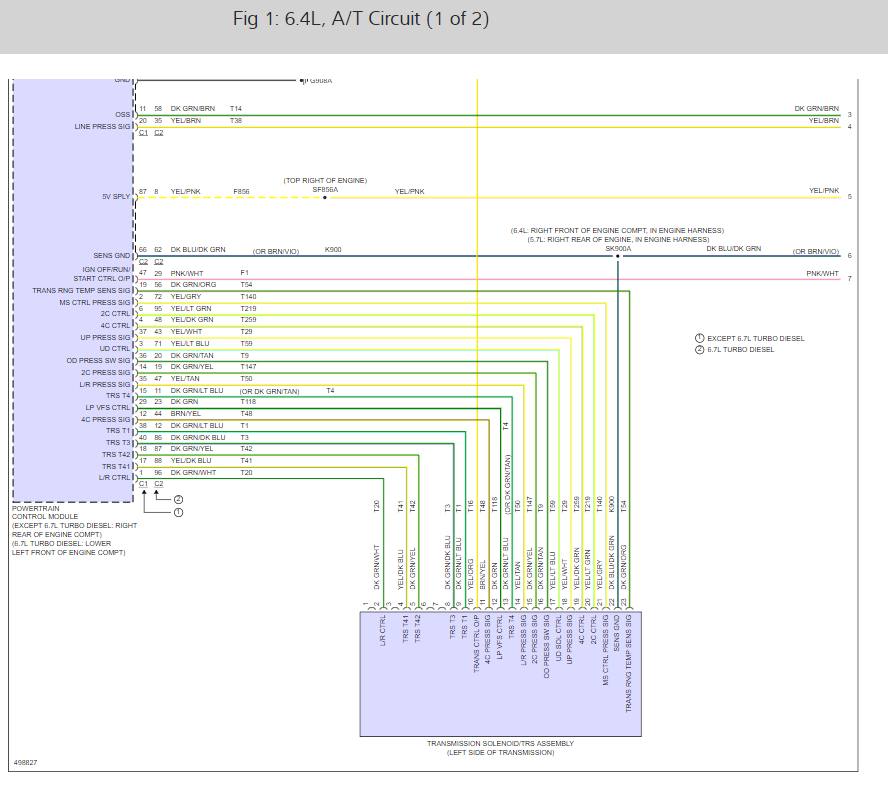

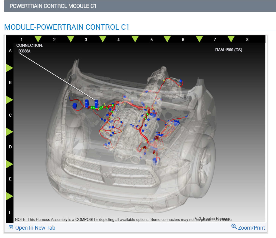

Okay cool, so we got p0882 and p0871 both transmission related codes. I have seen the TRS go bad causing the codes but we should do a pin th pin to make sure the connection are all good. Here is a guide to help us with that and the transmission wiring diagrams so you can see how it works with instructions on how to change out the TRS.
Oct 28, 2018 at 3:45 AM
ROCKY RATLIFF
  • 17 POSTS

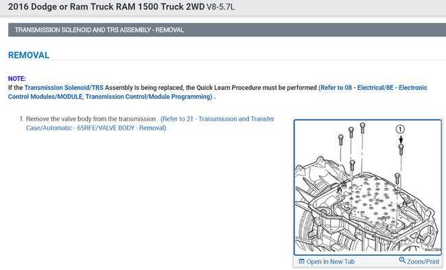

I seen that one of the pictures was for a 1500. I wanted the make sure that it didn't make a difference.
Oct 29, 2018 at 5:28 PM
  • 55,224 POSTS
They should be the same, let me know if the colors do not match up but they should.
Oct 30, 2018 at 5:14 AM
ROCKY RATLIFF
  • 17 POSTS

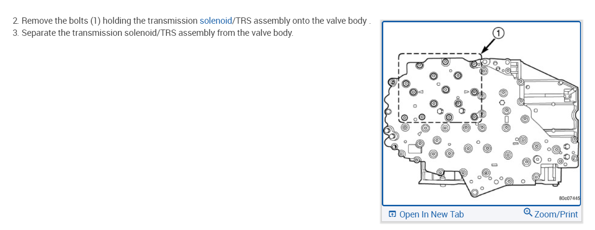

Where is the trs located at?
Oct 30, 2018 at 11:08 AM
  • 55,224 POSTS
Check out the diagrams above, it looks like the TRS is located in the valve body.

Is everything the same as the 65 rfe as the 66 rfe? The diagram shows it is a 65 rfe. My transmission is a 66 rfe.

It sounds like the transmission is going out or the PCM, but we should do a pin to pin test using the wiring diagrams from earlier and follow this guide to confirm.
If you want to try the PCM here is the location you can get a programmed unit from eBay.

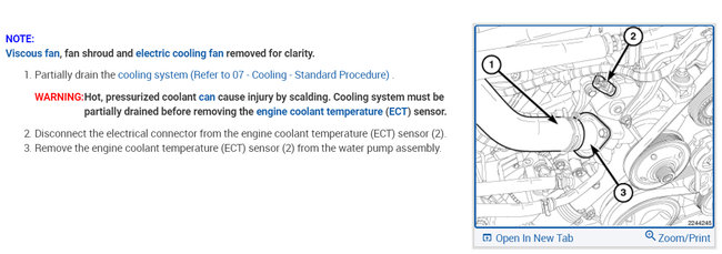

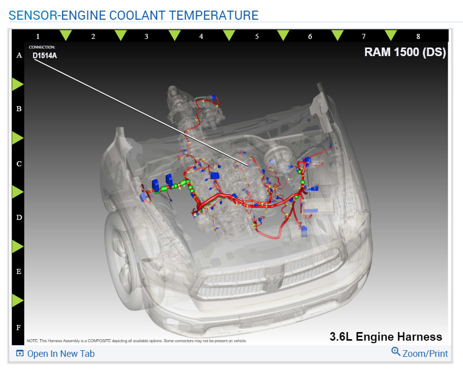

I cleared codes. P0118 pops up when I turn key on and run codes.
Nov 6, 2018 at 3:34 AM
  • 55,224 POSTS
That is for the engine coolant sensor which can cause all kinds of issues. Let's check the connection at the sensor if all looks okay replace the sensor. Here is a guide to walk you through the steps and the location of the sensor for your truck below:
https://www.2carpros.com/articles/coolant-temperature-sensor-cts-replacement
Clear the codes when completed. Check out the diagrams (below). Please let us know what happens.
