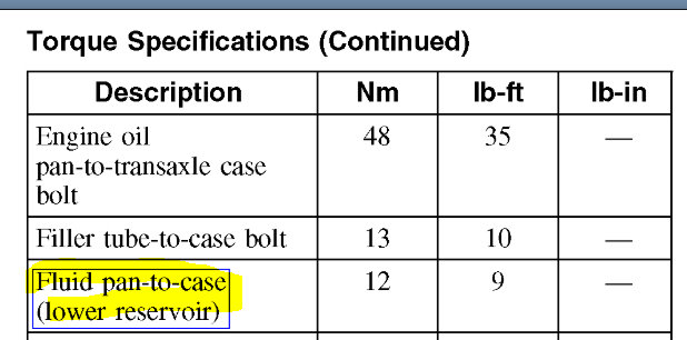

I really need the torque for the car listed above transmission pan bolts pretty please. I have to change the filter really really soon and I can't find the torque anywhere. Can you help me please? Thank you so much for taking the time to read this.
Diggs
Jan 18, 2020 at 10:40 AM
  • 110,240 POSTS
See the attached pic. Let me know if this helps.
Jan 18, 2020 at 1:51 PM
DIGGSIES
  • 20 POSTS
I really hope this helps. I can't tell if that is for the transmission pan but it looks like it could be. I'll put them on at 9. Thank you so much! I couldn't find it anywhere.
Jan 18, 2020 at 11:13 PM
  • 110,240 POSTS
I found that on Alldata. It's an excellent manual and I went under transmission torque specs. With that, it should be correct.
Please feel free to let me know if I can help. Also, I realize 9 ft/lbs seems loose, but you are placing a steel bolt into an aluminum housing. They strip easily, so be careful. Plus, you don't want the gasket to squeeze out from it's positioning.
Take care and let me know if you need anything.

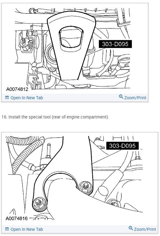

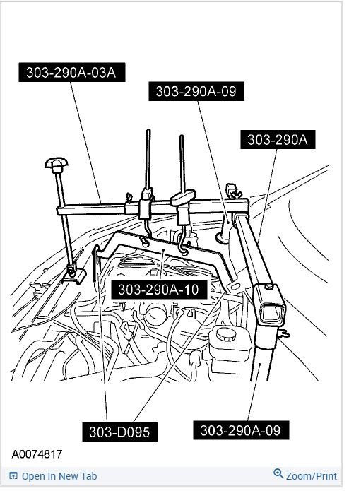

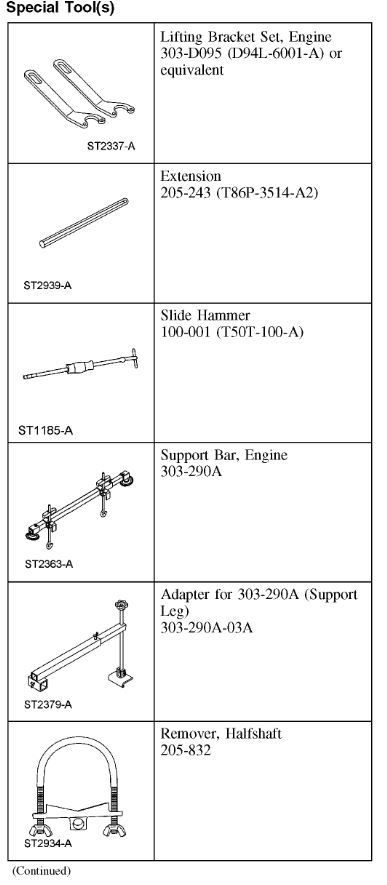

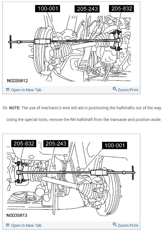

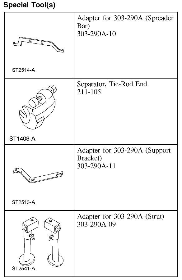

That's a good price for a drop in. About what my guy gets for a re-build.
The transmission comes out the bottom. The hardest part is usually getting the car up high enough to get it out. You use an engine support to hold the engine up, then drop the cradle out from under it and then remove the trans-axle. Book time is about 8 hours to do the job.
For the same info the shops and we use you can get Alldata DIY or Mitchell for $30.00 a year. Both will show the removal and install as well as a lot of other information.
http://www.alldatadiy.com/
https://www.eautorepair.net/Marketing/Default.asp
Tool wise the pictures are the special tools. Out of all of the listed pieces the only one that is really handy is the tie rode tool.
The engine support is a couple legs and a brace that set over the engine and bolt to it on the exhaust manifolds. I've used a regular engine lift, or make a simple crossbeam out of a 4X4 cut so it goes across the engine bay and on the strut towers and core support. Then a chain to a couple handy spots on the engine.
The slide hammer can be replaced with a couple short pry bars, it's used to pop the half-shafts free from the transmission.

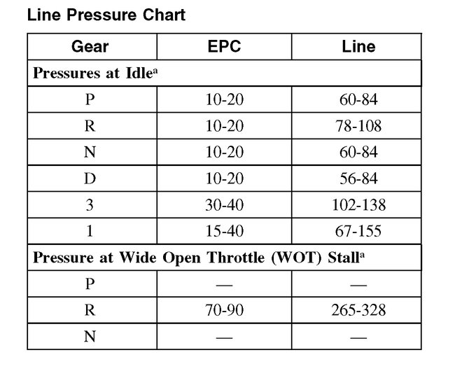

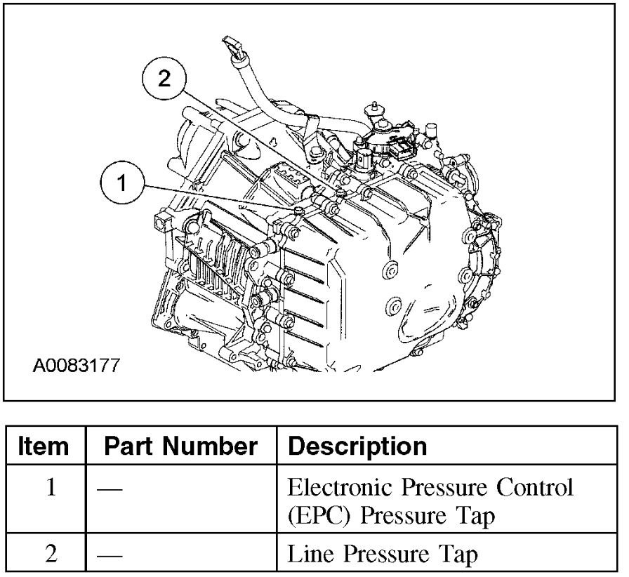

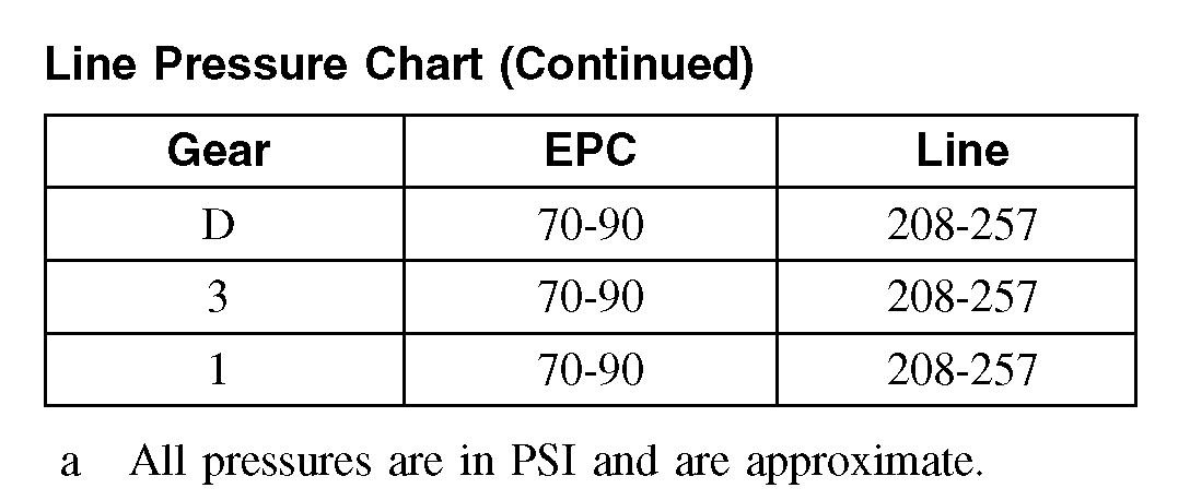

Based on your description, it sounds like a pressure related issue. Here are directions for testing transmission line pressure. It also indicates possible causes based on results.
______________________________________
2007 Ford Truck Freestar V6-3.9L VIN 6
4F50N (AX4N) Automatic Transaxle
Vehicle Transmission and Drivetrain Automatic Transmission/Transaxle Testing and Inspection Component Tests and General Diagnostics Line Pressure Test 4F50N (AX4N) Automatic Transaxle
4F50N (AX4N) AUTOMATIC TRANSAXLE
Line Pressure Test
Line Pressure Test
Pic 1
CAUTION: Carry out the Line Pressure Test prior to carrying out the Stall Speed Test. If the line pressure is low at stall, do not carry out the Stall Speed Test or further transaxle damage will occur. Do not maintain wide open throttle in any transaxle range for more than 5 seconds.
This test verifies that the line pressure is within specification.
1. Connect a pressure gauge to the line pressure tap.
2. Start the engine and check the line pressures. Refer to the line pressure chart to determine if the line pressure is within specification.
Line Pressure Chart (Part 1)
pic 2
Line Pressure Chart (Part 2)
pic 3

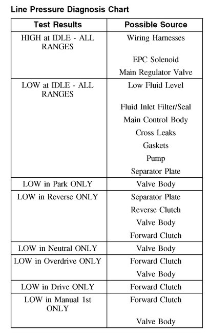

3. If the line pressure is not within specification, check EPC pressure.
4. Connect a pressure gauge to the EPC pressure tap.
5. Start the engine and check the EPC pressure. Refer to the line pressure chart for specifications.
6. If the EPC pressure is not within specification, GO to Pinpoint Test E to diagnose the EPC operation. If EPC operation is OK, refer to the line pressure diagnosis chart for line pressure concern causes. See: Automatic Transmission/Transaxle > Pinpoint Tests > Test E: Electronic Pressure Control (EPC) Solenoid
Line Pressure Diagnosis Chart
Let me know what you find. I hope it's a simple fix. I have to be honest, these transmission usually don't fail like this.

You should be able to get a pressure test gauge at a parts store as a loaner tool instead of buying something as a one time purchase. Both the line pressure and the electronic pressure port are on top of the transmission. To the left of the electrical connector.

Finally got the gauge set. Had to order one off the net. No stores had one available for purchase, rent or loan. Did line test and found very low pressure in 3rd gear at idle. Did not preform stall test as everything I saw said not to if test at idle was not in range. 3 came in at 79. Your chart says it should be at 102 - 138.
Line pressures were as follows:
P 72 1/2
R 92
N 76
D 79
3 79
1 110
I see your troubleshooting table says possible causes low at idle all gears etc but I'm not sure how to pinpoint further or if you can chime in on it knowing infinitely more than I do and having a working brain unlike the chart. At this point it hasn't fully slipped a gear (no movement of vehicle under throttle) since I started to baby it, but it will go to clacking a bunch if I accelerate too quickly. As in, anything more than the oldest granny on her way to the oldest church down the oldest dirt road.
I need to know if it will be necessary and more cost effective to just replace this trans-axle with a re-manufactured one which has a 3 year warranty or else to fix this machine. I can swap parts easily enough, especially with the information you all gave me about the subscription services. I can drop and install the new trans-axle easily enough for what it is if need be too. It will just take me about a month to get the funds together since I'm on stupid work comp with these knee surgeries.
Do you recommend doing the epc test as well or not and if not do you recommend the re-manufactured transmission or else swapping other parts and bits or else some other tests to confirm or deny a failing piece, part or bit?
I will do whatever needs to be done.
Thank you both for all of your help and thank you too admin for checking up and weighing in.

  • 20 POSTS
Okay epc complete. 3 was the only one out of range. It was low at 17. Was supposed to be 30 - 40.
Epc pressures were as follows:
P 15.5
R 15
N 15.5
D 17
3 17
1 27
Feb 1, 2020 at 6:09 AM
