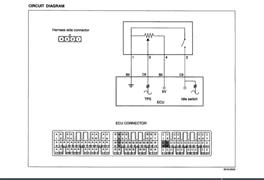

i changed fuel pump and mass airflow sensor then reset computer now it does not shift and revs up when changing shifting positions.

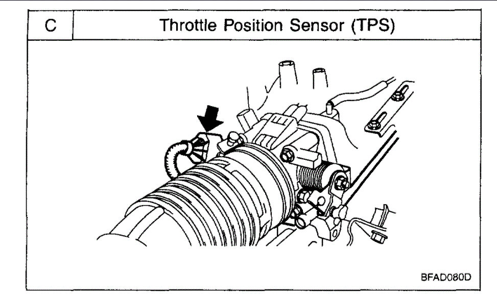

The transmission main sensor is the throttle position sensor. That sends a signal to the ECM where the fuel pedal is at and load and the ECM adjusts the time the transmission shifts.
This is why I am asking about codes. If the sensor was an issue, it should code. You can have the system read for free at a parts store.
I attached the location and the wiring diagram of the TPS for you. Do you have a voltmeter to test for voltage?

no, it didn't do that before. the throttle position sensor was my next step i wanted to ask to be more sure.
Aug 13, 2020 at 12:17 AM
I would verify voltages to the sensor before replacing the sensor.

i had taken sensor off to make sure it wasn't dirty could it be on wrong?
Aug 13, 2020 at 12:54 AM
No, because if it was, it would set a code for it.
