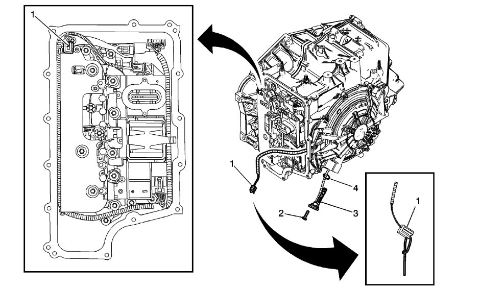

Car is showing, service ESC, loss of power reduction, and the check engine light is on, on the dash. took it to parts store, they hooked it up to the tester and said it was the transmission input speed sensor. Have the part need to see where it is located.
Feb 18, 2018 at 5:19 PM
Good morning.
I see no input speed sensor other than the sensor for the speedometer.
Let's start with the code that was set.
Feb 19, 2018 at 5:21 AM

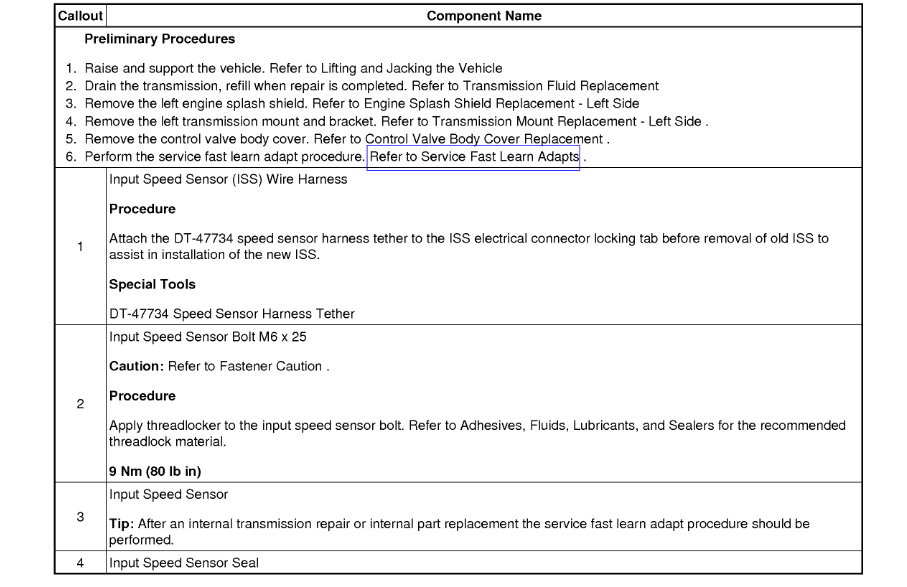

Found the sensor on another transmission listed for your car.
procedure and picture attached.
