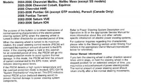

When I am driving slow, or pulling out of a parking spot its hard to turn my wheel??
Jan 30, 2021 at 12:43 AM (Merged)
JDL
  • 16,098 POSTS
Hello, I came across this bulletin, does it fit your problem? Have the trouble codes checked.

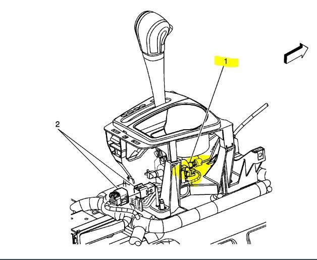

It is parked on level ground . How do I get it out of park? Is there a release somewhere? the brake lights don't work, so I know I have a fuse blown out. I will replace the fuse when I can . But , for now , what is the procedure to get it out of park and into neutral so that I can start it? Thank you so much.
  • 110,240 POSTS
Welcome to 2CarPros.
If the brake lights aren't working, it won't release from park. The park lock actuator gets power from the brake light switch. That needs fixed. As far as an over ride, you need to take apart the center console. Once removed, you will see the actuator (see picture). Basically, you need to move the actuator to release it.
Let me know if you get it working.
