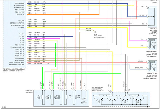

I bought this car a little while ago and it had some shifting problems. The code it was throwing was that third gears ratio was off. After researching and having a mechanic look at it, we came up with it being a bad valve body. I changed the valve body and the wiring harness for the valve body which was cross threaded onto the valve body which I thought was the issue. The fix improved its shifting, but it only shifts good after it's been running for about 20 minutes, and it is at operating temperature. It still slams into reverse, and it has no fourth gear. I can't find anything else that could be wrong with it.

Okay. so, the codes are P0706 transmission range sensor A circuit range/performance, P0732 gear 2 incorrect ratio, P0733 gear 3 incorrect ratio, P0741 torque converter clutch circuit performance/ stuck off, P0781 1-2 shift.

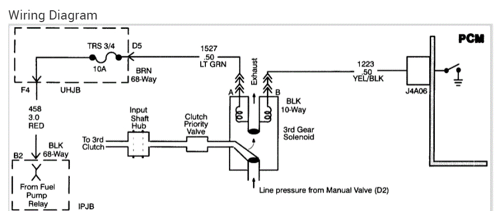

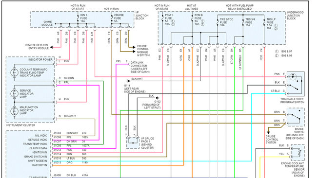

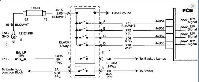

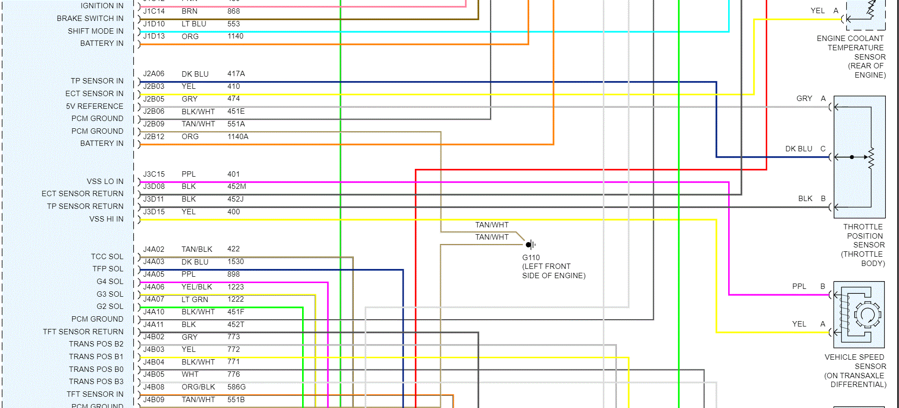

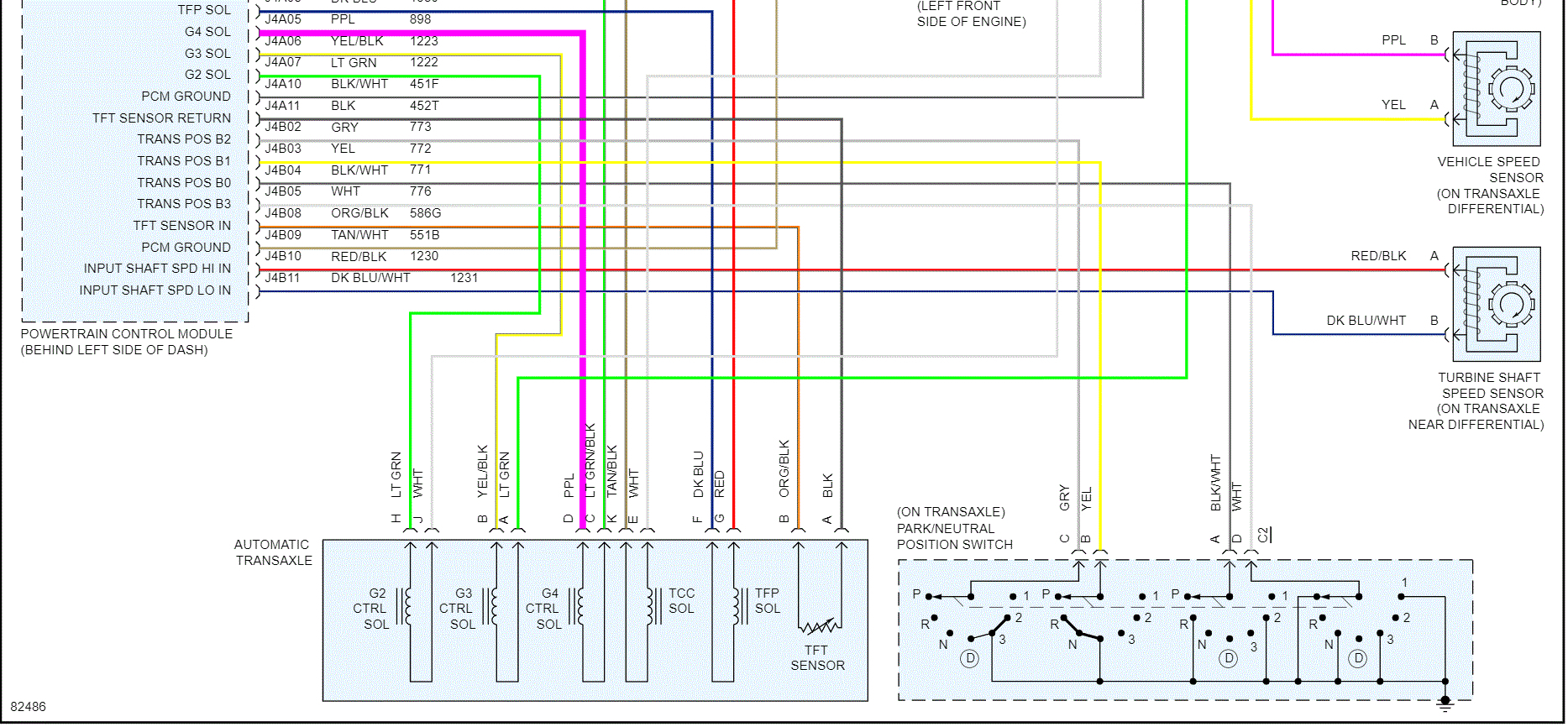

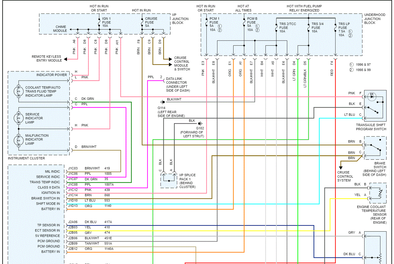

  • 110,240 POSTS
I attached the wiring schematic for the transmission circuit. I had to cut the pic in half to make it readable for you, but I did overlap them so you can follow from one to the next.
Take a look through them and let me know if you notice any variations from what you have done. Also, let me know if the new wiring harness was a direct fit component.
Mar 23, 2022 at 11:57 AM
EXISTEDTECH759
  • 13 POSTS
Well, I can't read diagrams well and three of the wires were the same color so I'm not sure what to do from here.
Mar 23, 2022 at 12:02 PM

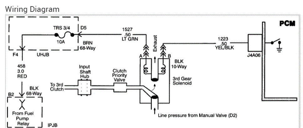

  • 110,240 POSTS
I will break the schematic into three. See if that helps. Also, if the wiring colors match, confirm they are going to the correct places.
Mar 23, 2022 at 12:10 PM
EXISTEDTECH759
  • 13 POSTS
Hey Joe,
I rewired the wiring harness and now the only code I have is third gear ratio incorrect and I still have no fourth gear. Where do I go from here?

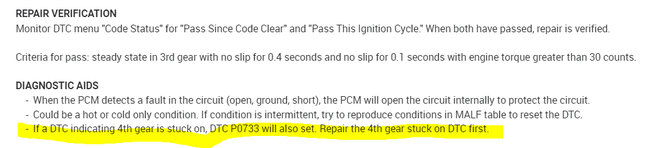

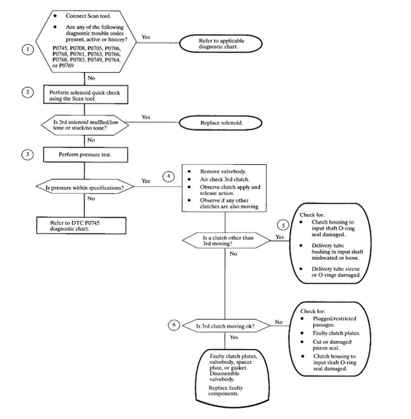

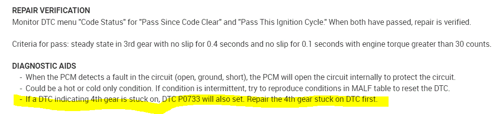

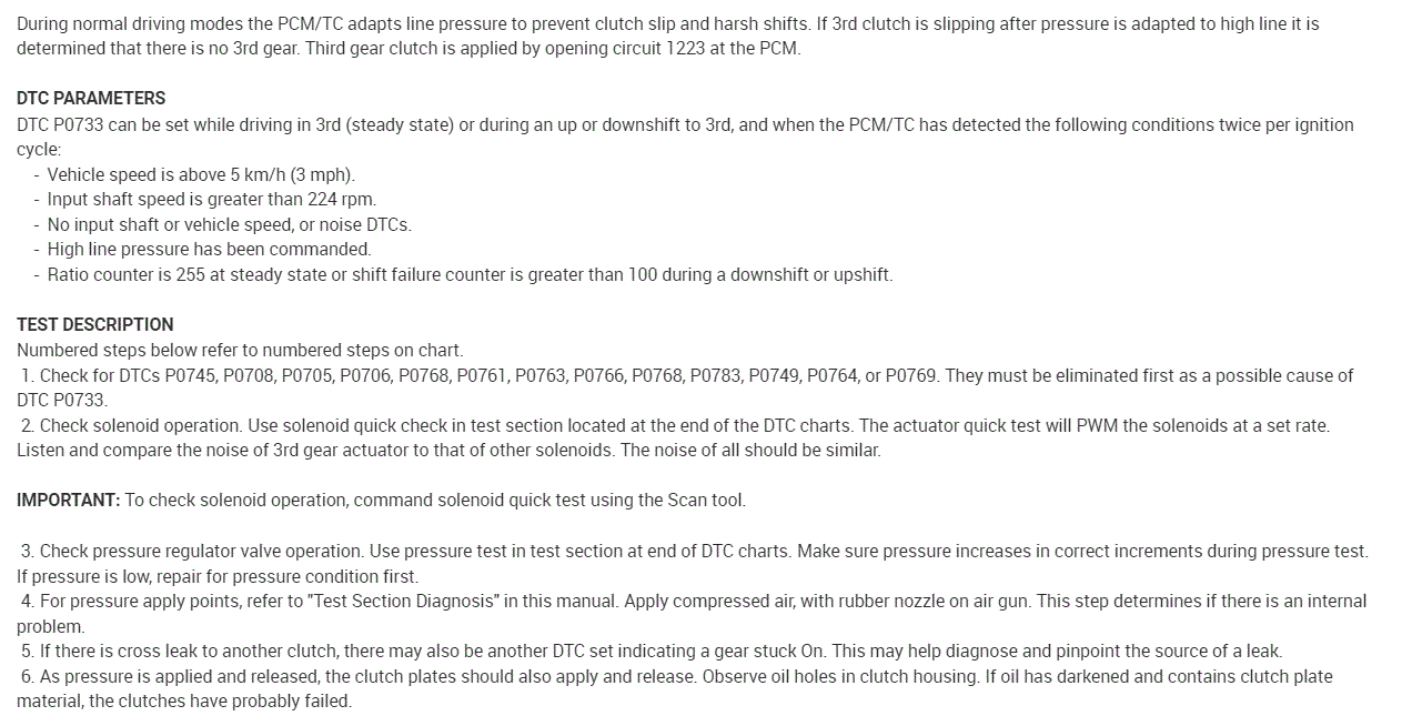

  • 110,240 POSTS
Is the P0733 the only code left? I ask because this can be the result of the 4th gear solenoid. See the last pic below
The pics below are the diagnostics for the P0733. Let me know if there are any other codes set. P0734 is specific to a hydraulic condition with the 4th gear clutch so that one is important. However, there are several others listed in the pics below.

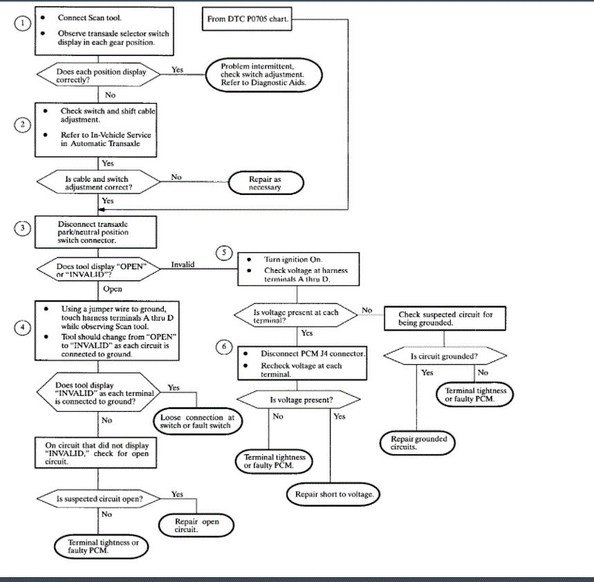

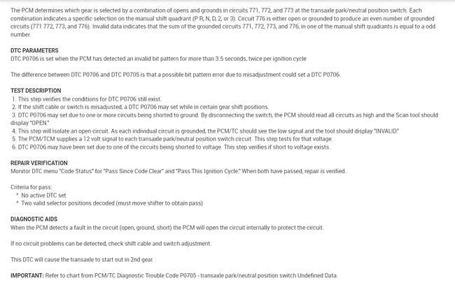

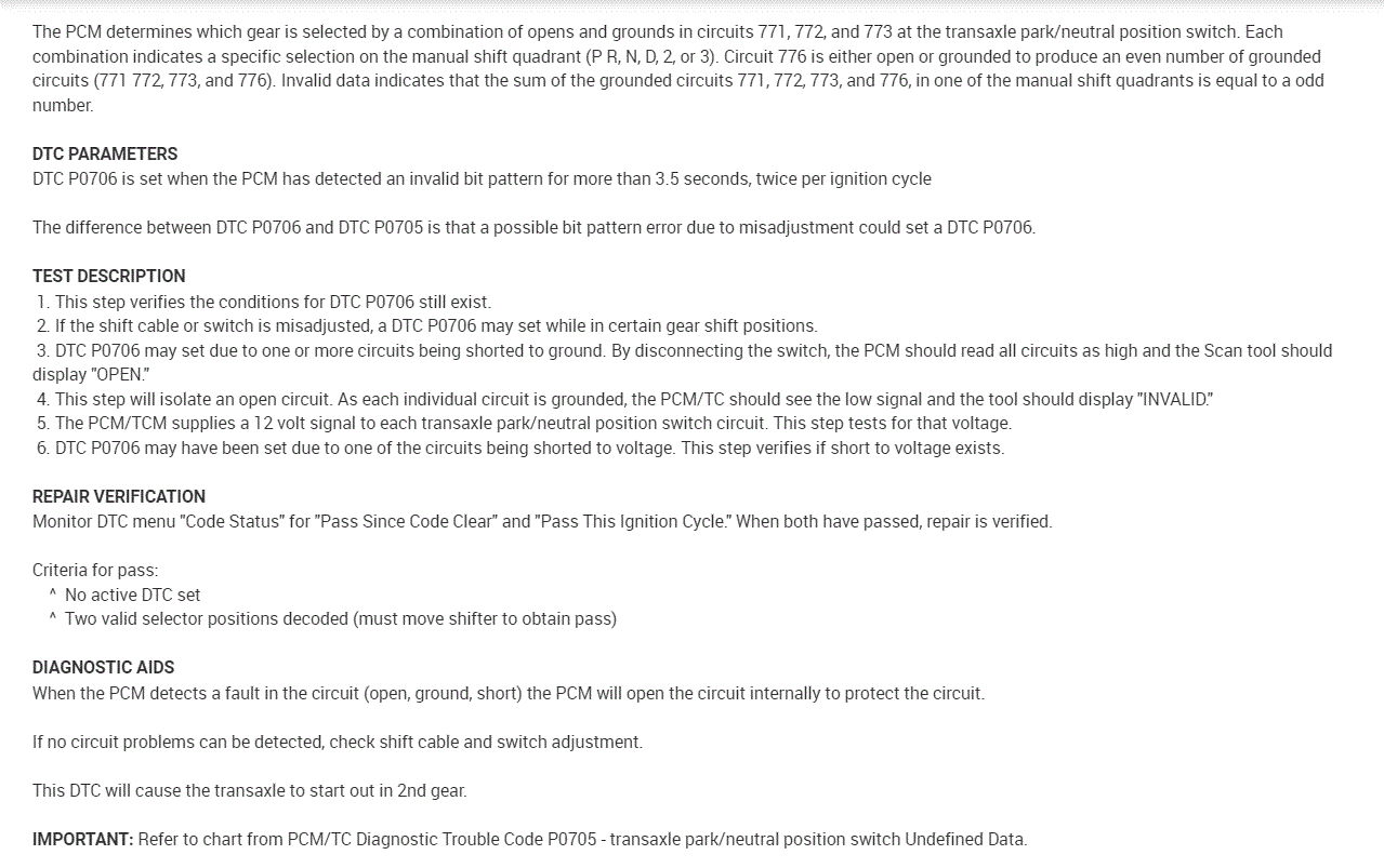

  • 110,240 POSTS
Okay,
The aforementioned diagnostics identify several codes that need to be addressed prior to focusing on a P0733. The only one you have that is present is the P0706, so let's see if we can get to the bottom of that code. It may be the cause of the 733 and the problems.
I attached the directions below which seem to focus specifically on the transmission range sensor. Take a look through them and let me know if you are comfortable performing the tests. I have a feeling this is where the problem is originating.
Mar 27, 2022 at 6:47 AM
EXISTEDTECH759
  • 13 POSTS
I will try to run that and get back to you.
