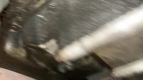

Transmission drain plug.

That is strange. As if you use a new crush washer and a plug that has the correct style and flange, with the right torque it should not leak. I could not tell from the video, but if the mounting surface of the pan is not smooth it can leak even with doing everything correctly.
