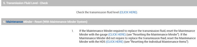

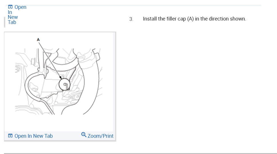

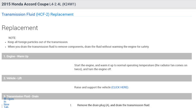

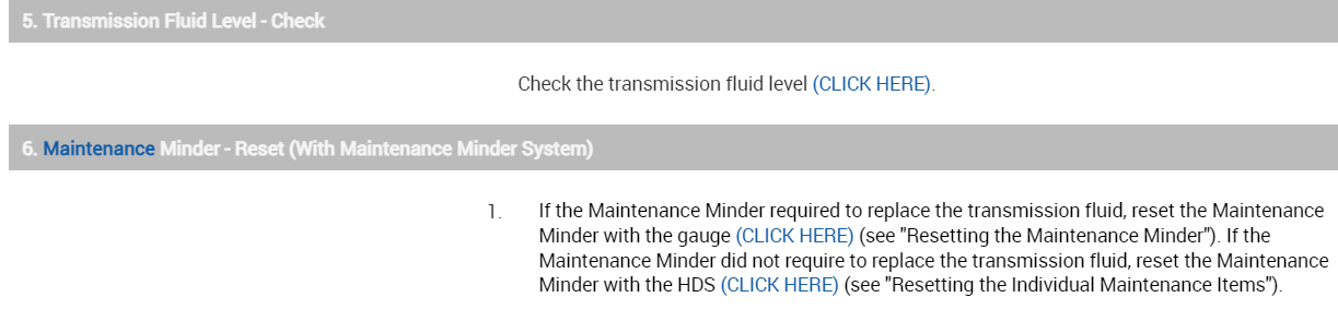

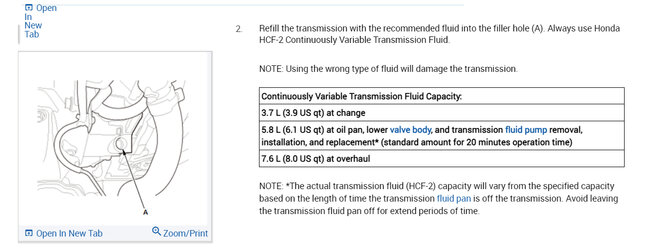

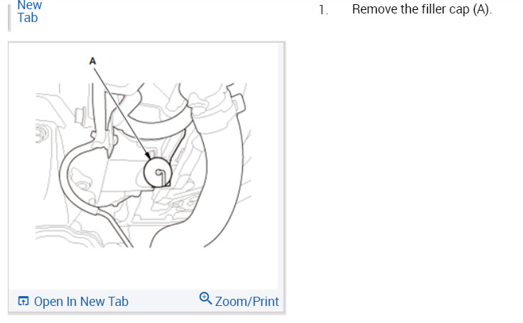

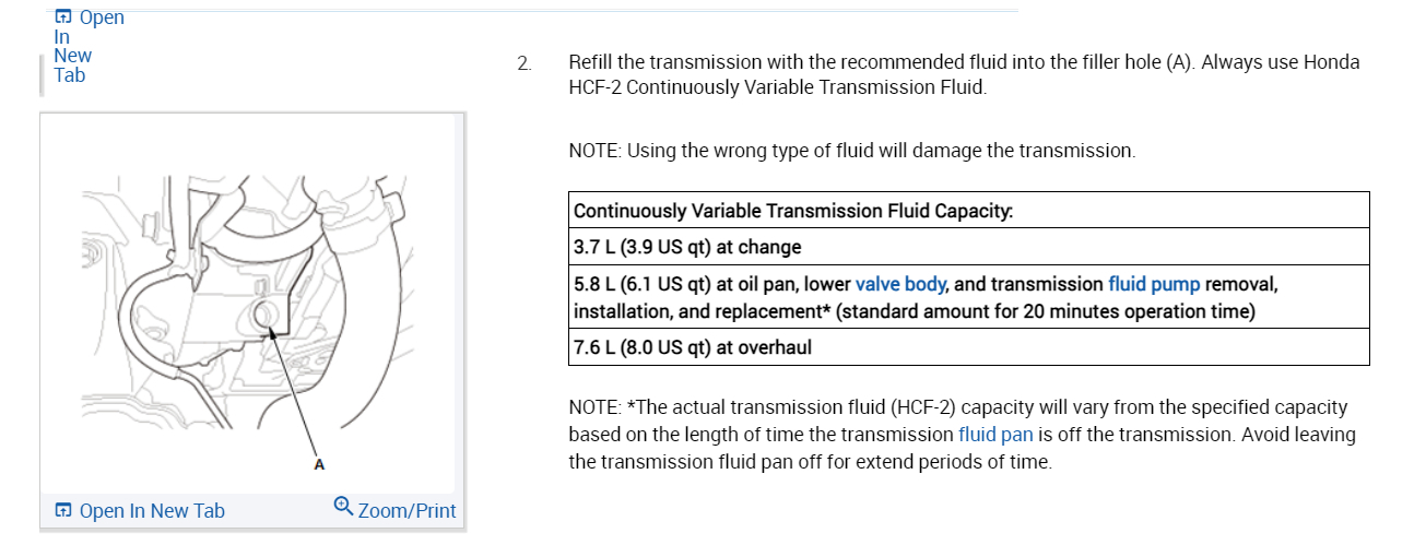

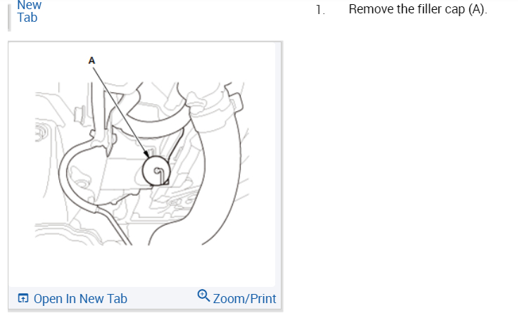

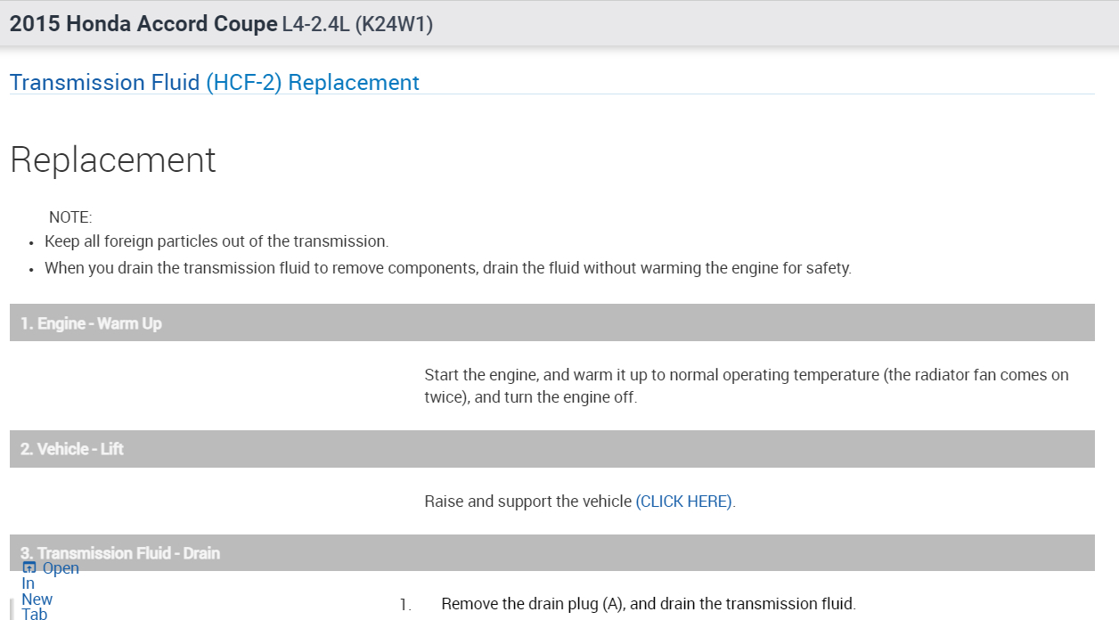

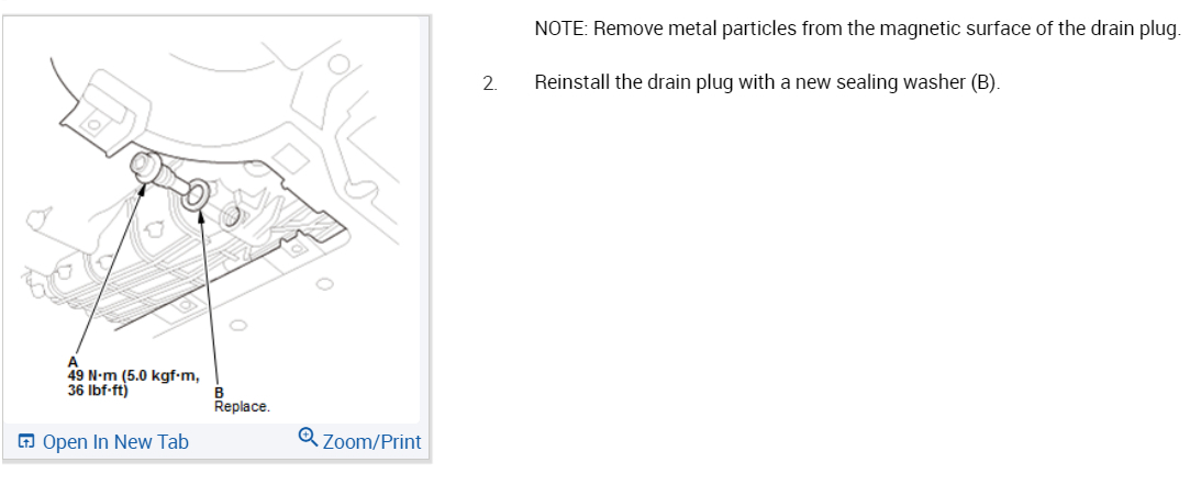

There is no way to get the codes without a scanner. It does sound like a transmission fluid change will help it because the CVT transmission has a high failure rate. Here is a generic guide to help you step by step with instructions in the diagrams below to show you how on your car:
Use Honda HCF-2. Note: Using the wrong type of fluid will damage the transmission. Check out the images (below). Let us know what happens and please upload pictures or videos of the problem so we can see what's going on.
