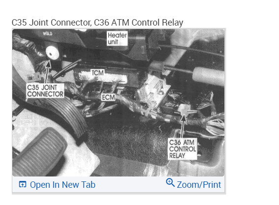

Clunking sound going into reverse, initially. Mechanic test drove and said either tranny or engine bolts. Now, it jerks going into reverse so stopped driving it. My Autel diagnosed Transmission Control Unit problem. Bought a used one from Ebay and can't find a YouTube video to demonstrate how to change it out. Called different shops for an estimate but none called back. All too busy. I live in Lower Queen Anne and need it soon to move. Any suggestions? Thanks.
May 2, 2023 at 1:28 PM
  • 55,433 POSTS

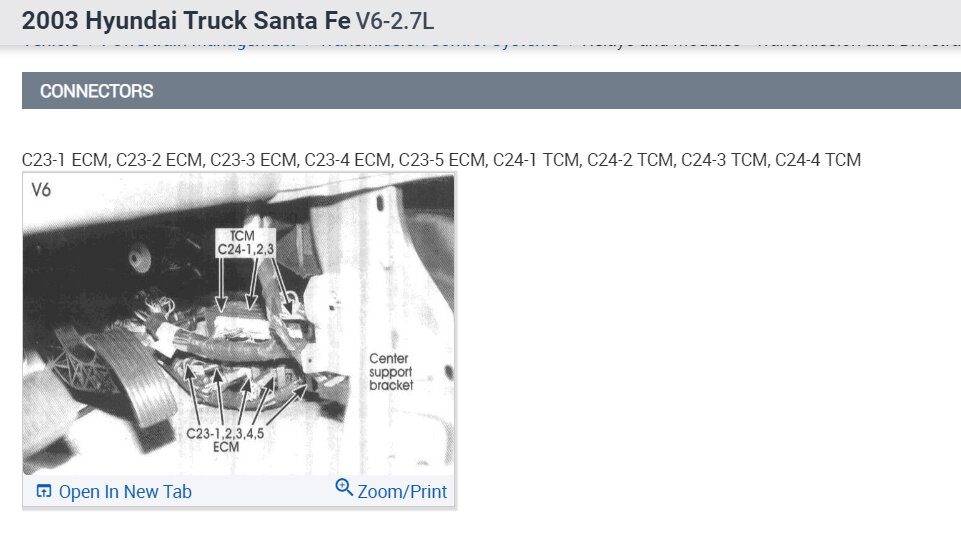

Sure, it looks like the TCM/PCM is by the throttle pedal here is the location in the images below. Please let us know if you need anything else to get the problem fixed. I would check the U joint is the driveshaft, transmission and engine mounts as well.
May 3, 2023 at 4:43 AM

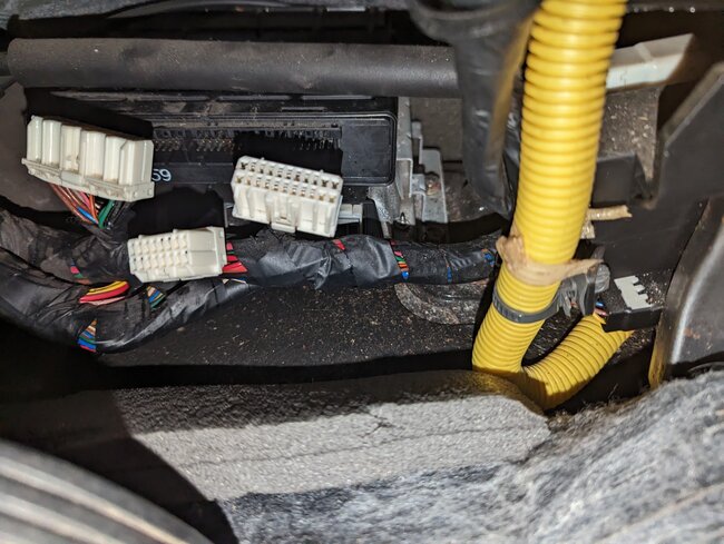

Hi, again. As you know, I am not a mechanic, however, I am determined to fix what I can fix. To wit, I followed your instructions and discovered that 1) There is an insulated cable on top of the unit. Additionally, the bolt that needs to be removed from the right side of the bracket is unreachable. I assume that someone else needs to be removed to get at it. You can only see it on a cell phone. There is a yellow collapsible tube running to the back seat. Probably not necessary to remove, right?
I am so close, unhooked the battery cable, wore the wrist strap, bought the silicone grease, got the wiring harnesses off and now what? Do I need to remove something else in order to get at the bolt securing the TCM?? I really appreciate your help!!
70 yr. old grandma Miriam. P.S. It sucks to be old and poor.
May 12, 2023 at 11:55 AM
  • 55,433 POSTS
I am sorry, please upload images of what you are seeing so I can help walk you through it.

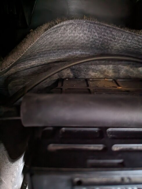

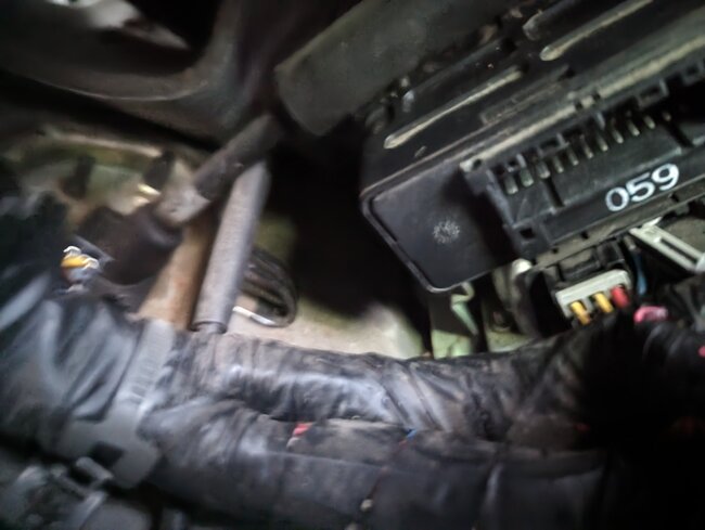

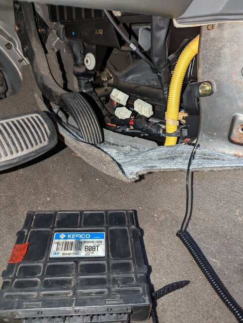

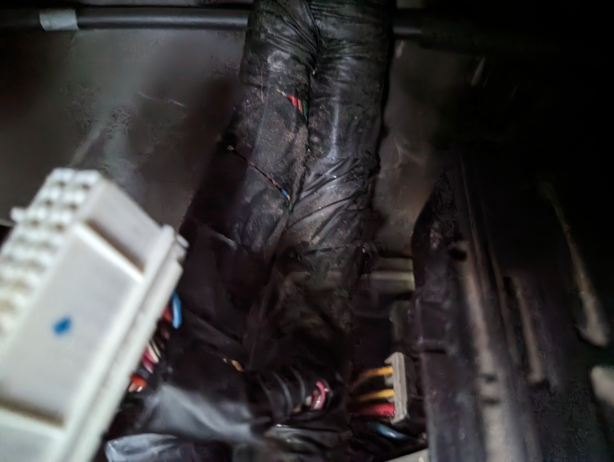

Here are photos of the transmission unit and bracket with the bolt on the right bracket. It looks like the unit has to slide up vertically but there is an insulated cable above the unit and it is secured tight in the bracket.
May 14, 2023 at 1:19 PM
  • 55,433 POSTS
Yep, it looks like it is close good job so far, it looks like there are 10mm bolts holding the bracket down, but can you slide the unit toward the gas pedal, there might be hold down clips? Let me know.

Hi again. Got the two bolts on the right side but can only lift the unit off the bracket on the right side. Can't see any bolts on the left side. The black insulated hose is tight on that side. Also, tried to pull it straight out towards the accelerator pedal but it has to be lifted off the right back remaining bolt. Only the nut came off. Could you send me a pic of any clips that may be holding it in on the left side? I really appreciate your assistance.
May 20, 2023 at 12:30 PM
  • 55,433 POSTS
Hi Miriam,
The images above all they show, can you access the TCM from the other side of the dash to see what's going on? Please upload images of what you see so I can help.

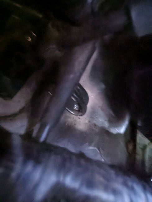

Sorry, don't know if these will help. The unit seems to be dislodged, but couldn't lift the left side up enough to move it out, towards the accelerator pedal. I felt around the left side, and it felt like there is a bolt in the front. Could that be holding the unit to the left. bracket?
May 21, 2023 at 7:28 AM
  • 55,433 POSTS
Yep, that looks like the PCM needs to come out first which is the box on the top of the TCM. Can you see how to remove it? There should be a clip or hold down bolt.

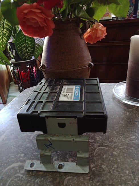

I finally got the nut off the front left bracket of the TCU. Couldn't get it out of the driver's side so removed the panel off the passenger side. Then I pushed the unit towards the pass. side and was able to jiggle it out from that side. Hurrah! Now, how do I get it off the brackets?
May 24, 2023 at 12:38 PM
  • 55,433 POSTS
Good job! Please upload an image of what you are talking about
May 25, 2023 at 10:12 AM

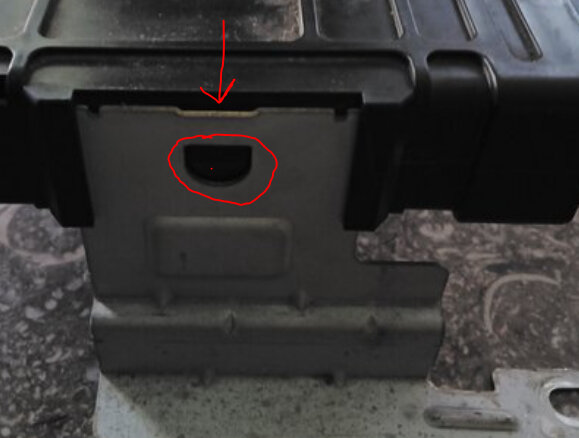

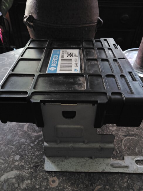

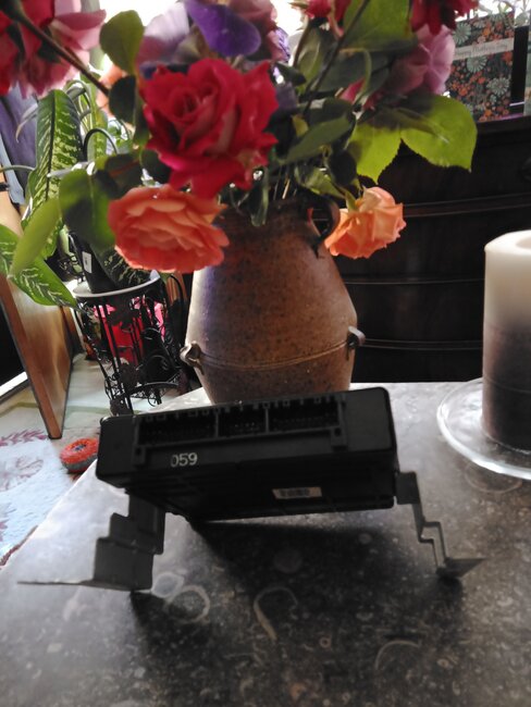

MIRIAM BROWN
  • 18 POSTS

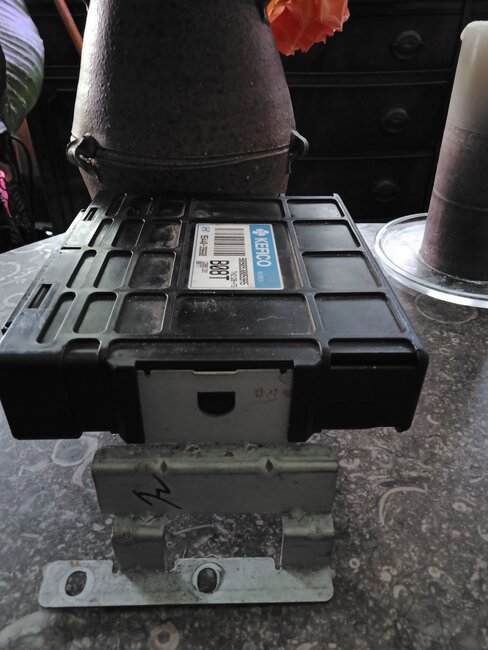

Sent three pics. I can't slide them out, even using a large screwdriver. Do I need to try to find brackets for the replacement unit?
May 27, 2023 at 9:55 AM
  • 110,244 POSTS
I noticed it has been a couple of days since we made contact with you. Have you been able to make any progress?
As far as the brackets, take a thin straight screwdriver and slide it down into where I have an arrow pointing to depress the locking tab I circled. That should release the bracket.

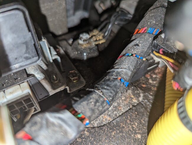

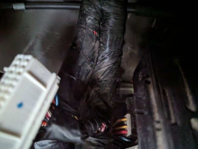

Just test drove it and it only clunks going into reverse. But now, the speedometer doesn't work.
Jun 15, 2023 at 8:09 AM
  • 110,244 POSTS
You aren't having too much luck with this. As far as the speedometer, did you do anything with the transmission output speed sensor? Check to make sure it is connected and there is no damage to the wiring. I attached a pic showing it below.
