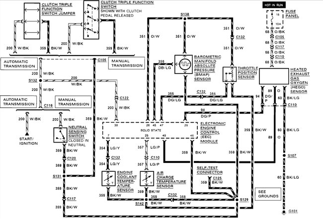

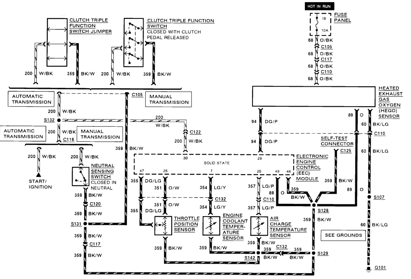

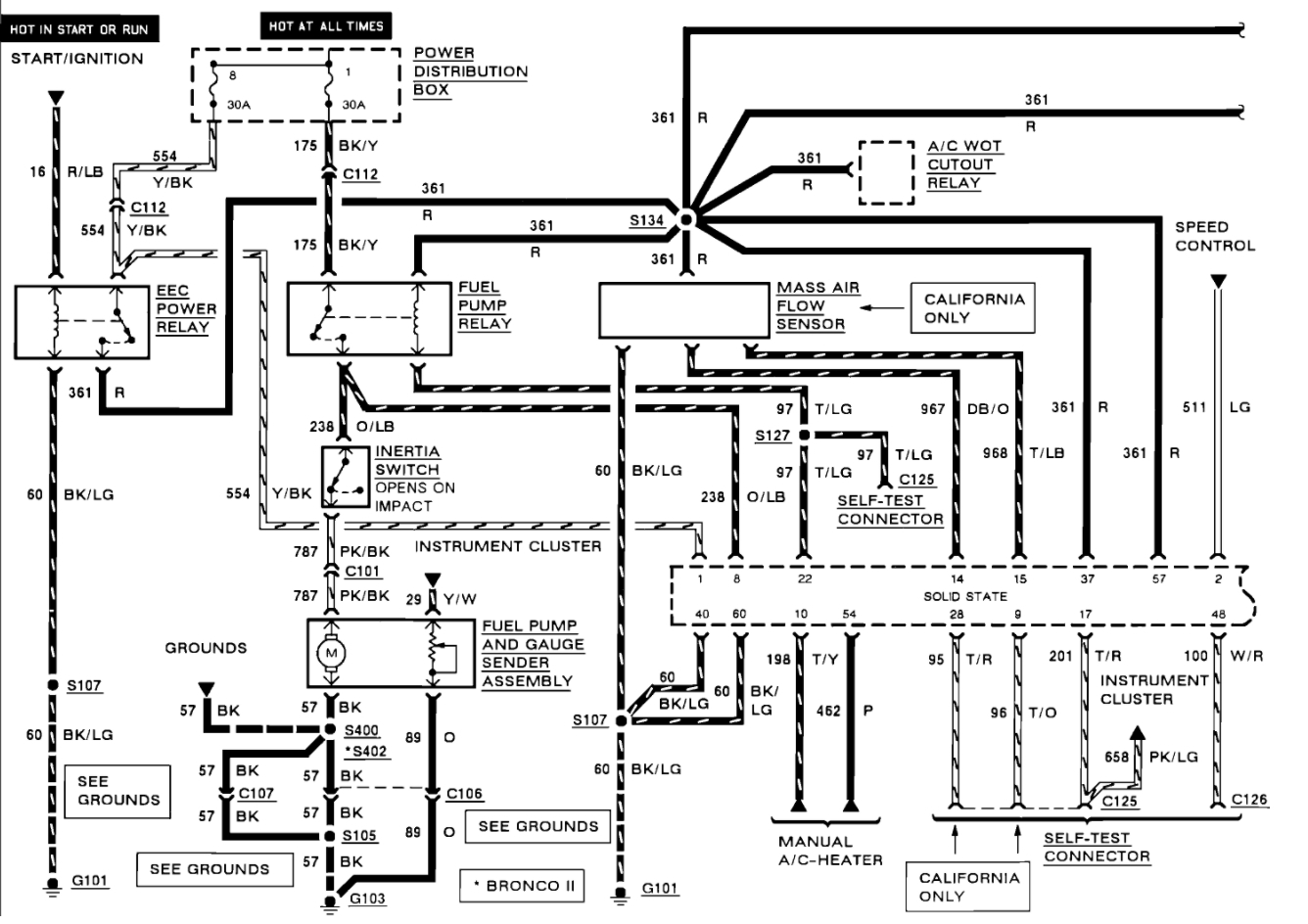

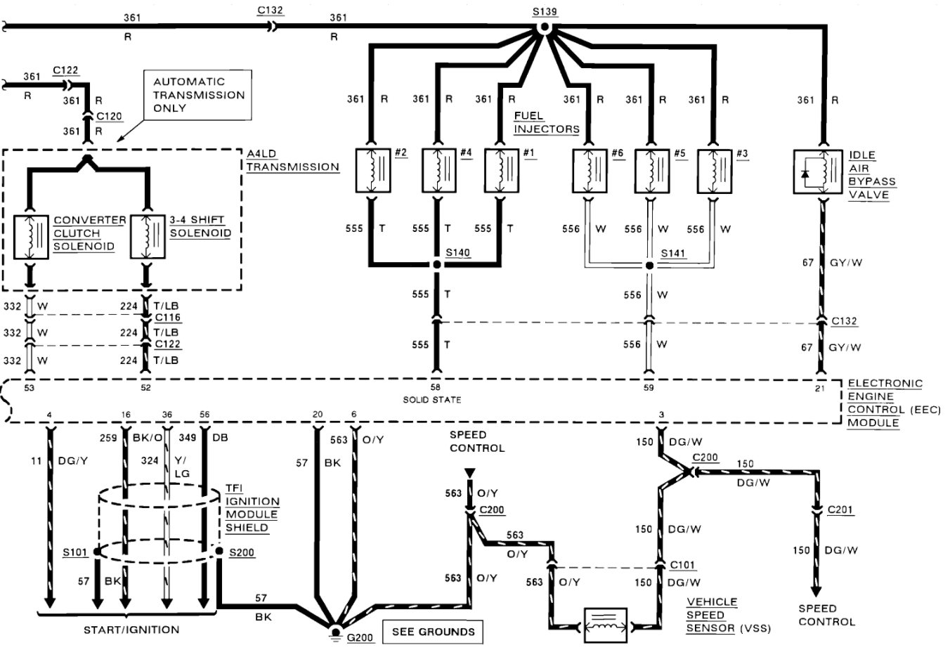

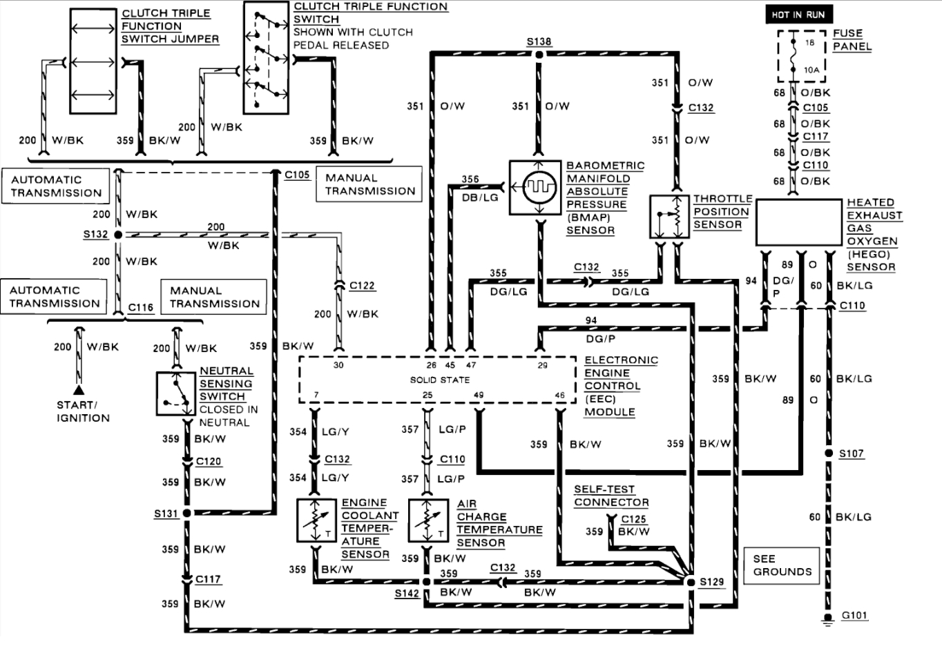

JOHN CRANFORD
Putting 1990 engine and transmission in 1939 coupe need to know how to hook up two wire switch on transmission. I have neutral and back up switch hooked up. No computer going old school.
May 4, 2021 at 3:53 AM (Merged)
  • 55,387 POSTS
Sounds fun. Here are the engine and transmission wiring diagrams so you can get the job done. (Below)
Let us know what happens and please upload pictures or videos of the project.
