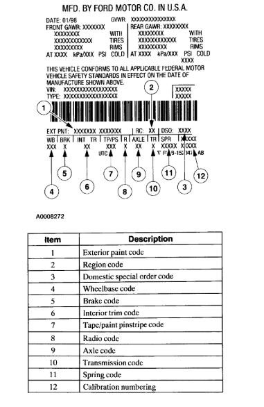

Is a regular 2001 Expedition 5.4l transmission compatible with a 2001 F250 super duty 5.4?
May 4, 2020 at 2:41 AM
Good morning,
Are they both 2 wheel drive?
there are 4 available transmission options for the 2001. I need to know the model numbers of the transmission.
It could be 4R70, 4R100, AODE, 4
R75.
The Expedition has the same availability.
They must be exactly the same as the wiring is different for all of them.
There is a white tag on the door and it will have the transmission code on it. I attached the tag so you would see.
May 4, 2020 at 2:52 AM
CHMCC
Does it have to be the same year?
May 5, 2020 at 3:18 AM
No, they must be the same model.
Check and see if there are any stampings on the case.
