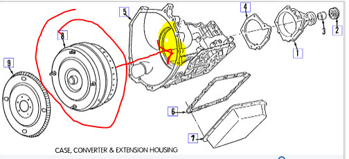

I just purchased the truck listed above. It has a slight slip in the transmission when you first take off in drive and reverse. Once it's going everything is fine. When I stop at a red light or something like that, it slips slightly again until it gets going again. I scanned for codes zero the only code it gives me is a misfire in #8 cylinder. What do you think is causing the slight slipping? I still have yet to change the filter and fluid I need the transmission. I don't want to do anything yet in case I need to drop the pan again for something else.

I checked the transmission fluid while the engine was cold, it read full. Then I checked it when the engine was at operating temperature. It didn't read anything on the dip stick. While the engine was running, I went through all the gears slowly to make sure the fluid was getting where it should be. It read nothing on the dip stick when the engine was warm but when the was cold it read full. It's of natural color and does not look or smell burnt. I will add some fluid to see what it does then.

Okay, I know what is happening. The front pump in the transmission is likely worn. What happens is this. The torque converter holds a few quarts of transmission fluid. The torque converter connects to the front of the transmission's front pump.
Under normal conditions, the front pump seals off the converter from draining. If it is worn and allows the torque converter to drain off, the fluid is going up after sitting, and then when it is warm and running, the converter is refilled and the fluid is low.
In this case, you should fill it when the engine is warm and running. However, after it sits overnight, the fluid level is going to show over full.
What does all of this mean? The front pump and converter likely need replaced. However, once the front pump is removed, then you have access to the clutch packs in the transmission and should inspect at a minimum the low/reverse clutch pack for wear.
Let me know if this makes sense. Also, let me know if you have other questions.
See pic below. I circled the torque converter and highlighted where the front pump is located.
