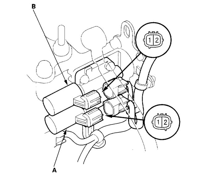

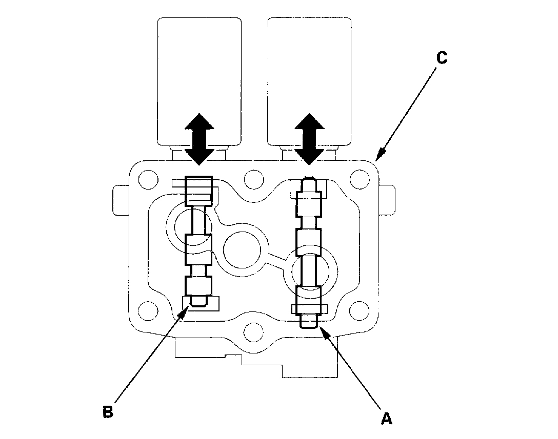

A/T CLUTCH PRESSURE CONTROL SOLENOID VALVES A AND B TEST
Test
picture 1
1. Disconnect the A/T clutch pressure control solenoid valves A and B 2P connectors.
2. Measure the resistance of the A/T clutch pressure control solenoid valves A and B between the No. 1 and No. 2 terminals of each connector.
STANDARD: About 5.0 ohms
3. If the resistance of either A/T clutch pressure control solenoid is out of standard, replace the A/T clutch pressure control solenoid valves A and B.
4. Connect the No. 1 terminal of the A/T clutch pressure control solenoid valve A (and B) to the battery positive terminal, and connect the No. 2 terminal to the battery negative terminal. A clicking sound should be heard.
5. If not, remove the A/T clutch pressure control solenoid valves A and B.
6. Check the fluid passage of the A/T clutch pressure control solenoid valves for dust and dirt.
picture 2
7. Connect the No. 1 terminal of the A/T clutch pressure control solenoid valves A and B to the battery positive terminal, and connect the No. 2 terminal to the battery negative terminal. Make sure the A/T clutch pressure control solenoid valves A (A) and B (B) move.
8. Disconnect one of the battery terminals and check valve movement.
NOTE: You can see the valve movement through the fluid passage in the mounting surface of the A/T clutch pressure control solenoid valves A and B body (C).
9. If either valve binds, or moves sluggishly, or if the A/T clutch pressure control solenoid does not operate, replace the A/T clutch pressure control solenoid valves A and B.

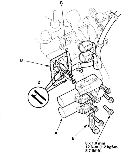

If you find that is the problem, here are the directions for replacement. Picture 3 correlates with these directions.
Replacement
picture 3
1. Remove the mounting bolts and the A/T clutch pressure control solenoid valves A and B (A).
2. Clean the mounting surface and fluid passage of the A/T clutch pressure control solenoid valves A and B and the transmission housing.
3. Install a new A/T clutch pressure control solenoid valves A and B with a new gasket (B), new O-rings (C), ATF feed pipes (D), and harness clamp bracket (E).
NOTE: Install the filter side of the ATF feed pipes in the transmission housing.
4. Check the A/T clutch pressure control solenoid valve connectors for rust, dirt, or oil, then connect them securely.

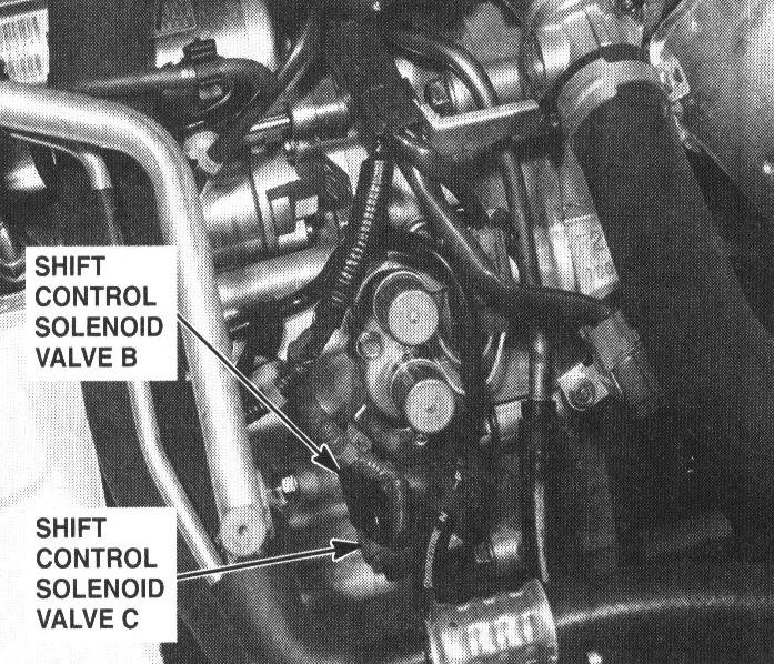

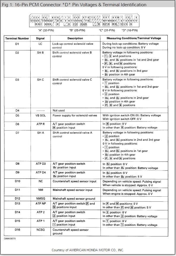

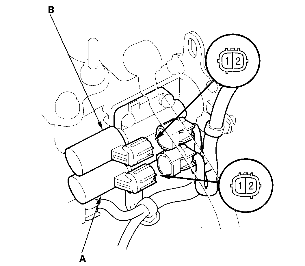

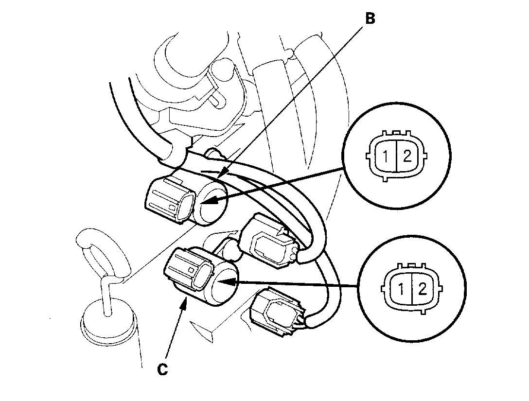

Also, here are the directions for testing shift solenoids.
See picture 4 and 5
1. Disconnect the shift solenoid valve B or C 2P
2. Measure the resistance between the No. 1 and No. 2 terminals of the shift solenoid valve B or C.
STANDARD: 12 - 25 ohms
3. Replace the shift solenoid valve B or C if the resistance is out of standard.
4. If the resistance is within the standard, connect the No. 2 terminal of the shift solenoid valve B or C connector to the battery positive terminal, and connect the No. 1 terminal to the battery negative terminal. A clicking sound should be heard. Replace the shift solenoid valve B or C if no clicking sound is heard.
