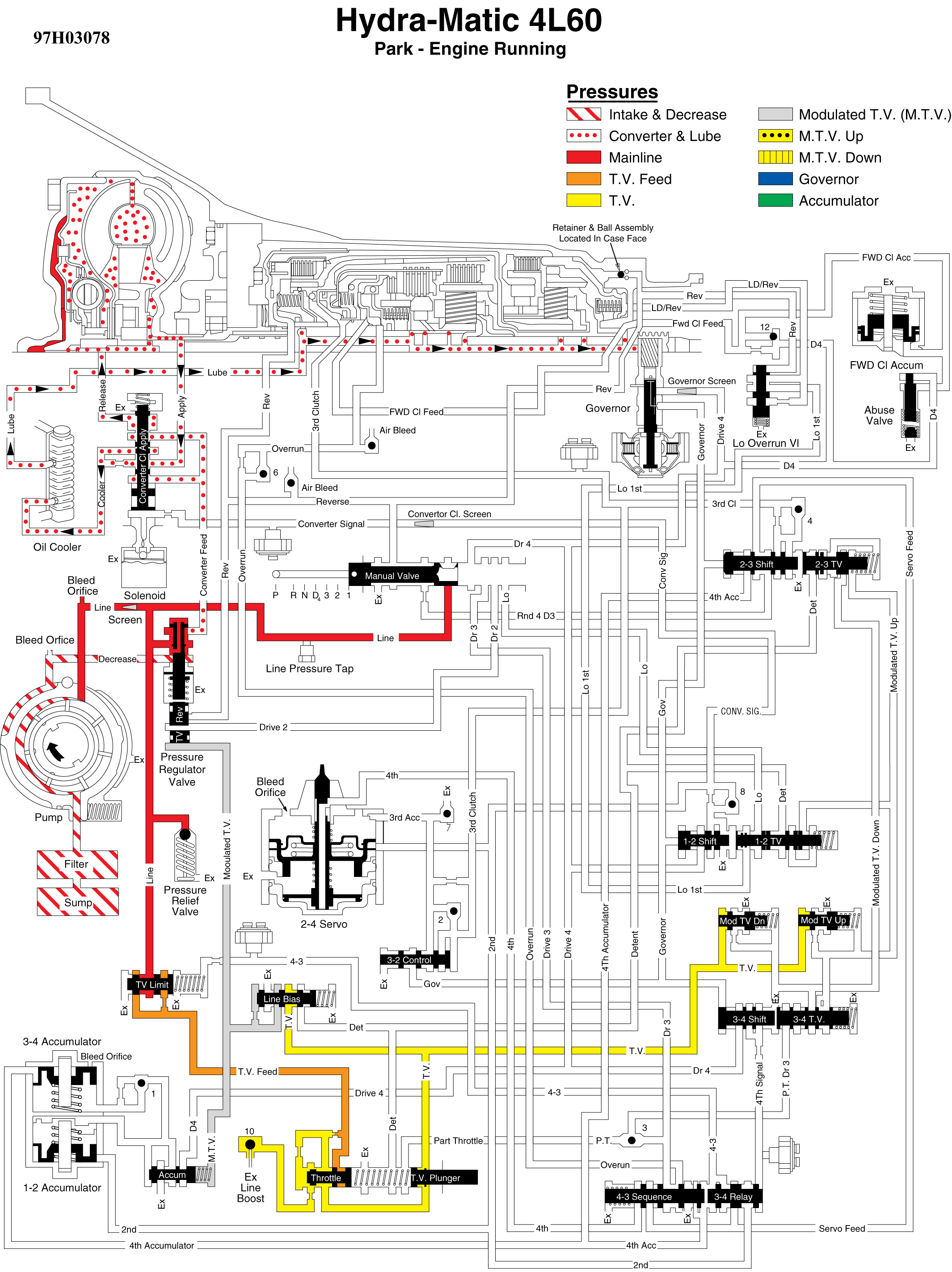

ALLIS
[quote:f2adf00634="pear69"]What type of transmission do you have? If you manually put it into 2nd gear, does it move? Check the transmission fluid level.[/quote:f2adf00634] I have a 700r chevy trans. It willnot shift into3rdif I start out in 2nd. fluid is ok . I just had this trans rebuilt 4yr ago & it has oround 60 k on it . Yes It moves if U put in2.
May 6, 2021 at 3:35 AM (Merged)
PEAR69
  • 1,482 POSTS
Try changing the fluid and filter. Check the kick down cable for proper adjustment and and smooth operation. If these don't work then
this sounds like a sticking 1-2 shifting valve inside the valve body of the transmission or a 1-2 accumulator piston stuck. The valve body is repairable and removable without removing the transmission--and removing the transmission is the hardest part of repairing a 700r4. Unfortunatly, if the acc. piston is stuck the transmission has to be removed and taken apart..
If you decide to change the transmission valve body, make sure you replace it with the exact year make and model because the valve bodys differ in these transmissions
If you decide to replace the transmission I suggest to get a factory rebuilt transmission. They are not that much more, they have all the upgrades in them and they have a factory warranty... And if you go this route the transmission you get ,most likely be a 4L60E which is an upgrade and replaced the 700R4. Keep me informed

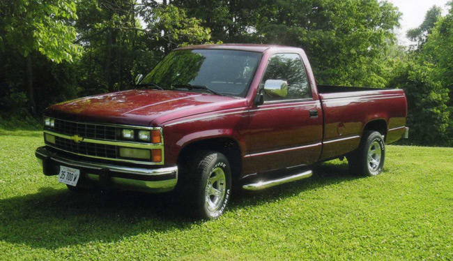

CHEVYGIRL88
So I recently acquired a 1988 Chevrolet truck, and in the middle of hauling two canoes (in the back of the truck) for a day on the river, the truck would not shift into a gear that allowed us to go over 40 MPH. We tried putting more transmission fluid into the truck, and it started to shift, but after about 2 minutes it decided not to again. I will admit that I do not know much about trucks, but I do love this car and if we can't figure out how to fix it I will be forced to sell it. Can anyone help me?
