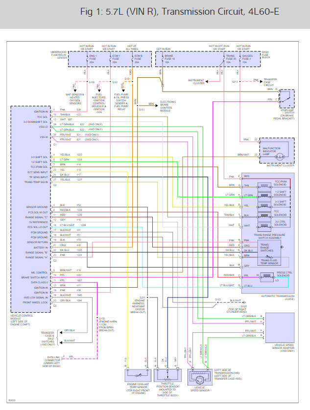

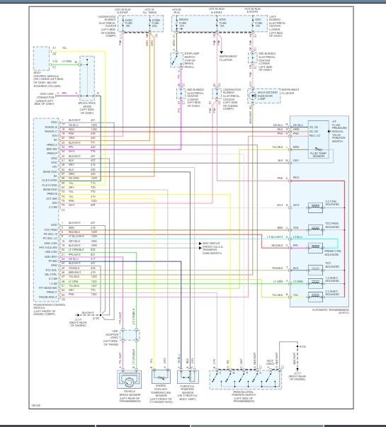

I installed refurbished 4l60e transmission and now it tries to take off in third gear and it will not shift out of third and. if I try to manually shift it and pull it down in the first year it will only go into second though it's in the first position and then again I can manually shift it into third, but it will not do nothing after that.

The transmission has an internal fault. Are there any codes set? If it is rebuilt, then you need to take it back to the shop that performed the repair. It may be valve body-related or internal in the clutches. These guides can help

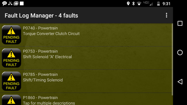

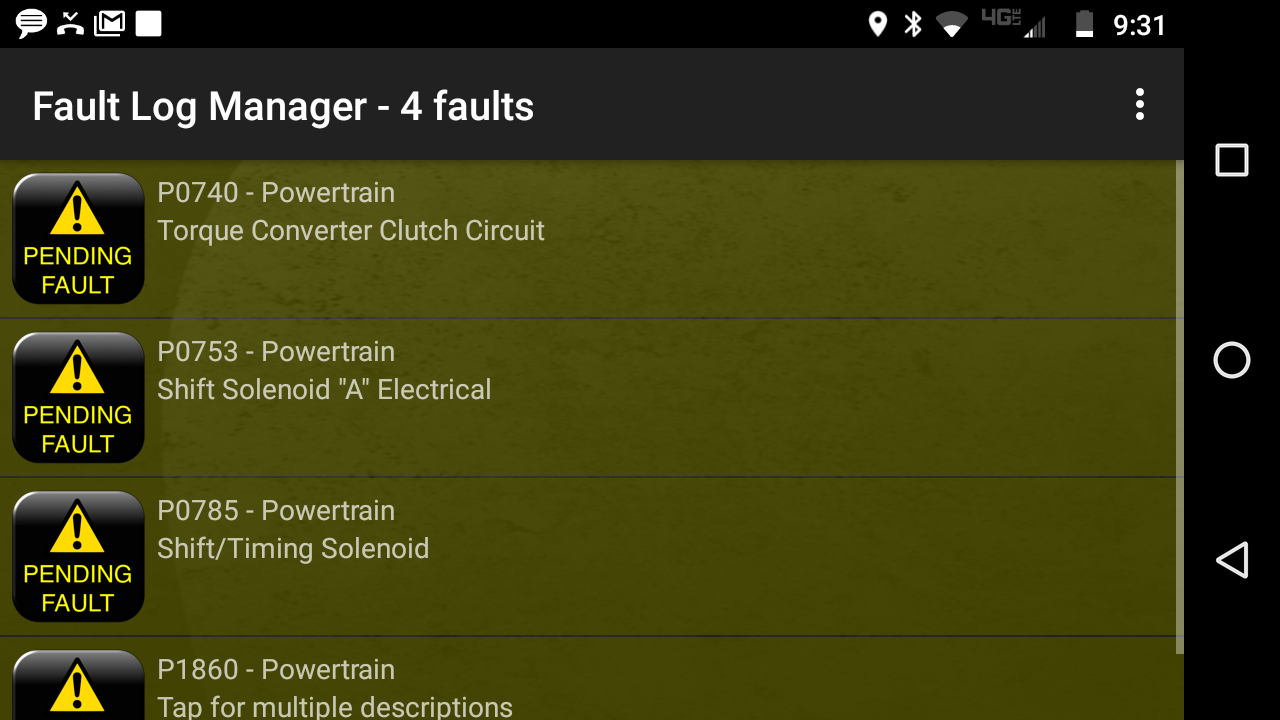

This is the codes I get. it's almost like the transmission is getting no power. I just find it hard to believe all the solenoids went out at one time.

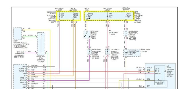

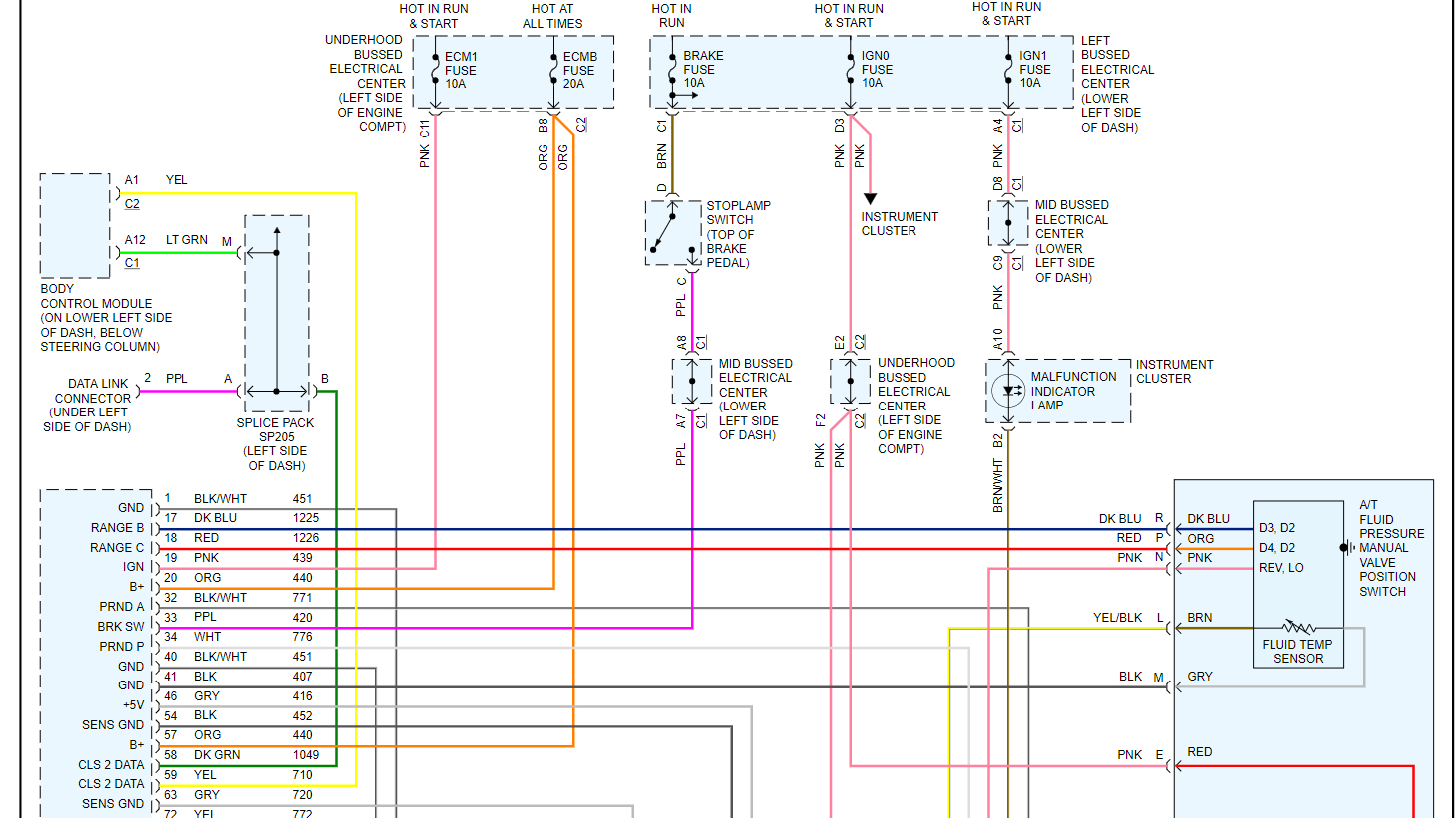

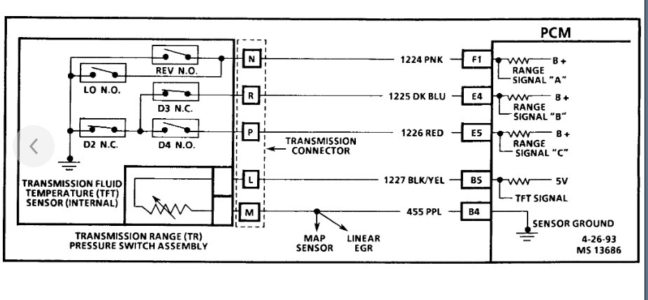

Okay, I attached a wiring diagram of the transmission.
Check all the fuses listed for power on both sides with the key on.
If that is okay, then go to the connector at the transmission and make sure the connection is clean and tight.

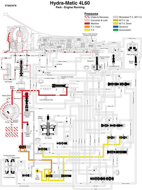

We have a couple ways to go at this point.
First, (and is where I would start) would be to check for transmission diagnostic trouble codes. A basic scan tool in most cases wouldn't be able to read these codes, so you may need to have it done. By doing this, it should identify if there is an issue with a shift solenoid.
Second, try to flush the ATF system including the transmission and cooler. Something there could be causing the pressure to drop.

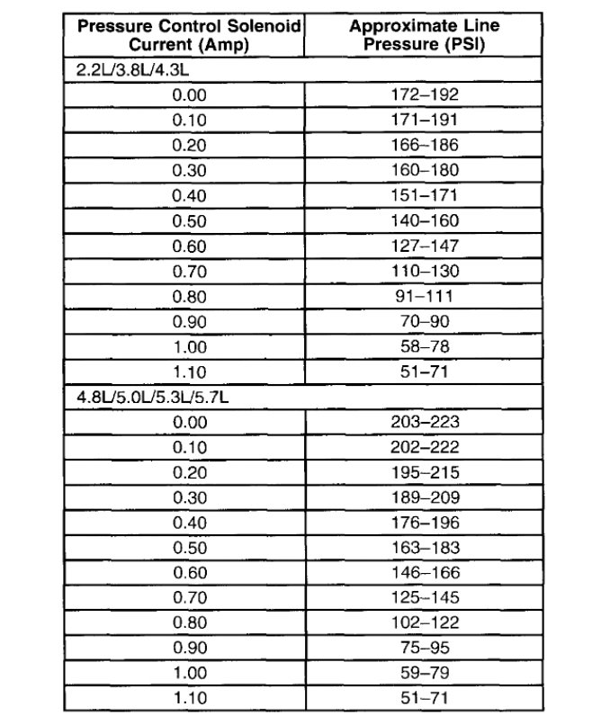

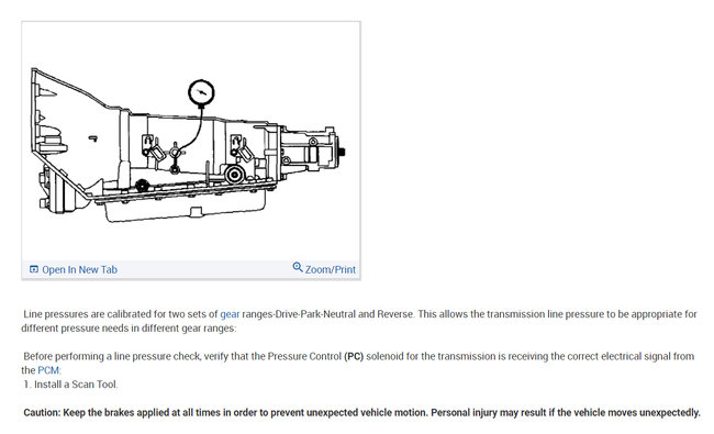

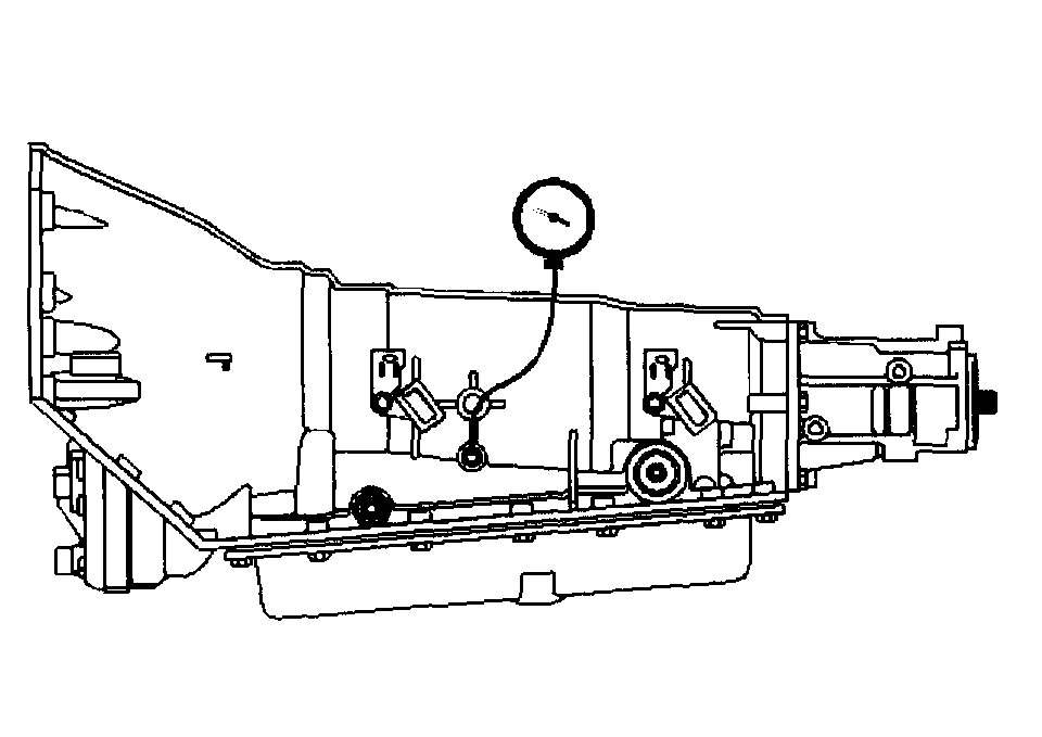

Third, check transmission line pressure. Here are the directions for doing this. The attached pic correlates with the directions.
________________________________________
1999 Chevy Truck K 1500 Truck 4WD V8-5.3L VIN T
Line Pressure Check
Vehicle Transmission and Drivetrain Automatic Transmission/Transaxle Testing and Inspection Component Tests and General Diagnostics 4L60-E/4L65-E Automatic Transmission Line Pressure Check

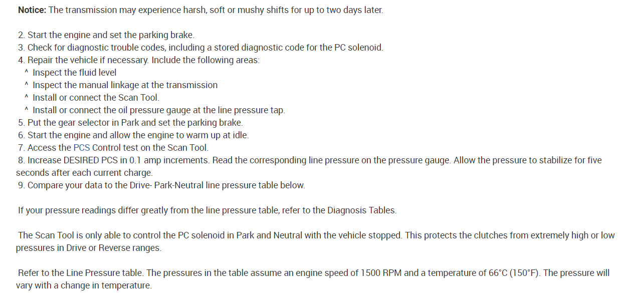

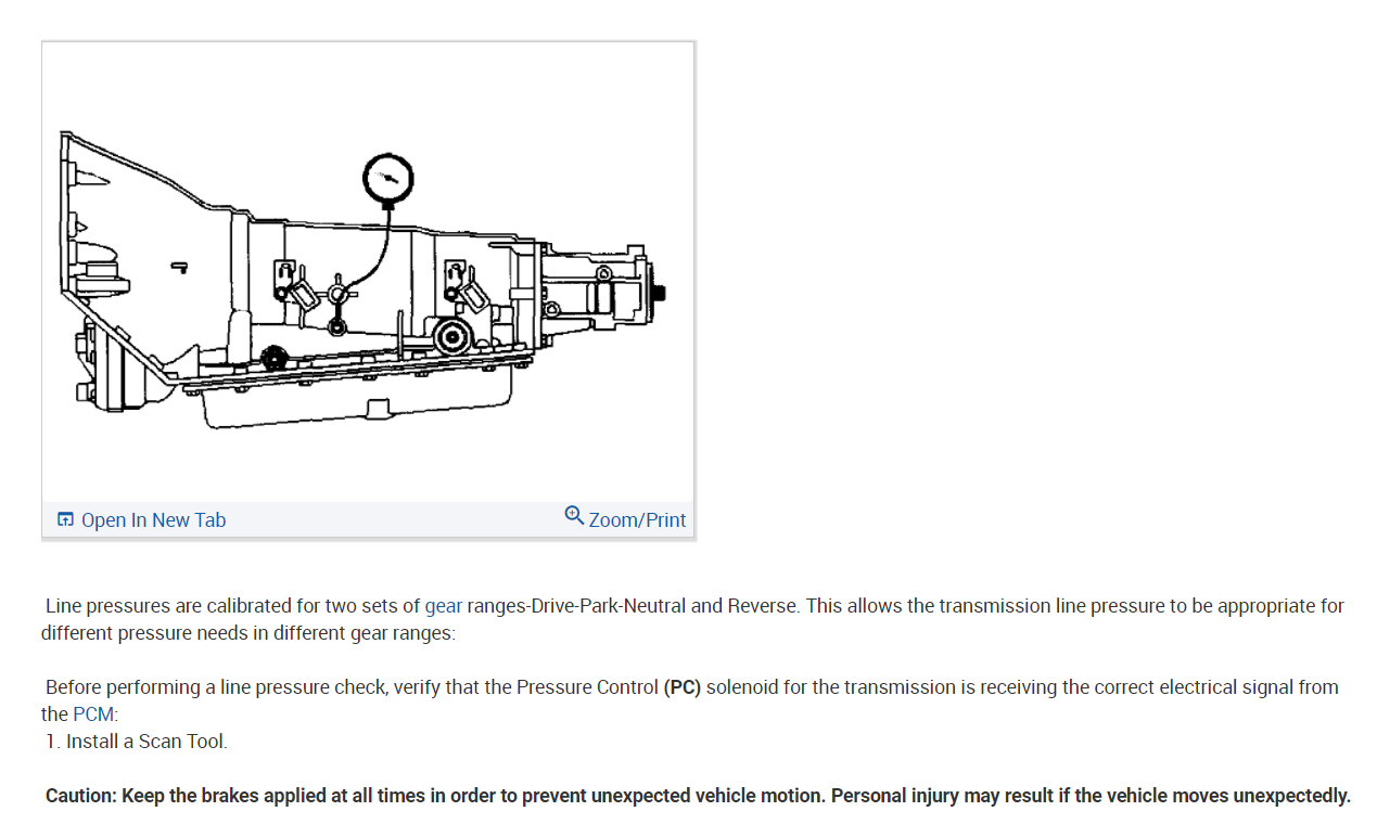

LINE PRESSURE CHECK
pic 1
Line pressures are calibrated for two sets of gear ranges-Drive-Park-Neutral and Reverse. This allows the transmission line pressure to be appropriate for different pressure needs in different gear ranges:
Before performing a line pressure check, verify that the Pressure Control (PC) solenoid for the transmission is receiving the correct electrical signal from the PCM:
1. Install a Scan Tool.
Caution: Keep the brakes applied at all times in order to prevent unexpected vehicle motion. Personal injury may result if the vehicle moves unexpectedly.
Notice: The transmission may experience harsh, soft or mushy shifts for up to two days later.
2. Start the engine and set the parking brake.
3. Check for diagnostic trouble codes, including a stored diagnostic code for the PC solenoid.
4. Repair the vehicle if necessary. Include the following areas:
^ Inspect the fluid level
^ Inspect the manual linkage at the transmission
^ Install or connect the Scan Tool.
^ Install or connect the oil pressure gauge at the line pressure tap.
5. Put the gear selector in Park and set the parking brake.
6. Start the engine and allow the engine to warm up at idle.
7. Access the PCS Control test on the Scan Tool.
8. Increase DESIRED PCS in 0.1 amp increments. Read the corresponding line pressure on the pressure gauge. Allow the pressure to stabilize for five seconds after each current charge.
9. Compare your data to the Drive- Park-Neutral line pressure table below.
If your pressure readings differ greatly from the line pressure table, refer to the Diagnosis Tables.
The Scan Tool is only able to control the PC solenoid in Park and Neutral with the vehicle stopped. This protects the clutches from extremely high or low pressures in Drive or Reverse ranges.
Refer to the Line Pressure table. The pressures in the table assume an engine speed of 1500 RPM and a temperature of 66°C (150°F). The pressure will vary with a change in temperature.

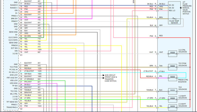

Trans went out. I pulled and transmission guy rebuilt. I reinstalled with assist. Still same issue. Took truck to the transmission guy. Bad pump. Go to get truck and a few miles up the road, stopped shifting and had heat issue. Replace water pump and now radiator. Test drove and no shift. Notice speedo no worries and then worked and shifted. Stopped working and went back to 1/2 gear. Replaced VSS on right hand side. Was going to do left hand nand used right hand on left hand and worked. Drove a few miles and all good. 3 days later drove again and now worries again. A/C does not work either. What steps should I do?? Tools needed?? Should I take back to trans guy??? Harness diagram?? Thanks....
May 6, 2021 at 3:33 AM (Merged)

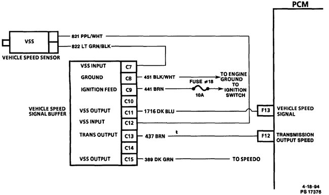

Good afternoon,
Yes, you should have a warranty on the transmission.
He needs to test and verify line pressure inside the transmission.
Also, the speedo not working will cause it no to shift at all. The ECM needs to see vehicle speed from that sensor.
I attached the wiring diagram for the transmission as well. You will need a scan tool for the line pressure testing. I attached that procedure for you as well.

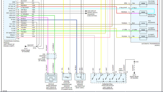

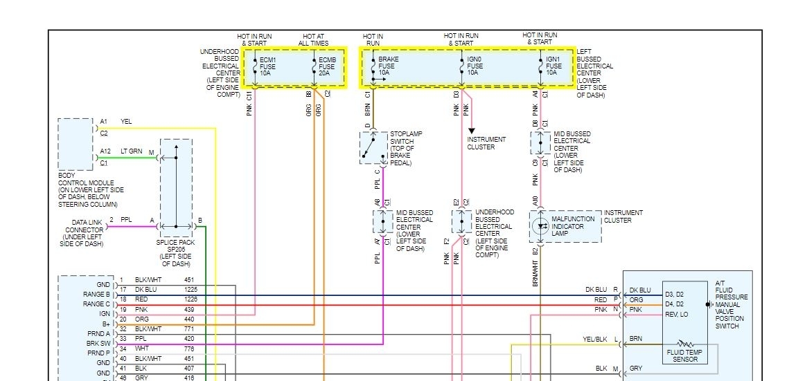

This sounds like you have corrosion at the main wiring connector please remove the connector and check for rust etc. If that seems okay I would replace the PCM with a used unit to see what happens.
Here is the wiring diagrams and PCM location.

I did the test using the guide and the wiring diagram and I found the PCM to be bad because I have a buddy that has the same truck we took it out of his now the truck works perfect thanks for you help the site rocks water back.

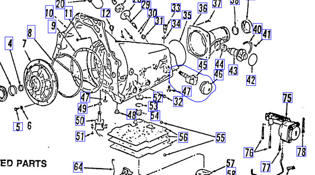

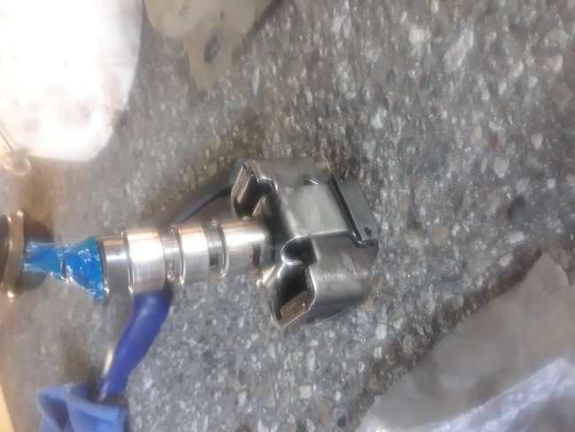

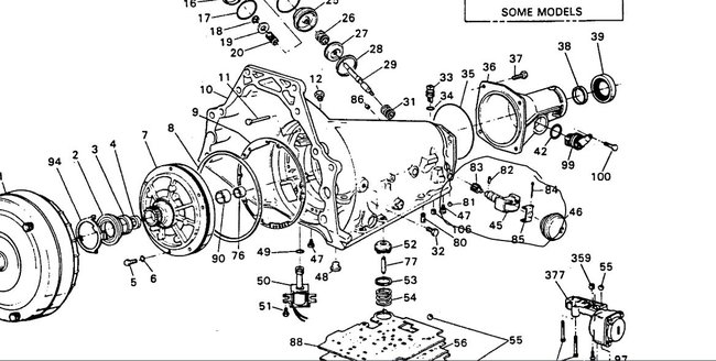

GARY MYERS
Doesn't seem to want to shift into third and overdrive. it does if i lift on the throttle! The shift indicator light blinks on an off when i turn the heater fan on. Dropped the pan and found no big problem except normal shavings on magnet and pan put back together after cleaning was a little bit better. Fluid was no burnt or smelled burned. Tachometer and speedometer work but speedometer is off a few MPH slow compared to GPS!
May 6, 2021 at 3:34 AM (Merged)
Good morning,
I would pull the governor off the side of the transmission and check the plastic gear on the end. It was common for that gear to dish and caused shifting issues.
I attached the procedure and a picture of the location for you.
1. Raise and support vehicle
2. Remove governor cover from case using extreme care not to damage cover. If cover is damaged, it should be replaced.
3. Remove governor.
4. Reverse procedure to install and check fluid level.

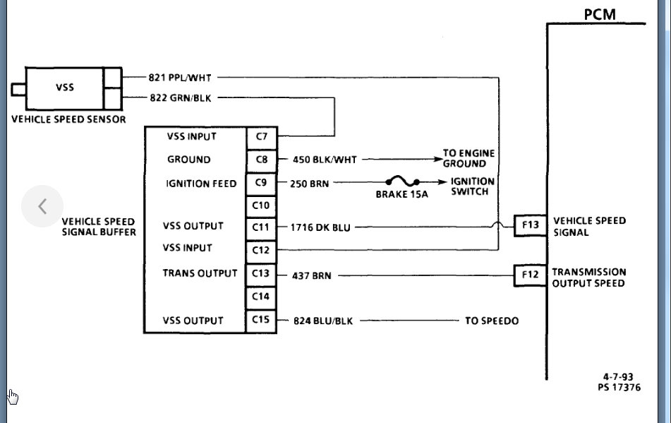

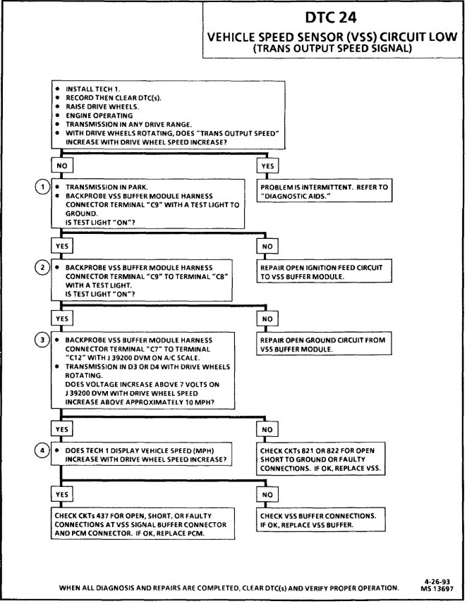

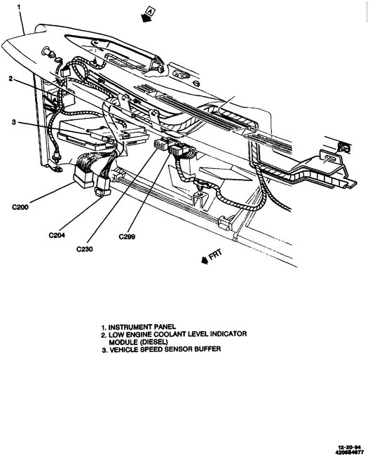

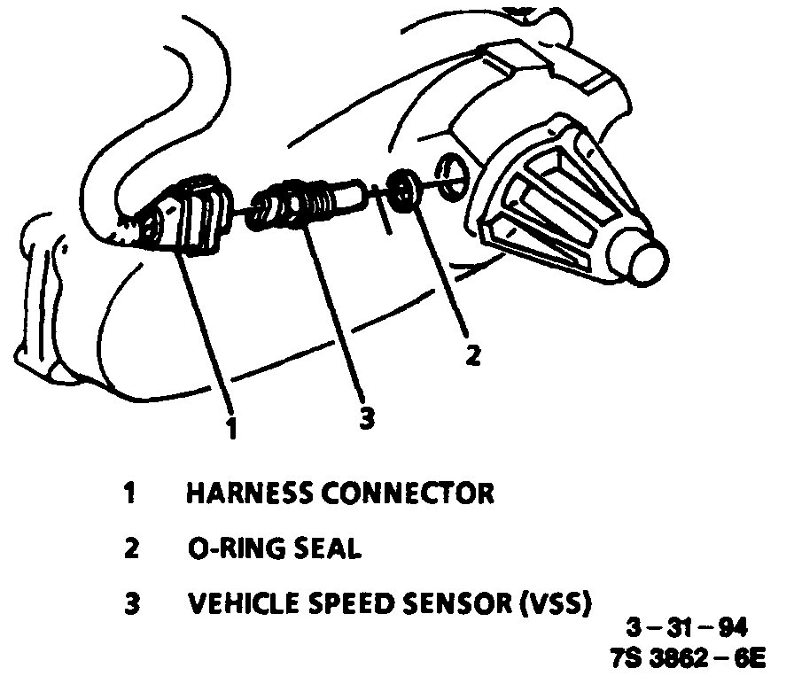

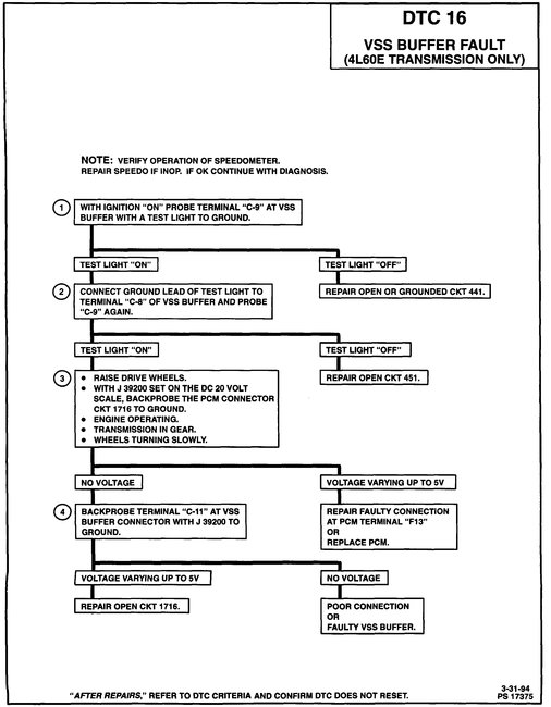

ANTHONY BORJA

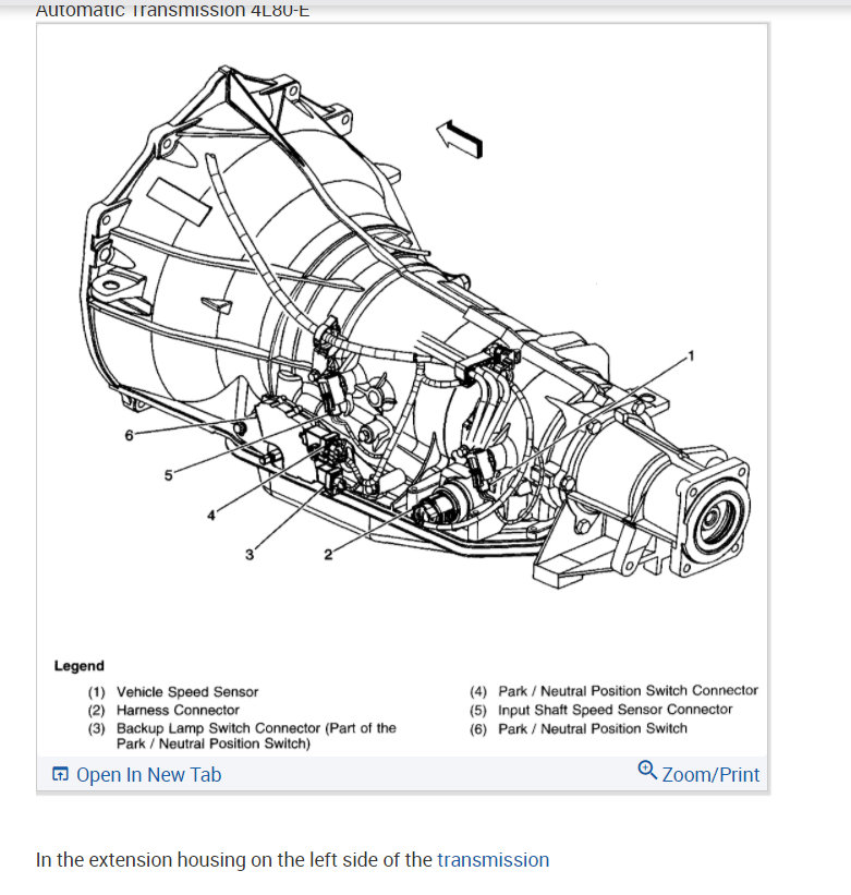

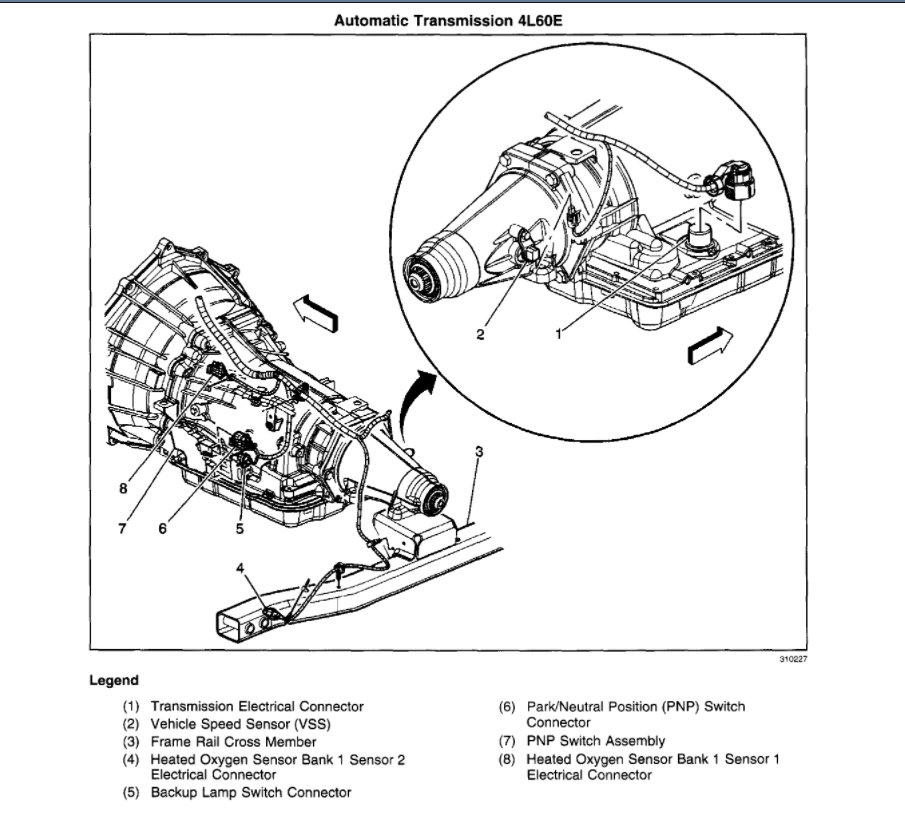

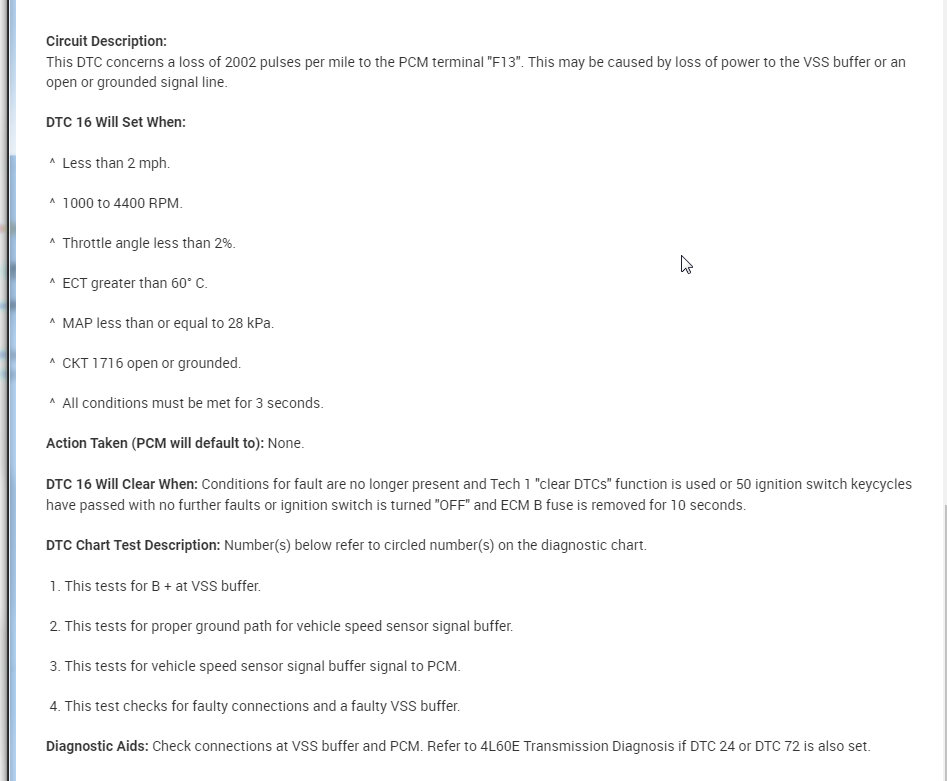

I replaced the transmission and the original problem still exists (wont shift out of third). My question is, with the speedometer not working and current shift issue will the VSS be the next logical step?
  • 110,241 POSTS
Welcome to 2CarPros.

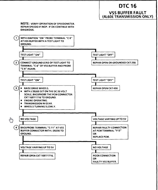

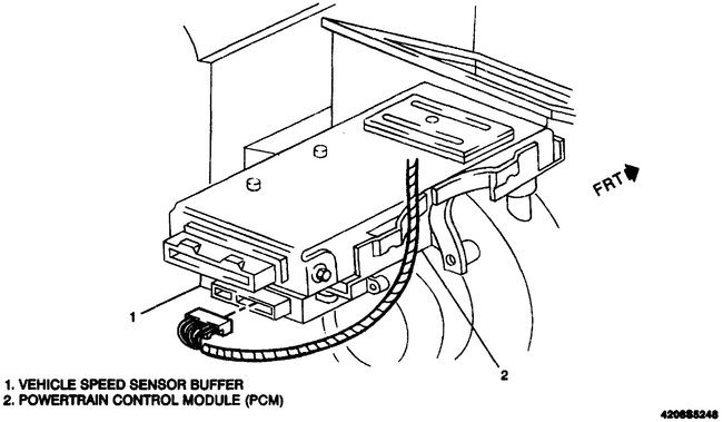

Most certainly. The VSS can be the entire problem. However, before just replacing it, have you checked for diagnostic trouble codes? Usually a bad sensor will set a code indicating the failure.
Pic 1 shows VSS location.
If you check the VSS and it's good, continue to the next test.
If you get a code 16, there is most likely an issue with the VSS buffer. Here are the directions for testing it.
CIRCUIT DESCRIPTION
This DTC concerns a loss of 2002 pulses per mile to the PCM terminal "F13." This may be caused by loss of power to the Vehicle Speed Sensor (VSS) buffer or an open or grounded signal line.
DTC 16 WILL SET WHEN
^ Less than 2 mph.
^ 1400 to 5000 rpm.
^ Throttle angle less than 2%.
^ ECT greater than 60°C (140°F).
^ MAP less than or equal to 27 kPa.
^ CKT 1716 open or grounded.
^ All conditions must be met for 2 seconds.
ACTION TAKEN (PCM WILL DEFAULT TO)
None.
DTC 16 WILL CLEAR WHEN
Conditions for fault are no longer present and Tech 1 "clear DTCs" function is used or 50 ignition switch keycycles have passed with no further faults or ignition switch is turned "OFF" and battery feed voltage is removed for 10 seconds.
DTC CHART TEST DESCRIPTION
Number(s) below refer to circled number(s) on the diagnostic chart.
1. This tests for B+ at VSS buffer.
2. This tests for proper ground path for vehicle speed sensor signal buffer.
3. This tests for vehicle speed sensor signal buffer signal to PCM.
4. This test checks for faulty connections and a faulty VSS buffer.
DIAGNOSTIC AIDS
Check connections at VSS buffer and PCM. Refer to appropriate trouble codes if DTC 24 or DTC 72 is also set.
The remaining pics are a flow chart for checking this issue. The last two pics show location of the VSS buffer.
Let me know if this helps or if you have other questions

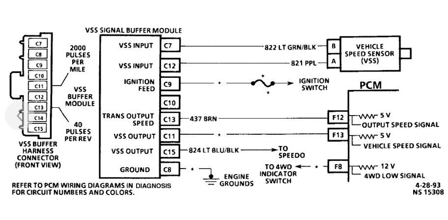

BRYCEN ROGERS
I have first and second gear but no third fourth and the turn signals fast. code 24 speed sensor won't work put new one in transmissions brand new.
Okay. The no third or fourth is most likely caused by the wheel speed sensor code so we need to fix that. I attached the test for this code. If the transmission is new and the sensor is new then more than likely you have a wiring issue which you should find following this test.
Let me know if you have questions as you work through it. Thanks

BRYCEN ROGERS
Now the charts that you sent me, do I start with the first page and then go to the second page then the third where do I start?

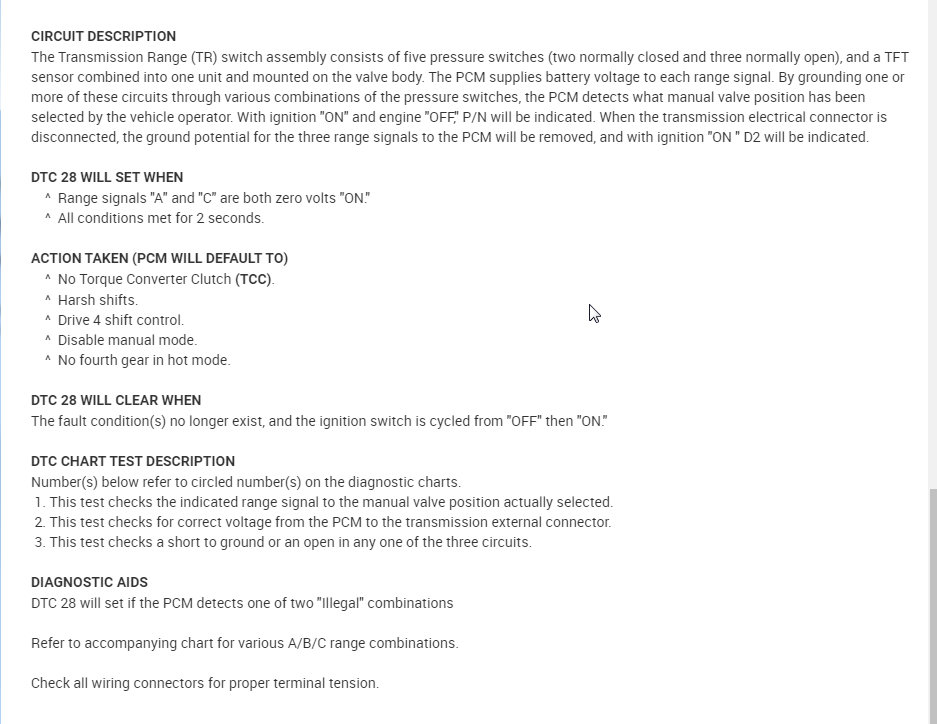

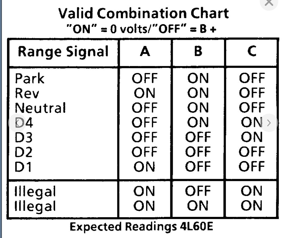

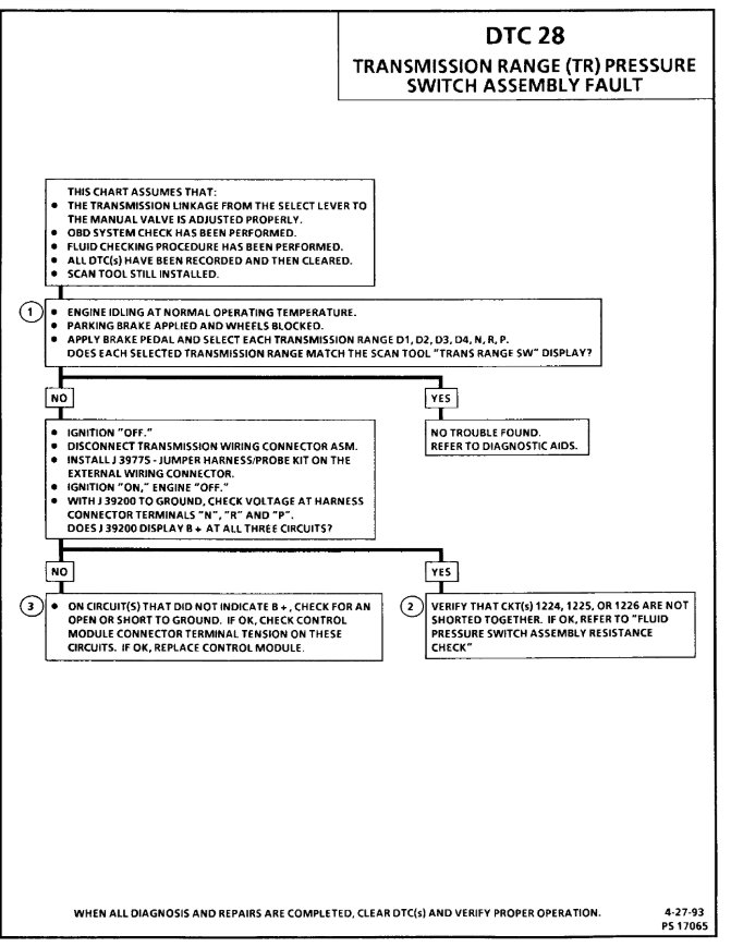

BRYCEN ROGERS
I also have a code 16 and a code 28 which is bad wiring 16.
Okay. I attached those codes as well. Yes. You start with the flow chart and the second page is the wiring diagram for this code. Then the last page is a description. I would read the third page so you are familiar with it but it looks like you may have one issue causing all three of these so I would start with one of the speed sensor codes and fix that one. Then I bet the others will not return either. However, if they do, just move onto to it. Worse case scenario you have three separate issues but I highly doubt that.

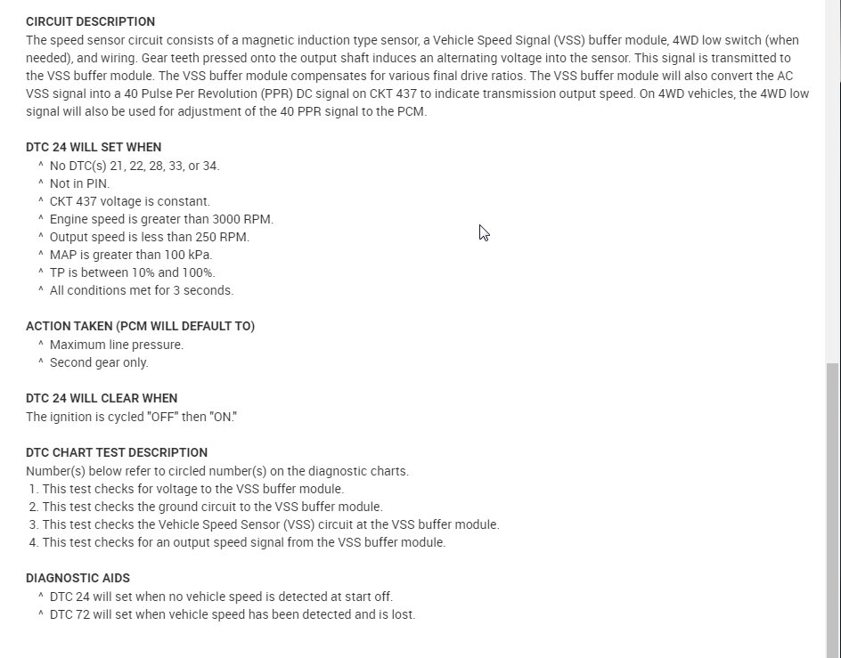

My trucks transmission seems to shift too late into second and third. It also has a hard shift into second. Most of the driving is in 20 to 40 mile zones. When I need to drive 20 mph the trans is in first gear. Will change into second until about 22 to 23 mph. Seem to me that if you are not accelerating it should shift up into third so that I can drive at this speed and not use up a lot of gas.
If I need to cruise at 30 mph it stays in second. Will not change into third until about 37 mph.

DTC 24 - Vehicle Speed Sensor error (open circuit or no activity) Does the speedometer work? If not check the speed sensor on the back of the T-Case for bad/damaged wiring. Or a defective speed sensor.
DTC 61 - This one comes up with three possible definitions. The one GM lists as applicable to your truck is a bad BPMV (Brake Pressure Modulator Valve) (for DTCs 61/62/63 all the same solution, replace the valve.
DTC 73: Pressure Control Solenoid (PCS) Circuit Current Error (Force Motor Circuit)
Circuit Description: The pressure control solenoid is a TCM-controlled device used to regulate transmission line pressure. The TCM compares TP voltage, engine rpm and other inputs to determine the appropriate line pressure of a given load. The TCM will regulate the pressure by applying a varying amperage to the pressure control solenoid.
The applied amperage can vary from 0.1 to 1.1 amp. The TCM then monitors the amperage on the return circuit.
DTC 73 Will Set if - The return amperage varies greater than 0.16 amps from the commanded amperage.
All conditions are met for 1 second.
I would start with the speed sensor as it tells the system when and how to shift and may be causing the DTC73 because it does not shift.

MIKE GIBBS
Will go 15-20 miles an hour then rpm's go up.
Happened in stop and go traffic. By the time I got to stopping place it was overheating. Had to replace gasket on water pump. No water in transmission fluid or fluid in water. Gives no codes.
Good afternoon,
There is a governor in the transmission that controls the shifting. It is a common failure for this issue.
2. If necessary, remove exhaust system.
3. Remove governor cover from case using extreme care not to damage cover. If cover is damaged, it should be replaced.
4. Remove governor.
5. Reverse procedure to install and check fluid level.
MIKE GIBBS
Called around could not find another governor in town give me a few days but I did feel this one apart and that is the problem you can see one of the pins for the butterfly weights is sheared and the gears are half gone
