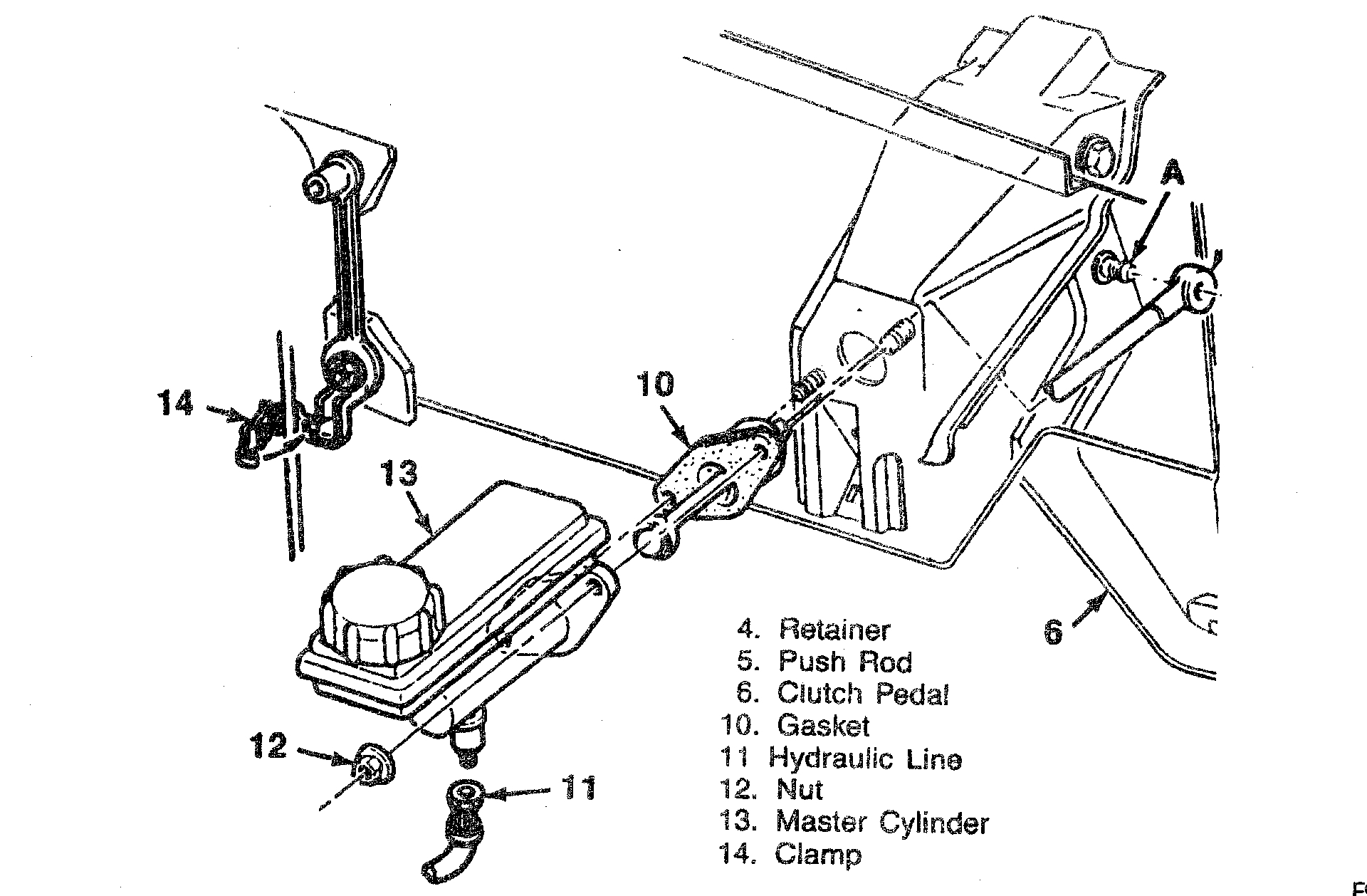

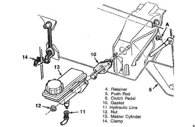

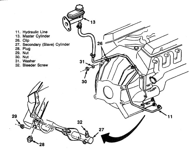

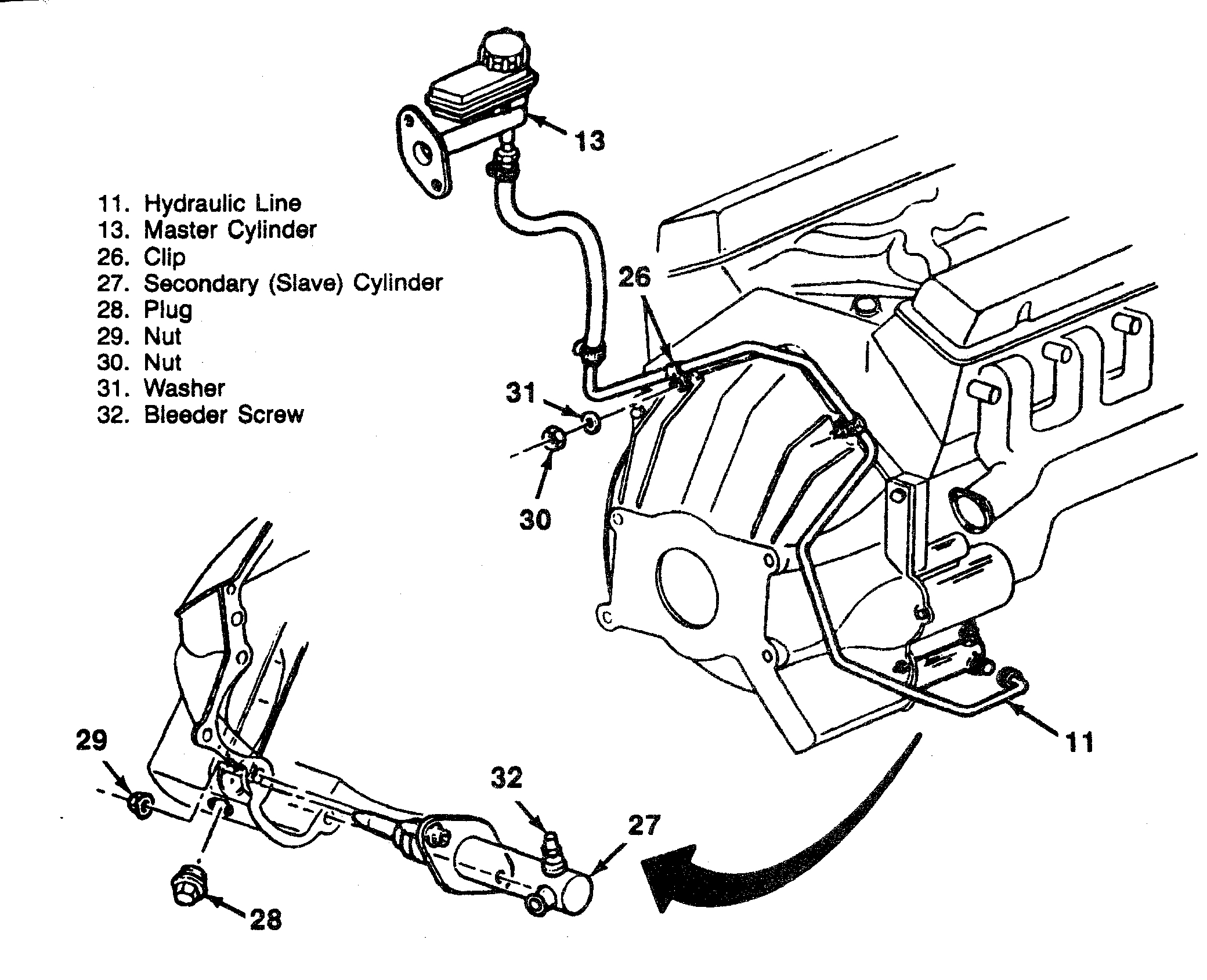

I realize you already have it out, but wanted to at least provide the directions for bleeding. You will need to do that after it is replaced. The attached pictures correlate with the directions.

SYSTEM BLEEDING
Bleeding Hydraulic Clutch Actuator
Pic 1
pic 2
Bleeding
1. Fill the reservoir with DOT 3 brake fluid.
Note: Never, under any circumstances, use fluid which has been bled from a system to fill the reservoir, as it may be aerated, have too much moisture content and possibly be contaminated.
2. Remove the secondary (slave) cylinder (27) and tip the bleeder screw (32) up.
3. Hold the clutch pedal down, open the bleeder screw (32) to let air and fluid escape, and close the bleeder screw (32). Let the clutch pedal up.
4. Repeat step 3 until all air is out of the system.
Note: Check and refill the reservoir as needed while bleeding so that air is not drawn into the system.
5. Install the secondary (slave) cylinder (27) and refill the reservoir if needed.
_______________________
Let me know if this helps. Also, let me know if it takes care of the problem.
Thursday, May 6th, 2021 AT 12:32 PM (Merged)
