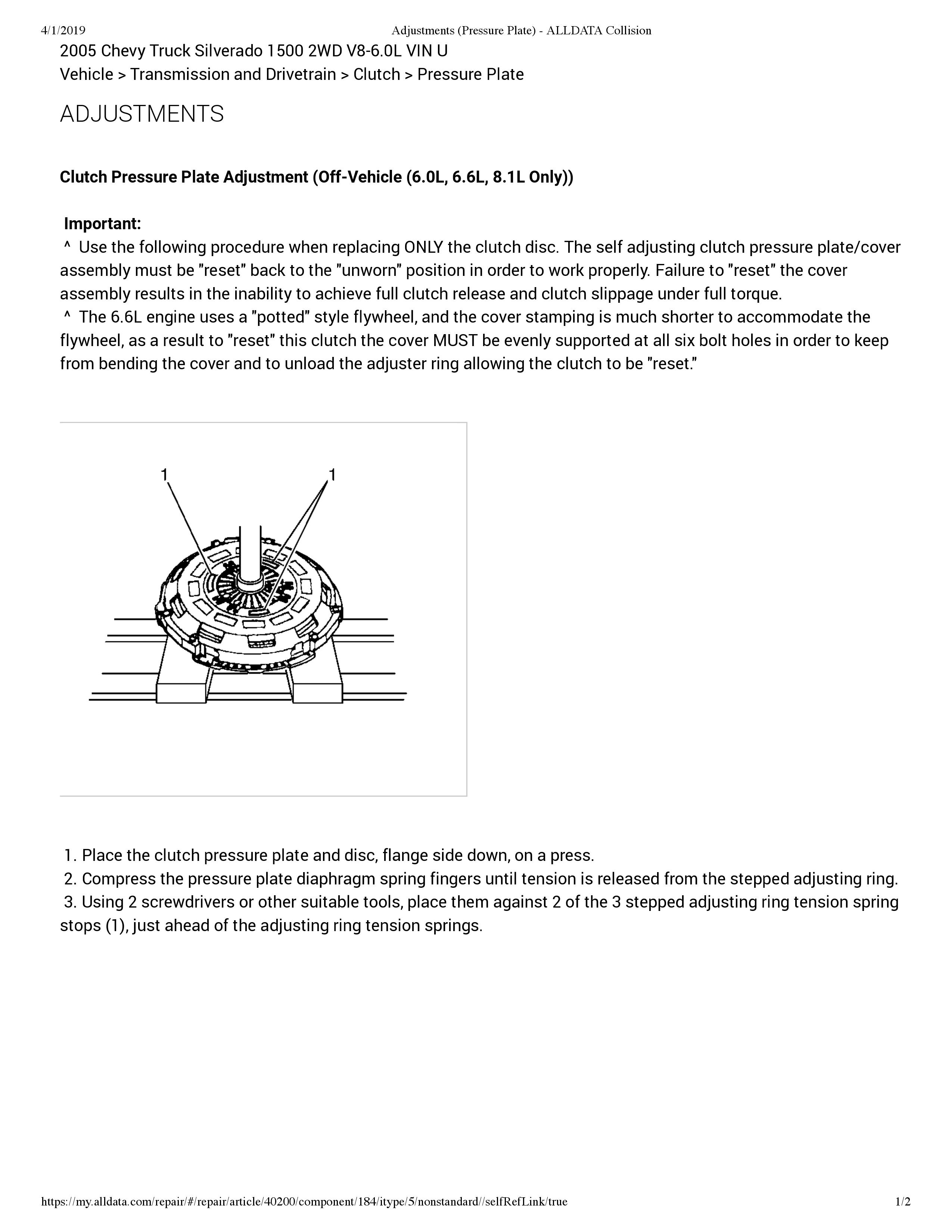

BIKERPRIDE
How do I adjust new clutch before installing in vehicle listed above (2500)?
May 6, 2021 at 12:12 PM (Merged)

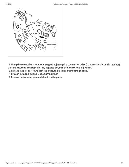

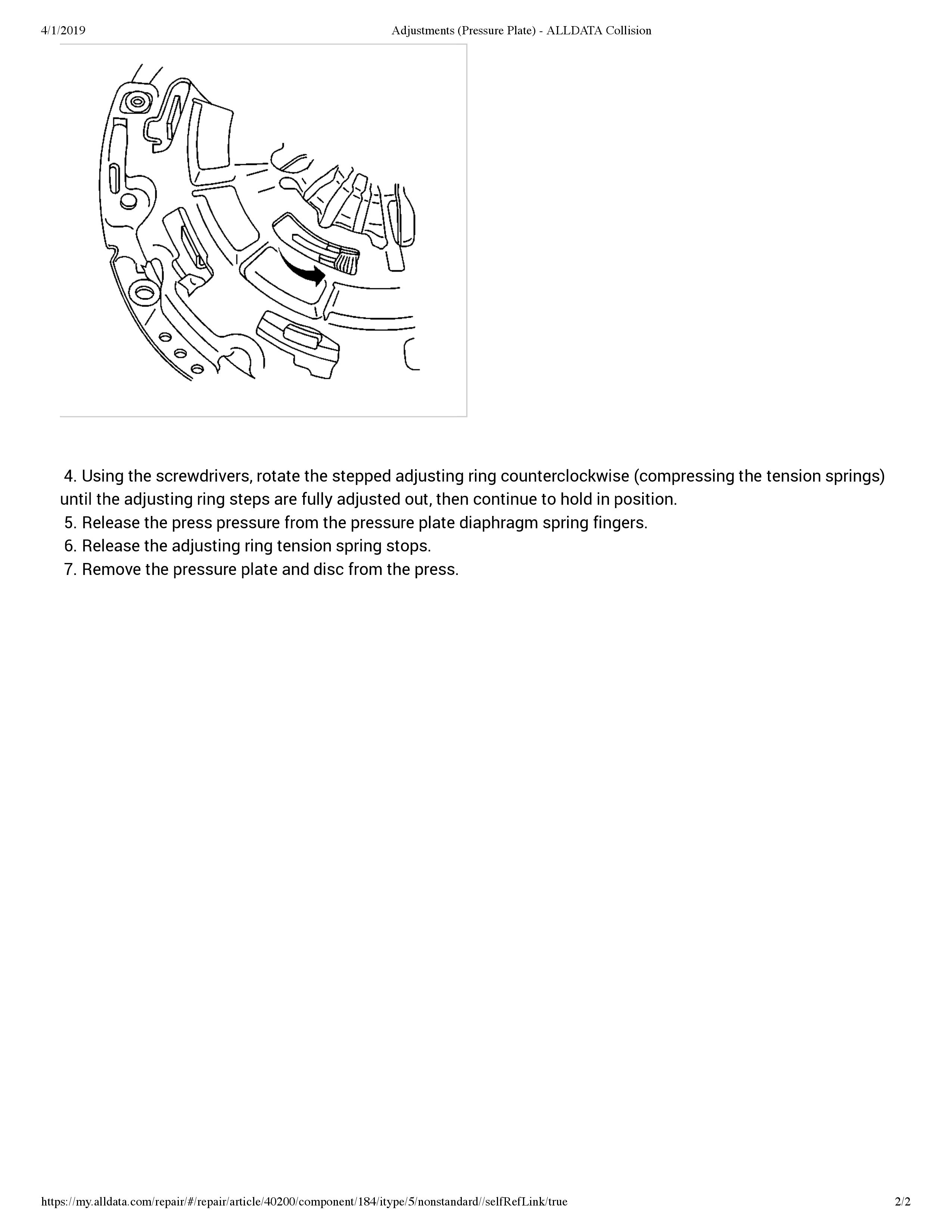

JOETECHPRO
  • 705 POSTS
Hey BIKERPRIDE,
Are you talking about the reset procedure for the self adjusting clutch mechanism?
If you are replacing the pressure plate, normally part of a clutch kit, the new pressure plate should come already set for the new friction plate.
If you are reusing the old pressure plate the instructions to reset are below.
Hope that helps, any further questions don't hesitate to ask.
