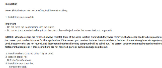

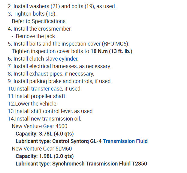

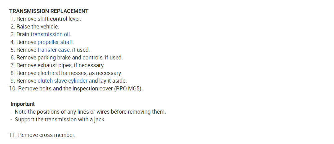

Just recently installed a new clutch and put the transmission back on. I shift the truck into first gear and it does not move. I do hear what sounds like grinding when I release clutch. What could the problem be? I used a clutch alignment tool to align the clutch before putting transmission in. Is it possible I was given the wrong clutch plate and disc? Is it possible the input shaft is not quite matched up to the clutch plate even though the transmission is fully mounted?
May 6, 2021 at 12:32 PM (Merged)
Good afternoon.
When you got the clutch, did you verify the new disc fit correctly on the input shaft? there are different size discs and if you have the wrong one, it would explain the noise. this guide can help us fix it
https://www.2carpros.com/articles/clutch-doesnt-work-sometimes-or-not-at-all
BCMULLEN95
  • 249 POSTS
The clutch plate fits perfectly over the imput shaft. Reinstalled the tranny still no rotation out of the out put shaft. Thinking something may have broke in the transmission. As i drained the transmission there are metal pieces attached to the drain bolt.
STEVE W.
  • 15,200 POSTS

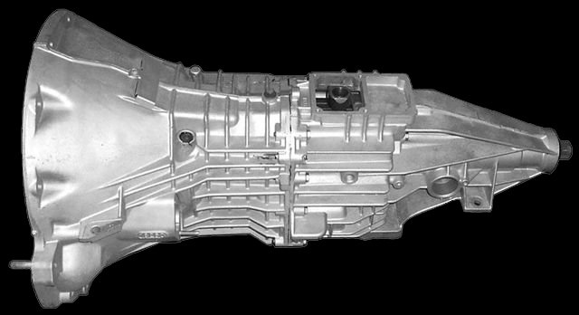

Metal pieces are not good. Could very well be a failed output shaft. I take it none of the gears function? If that is the case I would pull the transmission and open it up. Broken parts should be obvious. This one look like yours? That is an NV3500/Getrag290.

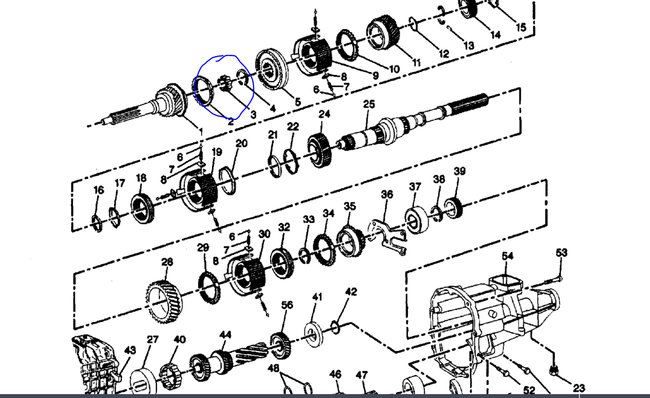

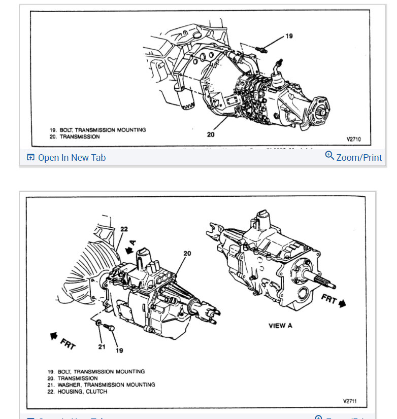

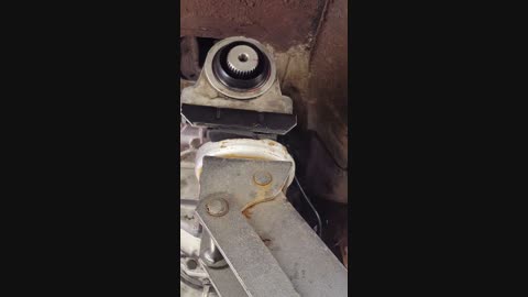

Steve that looks like my transmission. I started the truck and recorded a video of what it is doing. I feel as the the input shaft is not splined into the clutch plate. I think it is to far back. Away from the engine. Would that be an indicator that there is something internally wrong?

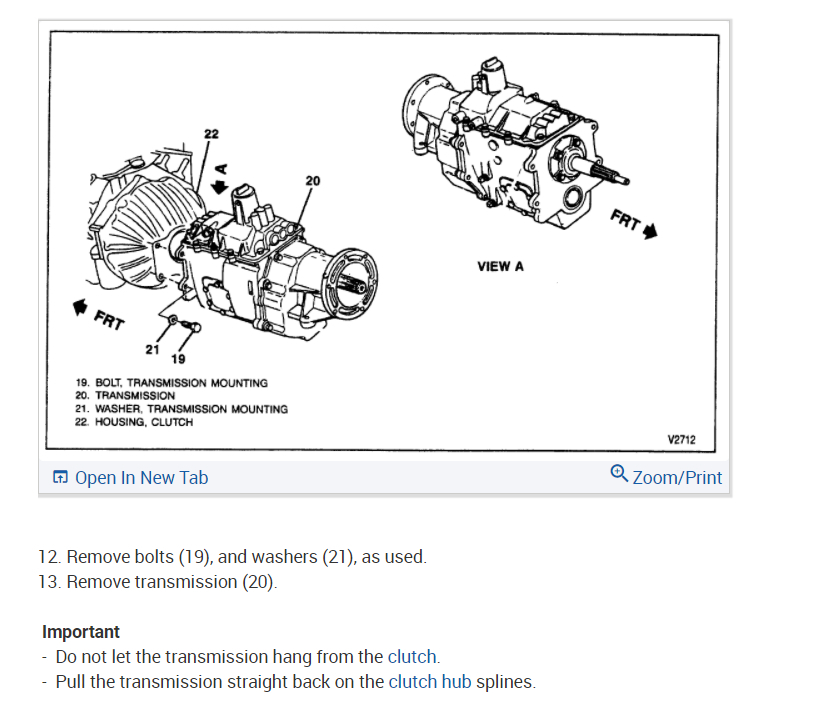

Yes it would. you will need to remove the transmission again and see if when you turn the input shaft, does the output turn with it. make sure it is in a gear.
BCMULLEN95
  • 249 POSTS
Here is the video.
sounds like you will be needing to get another transmission.
STEVE W.
  • 15,200 POSTS
If it is setting in too far it could be the input shaft bearings. You can find those transmissions all over the place, or you could rebuild that one, a kit with all the bearings and gaskets is not that expensive.
BCMULLEN95
  • 249 POSTS
Update, I did pull the transmission and a bearing came apart, the gears are all messed up.
Time for another transmission.

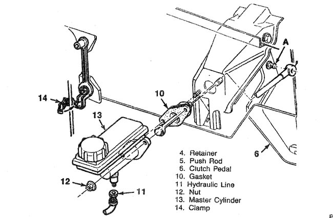

I've replaced the clutch master and slave cylinder on my truck. While bleeding the line I'll get some air and fluid. After a couple times I'll get nothing. No air or fluid. Am I missing something or is this normal? please help. I'm completely lost. thanks
BRCOPELAND
  • 28 POSTS
Okay, update: Got the lines bled and all the air out. Now the clutch pedal is so stiff I cant push it down at all. And can't get it to go in any gear. I'm completely lost. Please help

  • 110,194 POSTS
Welcome to 2CarPros.
If you can't move it at all, something is together wrong. If you open the bleeder on the slave, does the clutch pedal move? If it does, remove the slave and check to make sure it was properly installed. Something is causing it not to move.

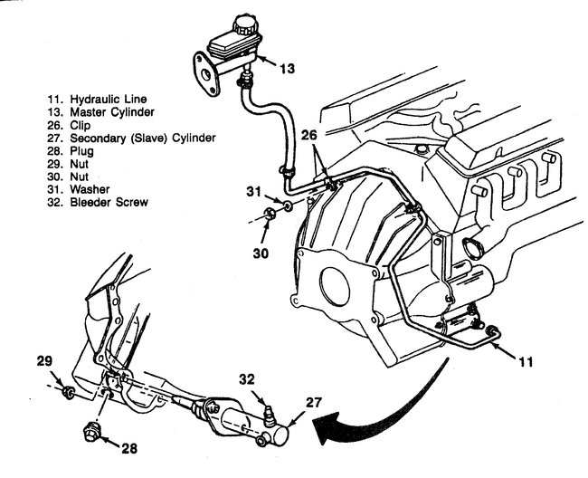

Update. Took the slave out and pedal still won't budge. Crack the bleeder valve open on the slave and the pedal will move. I'm at a complete loss. Please help

  • 110,194 POSTS
If it moves when you open the bleeder, the slave needs replaced. It must be frozen internally. If it was the clutch master cylinder, it still wouldn't move. If it was internal, it would move when removed.
I realize you already have it out, but wanted to at least provide the directions for bleeding. You will need to do that after it is replaced. The attached pictures correlate with the directions.

1991 Chevy Truck C 1500 Truck 2WD V6-262 4.3L
System Bleeding
Vehicle Transmission and Drivetrain Clutch Service and Repair Procedures System Bleeding
SYSTEM BLEEDING
Bleeding Hydraulic Clutch Actuator
Pic 1
pic 2
Bleeding
1. Fill the reservoir with DOT 3 brake fluid.
Note: Never, under any circumstances, use fluid which has been bled from a system to fill the reservoir, as it may be aerated, have too much moisture content and possibly be contaminated.
2. Remove the secondary (slave) cylinder (27) and tip the bleeder screw (32) up.
3. Hold the clutch pedal down, open the bleeder screw (32) to let air and fluid escape, and close the bleeder screw (32). Let the clutch pedal up.
4. Repeat step 3 until all air is out of the system.
Note: Check and refill the reservoir as needed while bleeding so that air is not drawn into the system.
5. Install the secondary (slave) cylinder (27) and refill the reservoir if needed.
_______________________
Let me know if this helps. Also, let me know if it takes care of the problem.

That's with a brand new slave cylinder. After I bleed the system the pedal gets as hard as a rock.

If the slave is removed and the pedal is hard, and when you open the bleeder you can depress the clutch pedal, you may have gotten a bad slave cylinder. Something is preventing the slave from allowing you to depress the clutch pedal. Now, if you told me you could press the clutch pedal without opening the bleeder once the slave was removed, then I would suspect the release bearing is frozen or there was an internal problem.
If the slave is new (and I have been wrong before so I can't guarantee this) I would return it under warranty and get a new one to see if it changes. With the slave out, you should be able to press the pedal because there isn't any resistance.

So latest update. Put another slave cylinder in I've had for a back up. And boom we now have a clutch. Took it around the neighborhood and shifted like new. Now I've just got to bottom up some small issues. Cutting out and things like that. But it's back on the road after six years of sitting/ thanks for your help Joe.

  • 110,194 POSTS
Welcome back:
I'm happy to hear you got it going. I suspected the slave because you said when it was off the vehicle, it was still locked until you opened the bleeder. That's the only thing it could have been.
Regardless, it's great to hear after 6 years, it's going again.
