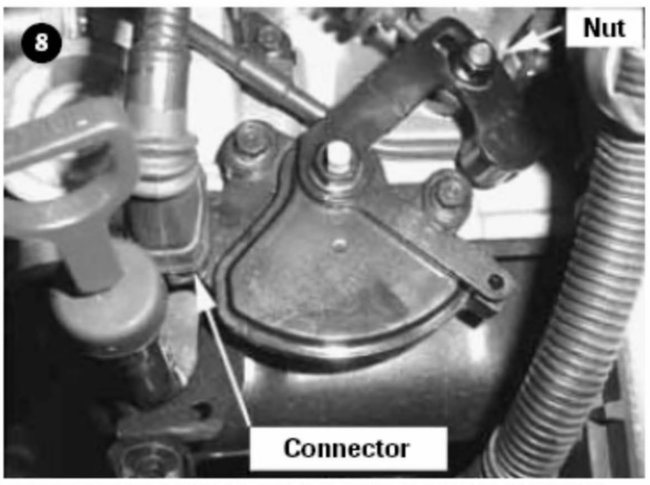

I ask because there is what is called a range sensor which is what tells the computer what gear has been selected. If it fails, what you are experiencing could be the result.

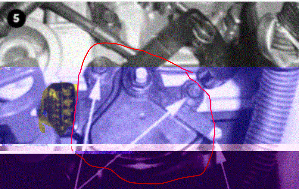

I attached a pic below showing the range sensor. The highlighted point is where the connection is made. See if the plug is tight and not damaged.

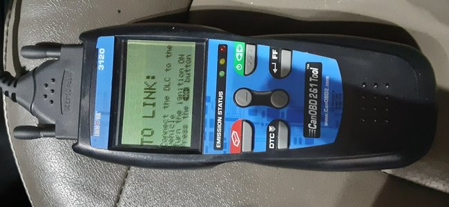

Also, you indicated there are no codes. Are you using a scan tool that can read codes from the transmission control module?

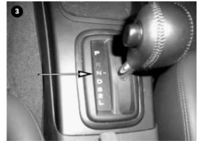

VERIFY THE RANGE SWITCH ADJUSTMENT:
3. Move the shift lever to "N".
pic 2

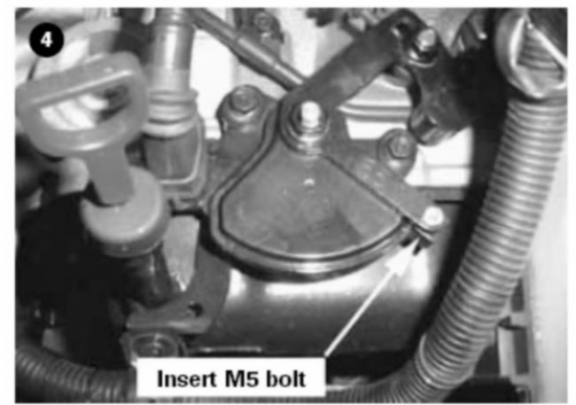

4. Insert a 5 mm drill or MS (5 mm) bolt in the adjustment hole of the range switch. Check that the drill or bolt fits into the adjustment holes.
^If not, go to Step 5
^If so, go to Step 9

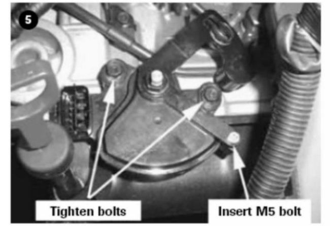

5. Loosen the two 10 mm mounting bolts.
pic 4
6. Disconnect the shift cable at the lever.
7. Insert a 5 mm drill or M5 (5 mm) bolt in the adjustment hole of the range switch. Tighten the two 10 mm mounting bolts to specification.
Specification: 7-8 ft.lb
(10-12 Nm, 100-120 kg.cm)
8. Move the shift lever to the "N" position. Attach the
shift cable to the lever and install the nut. Tighten the nut to specification.
Specification: 9-10 ft.lb
(12-13 Nm, 120-130 kg.cm)
Remove the 5 mm drill or M5 bolt.
pic 5

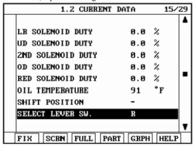

^"Select Lever Switch" and "Shift Position:
10. Move the shift lever to Reverse.
^Monitor "Select Lever Switch".
^If "R" is displayed, the TCM is receiving the correct signal from the range switch. Go to Step 11.

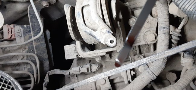

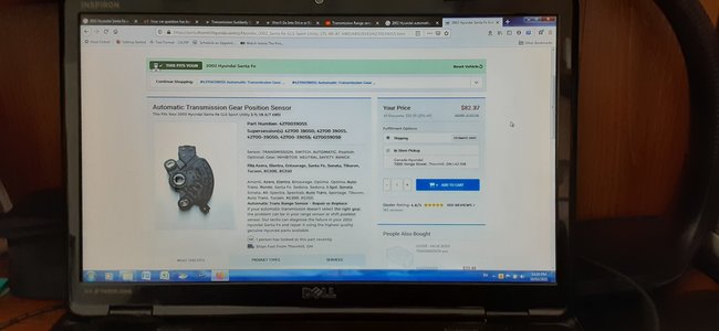

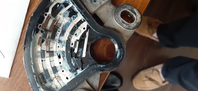

Well lets start with a; no, I don't have a scan tool that's designated to transmission codes, its just a OBD ll Scan Tool, which I thought picked up all codes. All the other indicators mentioned are okay, oil levels, color, shifter and cable and smell. Since I am unable to use a diagnostic tool or access one, I will have to rely on years of manual troubleshooting. So at this point I will order and replace the range sensor as it appears to be a good chance of one of the problems noted in our conversations, if that is not it I will do the oil check for filter and metal fragments.
below are some pictures, scanner, fuse box (for trans fuse), range sensor, dip stick with oil level an color. I will keep you posted on the replacement of range sensor.
