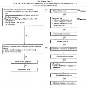

Encountered hard shift (wife) and check engine light. Code indicated output speed sensor and that was replaced. Initial test run OK, but wife said hard shift came again and check engine light came on. Performed "fuzzy" re-flash on TCM by touching both battery cables for 15+ sec. and check engine light went away. Test run fine for first couple of miles, but after running 40+ mph in cruise for a couple of miles, had hard shift down to third gear and engine light returned. Once this hard shift happens, the trans will not go into OD again unless the engine has been shut down and restarted. Hard shift is now exclusively from OD to third gear. Have not had car over 50 mpg or on highway; all in town driving.
No other fault codes beyond speed sensor.
What next?

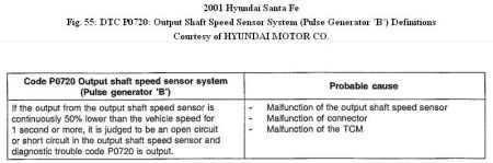

revisited Auto Zone and came up with two codes - P0720, Output Spd Sensor and P1529 which my wife said the dealer told her was "evaporative leak" (like a gas cap).
Auto Zone also said they'd exchange the spd sensor if I felt the one I got from them was faulty.
Apr 22, 2010 at 2:06 AM
KHLOW2008
  • 41,814 POSTS
I believe the P1529 is a reference code for the transmission having some trouble. Check the following to see if you can get any results.
https://images.2carpros.com/forum/automotive_pictures/192750_P0720SantaFe01Fig55_1.jpg
https://images.2carpros.com/forum/automotive_pictures/192750_P0720SantaFe01Fig56_1.jpg

Mystery solved. Finally gave up and took car to dealer who ended up replacing Output Speed Sensor. Car's fixed - runs fine.
Problem arose when Auto Zone read codes and sold me the wrong speed sensor. When questioned about that after replacement did not resolve problem, they continued to insist that the sensor purchased from them was the culprit. Learned a hard and expensive lesson.
