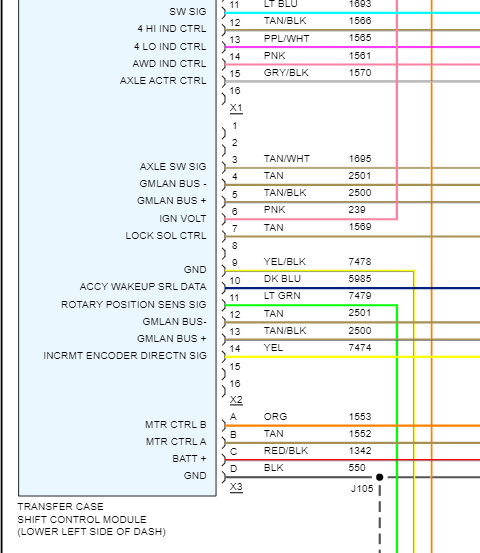

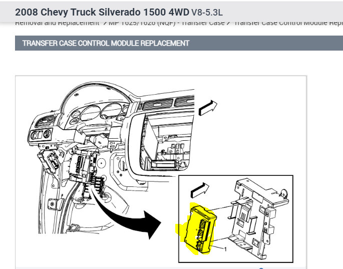

I am trying to find a diagram for the location of the TCCM for the truck listed above 1500.

It is located on the lower left part of the dash. See pic below.
What types of issues are you having? Also, have you scanned the module to confirm there is a problem?

Problem solved. I already had the replacement ordered just wanted to make sure I was replacing the correct module. Thank you
