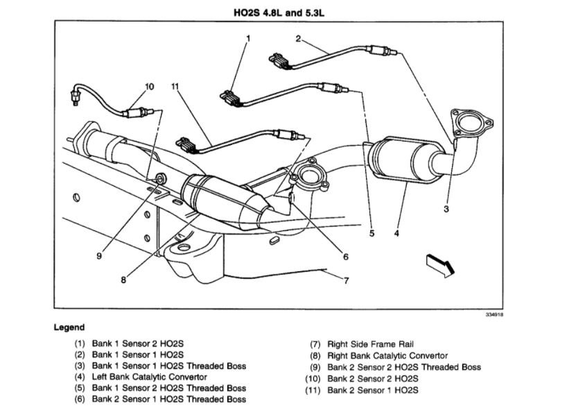

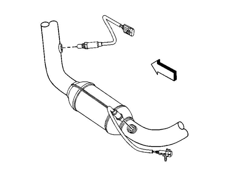

any help to replace all 4 oxygen sensors with their locations would really help me out.
Aug 24, 2009 at 10:25 AM
Good afternoon,
I attached a picture of the location of all the sensors below. The procedure is the same for all of them. Remove the connector and just unscrew the sensor and remove it.Here is a video and guide to show you how to do the job on a similar car which the process is the same. I have included instructions and diagrams below to show you how on your car.
https://youtu.be/B4CAou7i7Io
and
https://www.2carpros.com/articles/how-to-replace-an-oxygen-sensor
HEATED OXYGEN SENSOR (HO2S) REPLACEMENT BANK 1 SENSOR 1

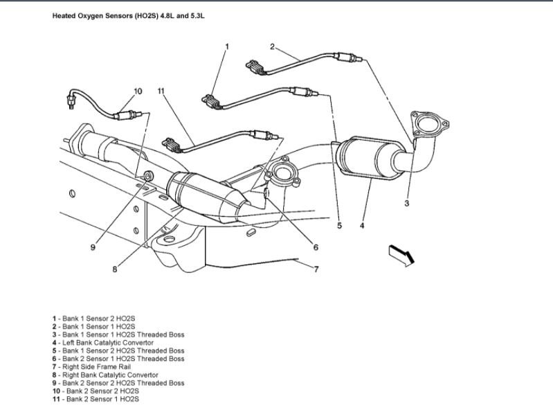

Check out the diagrams (Below). Let us know what happens and please upload pictures or videos of the problem.

Your vehicle has 4 oxygen sensors. 2 in the left exhaust pipe and 2 in the right exhaust pipe. May want to test all 4 to see which one needs replaced first. Follow this link to learn how to test an oxygen.

there are one ont he exhaust piping on each side of the engien before the convertor, and you may have two after, that are used to monitor catalytic convertor efficency.
o2 sensor bank 1 sensor one is the sensor before the convertor on the driver side of the engine.
o2 sensor bank2 sensor one is on the opposite side of the engine.

Yes, two upstream and two downstream sensors here is a guide to help you change the oxygen sensors out and a diagrams below to show you the location.

Good afternoon,
I attached a picture with the location of all 4 sensors for you.
https://www.2carpros.com/articles/how-an-oxygen-sensor-works
I also attached the procedure. It is the same for each sensor.

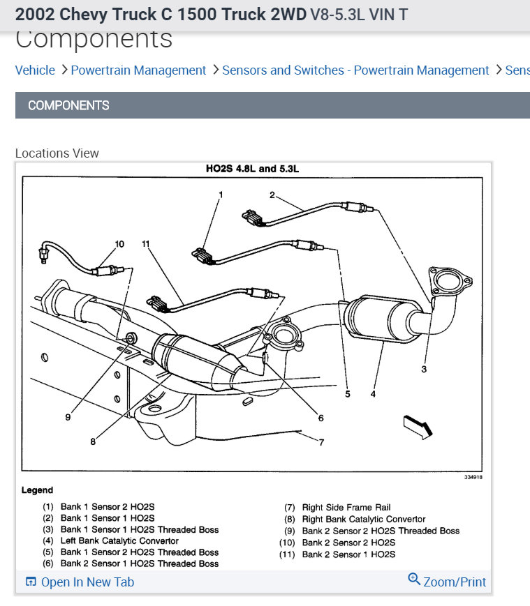

2002 Chevy Truck C 1500 Truck 2WD V8-5.3L VIN T
Heated Oxygen Sensor (HO2S) Replacement Bank 1 Sensor 1
Vehicle Powertrain Management Sensors and Switches - Powertrain Management Sensors and Switches - Computers and Control Systems Oxygen Sensor Service and Repair Procedures Heated Oxygen Sensor (HO2S) Replacement Bank 1 Sensor 1
REMOVAL PROCEDURE
1. Raise and suitably support the vehicle. Refer to Lifting and Jacking the Vehicle.
NOTE: Refer to Heated Oxygen and Oxygen Sensor Notice in Service Precautions.
2. Remove the connector position assurance (CPA) retainer.
3. Disconnect the oxygen sensor electrical connector (1).
4. Remove the oxygen sensor.
INSTALLATION PROCEDURE
IMPORTANT: A special anti-seize compound is used on the heated oxygen sensor (HO2S) threads. The compound consists of liquid graphite and glass beads. The graphite tends to burn away, but the glass beads remain, making the sensor easier to remove. New, or service replacement sensors already have the compound applied to the threads. If the sensor is removed for any reason and the old sensor is to be reinstalled, the threads must have a anti-seize compound applied before the reinstallation.
1. Coat the threads of the oxygen sensor with anti-seize compound GM P/N 5613695, if necessary.
NOTE: Refer to Component Fastener Tightening Notice in Service Precautions.
2. Install the oxygen sensor (2).
Tighten
Tighten the sensor to 42 N.m (31 lb ft).
3. Connect the oxygen sensor electrical connector (1).
4. Install the CPA retainer.
5. Lower the vehicle.

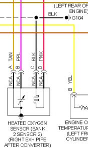

Hi, i would like to know if possible what is the exact wire coloring for the oxygen sensors located after the catalytic convertors. Including the 12v, ground, and heater wire colors
Mar 31, 2021 at 2:59 AM (Merged)
FACTORYJACK
  • 4,159 POSTS
The colors possibly change on the sensor side of the connectors, but here is the colors on the harness(vehicle) side. There is no 12V circuit, other than the heater control side. Bank 1 Sensor 2 pin A(H02S Lo) TAN/WHT, Pin B(H02S HI) PPL/WHT, Pin C(HTR ground) BLACK, and Pin D(HTR Pwr) PINK. Bank 2 Sensor 2 Pin A(H02S Lo) TAN, Pin B(H02S Hi) PURPLE, Pin C(HTR ground) BLACK, and Pin D(HTR pwr) PINK. Both sensor heaters are powered from O2 B fuse in underhood fuse block.

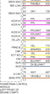

My check engine light was diagnosed as bank 2 o2 sensor low voltage. I replaced the sensor and disconnected the battery to reset the computer. When restarting the truck, the engine light comes back on. What should I do. I have replaced this sensor twice with the same results.
Mar 31, 2021 at 3:00 AM (Merged)
MERLIN2021
  • 17,250 POSTS
VCM supplies a voltage of about .45 volt between HO2S 2 signal and HO2S 2 ground circuits. HO2S 2 varies voltage from about one volt with rich exhaust to 0.1 volt with lean exhaust. HO2S 2 produces no voltage and acts as an open circuit when temperature is less than 600 °F (316 °C). DTC P0157, DTC P0158, an open sensor circuit or a cold sensor causes open loop operation. DTC P0157 determines if HO2S 2 or circuit is shorted low by checking for a lean condition during steady throttle and power enrichment. For duplication of DTC, ensure no misfire, EVAP system, ECT, IAT, MAF, MAP or TP sensor DTCs are set, no intrusive tests are in progress, no device controls are active, and system voltage is at least 9 volts. 1.Perform On-Board Diagnostic (OBD) system check. See ON-BOARD DIAGNOSTIC (OBD) SYSTEM CHECK under SELF-DIAGNOSTIC SYSTEM. After performing OBD system check, go to next step. 2.Install scan tool. Warm engine to normal operating temperature. Place gear selector in Park or Neutral. Apply parking brake. Increase engine speed to 1200 RPM. Monitor HO2S 2 voltage using scan tool. If voltage is fixed at less than .026 volt (4.3L, 5.0L and 5.7L) or less than .086 volt (7.4L), go to step 4. If voltage is not as specified, go to next step. 3.DTC is intermittent. Check if additional DTCs are set. If any additional DTCs are set, go to applicable DTC test. If no additional DTCs are set, see DIAGNOSTIC AIDS. 4.Turn ignition off. Disconnect HO2S 2 harness connector. Connect a jumper wire between HO2S 2 low circuit of HO2S 2 harness connector (VCM side) and ground. Turn ignition on, with engine off. Monitor HO2S 2 voltage using scan tool. If voltage is .35-.55 volt, go to next step. If voltage is not .35-.55 volt, go to step 6. 5.Check for any condition that may cause HO2S 2 to detect a lean condition. Repair as necessary. After repairs, go to step 10. If no problem is found, go to step 8. 6.Turn ignition off. Remove jumper wire from HO2S 2 low circuit. Disconnect VCM harness connector containing HO2S 2 high signal circuit. Check for continuity between HO2S 2 high signal circuit and ground, and then between HO2S 2 high signal and low circuits. If no continuity is present in either circuit, go to step 9. If continuity is present in either circuit, go to next step. 7.Repair HO2S 2 high signal circuit for short to ground or short to HO2S 2 low circuit. After repairs, go to step 10. 8.Replace HO2S 2. After repairs, go to step 10. 9.Replace VCM. Program replacement VCM using required equipment. Perform Passlock ® reprogramming and CKP system variation learn procedures. After repairs, go to next step. 10.Using scan tool, clear DTCs. Start and warm engine to normal operating temperature. Select DTC, SPECIFIC, and then enter this DTC. Operate vehicle within the conditions for setting this DTC. If scan tool indicates that this test ran and passed, go to next step. If scan tool does not indicate that this test ran and passed, go to step 2. 11.Using scan tool, select CAPTURE INFO, REVIEW INFO function If any undiagnosed DTCs are displayed, go to applicable DTC test. If no undiagnosed DTCs are displayed, system is okay. 3/19/20 Diagnostic Aids Using scan tool, observe Long Term (LT) fuel trim values at different RPM and airflow conditions. Scan tool should display fuel trim cells so that LT fuel trim values can be check in each cell to determine when DTC may have set. If DTC is set, LT fuel trim values will be about 158 or greater. Check for mispositioned HO2S wire pigtail contacting exhaust manifold. Check for intermittent ground in wire between connector and sensor. Check for poor VCM to engine block ground. Check for lean fuel injectors. Check for water near in-tank fuel pump inlet that may be delivered to injectors. Water causes a lean exhaust and can cause DTC to set.
https://images.2carpros.com/forum/automotive_pictures/62217_pcm1_1.jpg
https://images.2carpros.com/forum/automotive_pictures/62217_wd_2.jpg

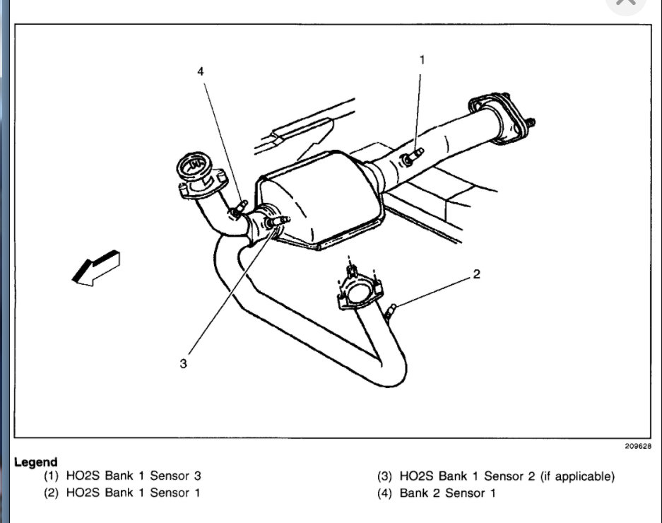

1999 Chevy Silverado/Z71/ 5.3 liter/extended cab/63,000 miles -I want to change the oxygen sensors on my 1999 Chevy Silverado. Could you please tell me how and where they are located on the engine?

They make a deep scket with a slit in the side for the wires, you will fid them by going to each exhaust manifold, and following the pipes till you bump into the sensor in the manifold, or pipe, you will have a minimum of 3 and if dual exhast, 4...1 before the conveter and 1 after on each side...

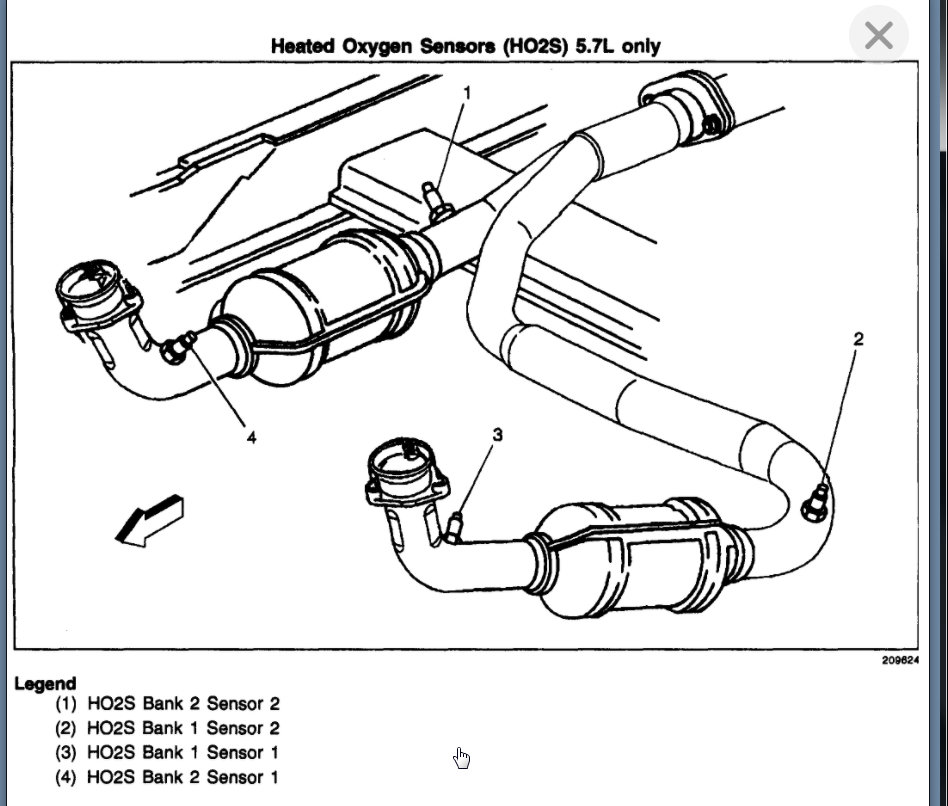

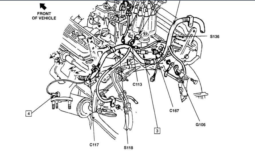

Where is the Bank 1 Sensor 2 on 98 Silverado? How do I replace it?
The first attachment is of the 5.7L and the second is of the 5.0L. So depending on what V8 you have you can find the sensor with these attachments.
Also, here is a guide that will help with more general information:
Let us know if you need more info. Thanks

where do the oxygen sensors plug into on the truck listed above k1500?

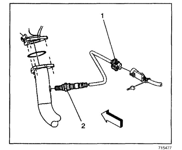

Good evening,
I attached a picture for you to view.
The connector is at the back of the motor in the picture I attached.
Why are you replacing the sensor?
