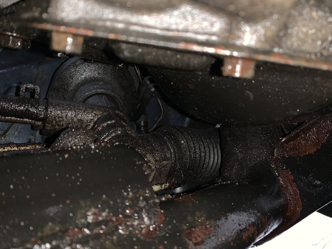

THUNDRNT66
I took out the battery to be able to see everything better and tomorrow my buddy is taking a pressure washer to it to clean it off to hopefully pin-point the leak. It’s literally everywhere. Underside is coated and dripping with it, it’s on top in crevasses if the transmission, by the breather for the gear shift under the air box, the transmission mount, and I think my power steering is leaking too. If I could upload multiple photos it’d be easier, lol.

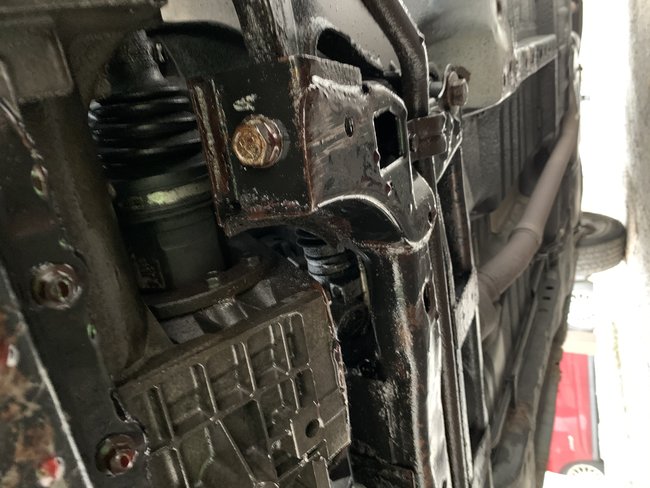

THUNDRNT66
Here is a better picture of the underneath.
Feb 24, 2021 at 3:12 PM
94 TRANSAM
  • 680 POSTS
I still can't see where its coming from but I can see it's a massive leak. I don't think its the CV seals because the fluid is forward of the CV's. Short of a crack in the transmission the only thing that will leak fluid like that is the torque converter seal which is a common leak. Unfortunately replacing that seal requires removal of the transmission. I would however start the car and try to trace exactly where the river is coming from to confirm.
  • 54,837 POSTS
Yes, that is a bad leak alright. you may need to go buy the car wash to clean the transmission with the pressure hose and then let it dry, start the car and see where the leak is coming from, use a flashlight.
