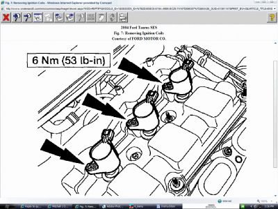

ANDY OQUINN
car misfires under load. had a diagnostic check & engine code said #3 cylinder misfiring.
what steps do we take now? does the intake have to be removed to get to coil pack & sparkplug?
Jan 16, 2021 at 1:19 AM (Merged)
MERLIN2021
  • 17,250 POSTS
#3 is the last plug in back near the driver, you must remove the upper intake manifold to access the coil on plugs, When you do get in there you might find a torn boot.
https://images.2carpros.com/forum/automotive_pictures/62217_Cop_1.jpg
