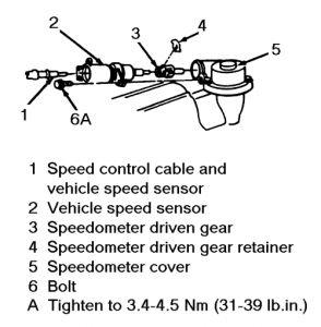

After the car has been warmed up about 1 hours of driving the speedometer drops to 0, the tachometer still works and revs high. The car seems to not shift gears and when it does it jerks and makes a loud cluck into gear but the speedometer still reads 0. The check engine light has now come on but it did not in the beginning.

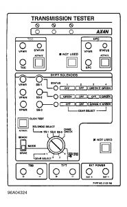

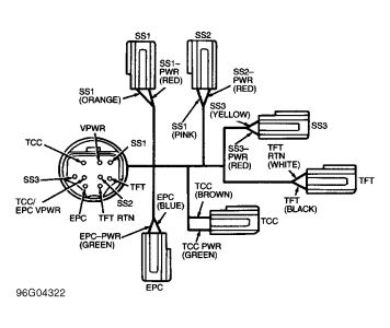

TMCG
I just wanted to follow up on this. I checked the valves in #2 just to be sure the rockers were torqued properly since there's no valve adjustment on this engine; all good. While I had it apart I swapped injector 4 back to #2. When reinstalling the upper intake manifold it seemed to not seat properly. After rocking it around a bit it appeared to seat fully. When I started it up, miss was gone and the engine ran smoothly. Drove it for about 50 miles to test it and it continued to run strong; no miss and no 30x codes. I can only think that the upper intake manifold was not seated properly on the first go round.
After a couple days new codes postes; 0430 and 1744 but I think that's unrelated. Just wanted to let you know the outcome.
By the way, for a 1744 is the TCC solenoid actuator internal or external to the trans?
Saturday, January 16th, 2021 AT 9:48 AM (Merged)
MERLIN2021
  • 17,250 POSTS
First, if this is a 95' it should have OBDI and you are giving me OBDII 96' and newer codes?
https://www.2carpros.com/forum/automotive_pictures/62217_taurus_2.jpg
https://www.2carpros.com/forum/automotive_pictures/62217_taurusc_1.jpg
TMCG
Merlin, first off, right you are on the year. It's my son's car and I just had 1995 in my head.
Anyway your reply is quite a mouthful and I appreciate the detail you provided. Considering the specialized equipment, familiarity with what a Quick or KOEO test is for example, detailed wiring and connector diagrams or the Maintenance Analysis procedures of the manufacturer; you made it very apparent that I would be biting off more than I could chew if I started messing with the transmission.
Thanks again for all your help. Although it appears to be running/shifting fine over the past 500 miles or so, I guess he'll just have to drive it until the trans gives it up. Tom
