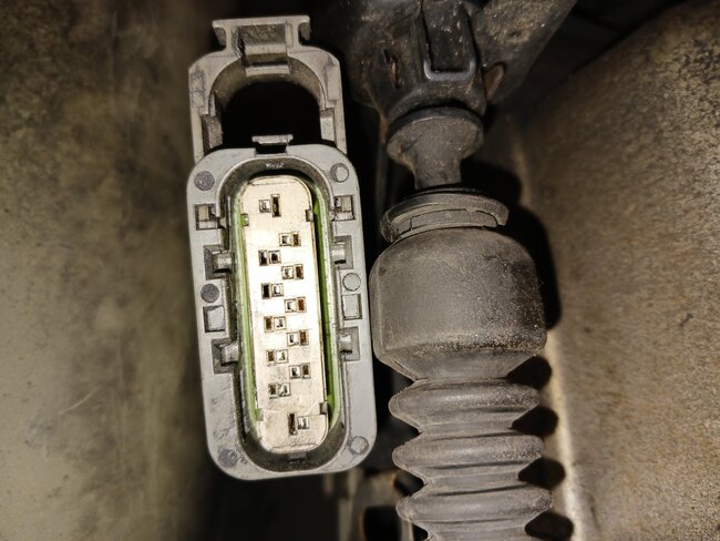

Good afternoon. I don't see a pink wire in that harness. Just to verify the vehicle is a 2006 trailblazer with a 5.3 and 2WD transmission.
Tuesday, February 7th, 2023 AT 12:37 PM
  • 109,872 POSTS
That is the correct vehicle. The wire could be faded. Is there anything there that appears it may have been pink?
Sorry, I know this must be frustrating.
Tuesday, February 7th, 2023 AT 8:21 PM
ELEWIS84
  • 24 POSTS
I will check all the wire that resemble pink and report back to you with my results. Thank you

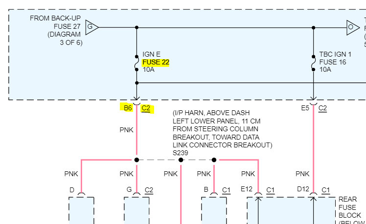

Good afternoon. There isn't power going to the pink wire.
Monday, February 20th, 2023 AT 2:19 PM
  • 109,872 POSTS

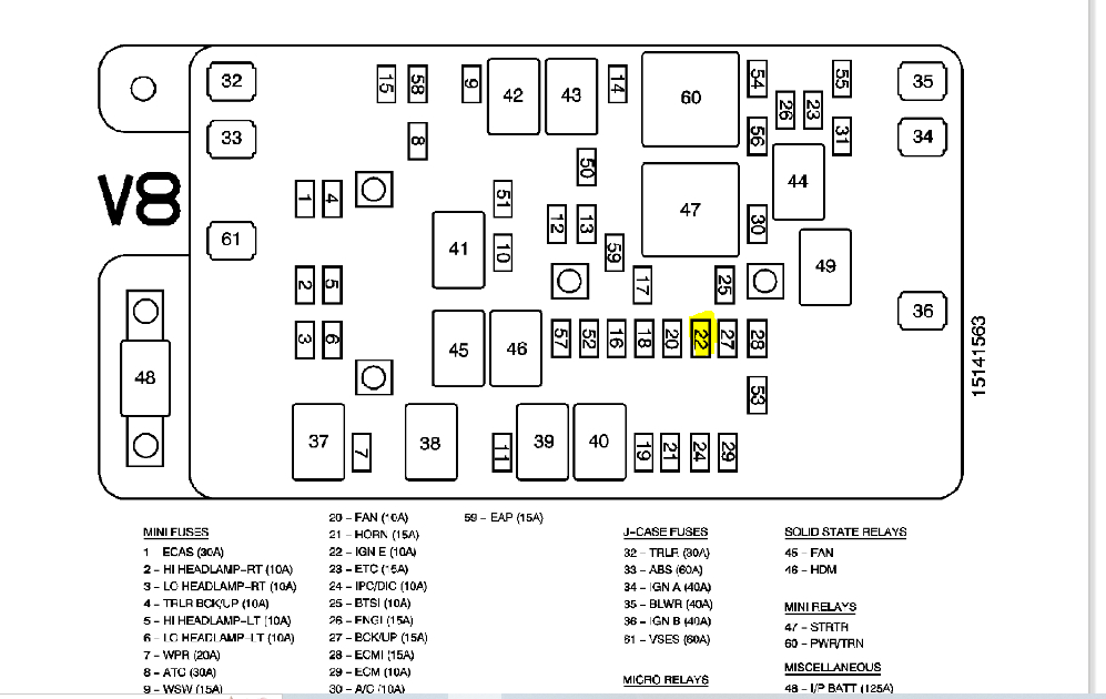

Have you checked fuse 22 in the under-hood fuse box to make sure it is good and there is power to and from it? See pic below
Also, here is a link you may find helpful:
See pic below.
Monday, February 20th, 2023 AT 4:43 PM
ELEWIS84
  • 24 POSTS
Good afternoon. There is roughly 5V going to and from fuse 22 under the hood. Also, there is 5V only going to 2 wires on the neutral safety switch with the key in the run position.
Sunday, March 5th, 2023 AT 3:46 PM
  • 109,872 POSTS
You should have 12v or battery voltage. Is the battery fully charged and in good condition?

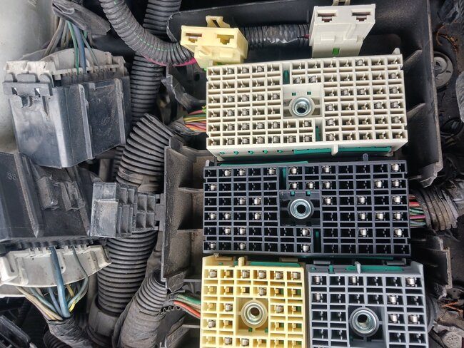

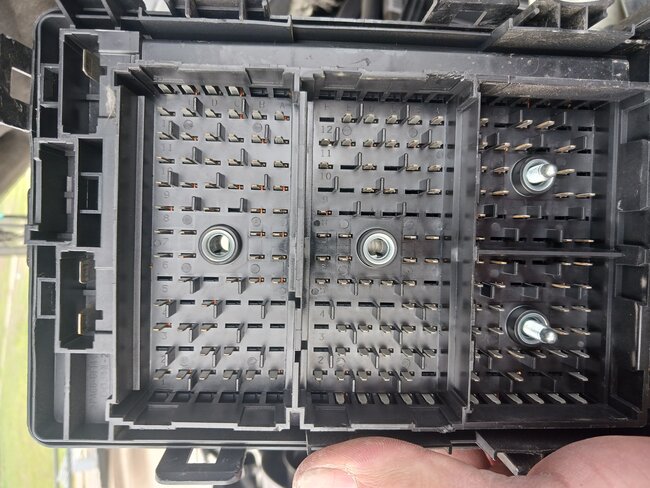

Good afternoon, to remove the fuse box I unscrew the three 7mm bolts and unsnap it correct?
Sunday, March 12th, 2023 AT 2:54 PM
ELEWIS84
  • 24 POSTS
Here are the pics of what I came up with. I really appreciate all your help
Sunday, March 12th, 2023 AT 3:19 PM
  • 109,872 POSTS
It's hard to tell in the pics. Do you see any evidence of corrosion? Also, is the wiring in good condition?
Sunday, March 12th, 2023 AT 6:27 PM
ELEWIS84
  • 24 POSTS
I don't see any corrosion. I will peel the wire loom back tomorrow and check the wires.
Sunday, March 12th, 2023 AT 6:33 PM
  • 109,872 POSTS

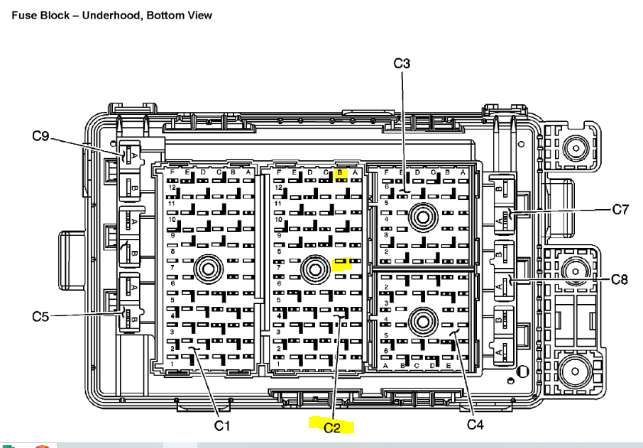

If the connector pins are good, I need you to check the power to the connector wire on both sides of the connection to see if there is a drop in voltage or if there is low voltage going to it.
Sunday, March 12th, 2023 AT 7:43 PM
ELEWIS84
  • 24 POSTS

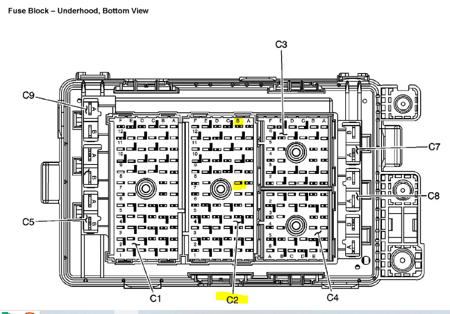

Would you mind sending me a diagram of which pin(s) to check?
Sunday, March 12th, 2023 AT 8:06 PM

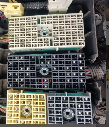

  • 109,872 POSTS
I attached the connector pin info below. You are looking for connector 2, pin B6.
Take a look at what I attached and let me know if it helps.
See pics below. Make sure to check the box where that pin connects. It should be easy since it is near the bolt hole.
