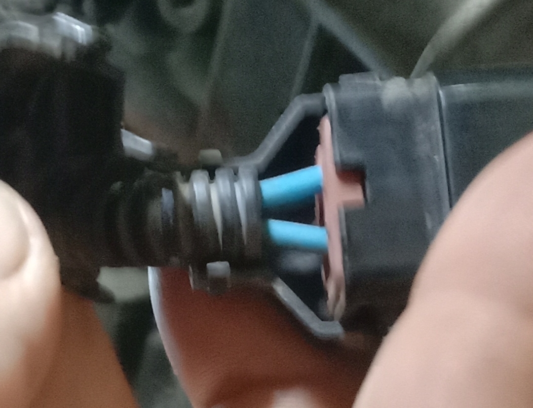

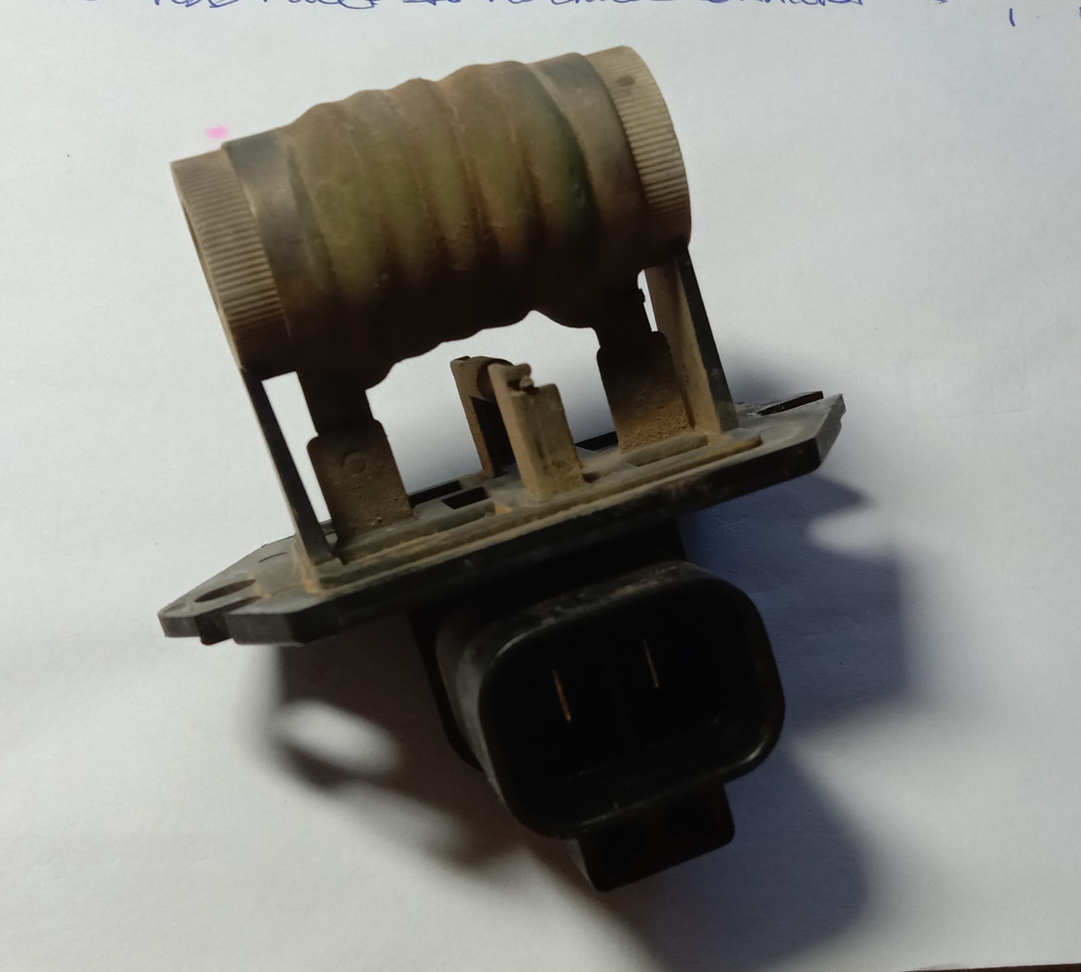

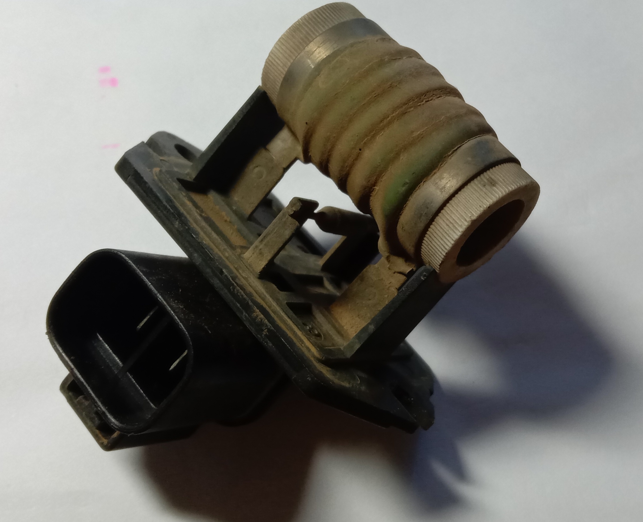

I attached pics of the radiator resistor connector just for FYI, both wires have the same light blue color.
There was no voltage between the 2 terminals. There was no voltage from the terminals to ground either.
Between the terminals I did see 0.002v but no more.
My chart shows the voltage readings at the Temp Sensor connector. I followed your instructions exactly.
I have stared at all of our results for hours and cannot conclude what the problem is.

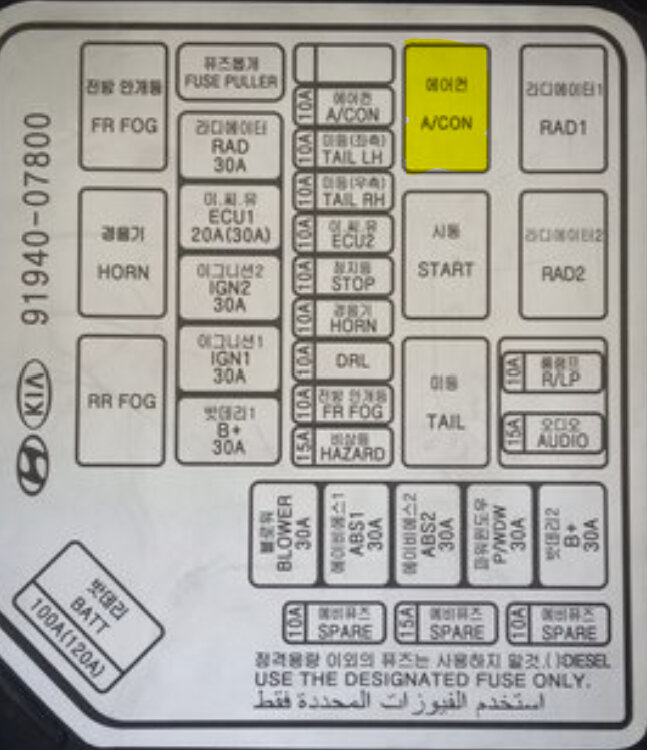

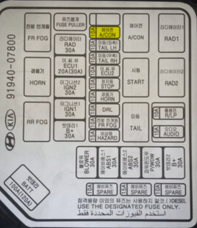

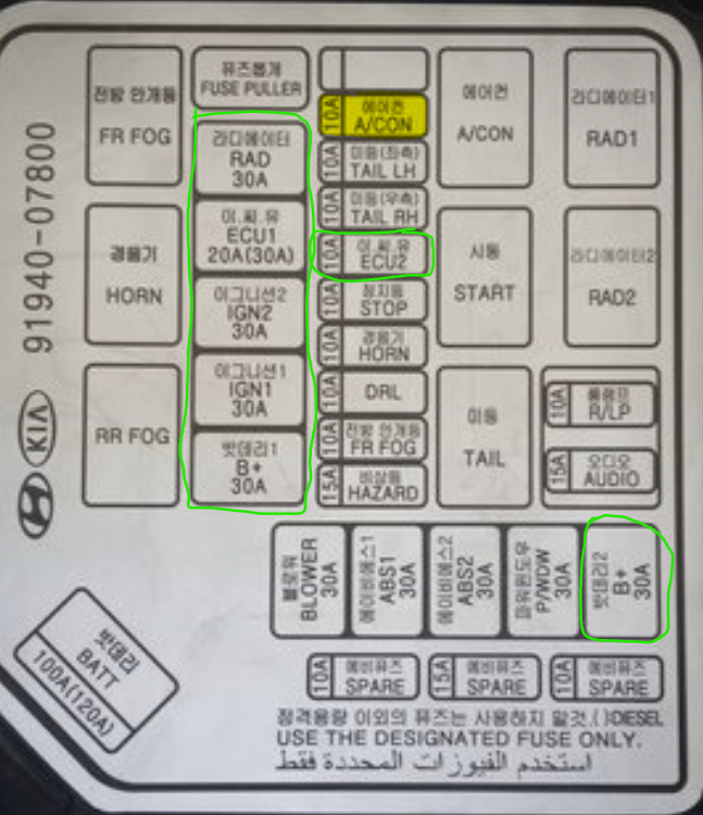

Next, there is a fuse, 10 amp, red. I have highlighted it on your fuse panel diagram you sent me. Check this fuse with the key on and see if you have 12 volts on both sides of this fuse. (see image)
One of those light blue wires might be going to the A/C relay, Rad1 or Rad2, next to this fuse we just tested. I have added the diagram again, this time highlighting the relay. (see image)

Could you please send me a picture or 2 of the resistor uninstalled as well?
Here is a video of some tests you can do on the resistor itself, removed from the vehicle.
https://youtu.be/LUNvzyvn8J8
(You might want to mute it the music in it is very loud)
If the resistor is bad there will be a spot where you get no reading. Let me know what you find.

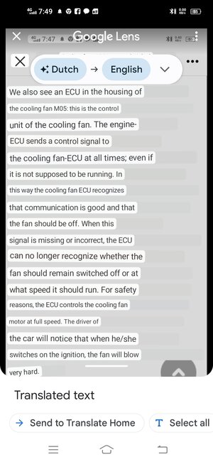

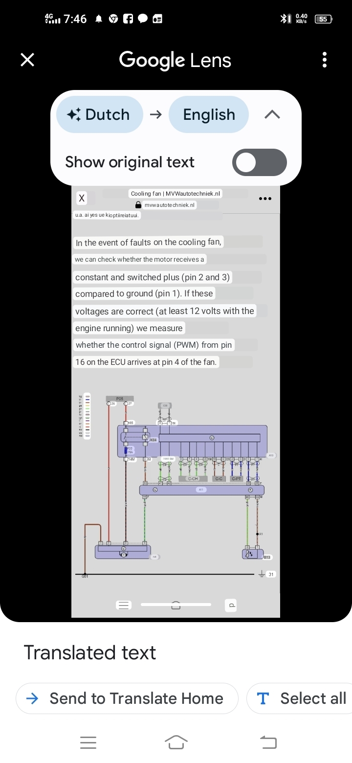

Through different contacts I have been sent some info about cooling circuit wiring for a Kia Picanto. It is a multi-page doc and all written Dutch.
I have copied the page with a wiring diagram and have google translate the text. The page with text only is the paragraph immediately following the diagram. I hope this will help.
The Air-conditioner does not work. The fan inside the car is okay, but it does not blow cold. I don't use the car a lot and I did not realize the cooling fans were not working but the A/C may well have stopped working about the same time as the cooling fan problem occurred, the timing is similar.
Thank you for the additional info, I will work on it today as long as the rain holds off.

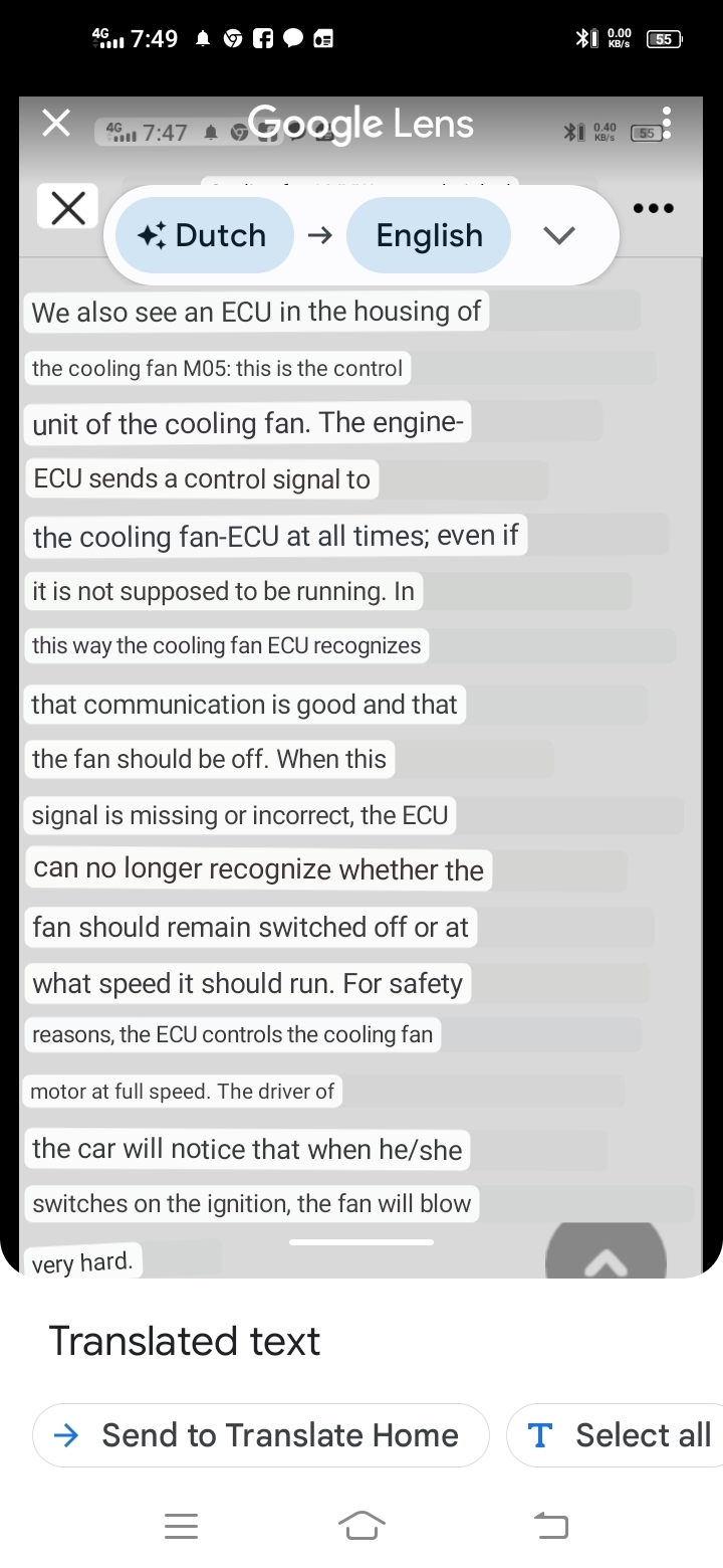

LESLIE PAYNE
  • 42 POSTS
Hi Brandon.
This the diagram that I wanted to send from the Dutch guy, I attached the wrong one.
The other one was sent to me also but probably not as useful.

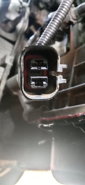

1, Fan connector. Pic attached.
Ign off, a/c off.0.0v
Ign on, a/c off.0.0v
Ign on, a/c on.0.0v

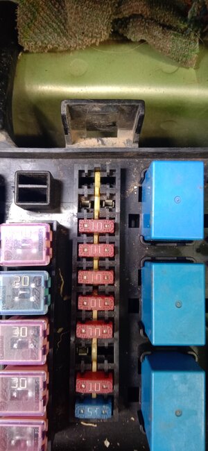

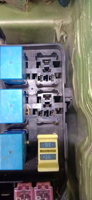

2, 10A Fuse (beside relay)
Ign off. 0.0v Both terminals
Ign on. 0.0v. Both terminals

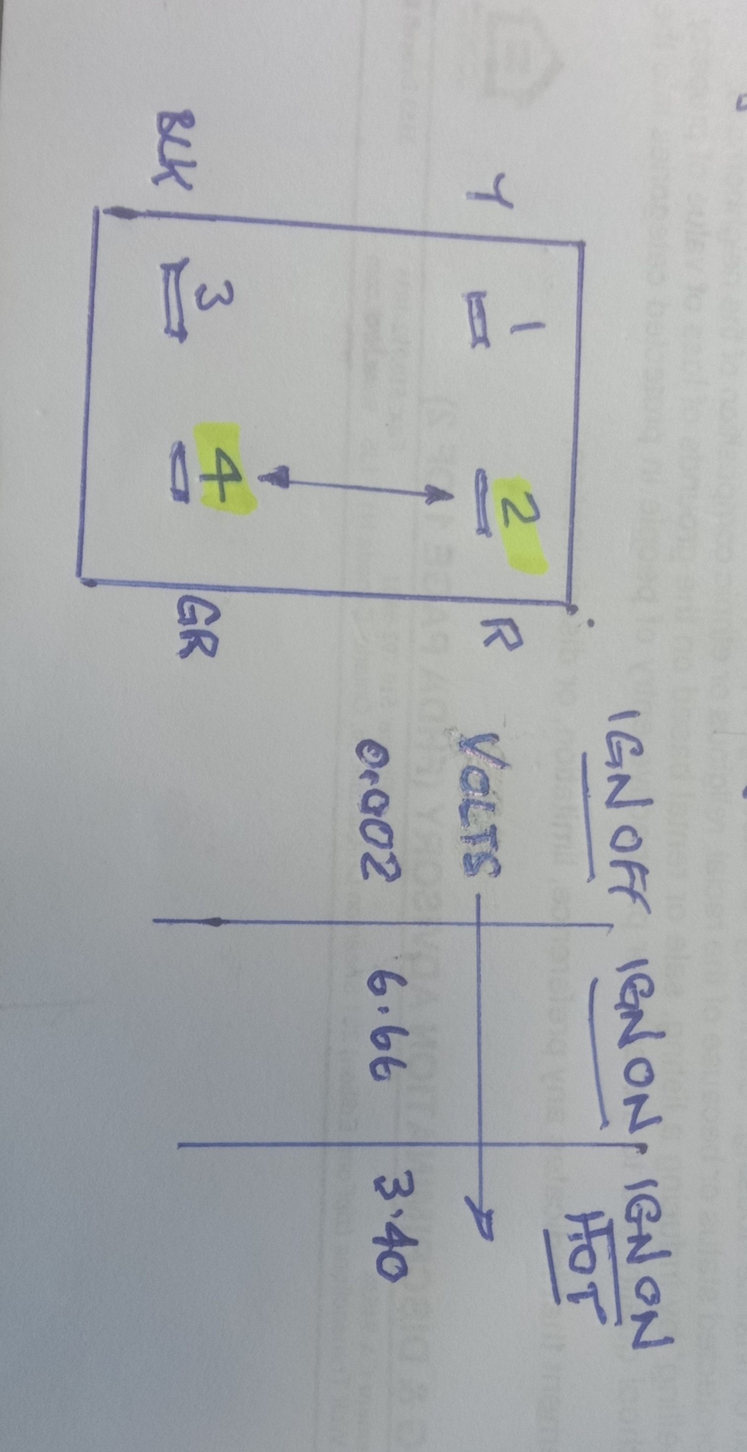

3, I have attached a picture of the relay terminal and a sketch of the voltage readings.
For simplicity I have numbered each location consecutively.
4, Resistor pic attached.
Your additional comment I did not understand, I have nowhere to read points of resistance along it's length, it has a coating.

6, Jumper the resistor connector.
Nothing I did would make the fan run with a jumper across the 2 connector terminals.
The relays and 10amp fuse were in place. The temp sensor was not in the engine block but it has a ground wire attached to battery negative.
Ign on, heated sensor, A/c on or off, all failed.

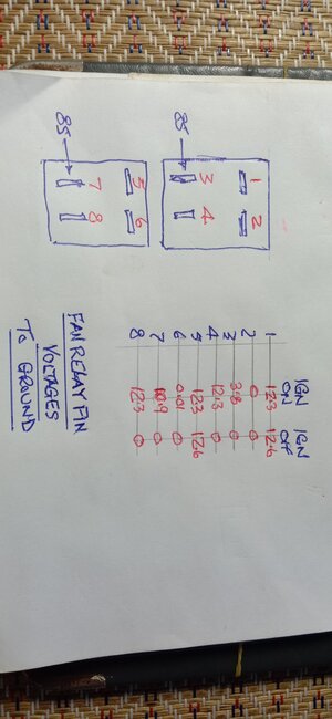

7, Resistance of terminal 85 Fan Relays to Fan connector terminals.
Neither of the Fan Relays terminal 85 measured any resistance to the fan connector. The meter remained on "1".
A/C on or off was the same reading.

Forgot to include the chart of Fan Relay Voltages.

1) Can you remove the A/C relay next to the fuse. Just check for voltage and see if you got power to that.
We are looking for 12 volts on 87 again and key on 12 volts on 30, same as the 2 fan relays. No Ohm's, just voltage.
2) If the fan relays and the A/CON relay are the same, try switching them. Look at the side and make sure amperage is the same and part number is the same.
If so, try switching them around and see if anything happens. Make sure they are exactly the same though if not, do not switch them around.
If you are unsure, you can send me images of all 3 of them and I will be able to tell if they are or not.
3) If you could test this relay just like we did with the others. Here is the link to the test again for you:
3) Something is turning off power to that fuse and it might be affecting the whole cooling fan circuit.
But let see what you have for readings and see if we can figure out why that fuse has no power.
4) I would check all the other fuses in that panel and any others to make sure nothing else is missing power. They shouldn't be, but let's check and see just in case.

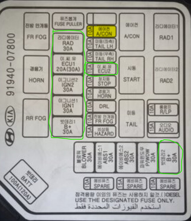

5) I have circled some fuses in green. Please check these fuses. For the square ones with the clear top, even if they don't appear burnt out. Remove them and test with your meter on resistance.
I would disconnect the battery so when you go to remove or put back in it doesn't pop one of them, just so you don't get stuck with a burnt fuse and no way to go out and get it. Also so we don't cause any surges in electricity.
I have re-added the diagram of your fuse box and circled in green the additional ones to check.
Right now, we got to figure out why that fuse has zero power.

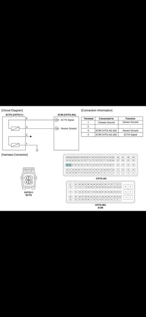

I read one comment online that a Kia owners wiring fault was traced back to poor ground on the ECM.
A Korean car owner/mechanic told me that it is common on Korean built machinery to use 4 pin cooling sensors with 2 pins having 12v because the sensor has an expansive wax driving a high amp contact which can operate the Aircon directly.

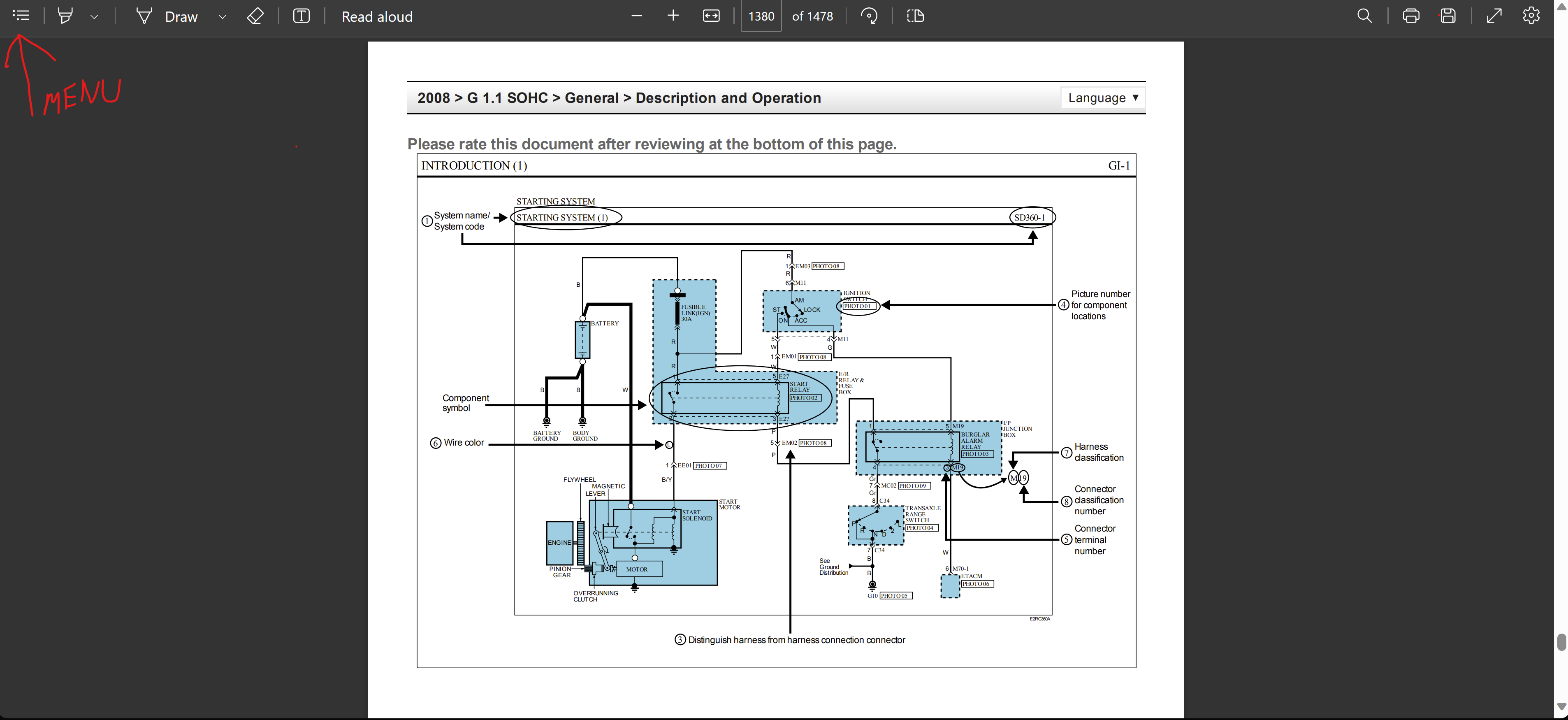

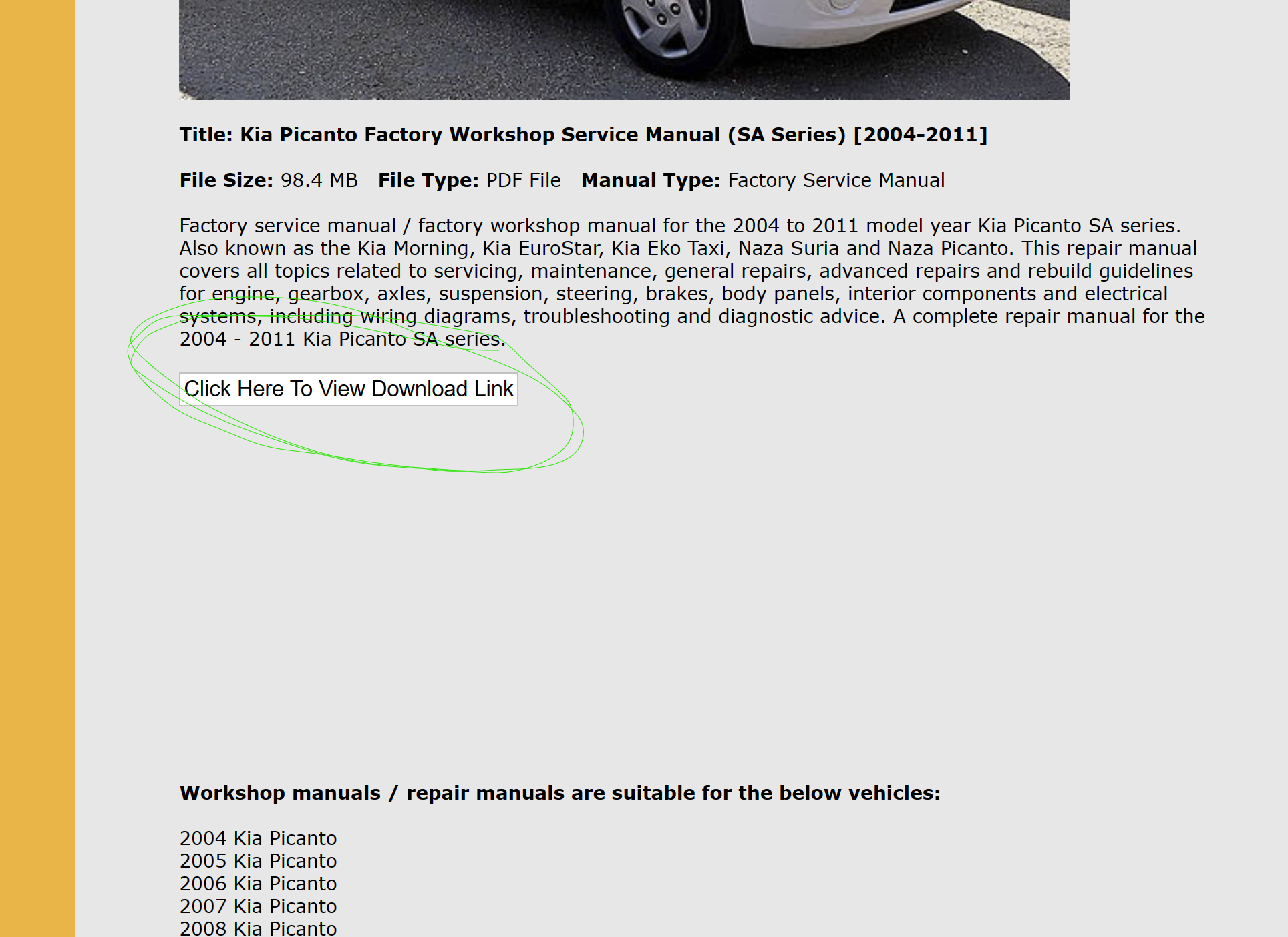

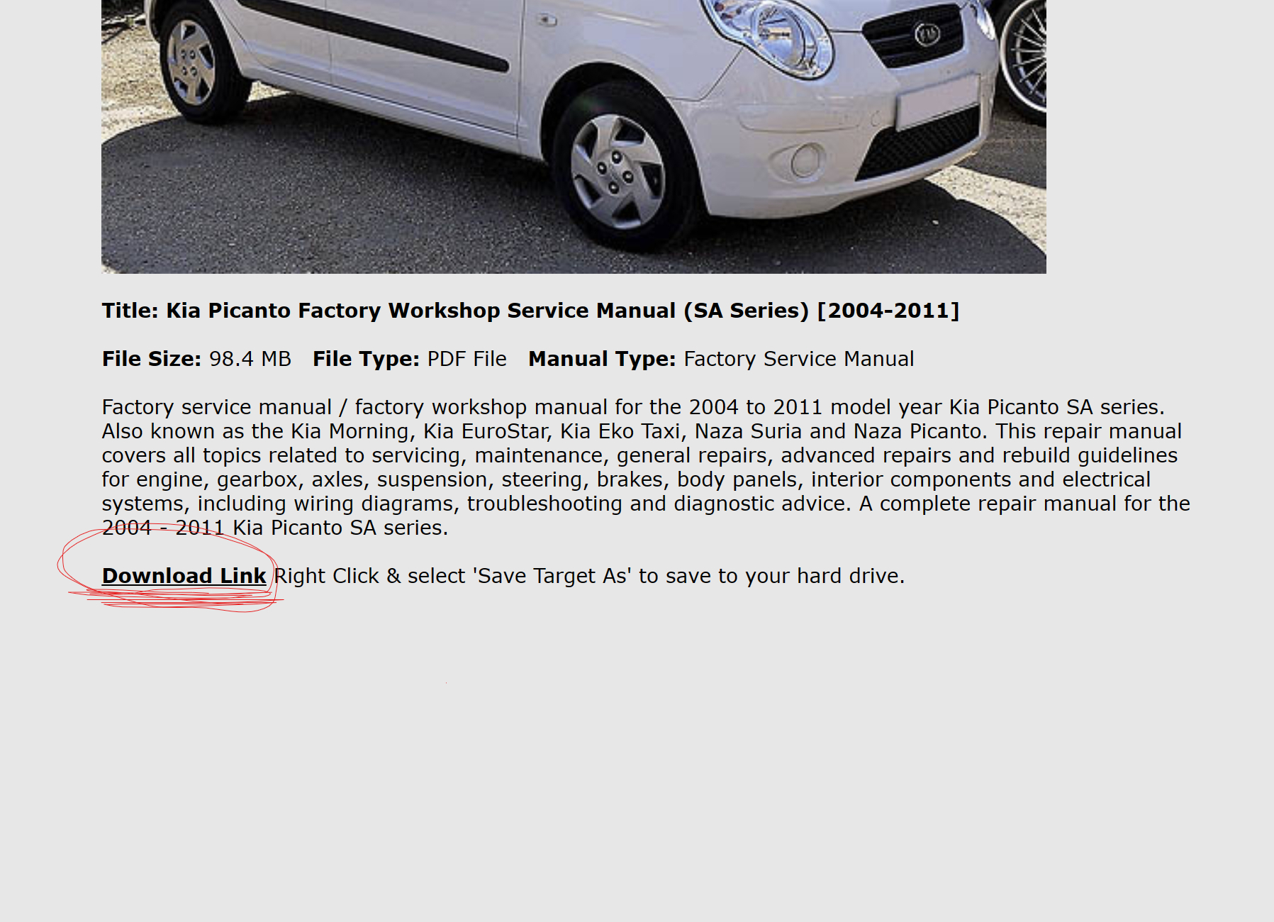

That link I sent you should take you right to the online downloadable PDF file. I was able to use on my computer.
You will need to click on the part that says, "Click here to view download link" (see image in green).
This will refresh the page and you will see "Download Link". Please right click on this link (see image in red) and click "Save As".
Just save it to your desktop for now.
Then open and view the PDF. You should have around 1478 pages of information on your vehicle.
I have it on my computer, and it works fine.
Unfortunately, because your vehicle was never sold nor produced in the U.S, getting information is near impossible. Steve took his own time to get this for you. It may not be everything you are looking for, but it is certainly a lot more than we had. I myself am very thankful.
The wiring diagrams start at page 1380. There may be a collapsible menu in your PDF viewer. Mines has one and it gives me a table of contents.
I have also added a screenshot from my side showing my PDF viewer. I am running Windows 11 though so yours may be a little different if you are using MAC or an earlier version of windows.
Take a look at my images and see if there is anything missing. I would prefer to help you get access on your end rather than have to screen shot everything to you, so you have the entire manual whenever you need it.
Please let me know if you are able to download.

Also thank you for the information on the 4-wire temp sensor. I really appreciate you sharing that. Something I have never come across.
I think a bad PCM ground is a possibility, but the issue might be more localized to a specific connector.
I think taking a look at power and ground for the PCM is a good idea. Since you are having cooling fan issues and shifting issues, it is possible they are related.
Let me take a look at these diagrams and see if I can find out where the ground is located for it. I also want to look and see if the fans are in the same connector as the transmission at the PCM.

Hi Brendon,
It took 4 attempts to download the 5he manual before I got the correct one. I kept getting the Basic one or a request for payment. Was doing something wrong but got there in the end.
The manual appears to be for a 2008 Picanto.
Page 36 and 39 shows the problem I have been having with the Trans Speed Sensor. Page 39 is my sensor; page 36 is the sensor the dealership says I should have. You will note that both refer to the identical G1.1 SOHC Repair.
The Reference to the Cooling Sensor also shows a 2 pin (not my 4 pin) for testing.
Been trying to understand the Power Dist Diag's. Page 1455, why at the Ac and 2 Fan relays are there no wires connecting to something? They are shown again on 1452 going to the Passenger Fuse box (in the engine bay on my car) so I am having difficulty tracing to.
Page 1478 shows 7 wires coming together at the black dot. What is the representing?
