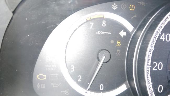

I just acquired a used 2014 Honda Accord LX model.
The TPMS, VSA AND EPS check lights come on and stay on after i start the car (They stay on when driving).
Whatever is responsible for these check lights totally elude me, although is suspect the steering may not be properly aligned.
This is because when reversing the grid lines showing on the screen is curved to the left when the wheels and steering are straight but straighten as i turn the steering to the right.
Your input will be most appreciated.

You need to retrieve the trouble code to find out what could possibly be the cause. Record the codes and clear them and see what comes back when engine is started. Recheck the codes again if the lights comes back.
