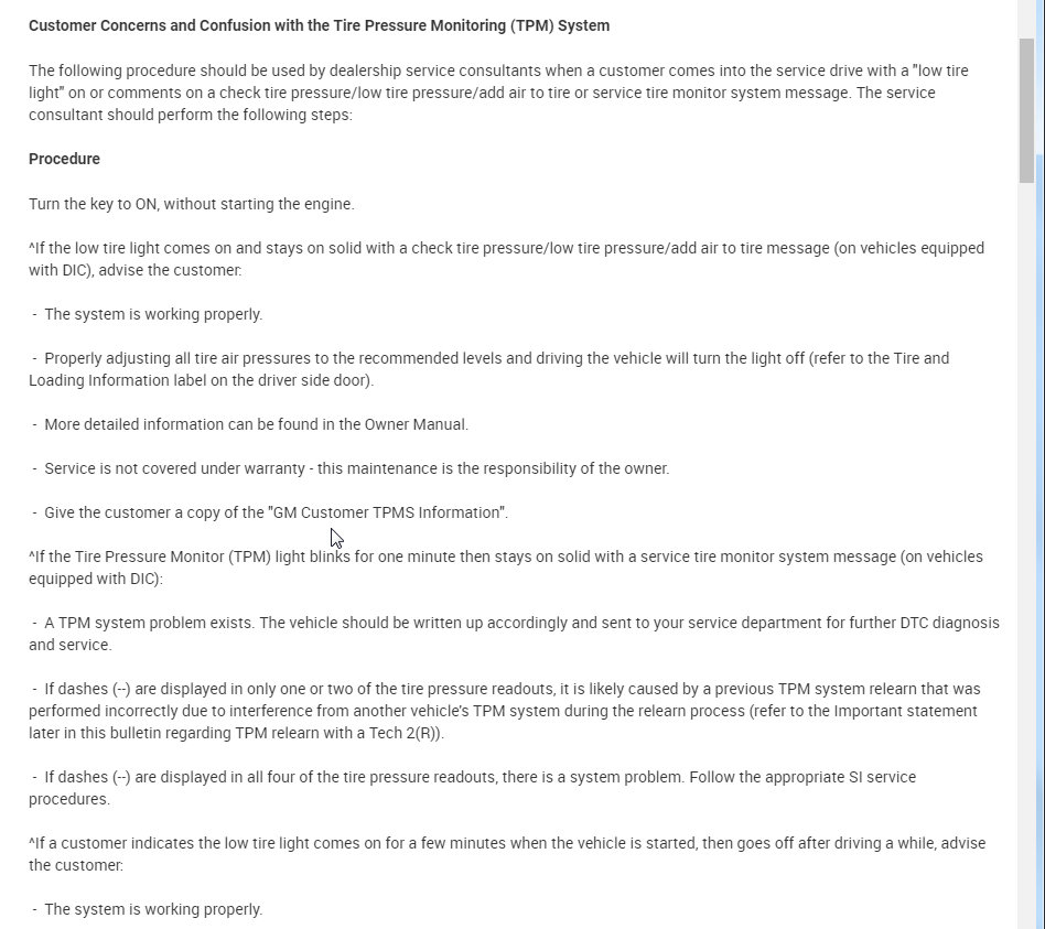

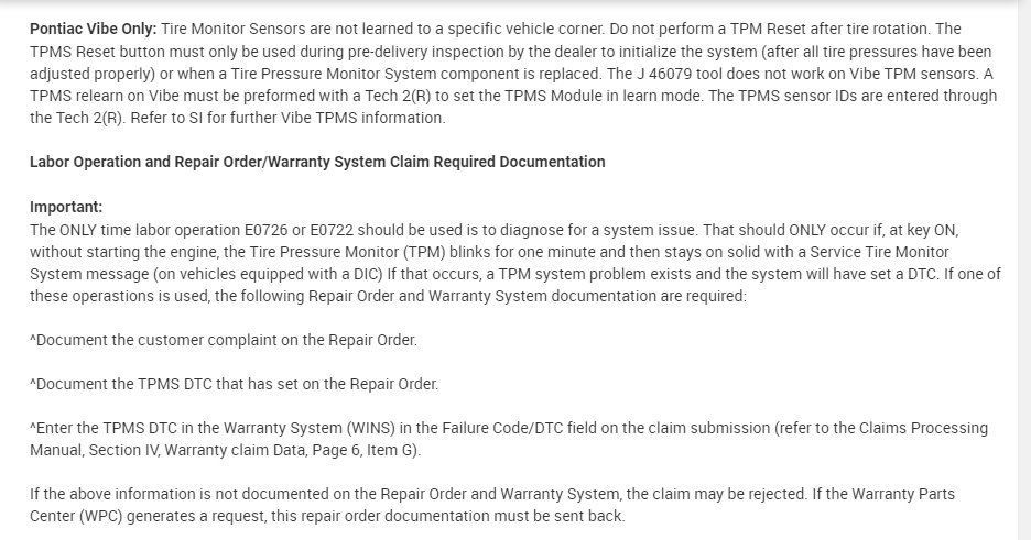

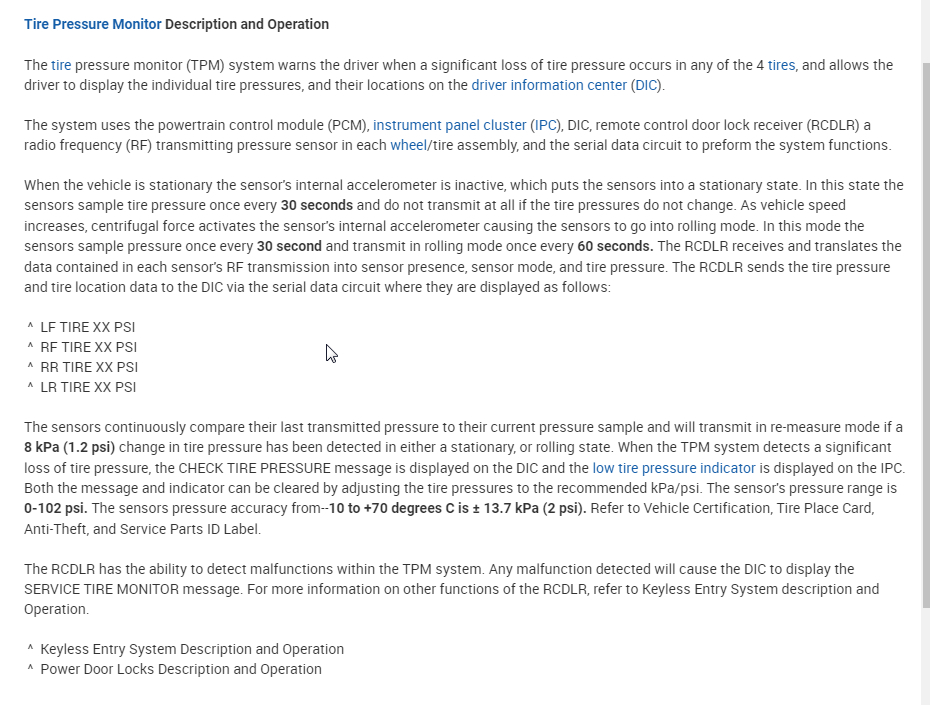

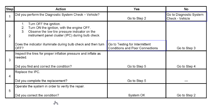

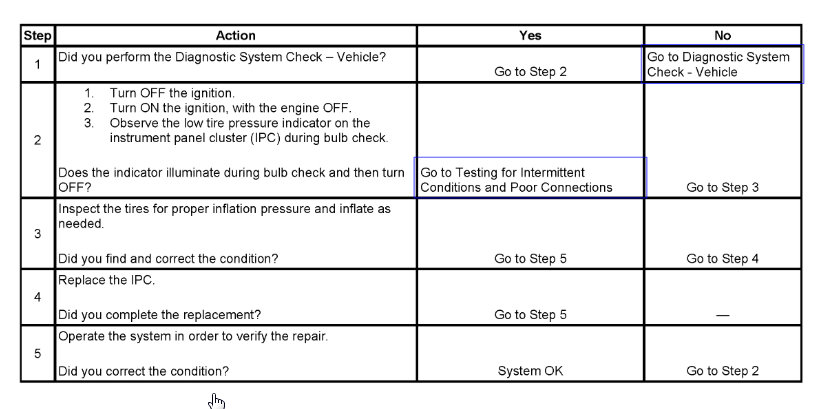

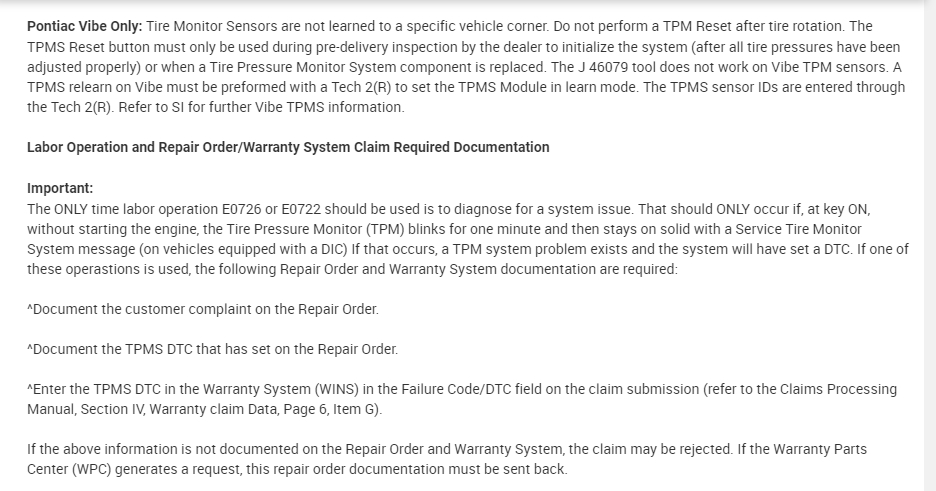

Yes. Most likely this is the module. I attached the process. However, you need to run through the test I attached and see if the cluster is the issue. I doubt it is but just make sure this is ok as it is an easy test.
More than likely the module is just not picking up the signal from one of the sensors and it is turning this warning on.
Let us know what you find and we can go from there. Thanks

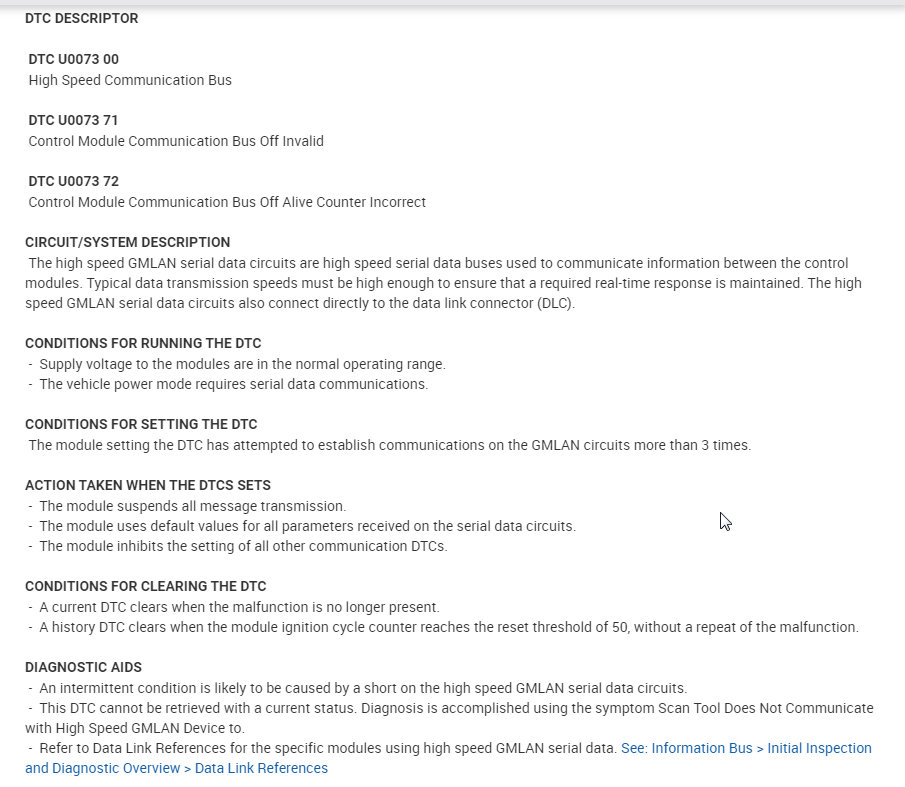

Sorry for the delay, lots going on. During diagnostics I found two codes. No check engine light but 2 codes were present. U073 Control module bus "A" off and P0700 Transmission Control system. I am trying to determine the relationships.
Dec 31, 2019 at 8:50 AM
This depends on a number of things and could be related to each other. However, the transmission control code is not related to the TPMS issue.
If both codes were set at the same time then neither of them could be related to the TPMS issue.
It is very common for general bus issues to cause issues in the TPMS because this operates on an RF signal and are sensitive to bus interruptions.
Do you know which module set the U0073? That will tell us if there is something else going on or not.

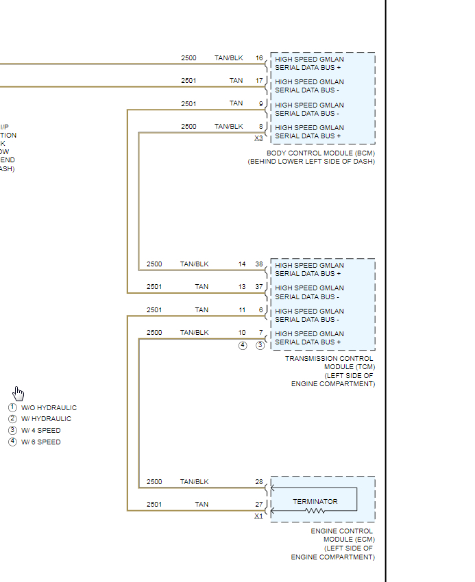

I understand that but I also know that if bus "A" is shut down it interferes with the TPMS receiver delivering its response to the BCM. At least that's what I understood. I could be wrong but there is only 2 bus communication between all modules and the BCM and they are all in parallel so a break in the chain shuts down the communication. I'm still trying to figure out if the TCM is faulty or just needs re-flashed. I'm leaning towards re-flash as from what I understand 99% of the time that's all it is.
Jan 2, 2020 at 11:34 AM

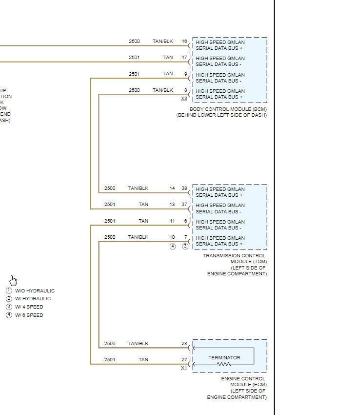

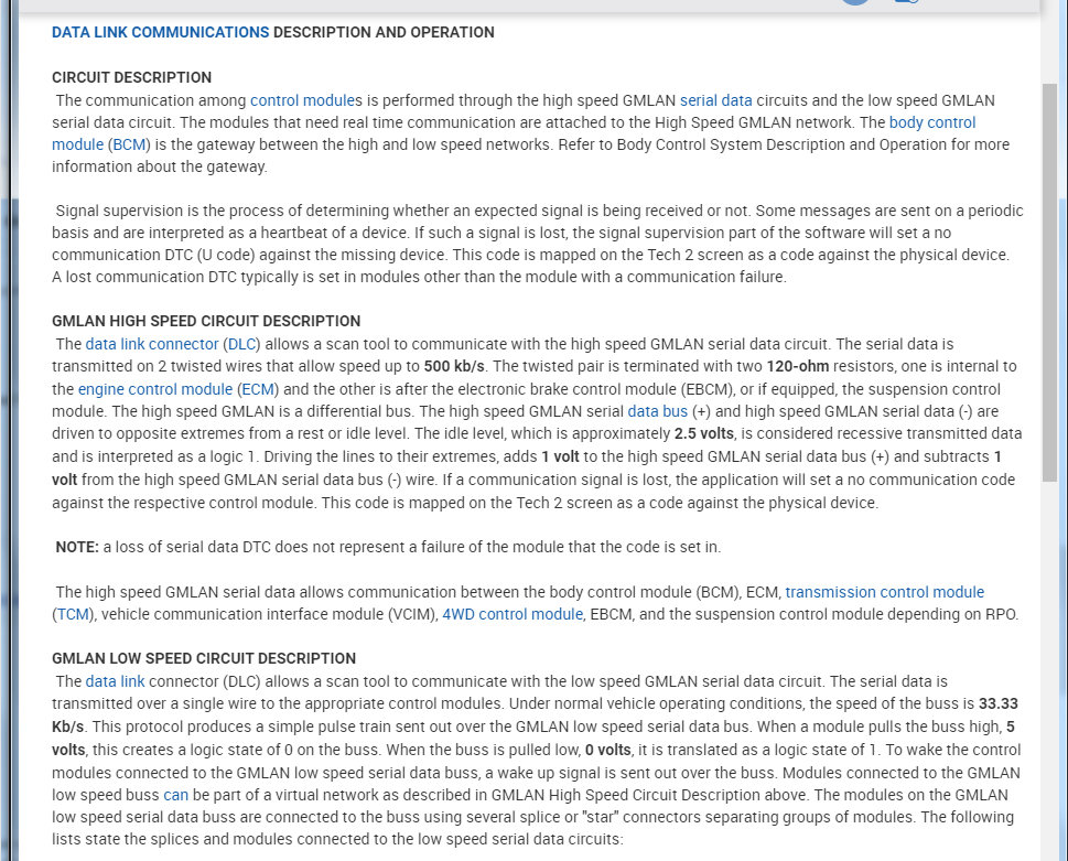

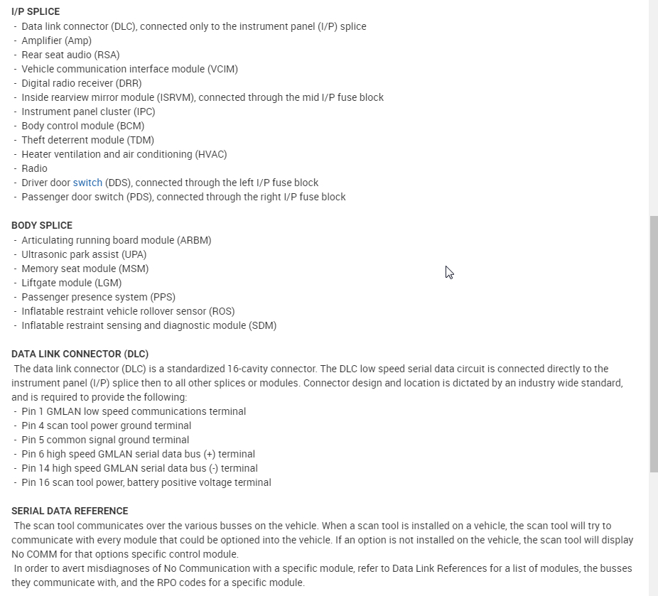

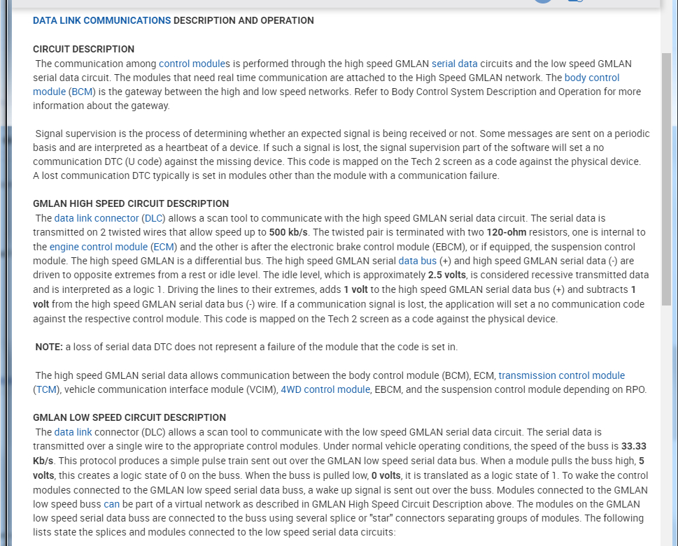

Okay. You are partly correct. You have two types of bus networks on this vehicle. A high speed bus and a low speed bus. The High speed is used for the modules to communicate with each other and when one of them like the TCM is offline the BCM will set a U code against that module like you have. However, the difference is if the TCM were offline all the time, you would have a lot of codes and the performance of the vehicle would be effected. This means that the TCM had an issue at some point and it set these bus off performance codes but it is not active currently. That means there is no real way to diagnose that code because the issue is not currently there.
One way to test this is to go to the TCM or BCM and check for proper bus voltage. If you get on any of the bus wires, you should have about 2.5volts. Basically the + and - bus wires need to add up to 5 volts so if one is 2.7 volts the other should be 2.3 volts when measured with a multi-meter. The bus off performance code happens when one leg of this network get pulled high or low and the total voltage no longer equals 5 volts. For example the + is 3.5v and the - is normal at 2.3 v.
All this to say, the TPMS light is currently on correct? If that is the case then you have an issue with that system but unless these bus codes are currently active they are unlikely the cause of the TPMS light.
Also, as for the replacement or re-flash of the TCM, that may work if the TCM is in fact the issue. At this point, based on experience I don't see enough to say the TCM will fix these codes or turn off the TPMS light.
What I would suggest is measuring the bus voltage and going from there. If the bus is off then the TPMS is the most sensitive module. So if we can get a little more evidence then we would have more to go on and replacing the TCM won't be so much of a guess.

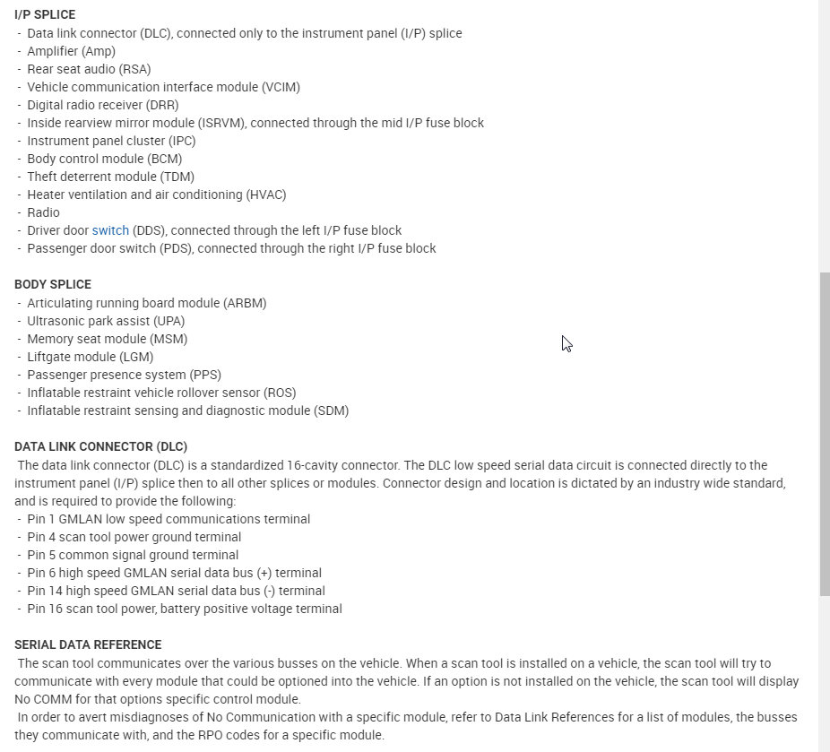

Okay, that makes more sense. Where do you suggest that I test the bus voltage at. I think it would probably be easier at the BCM but I would like your input.
Jan 3, 2020 at 11:15 AM
KCCOMPUTERS
  • 14 POSTS
To add to this. I cleared those codes when I ran the diagnostics. I wanted to see if they would reset. I will run diagnostics again tomorrow and see if they are back and will let you know what I find.
Jan 3, 2020 at 11:17 AM
Okay. That is a good idea. If they return then that means that the issues is continuing to happen but with a bus issue it may only be a momentary issue. So by the time you test it, the issue is no longer there.
As for testing the bus voltage, it doesn't matter. It is the same anywhere you test it. Think of it like a closed circuit television. No matter where you view the TV it is the same picture if you are on that closed circuit.

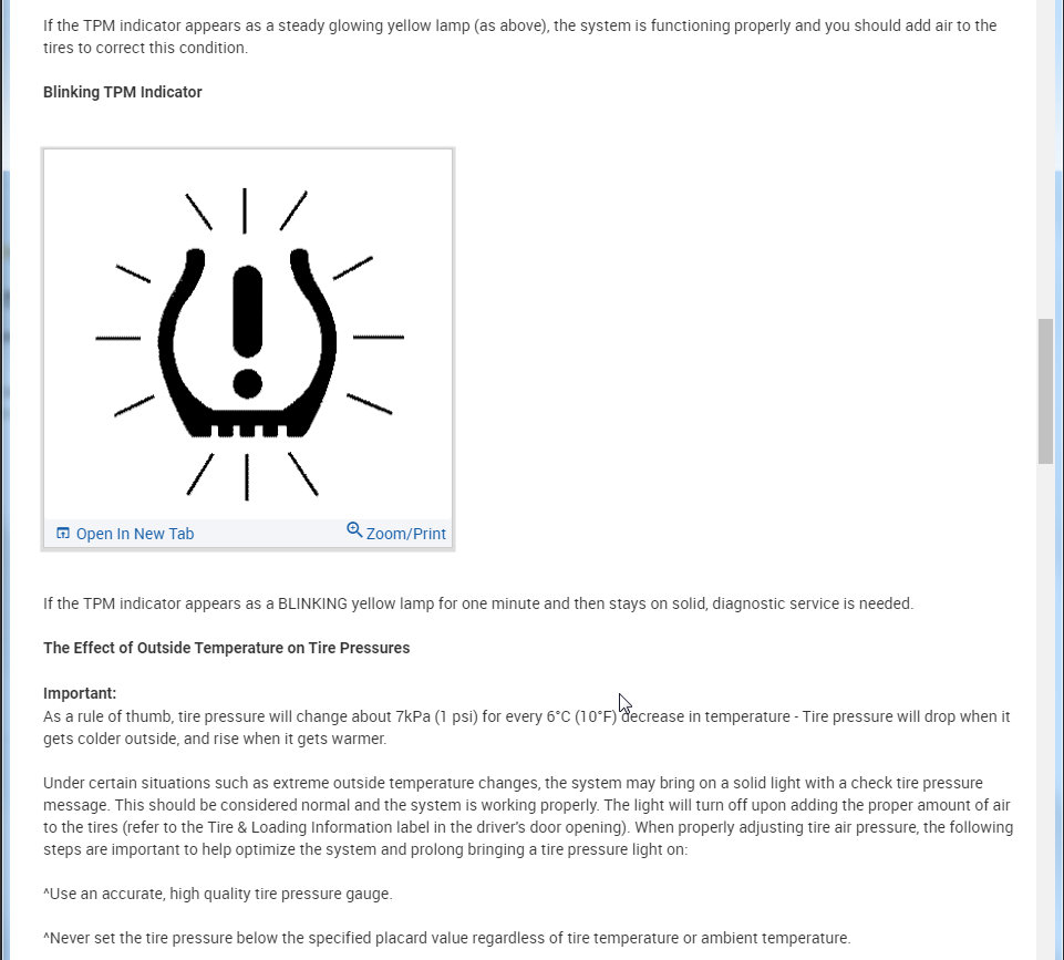

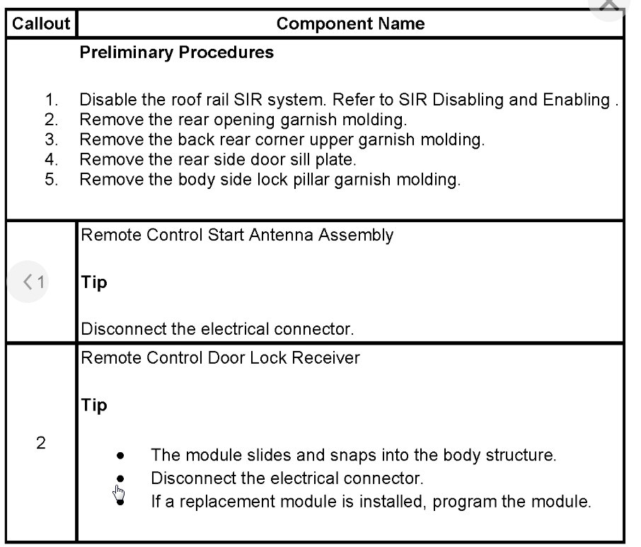

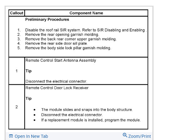

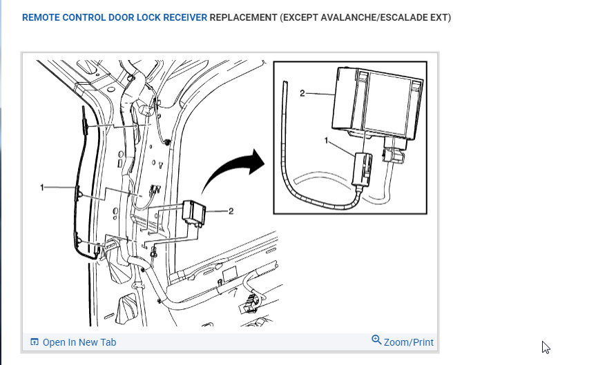

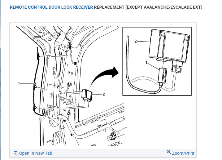

Based on the fact that the light is on and you are getting a message in the message center you have a malfunction in the TPM system. Since the sensors are all new, we can assume it is the remote control door lock receiver module as this is what the BCM uses to pick up the RF signal from the sensors and transmits them to the BCM who shares it with the cluster.
The proper way to diagnose this is using a scan tool but if it were me, I would just replace it and then relearn the module and then all the sensors. Unfortunately you will need to program this module using a scan tool but any shop that has one capable can do that pretty easily.

Okay here is the update: I replaced the RF module, then took it to the dealer to have it flashed which could not be accomplished as it turned out the BCM was faulty. So $700.00 later I had a new BCM installed, flashed and the RF module also flashed so remotes would work and TPMS sensors would supposedly be picked up. Then it turns out that the new TPMS sensors that I had purchased from Amazon apparently had dead batteries so I had to order 4 new sensors. I had those 4 new sensors installed and now my TPMS sensors actually get picked up when performing the re-learn process but alas its not all good, because as soon as you turn the key off the TPMS sensors are all forgotten and must be re-learned again to read tire pressures. So now that I have spent well over $1,000.00 trying to fix this issue and still have not fixed it. Where do I go from here?

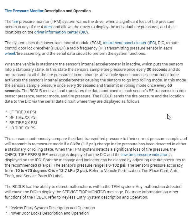

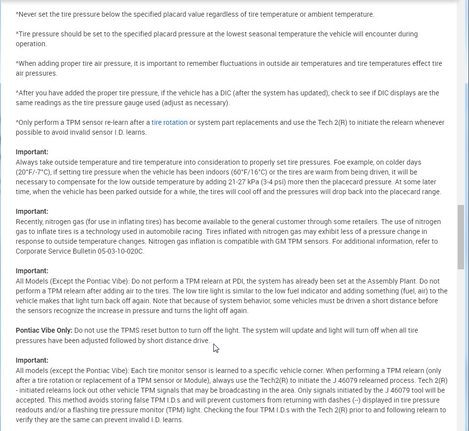

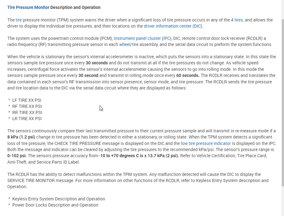

There is a specific procedure that must be performed to have the CAN work with the sensors.

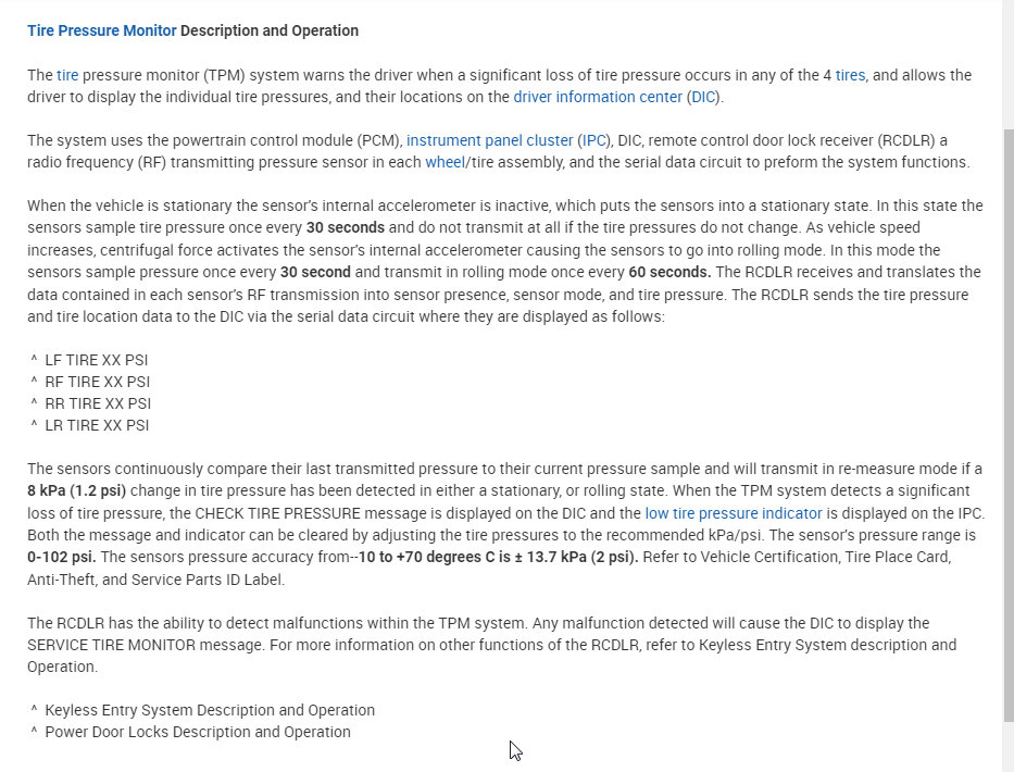

Tire Pressure Indicator Sensor Learn
Special Tools
- EL-46079/J-46079 Tire Pressure Monitor Diagnostic Tool
Learn Mode Description

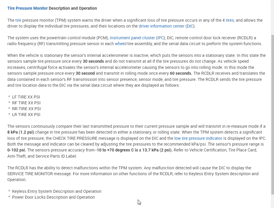

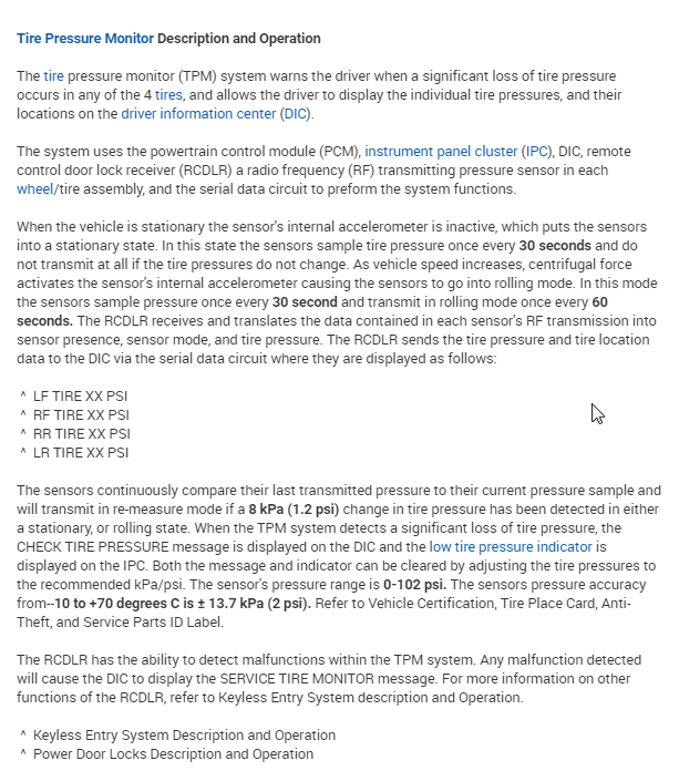

The tire pressure monitor (TPM) system uses the instrument panel cluster (IPC), body control module (BCM), remote control door lock receiver (RCDLR), keyless entry transmitter, 4 radio frequency transmitting pressure sensors, and the serial data circuit to perform the TPM learn mode functions. The sensor learn procedure must be performed after every tire rotation, RCDLR replacement, or sensor replacement. Once the learn mode has been enabled, each of the sensors unique identification codes can be learned into the RCDLR memory. When a sensor ID has been learned, the RCDLR sends a serial data message to the BCM to sound a horn chirp. This verifies the sensor has transmitted its ID and the RCDLR has received and learned it. The RCDLR must learn the sensor IDs in the proper sequence to determine correct sensor location. The first learned ID is assigned to the left front location, the second to right front, the third to right rear and the fourth to left rear. The turn signals will individually illuminate indicating which location is to be learned in the proper sequence.
Sensor Functions Using J-46079
Each sensor has an internal low frequency coil. When the EL-46079/J-46079 is used in activate mode, it produces a low frequency transmission that activates the sensor. The sensor responds to a low frequency activation by transmitting in learn mode. When the RCDLR receives a learn mode transmission while in TPM learn mode, it will assign that sensors ID to the location on the vehicle relative to the order in which it was learned.
Sensor Functions Using Pressure Increase/Decrease Method
Each sensor takes a pressure measurement sample once every 30 seconds while in stationary mode. If the tire pressure increases, or decreases by more than 8.3 kPa (1.2 psi) from the last pressure measurement, another measurement will occur immediately to verify the change in pressure. If a pressure change has indeed occurred, the sensor transmits in Learn mode. When the RCDLR receives a Learn mode transmission while in TPM learn mode, it will assign that sensor's ID to the location on the vehicle relative to the order in which it was learned.
Learn Mode Cancellation
The learn mode will cancel if the ignition is cycled to OFF or if more than 2 minutes has elapsed for any sensor that has not been learned. If the learn mode is cancelled before the first sensor is learned, the original sensor IDs will be maintained. If the learn mode is canceled after the first sensor is learned, the following will occur:
- All stored sensor IDs will be invalidated in the RCDLR memory.
- If equipped, the DIC will display dashes instead of tire pressures.
- DTC C0775 will be set.
These conditions will now require the learn procedure to be repeated for the system to function properly.

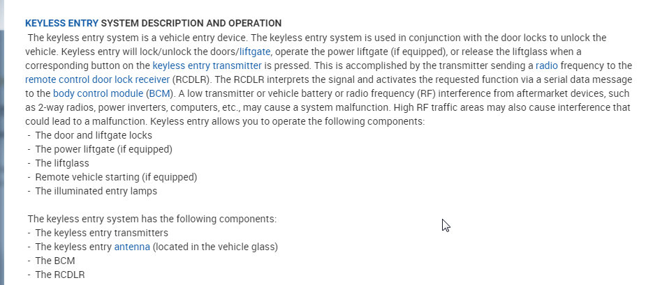

During the relearn process sometimes the horn beeps twice as the vehicle enters learn mode and then beeps twice as the first sensor flags and then beeps once on the next 2 sensors and then fails to flag the last sensor. And then sometimes it does exactly correctly and all 4 successfully learn and the service light still doesn't go out even though all 4 sensors are reporting correctly. But if you turn the key off and then back on it all goes away and all 4 sensors will have to be relearned. And now to add to the issue my traction control has a mind of it's own and it turns itself on and off randomly. I am assuming that the DIC is faulty or I have a nasty gremlin somewhere.
Feb 15, 2020 at 1:14 AM

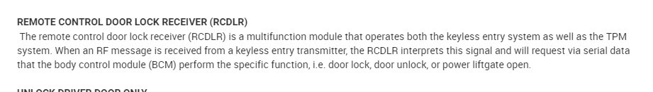

Okay. The fact that this is acting the way it is, you are correct that the DIC is the issue or there is a greater issue.
Keep in mind, the TPS is the most sensitive module on the vehicle and it requires communicating between the PCM, Cluster, RCDLR, DIC.
It communicates on this CAN network and if there is a interruption on this then something is not able to communicate. With this system being the most sensitive then it would explain the erratic action you are seeing.
However, it sounds like the RCDLR is sending out the signal to the DIC but this may not be broadcasting the signal on the BUS. So if it were me I would replace it and see what happens.

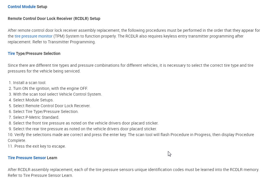

Okay. Here was the problem: The technician who flashed the new BCM and RCDLR forgot to program the tire size and pressure into the RCDLR and that was the reason that the new RCDLR would not retain the TPMS sensors after the relearn process. It was not the DIC and I did not have to replace the DIC. It is finally fixed, TPMS is working correctly now.
Feb 27, 2020 at 12:26 AM
  • 55,214 POSTS
Yep, it sounded like that could be the problem sometimes we assume people complete the work correctly but sometime we need to back track. Glad you could get it fixed, that kind of problem can be tough. Please use 2CarPros anytime we are here to help.
