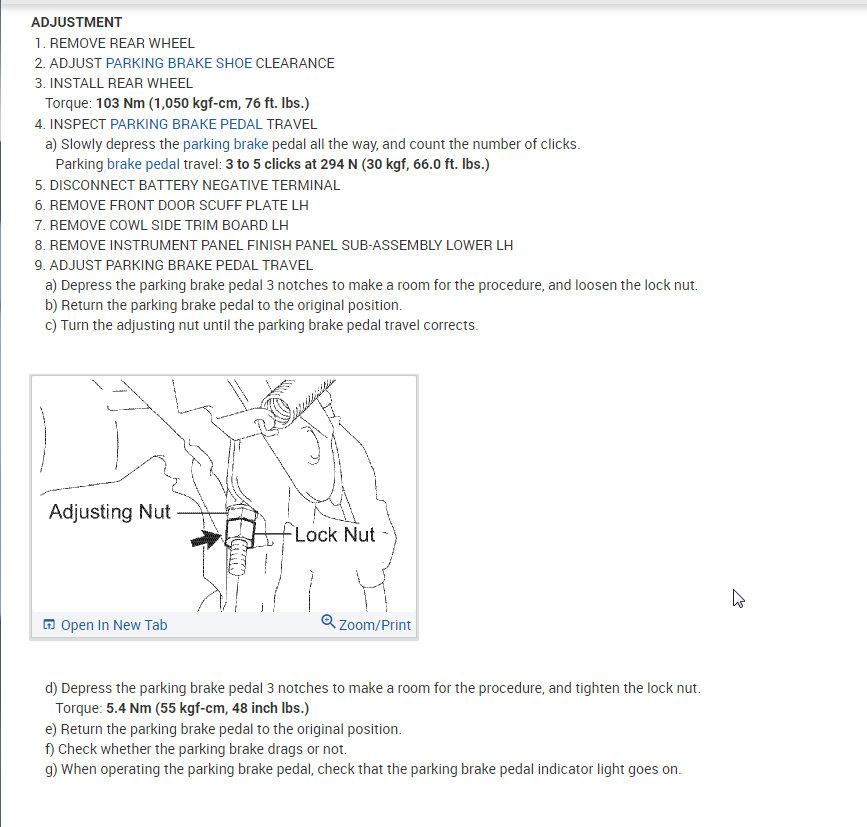

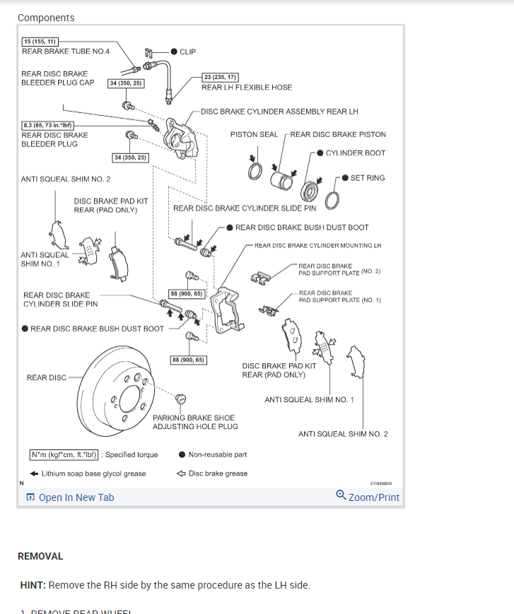

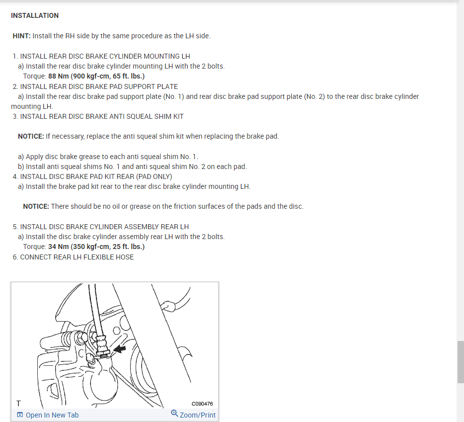

Sounds like if the vehicle rolling slightly on a grade then it is operating correctly. However, here is a guide on how to replace the rear pads and rotors in case you need this:
https://www.2carpros.com/articles/how-to-replace-rear-brake-pads-and-rotors
Also, based on what you are saying happened, it sounds like the parking brake is in needed of replacement or adjustment. Here is a guide that will help with this:
https://www.2carpros.com/articles/parking-brake-shoe-replacement

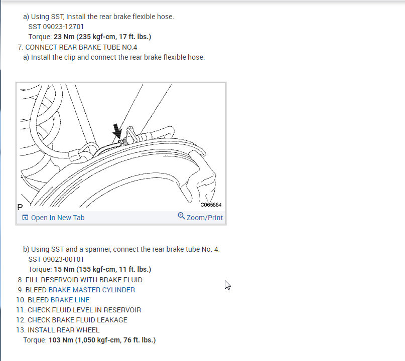

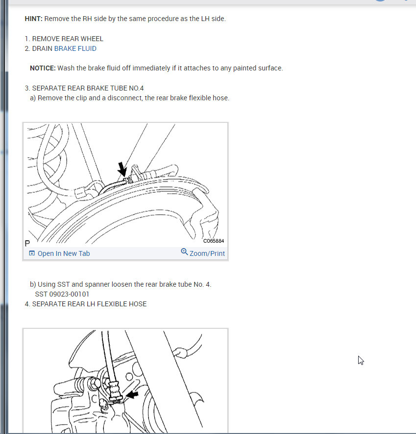

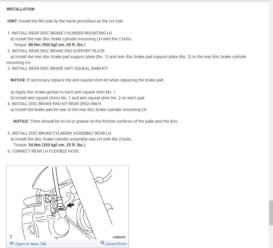

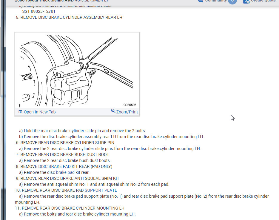

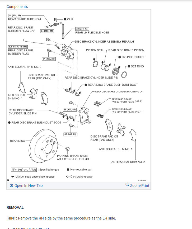

Lastly below you will find the process for all of this from the manual which should give you the info that you need. Please let us know if you have questions. Thanks
