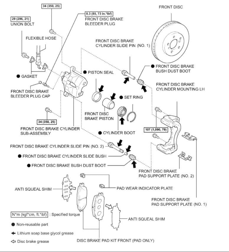

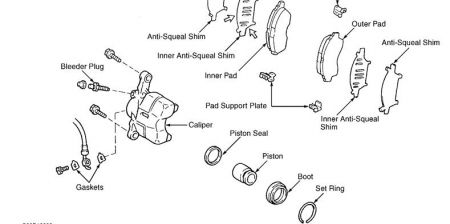

Hi there,
This is a very hard question to answer as this will depend on the brake pad hardness and the driving conditions, soft pads and city driving will eat pads quick, but country driving with hard pads will last a lot longer and fronts will wear faster than rears under normal conditions normally at a rate of 2 to 1 sets of pads. Here are instructions int he diagrams below to show you how on your car with a guide to help walk you through the steps.

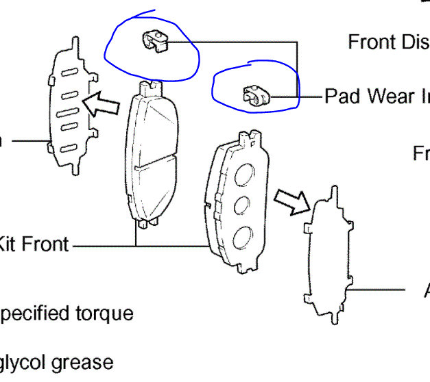

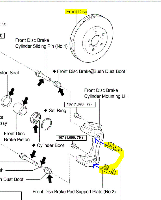

I just recently had my front brake pads replaced from the driver and passenger front tires only. The back tires are still good for another year.
The brakes and rotors needed replacing but in the process. I had ordered the wrong rotors so they had used only the brake pads for the front tires. To not waste time with ordering new orders, they took the rotors on the vehicle and I guess filed them down with a specific type grinding machine to perform the task.
Now, not all the time but every now and then, when applying the brakes I hear a hissing sound coming out of the front tires more from the driver's side I guess because I'm on the driver's seat. It may be from both sides but I can't tell.
What could be the problem.
Feb 11, 2021 at 9:50 AM (Merged)

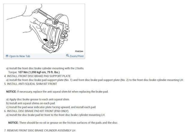

  • 110,194 POSTS
It sounds like they cut the rotors, which is a normal thing to do as long as the rotors are still within the manufacturer's specs. Often times, they just get replaced.
As far as a hissing sound, I have to ask what kind of brake pads were used. Some semi-metallic pads are known to make noise. Also, ceramic brakes can create a unique sound as well.
Are the brakes working properly? Also, I realize you mentioned that it only does is now and then. However, it is loud enough for you to record with your phone and upload for me to hear? As far as the sound, could it be described as a rubbing sound rather than a hissing? When I hear hissing, I think of an engine vacuum leak.
Let me know. Also, if you look at the two pics below, I highlighted the rotor and brake hardware in pic 1. The hardware (with arrows pointing where they go) can be bent or not properly installed, so check them. Also, make sure the rotor is smooth and there is no evidence of something cutting grooves into them.
Pic 2 shows the brake wear indicator. They are designed to touch the rotor to warn you when the pads wear out. If they are bent or loose, that could also be an issue.

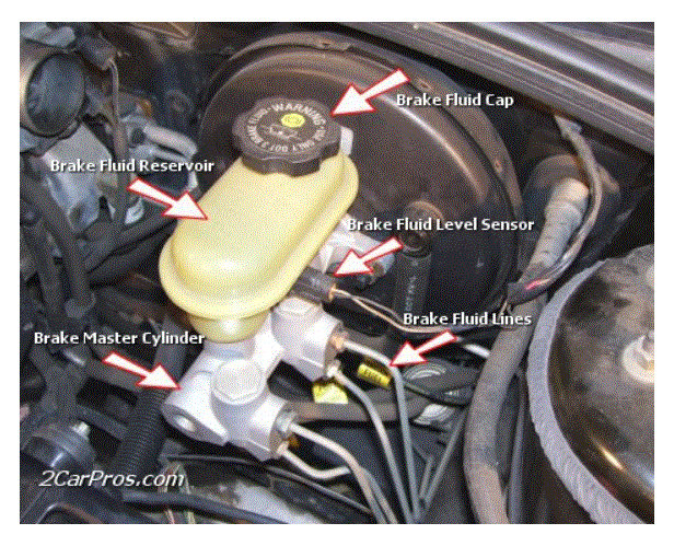

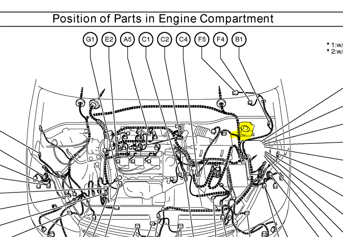

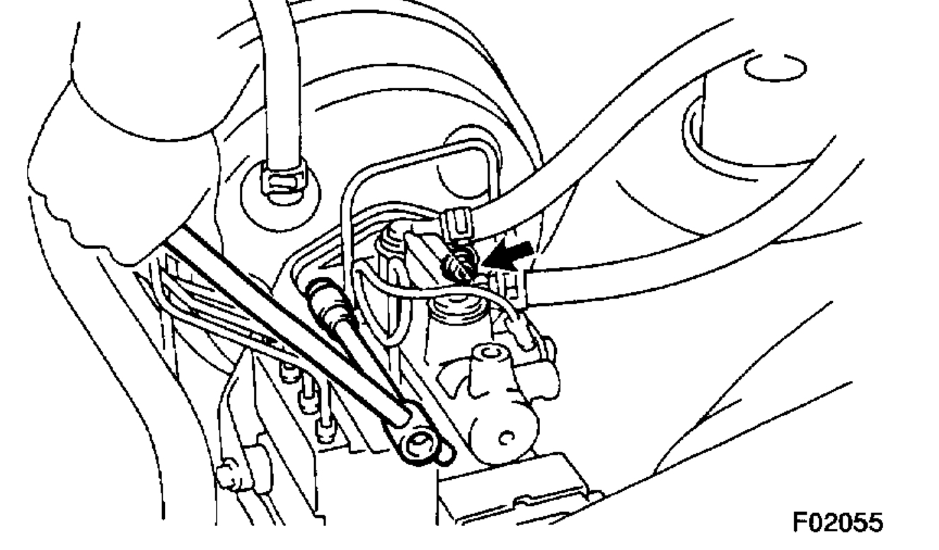

  • 110,194 POSTS
I suspect it has something to do with the type of brakes. I'm saying that simply because it stopped since the rain started. Now they are wet.
As far as brake fluid, I don't feel that would cause anything like this. However, it wouldn't hurt to check. I attached a pic showing the location of the brake master cylinder reservoir location. There will be a line on it indicating full and low. Check the level. If you need to add, it requires DOT 3 brake fluid. Any parts store will have it.
I attached another pic, pic 2, so you know what you are looking for. Note that the reservoir may be shaped differently.
Let me know what you find.

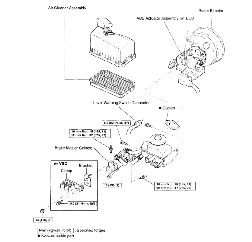

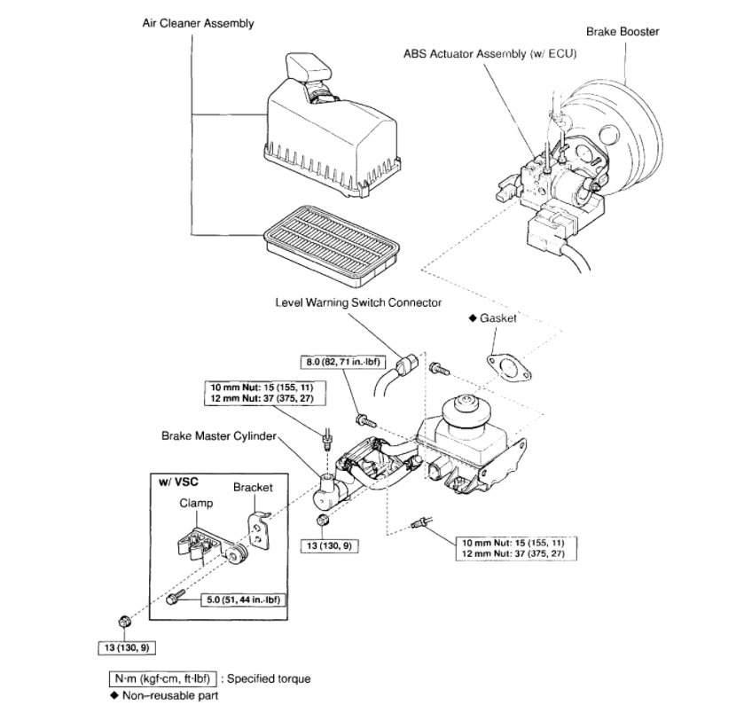

MPSADOWSKI
van drives fine and brakes will stop vehicle. I did not notice any brake fluid leakage at the front caliper or rear drum pistons. I hope this would solve the pedal travel issue.

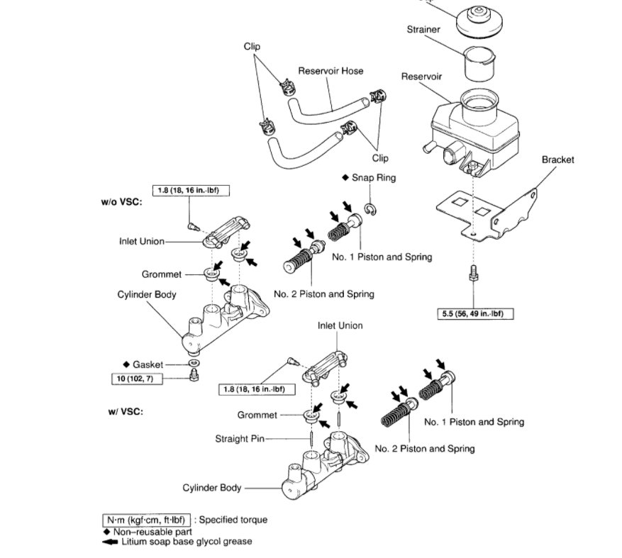

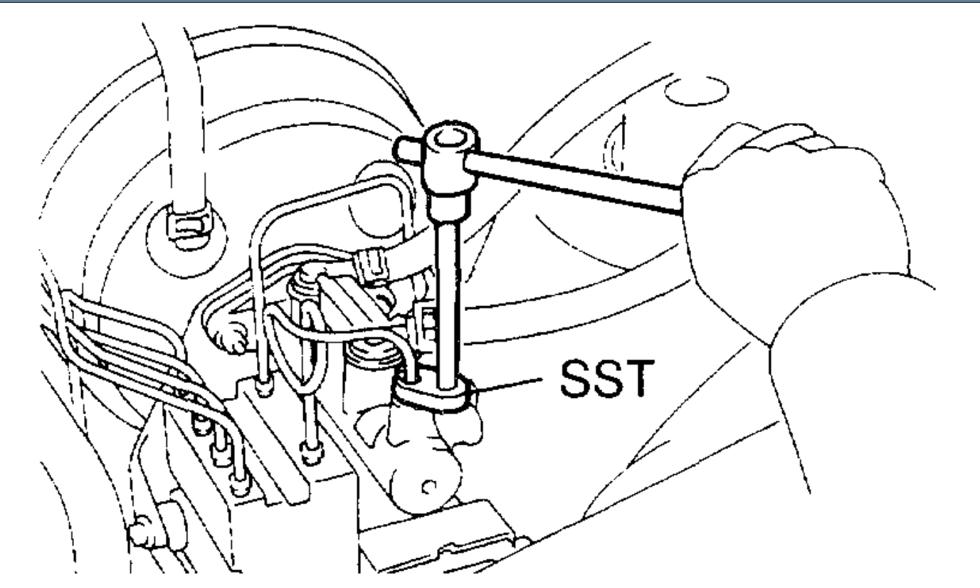

Good afternoon,
If the pedal goes to the floor, there is a possible issue with the master cylinder.
https://www.2carpros.com/articles/brake-pedal-goes-to-the-floor
There is air in the lines from the lack of fluid. I would replace the master cylinder and bleed the system.
https://www.2carpros.com/articles/how-to-replace-a-brake-master-cylinder
https://www.2carpros.com/articles/how-to-bleed-or-flush-a-car-brake-system
REMOVAL
1. REMOVE AIR CLEANER ASSEMBLY
2. DISCONNECT LEVEL WARNING SWITCH CONNECTOR
3. DRAW OUT FLUID WITH SYRINGE
NOTICE: Do not let brake fluid remain on a painted surface. Wash it off immediately.
4. REMOVE RESERVOIR WITH BRACKET
Remove the 2 bolts and reservoir with bracket .
Torque: 8.0 Nm (82 kgf-cm, 71 inch lbs.)
5. DISCONNECT BRAKE LINES
Using SST, disconnect the 2 brake lines from the master cylinder.
SST 09023-00100
Torque: 10 mm nut: 15 Nm (155 kgf-cm, 11 ft. lbs.)
Torque: 12 mm nut: 19.6 Nm (200 kgf-cm, 14.5 ft. lbs.)
6. REMOVE MASTER CYLINDER
(a)w/o VSC:
Remove the 2 mounting nuts.
Torque: 13 Nm (130 kgf-cm, 9 ft. lbs.)
(b)w/ VSC:
Disconnect the brake line from clamp and remove the bolt and clamp, then remove the 2 mounting nuts and bracket.
Torque:
Mounting nut: 13 Nm (130 kgf-cm, 9 ft. lbs.)
Clamp bolt: 5.0 Nm (51 kgf-cm, 44 inch lbs.)
(c)Pull out the master cylinder with gasket.
7. REMOVE GASKET FROM MASTER CYLINDER
INSTALLATION
Installation is in the reverse order of removal.
HINT:
- Before installation, adjust length of brake booster push rod.
- After installation, fill the brake reservoir with brake fluid, bleed the brake system.
- Check for leaks, check and adjust brake pedal.

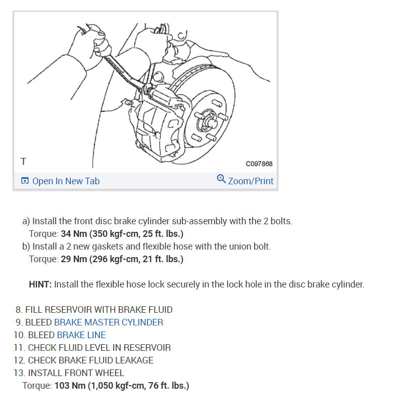

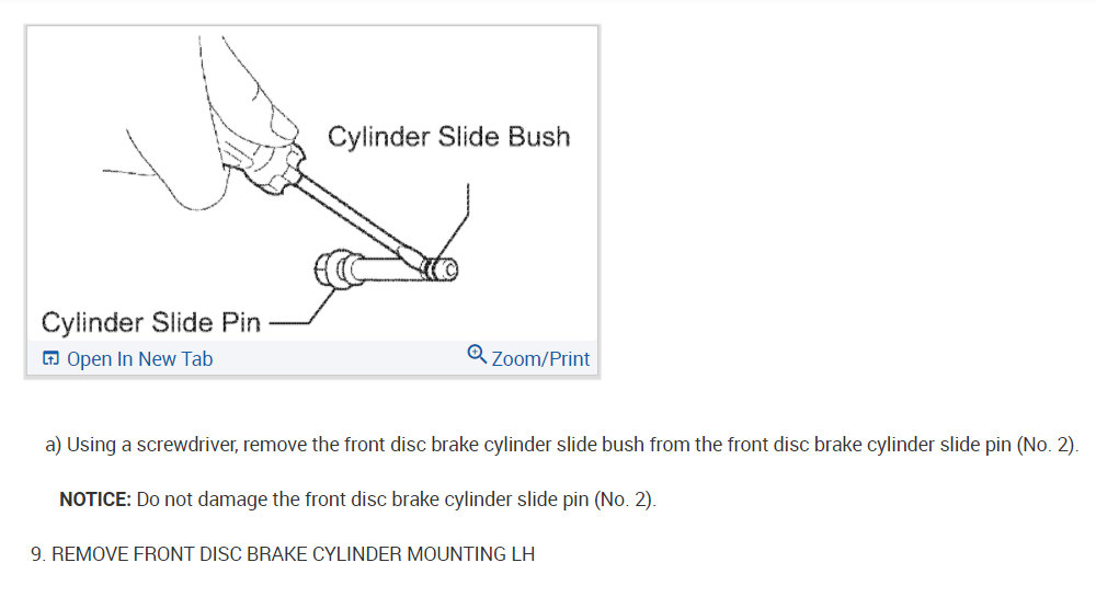

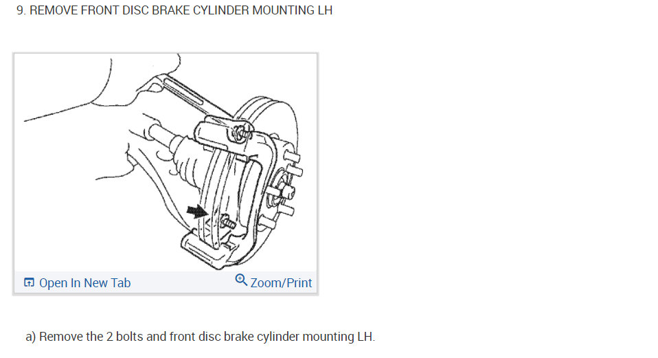

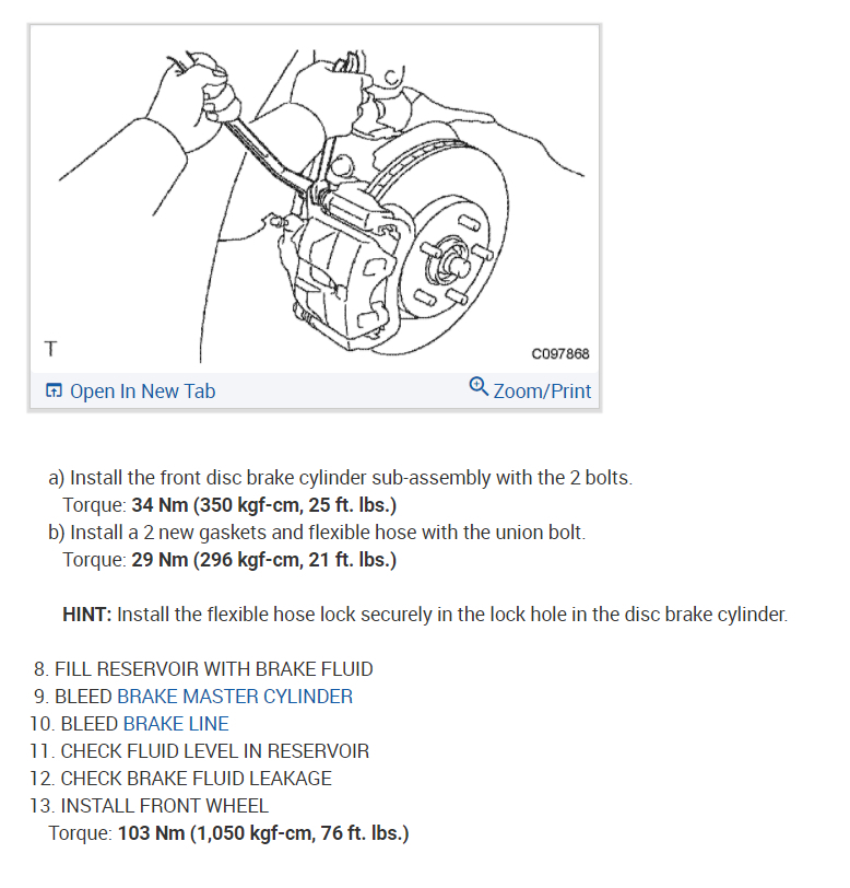

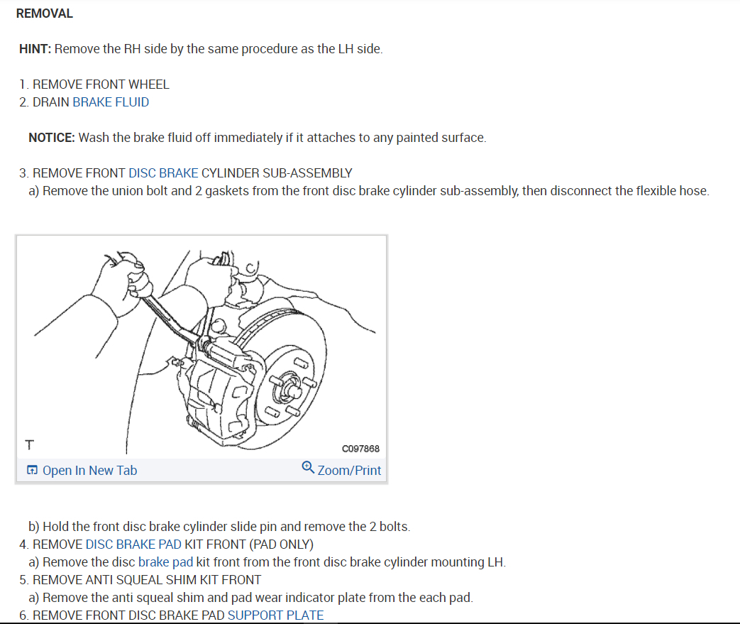

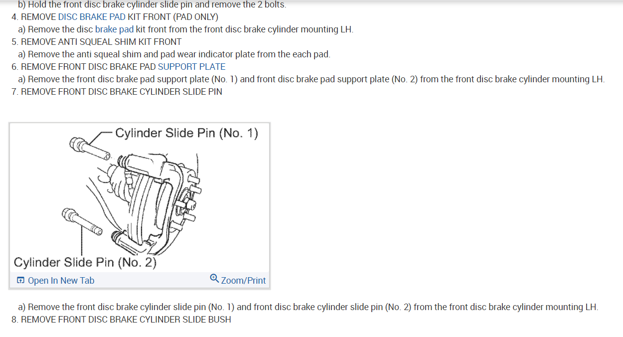

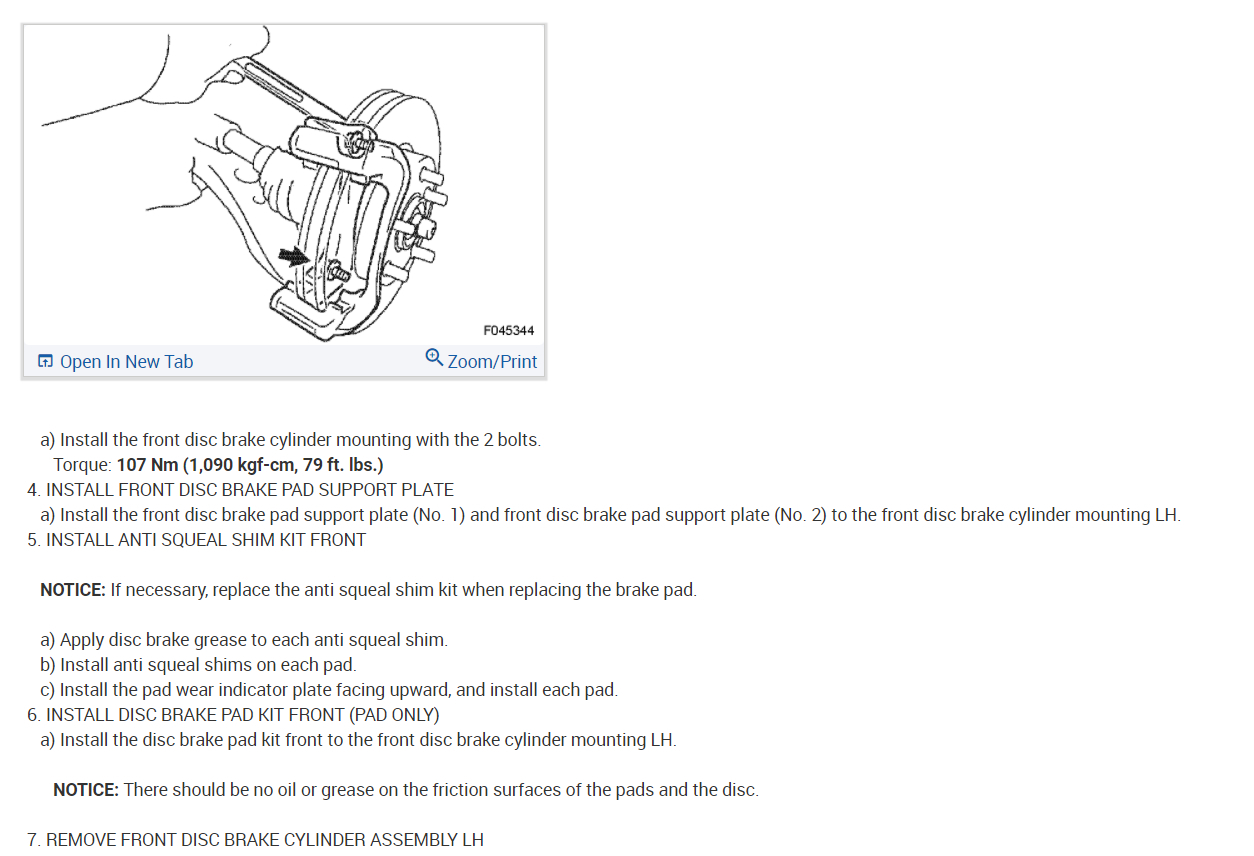

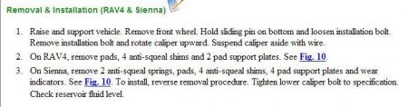

RDJ1443
How do I replace the Front Brake Pads?
BLUELIGHTNIN6
  • 16,542 POSTS

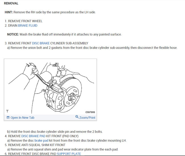

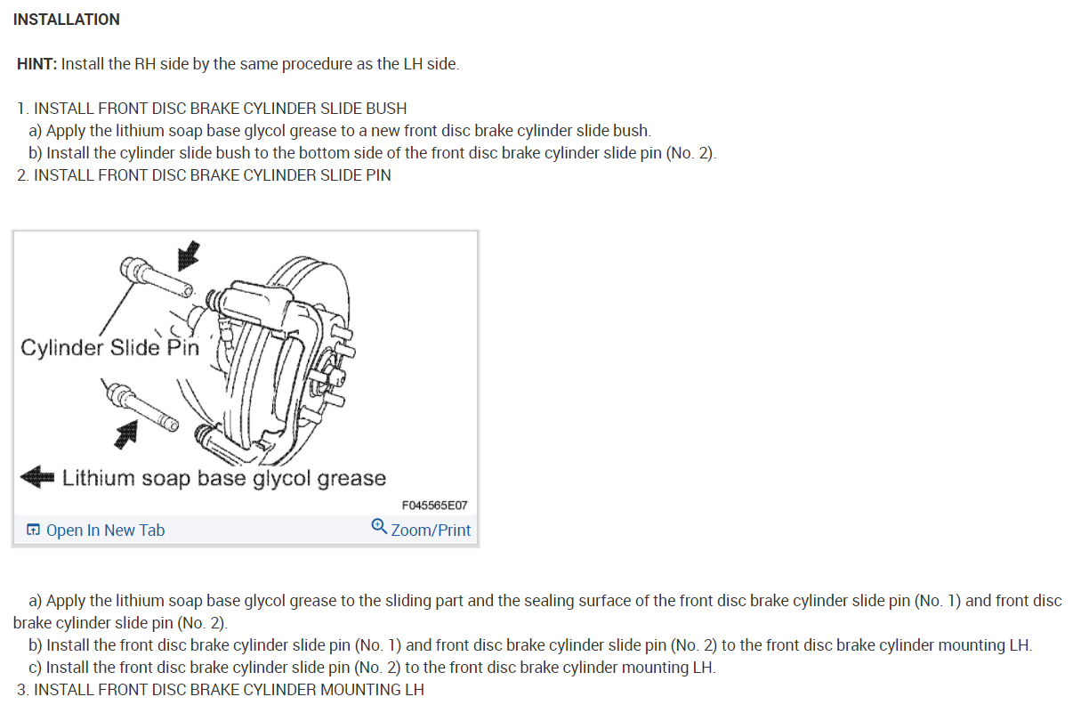

Hello Below are the procedures for replacing your vehicle's front brake pads..
https://images.2carpros.com/forum/automotive_pictures/261618_Noname_1001.jpg
FIG. 10
https://images.2carpros.com/forum/automotive_pictures/261618_Graphic_180.jpg

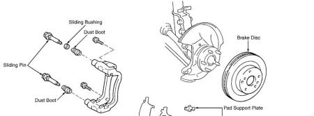

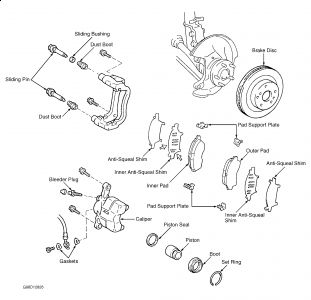

RDJ1443
This did not help me. Can not read diagram. Pinion came out and we can not get it back into position.
BLUELIGHTNIN6
  • 16,542 POSTS
that is the proper replacement procedures..if you still can't do the job take it to a shop..
https://images.2carpros.com/forum/automotive_pictures/261618_Noname_1006.jpg
https://images.2carpros.com/forum/automotive_pictures/261618_Noname2_282.jpg
