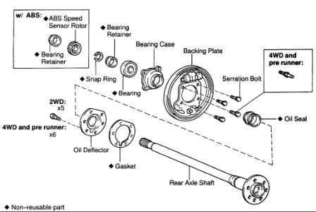

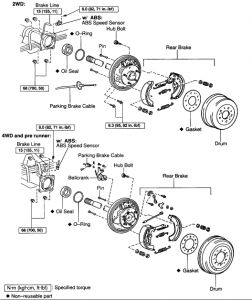

Hello Mike The info you requested for a 2000 Toyota Truck, Tacoma Extra Cab, 4WD, V6-3.4L (5VZ-FE) Removal

HINT: PreRunner is the model described below. RZN191L-TRPDKAB, RZN196L-CRPDKAB, VZN195L-CRPDKAB REMOVE REAR WHEEL AND BRAKE DRUM Torque: 110 Nm (1,150 kgf-cm, 83 ft. lbs.)

CHECK BEARING BACKLASH AND AXLE SHAFT DEVIATION Using a dial indicator, check the backlash in the bearing shaft direction. Maximum: 0.7 mm (0.028 inch) If the backlash exceeds the maximum, replace the bearing. Using a dial indicator, check the deviation at the surface of the axle shaft outside the hub bolt. Maximum: 0.1 mm (0.0039 inch) If the deviation exceeds the maximum, replace the axle shaft. w/ ABS: REMOVE ABS SPEED SENSOR FROM REAR AXLE HOUSING Remove the bolt and ABS speed sensor. Torque: 8.0 Nm (82 kgf-cm, 71 inch lbs.) REMOVE REAR BRAKE ASSEMBLY
https://images.2carpros.com/forum/automotive_pictures/248015_4_18.gif
DISCONNECT BRAKE LINE AND PARKING BRAKE CABLE Using SST, disconnect the brake line from the wheel cylinder. SST 09751-36011 Torque: 15 Nm (155 kgf-cm, 11 ft. lbs.) 2WD: Remove the 2 bolts and disconnect the parking brake cable. Torque: 9.3 Nm (95 kgf-cm, 82 inch lbs.) REMOVE REAR AXLE SHAFT ASSEMBLY Remove the 4 backing plate mounting nuts. Torque: 68 Nm (700 kgf-cm, 50 ft. lbs.) Pull out the rear axle shaft assembly from the rear axle housing. NOTICE: Be careful not to damage the oil seal. REMOVE O-RING FROM REAR AXLE HOUSING INSPECTION w/ ABS: REMOVE BEARING RETAINER (DIFFERENTIAL SIDE) AND ABS SPEED SENSOR ROTOR

REPLACE BEARING CASE Remove the oil seal (outer side) and bearing. Install 4 nuts to the serration bolts. Using a hammer, remove the serration bolts and bearing case. Position the backing plate on a new bearing case and using 2 socket wrenches, install the serration bolts. Install a new bearing and oil seal (outer side).
https://images.2carpros.com/forum/automotive_pictures/248015_15_1.gif
REPLACE OIL DEFLECTOR Using a brass bar and hammer, remove the hub bolts, oil deflector and gasket. Position a new gasket on the axle shaft and install a washer and nut to a new hub bolt, as shown in the illustration, and install the hub bolt by torquing the nut.
https://images.2carpros.com/forum/automotive_pictures/248015_16_1.gif
INSTALL REAR AXLE SHAFT IN BACKING PLATE Coat a new oil seal lip with MP grease. Install the backing plate and bearing retainer on the rear axle shaft. Using SST and a press, install the rear axle shaft into the backing plate. SST 09316-60011 (09316-00051) Using snap ring expander, install a new snap ring.

Using SST and a hammer, install a new oil seal. SST 09950-60020 (09951-00710), 09950-70010 (09951-07150) Coat a new oil seal lip with MP grease. INSTALLATION Installation is in the reverse order of removal. HINT: After installation, bleed the brake system and check the ABS speed sensor signal.
