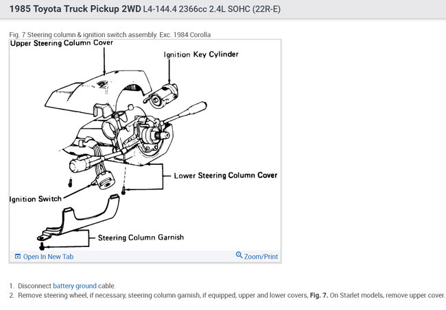

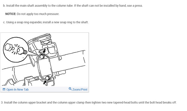

We're replacing the ignition switch in our Tacoma and are unable to get the switch assembly to slide out from it's housing. I suspect it's the steering locking mechanism that's preventing it's removal. Any advice?
Wednesday, April 30th, 2008 AT 5:19 PM
26 Replies
RICHARD TOMASCIK
Here are the instructions in the diagrams below to show you how to replace the ignition tumbler and switch. Check out the diagrams (Below). Please let us know what happens.

  • 75,992 POSTS
Sounds like the problem is the ignition key cylinder
Obtain audio anti-theft code, if equipped, as outlined in Technician Safety Information . On models with air bag system, disarm airbag system as outlined under Technician Safety Information.
Disconnect battery ground cable.
Remove steering wheel, if necessary, steering column garnish, if equipped, upper and lower covers, Fig. 12.
https://www.2carpros.com/forum/automotive_pictures/12900_ign_key_cyl_1.jpg
Fig. 12 Steering Column & Ignition Switch Assembly.
Disconnect electrical connectors from ignition switch.
Turn ignition key to ACC position
Push down the stop key with a thin rod, pull out the ignition key cylinder.
Reverse procedure to install. Make sure that the ignition key is at the ACC position. Reset audio coded anti-theft and air bag system, if equipped, as outlined under Technician Safety Information.

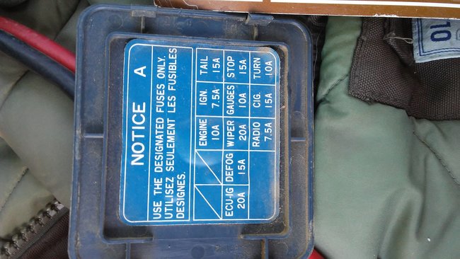

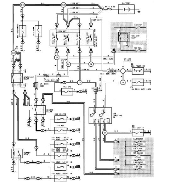

The fuses in the kick panel on the driver side do not illuminate when I put a test light on them. When I turn the ignition to crank, I get nothing (no sound, no clicks). I get no check engine light, no buzz from when you put the key in the ignition or when I turn the key on. It has a brand new battery and is getting power to the block and 12 volts. I get headlights and horn. I'm wanting to test the ignition wires going to the switch or the switch itself, but not sure what or how to do it. I've really run out of options of what to do and requesting help.
Saturday, August 15th, 2020 AT 1:59 PM (Merged)
  • 52,797 POSTS
Good afternoon,
Did you check for power with the key on?
I attached a diagram of the fuse panel.

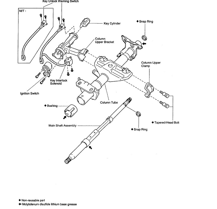

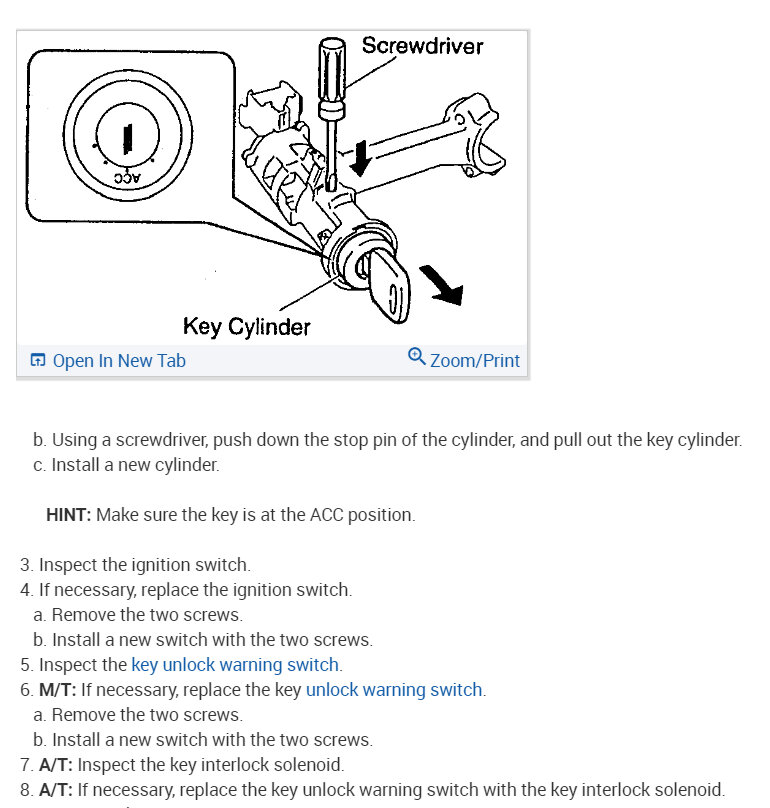

I need to replace the ignition lock cylinder. What do I need to remove to get the cylinder out of the ignition housing?
BLUELIGHTNIN6
  • 16,542 POSTS
Disconnect the negative battery cable.
Unscrew the retaining screws and remove the upper and lower steering column covers.
Unscrew the 2 retaining screws and remove the steering column garnish.
Turn the ignition key to the ACC position.
Push the lock cylinder stop in with a small, round object (cotter pin, punch etc.) and pull out the ignition key and the lock cylinder.
You may find that removing the steering wheel and the combination switch will facilitate easier removal.
Withdraw the lock cylinder from the lock housing while depressing the lock tab.
To remove the ignition switch, unfasten its securing screws and withdraw the switch from the lock housing.
