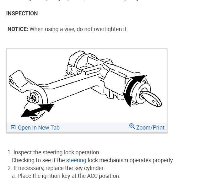

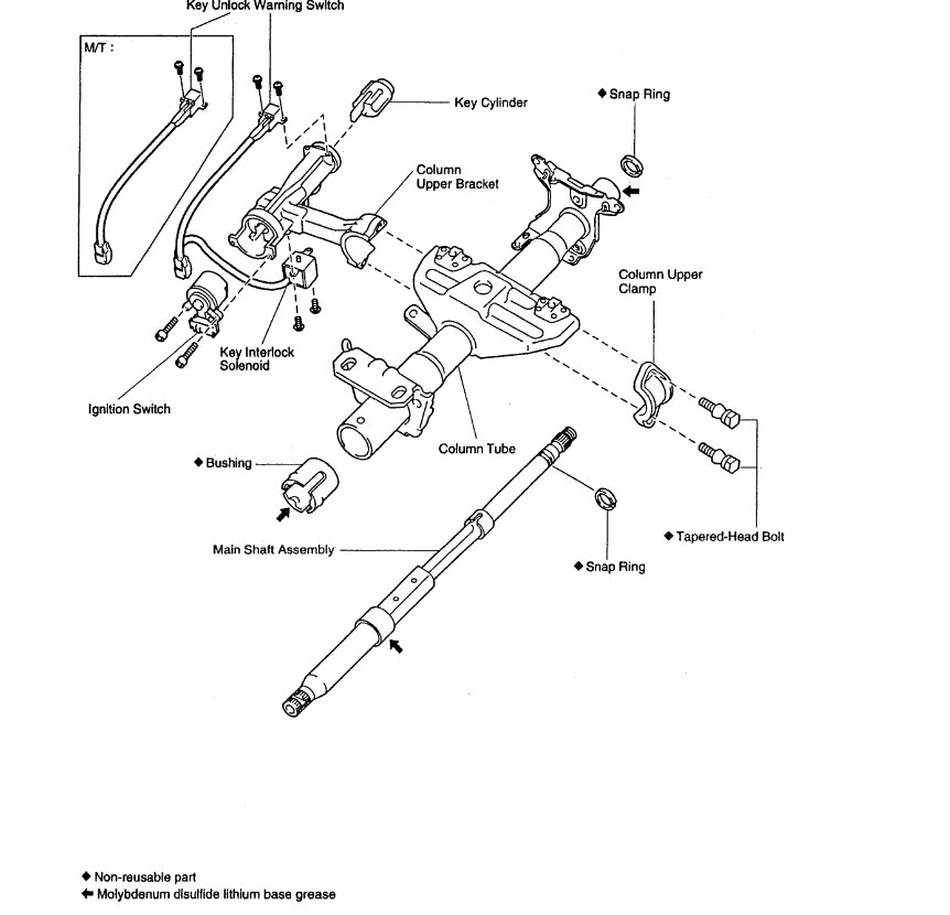

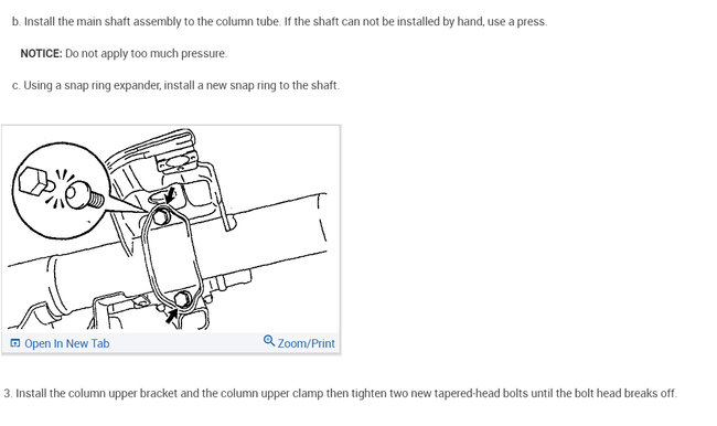

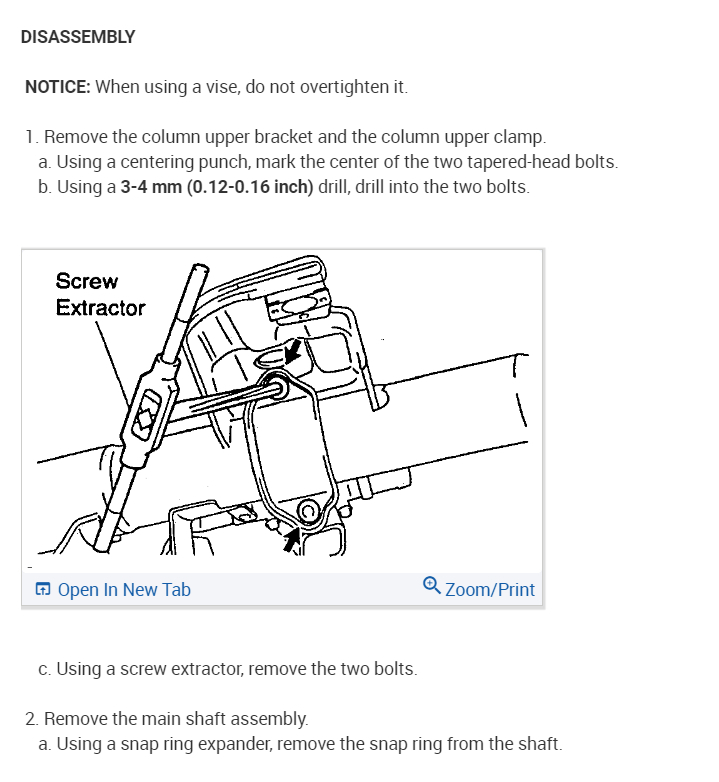

We're replacing the ignition switch in our Tacoma and are unable to get the switch assembly to slide out from it's housing. I suspect it's the steering locking mechanism that's preventing it's removal. Any advice?
Apr 30, 2008 at 10:19 AM
RICHARD TOMASCIK
Here are the instructions in the diagrams below to show you how to replace the ignition tumbler and switch. Check out the diagrams (Below). Please let us know what happens.
Apr 30, 2008 at 10:22 AM

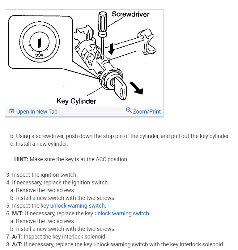

MFERRIS75
How do remove the ignition cylinder? I have to replace it it, but there is a pin that is not allowing me to remove the part. How do it?
Aug 15, 2020 at 6:58 AM (Merged)
BLACKOP555
  • 10,386 POSTS
to remove you turn the key to the on position, then insert a straightened paper clip in the hole on the cylinder and push this disengages the pin and the tumbler should pull striaght out.

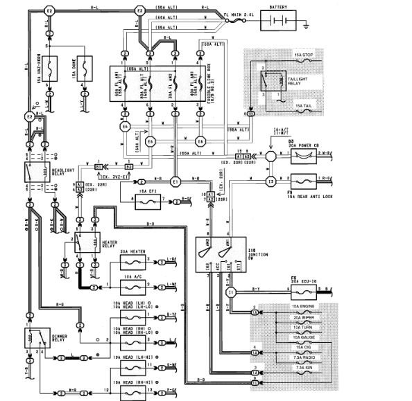

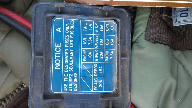

The fuses in the kick panel on the driver side do not illuminate when I put a test light on them. When I turn the ignition to crank, I get nothing (no sound, no clicks). I get no check engine light, no buzz from when you put the key in the ignition or when I turn the key on. It has a brand new battery and is getting power to the block and 12 volts. I get headlights and horn. I'm wanting to test the ignition wires going to the switch or the switch itself, but not sure what or how to do it. I've really run out of options of what to do and requesting help.
Aug 15, 2020 at 6:59 AM (Merged)
Good afternoon,
Did you check for power with the key on?
I attached a diagram of the fuse panel.
KEN WEBB
I need to replace the ignition lock cylinder. what do i need to remove to get the cylinder out of the ignition housing?
BLUELIGHTNIN6
  • 16,542 POSTS
Disconnect the negative battery cable. Unscrew the retaining screws and remove the upper and lower steering column covers. Unscrew the 2 retaining screws and remove the steering column garnish. Turn the ignition key to the ACC position. Push the lock cylinder stop in with a small, round object (cotter pin, punch etc.) and pull out the ignition key and the lock cylinder. You may find that removing the steering wheel and the combination switch will facilitate easier removal. Withdraw the lock cylinder from the lock housing while depressing the lock tab. To remove the ignition switch, unfasten its securing screws and withdraw the switch from the lock housing. To install: Align the locking cam with the hole in the ignition switch and insert the switch into the lock housing. Secure the switch with its screws. Make sure that both the lock cylinder and the column lock are in the ACC position. Slide the cylinder into the lock housing until the stop tab engages the hole in the lock. Install the steering column garnish and the upper and lower column covers. Connect the negative battery cable.

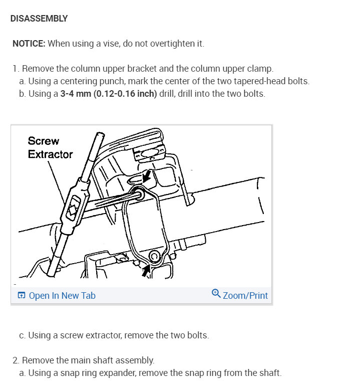

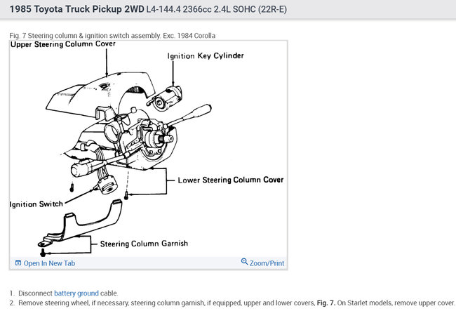

JHARETOYOTA
i got into a wreck in my new vehicle and i had to key to my Toyota on my keychain, since my vehicle was totaled the wrecker company had my keychain and i cant get it back. I was wondering how to pull out the key cylinder so i can get a key made for it(i cant get the key cylinder out) Thanks for any help
  • 75,992 POSTS
Here are the instructions and a diagrams below to show you how to do the job.
1. Disconnect battery ground cable.
2. Remove steering wheel, if necessary, steering column garnish, if equipped, upper and lower covers, Fig. 7. On Starlet models, remove upper cover.
3. Disconnect electrical connectors from ignition switch.
4. Turn ignition key to ACC position and remove ignition key cylinder.
5. Remove screw and ignition switch.
6. Reverse procedure to install.
JHARETOYOTA
i would turn the cylinder to the acc part but i dont have the key and it is in the lock position and the steering wheel wont move.
  • 75,992 POSTS
You will need to drill it out it can be a little messy so hang in there.
