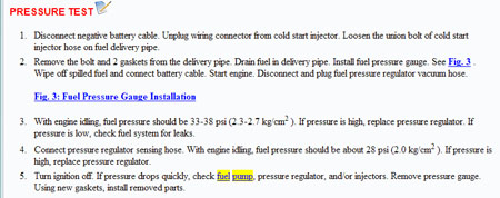

I Own A Toyota truck when I bought it it needed a fuel pump I changed the fuel pump but I have a problem the is not getting any power and I checked the wiring and power is not going to the fuel pump and I don't know where the relay fuse is at.

Here's what to check...
https://www.2carpros.com/forum/automotive_pictures/62217_FPa_1.jpg
https://www.2carpros.com/forum/automotive_pictures/62217_FPb_1.jpg
https://www.2carpros.com/forum/automotive_pictures/62217_FPc_1.jpg
