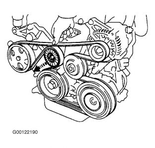

DOCFIXIT
  • 18,828 POSTS
Both on and off pull clockwise. See diagram.
https://images.2carpros.com/forum/automotive_pictures/198357_Graphic_468.jpg

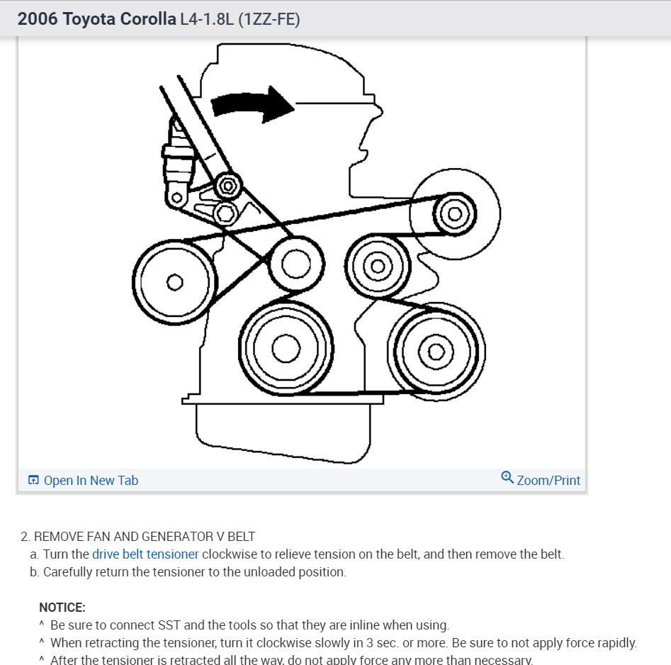

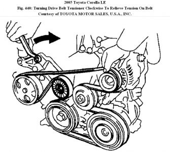

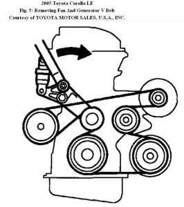

KHLOW2008
  • 41,814 POSTS
Hi MALAKIYA, Here are the procedures. FAN AND GENERATOR V BELT (1ZZ-FE) REPLACEMENT 1. REMOVE ENGINE UNDER COVER RH 2. REMOVE FAN AND GENERATOR V BELT a. Turn the drive belt tensioner clockwise to relieve tension on the belt, and then remove the belt. b. Carefully return the tensioner to the unloaded position. NOTE: Be sure to connect SST and the tools so that they are inline when using. When retracting the tensioner, turn it clockwise slowly in 3 sec. or more. Be sure to not apply force rapidly. After the tensioner is retracted all the way, do not apply force any more than necessary.
https://images.2carpros.com/forum/automotive_pictures/192750_SerpentineBelt1ZZ05CorollaFig05_1.jpg
https://images.2carpros.com/forum/automotive_pictures/192750_SerpentineBelt2ZZ05CorollaFig440_1.jpg

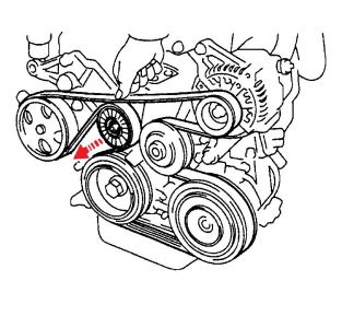

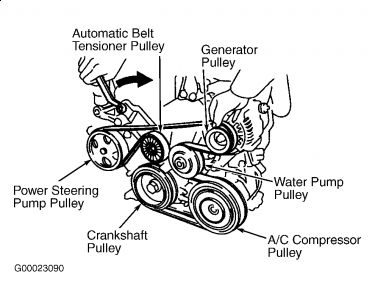

LRRYMNDZ
how do i get the new belt back on the engine? i would also like to know if i can get a diagram for the tension bar and how to get the belt on right?
Sep 3, 2019 at 4:18 PM (Merged)
BMRFIXIT
  • 19,053 POSTS
https://images.2carpros.com/forum/automotive_pictures/99387_corrrola_2.jpg
https://images.2carpros.com/forum/automotive_pictures/99387_corolla_belt_2.jpg
