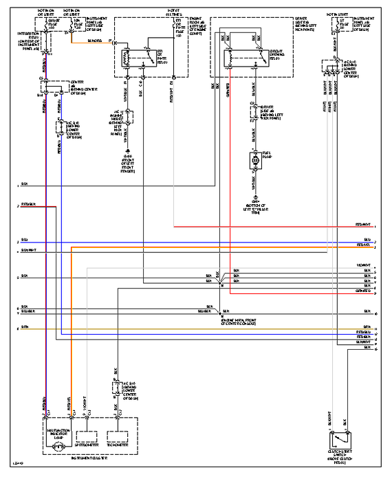

Where is the ignition coil wire in a 2003 toyota corolla? I have had the starter replaced and the battery, but car will not fire up once in a while, someone told me to see if ignition coil wire is loose?
where is it under the hood
Sunday, March 23rd, 2008 AT 8:02 PM
46 Replies
MMPRINCE4000
  • 8,548 POSTS

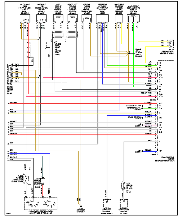

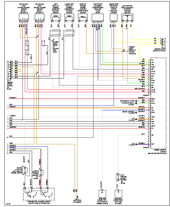

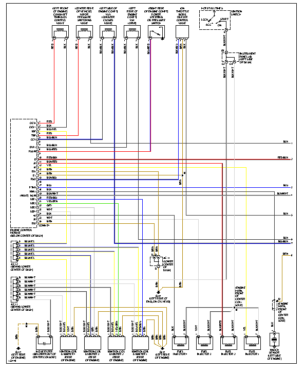

They use individual coil packs for each cylinder. Remove the plastic engine cover and you will see the 4 coil packs. They are bolted to the cylinder head. Here are the engine wiring diagrams with a guide to help you check them below.

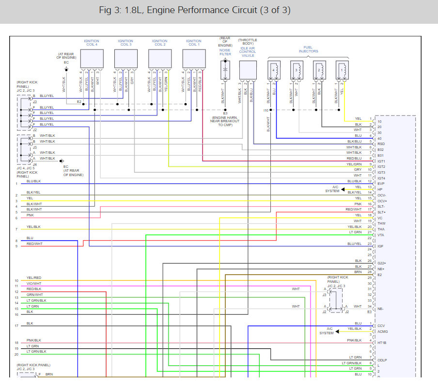

I need a diagram of a coil on plug transistor for a 00 corolla. I think the transistor is part of the coil and not the PCM, Is that true?
Is this transistor PNP or NPN? Also what is the base/trigger voltage value. Thanks!

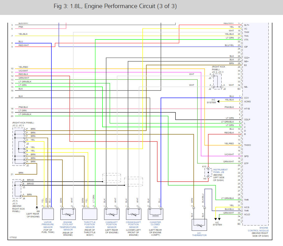

HMAC300
  • 48,601 POSTS
Crank position sensor is 1630-2740oms cold and 2065-3225 ohms hot cold temp is 14-122F and hot is 122-212 F the oil is allone piece. There is also a cam sensor and this shold be scanned for codes and fuel pressure checked first if it doesn't run cam sensor is 835-1400 and hot 1060-11645 hot

J.STIEG
  • 352 POSTS

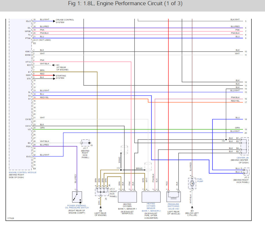

It runs fine, I would like to see a "wiring diagram" so I can learn about ignition systems. Thanks
There are 4 wires at the coil on plug.
+2
Tuesday, August 11th, 2020 AT 4:21 PM (Merged)
HMAC300
  • 48,601 POSTS
The wiring daiagram that you seek wold be to small for me to send as it it 3 differnt pages and covers the whole engine for obd2. Get a haynes manual for that
+1
J.STIEG
  • 352 POSTS
All I need to know is just the coilpack/transistor area alone. 4 wires, Is that something you can post, thank you.
HMAC300
  • 48,601 POSTS
That includes the whole harness I cold only seperate the coil pack nothing else because everything runs to the computer.

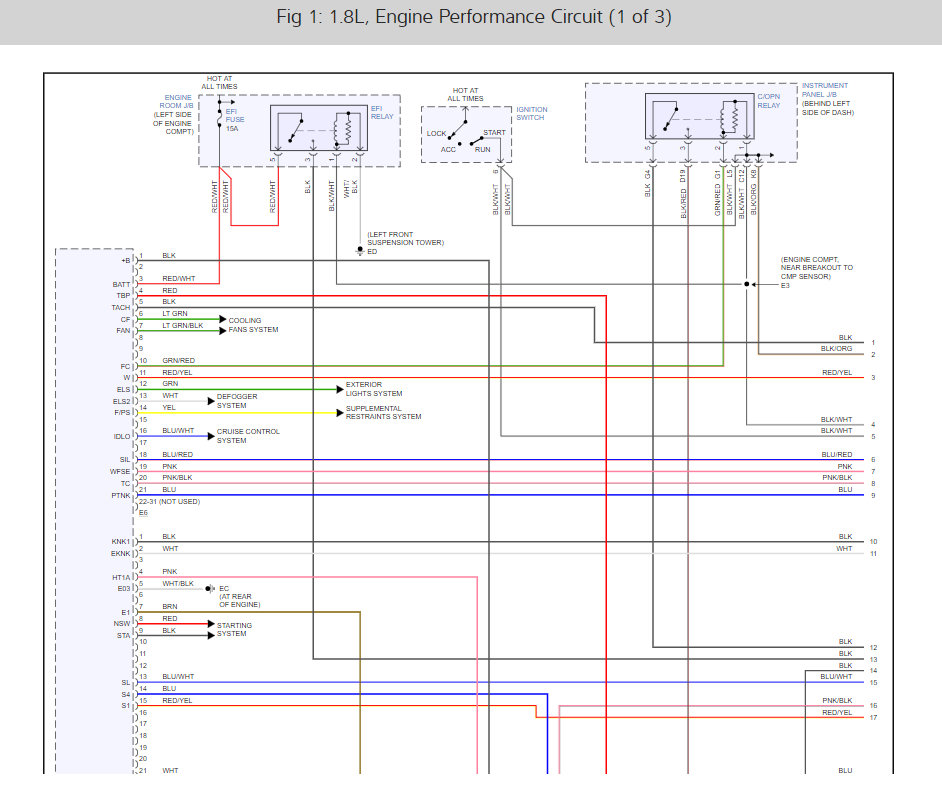

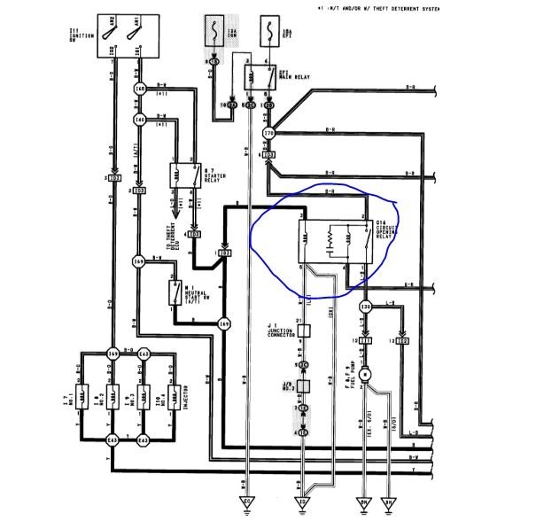

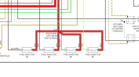

Is there a fuse or some kind of power pack that supplies power to injector? I do have power to three injectors not to one, changed injectors at different cylinders to see if injector was clogged it worked fine at different cylinder. Have spark at all spark plug wires everything worked fine before I powered washed engine. No power at wire that plugs in to injector
  • 75,992 POSTS
The black wire on the injector harness connector is the hot side-the one that don't have power get a jumper wire and splice into another injector harness connector black wire and see what happens
https://www.2carpros.com/forum/automotive_pictures/12900_injector_6.jpg
+1
BUILTROD
Also I forgot to mention check engine light is on now as well, if I use jumper wire will that screw up firing order of fuel injectors? Again this all just happened after I washed engine, drove car around block then parked went to start a week later, thats when problems started
  • 75,992 POSTS
The black wire on each injector is the power-it won't affect the F/O of the injectors they all tied into a splice look at the diagram-
Also try pulling the code/s from the computer

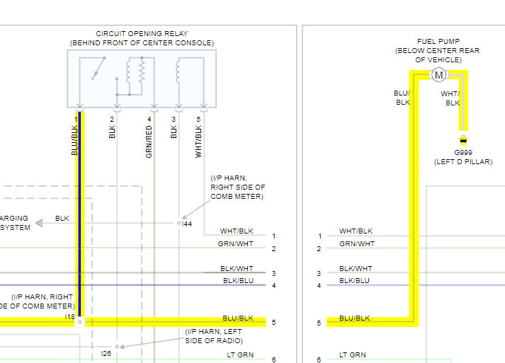

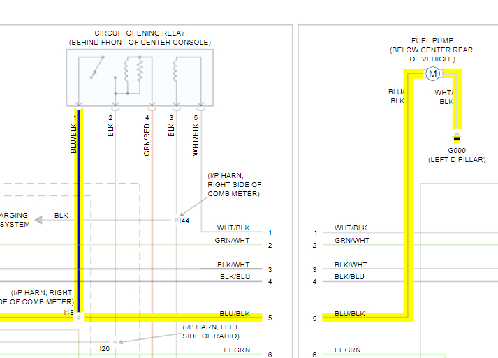

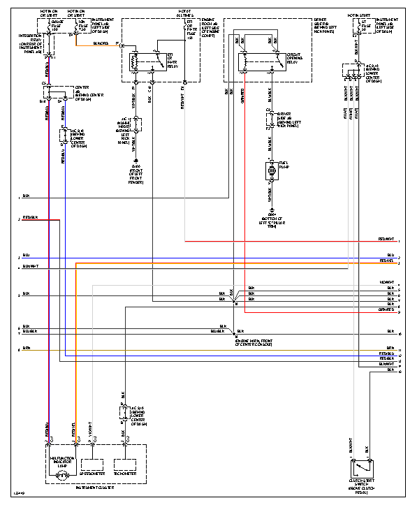

Need the wiring colors of the connector for the fuel pump/sending unit.

I attached the wiring diagram for the fuel pump. Looks like the supply wire off the relay is blue/black and the ground from the pump is white/black.
Let us know if you need more info. Thanks
